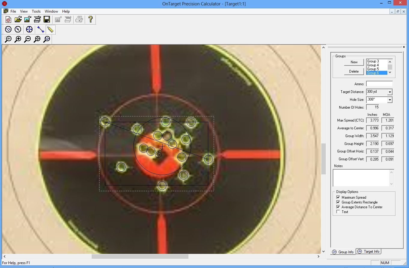

Remington Defense (M24 rebuild) makes a decent rifle - 300 yard target attached, would be a 148 6x if in a midrange F class match. Someday I'll figure out how to clean a target.
My Rem 700 5R will shoot 0.25-0.5" @ 100 yards with 175gr SMKs over 42.2gr of IMR 4064. It is a 0.5" or better shooter with 175gr FGGM.
