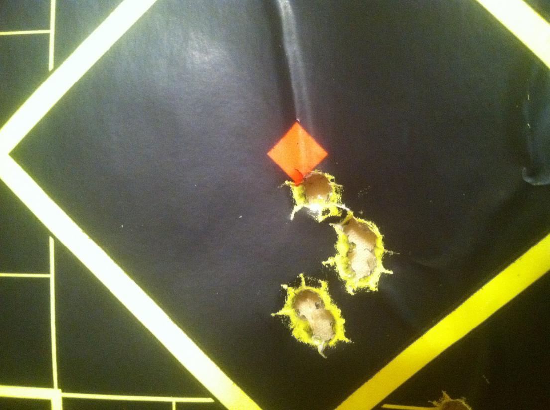

Hey guys. I done what y'all recommended and retorqued the ring caps to 20in lbs. and the ring cross bolts to 65in lbs. as well as the action screws. I then ran about thirty rounds of 147gr. FMJ's through it and these are the groups it started printing with the millet still attached.
100 yards, correct?if so that looks like an improvement over your previous outing. Perhaps you have a rough barrel and simply getting some bullets through it is helping clean it up.

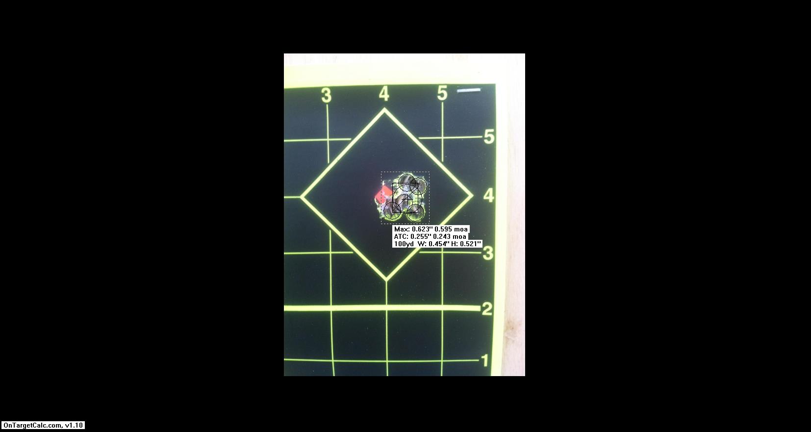

Yes 280nosler, these are all 5 shot 100 yard groups using the same federal gold medal match 175gr. SMK ammo I started off with. Front supported by sandbag and rear supported by my non-firing hand under the butt of the stock in the prone position from the bed of my pickup on a shooting mat. Atlas BT-10 bipod is entire. When the groups started improving I went straight from the 100 yard sight in target to the gong at 600 and didn't stop anywhere in-between! First 5 rounds were all 5 hits with a 1.2-2mph wind varying from the 9 o'clock which I didn't redial for between shots. As you can see from the pictures of the gong you can see where the wind picked up and fell off. The far far right edge hit the wind gusted on me then two shots later fell out completely which was the far left hit. I put two in the same crater almost in the same hole!!! I would say if it weren't for the wind that would have been a nice group at 600! Gong has 14" body and 6" or 8" head, can't quite remember. Target body is just slightly over 2moa at 600 and head is 1moa at 600 if it is a 6" head. Rifle was on a bag in the front and rear at 600. I think it's most definitely getting better the more I shoot it! What do you guys think? Thanks again!

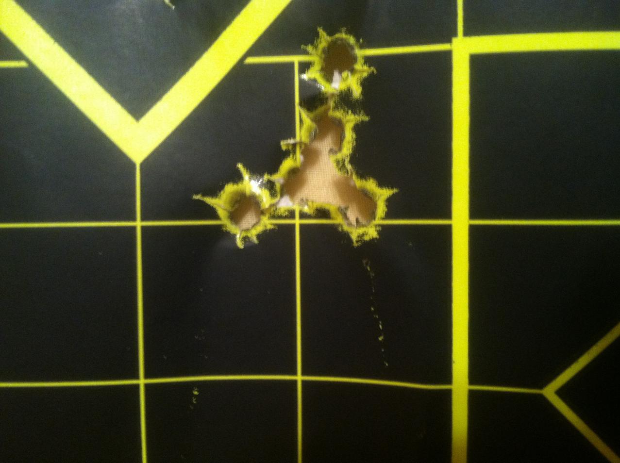

I don't guess the other pictures of my groups posted. Here they are.

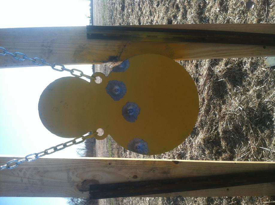

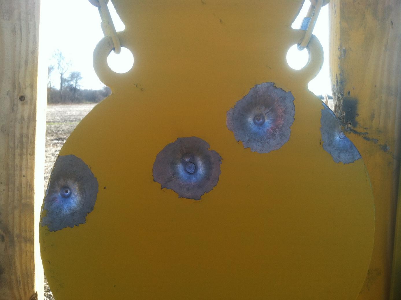

Custom rig. Long story. Here is the short version. Saw this rig advertised here on the hide. Contacted the seller, made the deal. The seller said the story behind the rifle was this. There was a total of four made for the Dade County SWAT team in "94". In 2007 they put these up for auction of some web site he found. He bid on one and won it. He said it looked as though it had not been shot much. He put about 200 rounds down it and said it was a hammer. In 2011 he put it up for sale here and I bought it. I have all original paper work. It came from a company called "Accra-Liance Sniper Systems". I have looked in the entire internet and can find nothing on this company. But he was correct about one thing. It is a hammer. below is a pic.
IOR 3.5X18X50, it had a Leupold 10X on it when I got it, I bought a Nikon 2.5X10X42 with a mil-dot reticle, nice scope but wanted a tad more mag. So I ran across the IOR here on the hide also. I have been happy with this set up ever since. I have a place where I can shoot out to 600. I plan on seeing what kind of groups I can get @ that range pretty soon.
Post on this thread how it does at that range. I would personally like to know. I'll update again when the bipod gets here and winds cooperate so I can try and print a 1moa group at 600 or better!
Thanks man. Me too! I'm hoping it continues to get better!! I think with better glass it would get better also but the millet is actually "fairly" decent for a "beginners" scope.

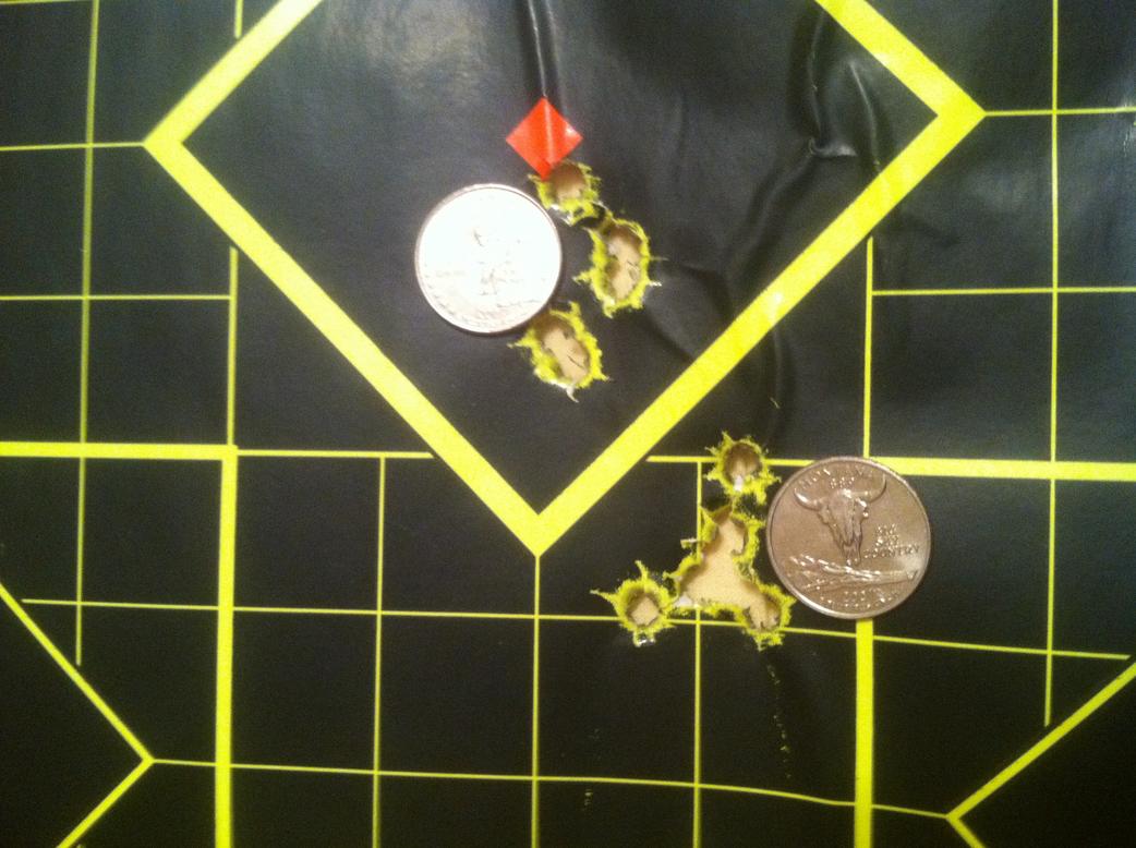

Hey guys been a few weeks. I got the rifle skim bedded into the stock with marine-tex going roughly an inch and a half forward of the recoil lug in the barrel channel to support the chamber. I got my atlas BT-10 bipod in and got it on. This 5 shot group was at 102 yards off bipod and rear squeeze bag. I stabbed the bipod feet down through the inch of sleet we got here last Friday which enabled me to load the bipod really well. Same ammo federal gold medal match 7.62x51 175 grain Sierra matchking. Environmentals were: 32.7°F, 29.70InHg baro pressure, 2mph wind from 12-1 o'clock, 100%RH. I also moved the scope back one slot on the rail when I reassembled all of it from the bed job as I felt I may have initially been straining a bit to get a good sight picture. What do you guys think?

Terrible! You better sell that thing...to me...for cheap. :p
