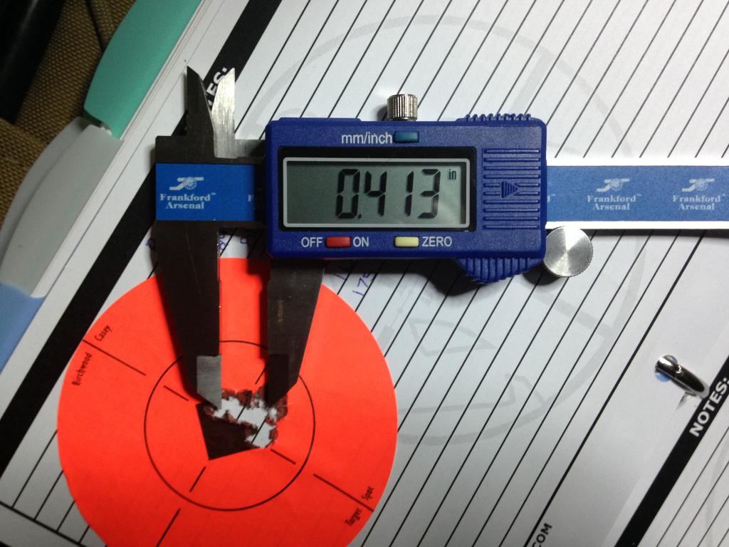

175 FGMM 5 shot group 100 yards. I'm going to try and replicate this ammo.
