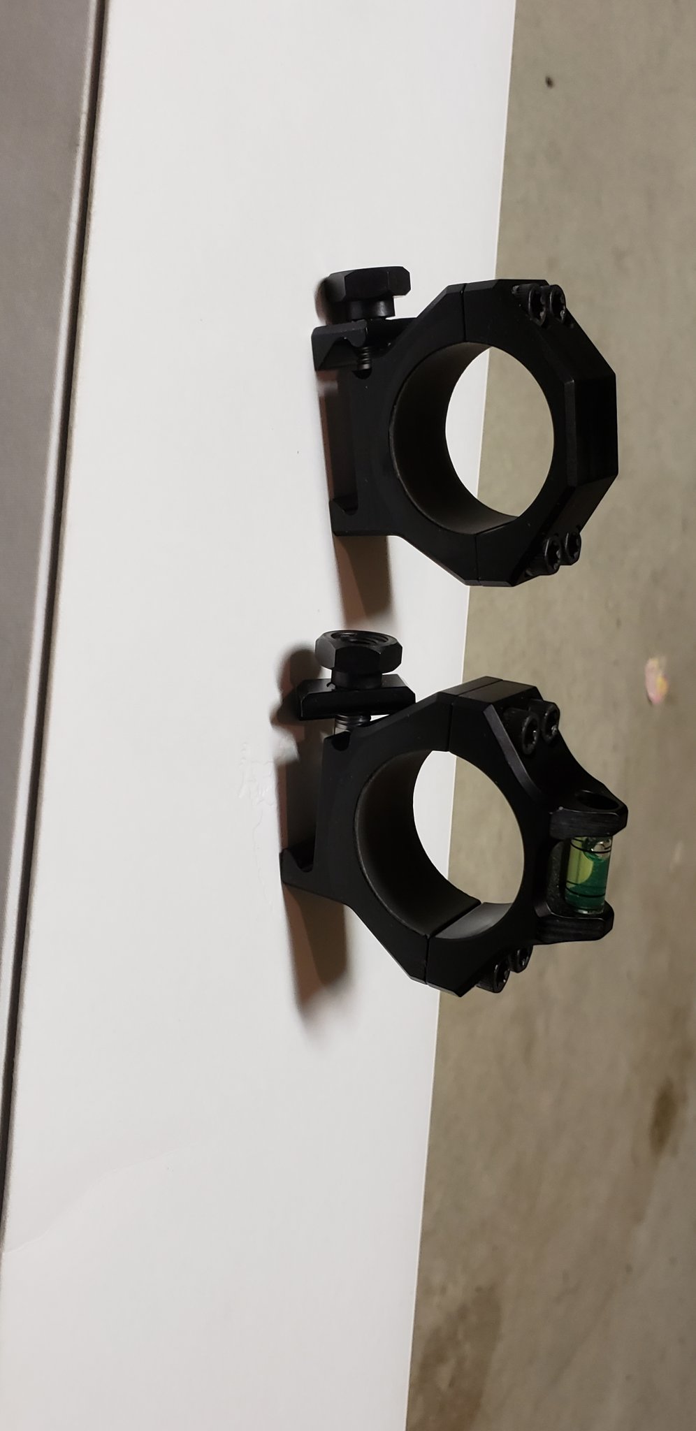

Sold a scope that had rings bedded to it by my builder. Any idea how I remove bedding so I'm not wasting the rings?
No idea what compound was used as bedding.
Hawkins ultralight rings. Pic of bedding attached.
I would first try sharpened popsicle sticks if the material is soft enough.
Sharpen them on one side only like a chisel and they work without scratching things.
Next level up would be sharp plastic scrapers
Reactions: prwillard2

When I bed scope rings I put release agent on both the scope and the rings. I can't imagine a smith did not do this. They ought to pop right out with a brass pick.
Crappy rings need to be lapped straight. Ok rings can be bedded. Precision CNC rings are usually GTG, but some people like to bed them anyway.
These are Hawkins rings
