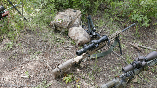

We are tall target testing on paper, not steel... measuring the movement same as you. When we return to zero, and it's 1.5" off where we started we don't need calipers to see we have a problem.
we are also across the course shooters, attacking targets from alternate positions, not in the prone, not using $1000 front rests. We engage targets off tripods, we shoot moving targets, we shoot unknown and odd distance targets so tracking matters to us too. Engaging at a 833 yards needing a 1st round hits means we don't have convertible sighters to fall back on.
Lastly,
Cause you are so superior, we haul our own gear. We carry it on our backs and not wheel it to a line 25 yards from our car. I walked 10.6 Miles last week at the Sniper's Hide Team Challenge. (with a 9year old ) We don't call time out in the rain, we fall down, we bang our gear around. We shoot angles, not flat line distances, we even transition to support side shooting because you can't take the shot right handed. Because we are timing things a 2oz trigger does not work. Drop your rifle on the butt, it will fire, not mine. I did it at Shot with Bix & Andy triggers, when it released he said, "oh you know that" ... of course we do. SH_HD_AICoville-1.jpg
19400282_1383351781719151_8870929637090170179_o.jpg?oh=1bfe5fe64d263ac42eaa6718f29a9338&oe=59C...jpg
Different disciplines require different ways of attacking the problem. My scope adjusts .36 not .18, if the variation is inside .36 do I care, not if the dope says 7.08 mils I can only dial 7.0 or 7.1 I cannot adjust a fraction of the whole mil.
Take you out of your comfort zone and most of you fall apart because you have no fundamentals. Zero follow through because the majority are using free recoil.
