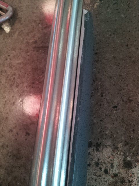

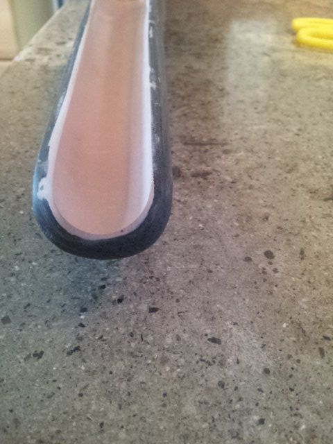

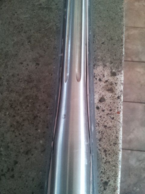

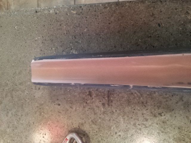

I dont know if this has been covered, but here is my take on how to "clean" up the reveal between your barrel and stock
I recently rechambered a gun with a smaller contour barrel and I had a large, uneven gap between the barrel and the stock. I know this is only aesthetic, but I like my guns shooting and looking good.
I simply got some 20 mil tape and put 2 layers lengthwise on the bottom half of the barrel
http://www.amazon.com/Orbit-Sprinkl...F8&qid=1395623125&sr=1-1&keywords=20+mil+tape
Next I got some Walmart bondo, mixed it applied generously to my stock channel.
I then put my barreled action in the stock and tightened it down.....30 minutes later and a little cleanup and it is ready for paint.
What you have when you're done is a perfectly free floated barrel with a very even reveal
I thought this would be useful for someone.
