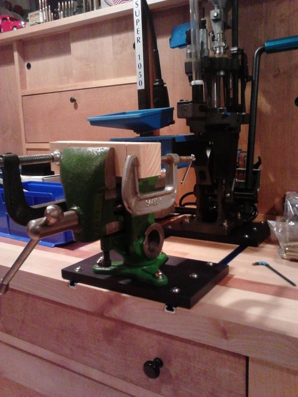

I bought this one from Brownells
https://www.brownells.com/gunsmith-t...--prod361.aspx
Made in USA. Nice that Brownells has just about every type of jaw material you may need in a one stop shop.
Mounted it on an aluminum plate that will secure to T tracks on my workbench. When I want to use it I put it on my bench. when I don't want to use it it goes in a box out of the way.
Love to say I do a lot of gunwork with it but so far its most useful employment has been building Pinewood Derby cars.
Add edit......
Hmmm just read the reviews on that Brownells vice and they don't look very good.
I bought my vice probably about 4 years ago, perhaps they have a different vendor now. Hope they have corrected base don the negative reviews.
Here's the USA company that assembles the vise. I wouldn't say manufacture, as parts are sourced "globally". A copy of the original which can still be found on eBay and Craigslist. A lot less expensive than the Brownells version.
