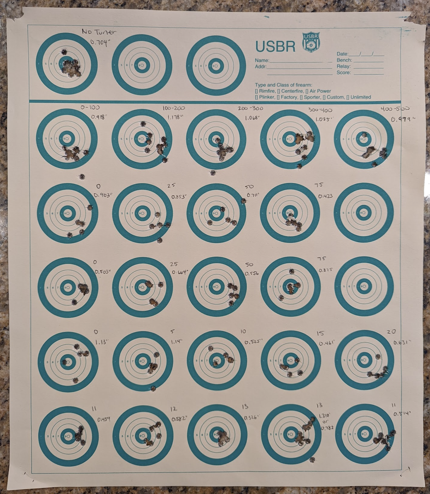

So maybe it wasn't worth the time or ammo to play with the tuner since it already is shooting well, nor do it during a windy day, but why not get out and shoot some. This was just shot in prone with a bipod and rear bag.

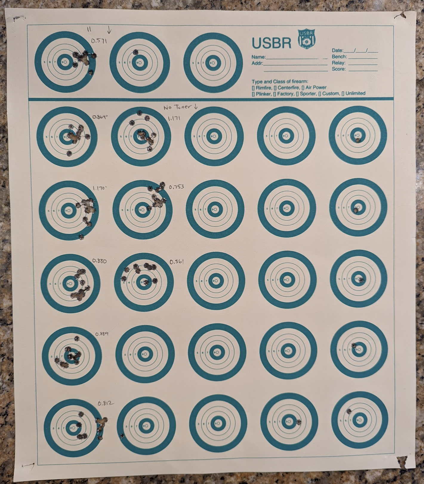

Started out with a control group which went really well with no tuner. Then did the Hopewell method of 2 shots at 0, 25, 50, 75, 100. and repeat for 100-200, etc. I settled with liking my 0-100 group the most, so then did 2 5 shot groups at 0, 25, 50, 75. It felt like either my 0 group or my 75 group was the most consistent, so I decided to go with 0.
Then I tested 0, 5, 10, 15, 20. And settled on somewhere between 10 and 15, so I went 11, 12, 13. I saw a killer 13, so I started doing 10 shot groups. I did 10 at 13 that I didn't like so I did another 10 shots at setting 11 which I liked.
I then went back and forth between setting 11 on the Tuner, and taking off the Tuner.
Left column was with the Tuner at 11 setting, and the 2nd column was no tuner. So between the two it's a wash for me.
I then went to 50yds to see how it compared and my 50yd groups were tighter with the tuner on, so I decided to leave it on.
My friend was there as well and went through the entire process. We have identical rigs -
Vudoo 360, Benchmark 22". His in a MDT, mine in an XLR. Both with ZCOs.

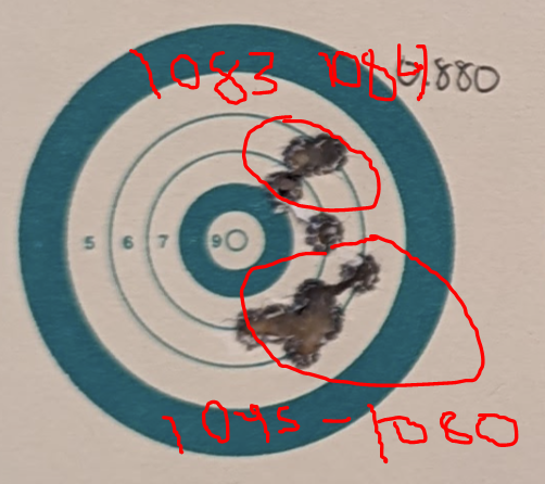

What's interesting is through his exact process of doing the same tuning, he ended up with 11 as well as his setting. Versus his control groups, the tuner definitely shrunk the groups down quite a bit. His barrel/ammo is a bit slower than mine though.

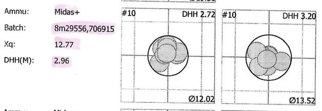

My Midas+ avg is 1072, with it going anywhere from 1050 to 1084. It feels like all the rounds in the 1053 to 1081 range group really well together, but but whenever I shot like a 1083/1084 it tended to jump up significantly more.
My friend was shooting Center-X with an avg velocity of 1046. So he was going from 1030 to 1061.
Ideally I'd put this in a 1 piece BR rig in a wind tunnel, but I have neither so it is what it is. Ended up shooting about 300 rounds in prone, zero fte's or ftf's so that's good.

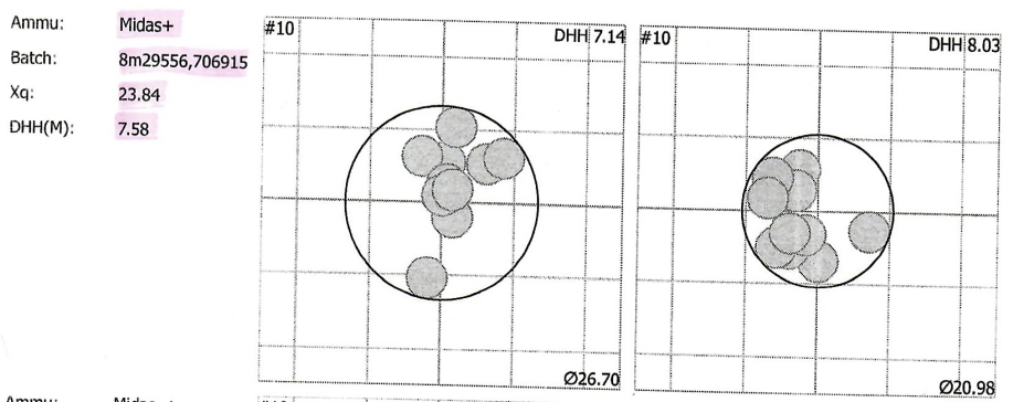

My interest is based on the fact that I am diligently trying to establish baseline expectations for various grades of ammo that I have available to me. This involves settling on methodology and criteria for comparison. Whenever someone like you shares their data from the Lapua Center I like to compare because the center possibly represents near ideal conditions.
So by comparison, I am currently shooting a case of SK RM, outdoors,50yds, temps -8 to 4 C, often little or no wind, Vudoo w/22 inch ACE barrel, and a pretty solid tune on the Harrell. Since Feb28 I have shot 35 8x5s that I generate 40 shot composite groups from.
My outside to outside average 21.2 mm, ranging from 17.3 to 25.4 mm.
Good luck in your upcoming competition.
Thank you.
Thanks!
Here's the info from my 50m test in the ideal Lapua conditions - these are Edge to Edge, so subtract the .221" from it.
My own personal 6x5's are usually around .25" to .275" c-c but those are 5 shot groups, not 10 shot groups.
As a general yardstick, in a good barrel a very good lot of ammo can produce ten shot groups at 50 that are no more, or less, than 12mm outside-to-outside (or .250ish" center-to-center) on a regular or consistent basis.
Ammo that regularly gives 13mm oto ten shot groups (.300ish" ctc) is a good lot. Anything over 15mm oto (about .370ish") is not.
That's what Lapua said, that their best results they get are 12-13mm. Out of all my testing I only saw 2 results of 12 & 13, the majority of the tests are 15-18mm (outside to outside) for the 10 shot groups.
So either the ammo isn't very good, or Vudoo repeaters aren't that competitive. I've harvested a bunch of results from the past 2 years of testing at Lapua from different rifles, and so far my Vudoo repeater getting the 12mm and 13mm has been pretty good, which I guess is around average for people running custom Turbo / BR rigs. In the world of repeaters though, custom CZs, 10/22's, Vudoo's, and RimX's, the results have usually been around the 15-18mm 10 shot groups.
My 24” Shilen best tune was at setting 157 Via the Hopewell method. The Purdy solution had it at 153. I don’t have an opinion, only offering my results.
Jadams
What did you get as a final physical length? Also, now all I can do now is measure and compare tuners, too much wind to get out and test but, I have a theory., After parting with a great shooting benchrest specific rifle and looking at tuner designs, that the Harrell's tuner is not ideally suited to shorter barrels. I say that because, I think the inner tube is too close to the outer tube at lower settings unless a weight ring is added. When I set my Harrell's at 153, the inner ring is protruding slightly past the outer ring which I'm guessing could reduce the tuner's effect. Orkan has an excellent video shooting a 26" barrel with a Harrel's and light (1") weight ring which brings the outer shell out where I believe it needs to be. I won't know until I try them out, but from other postings I have seen, I think a ProX which has bushings designed for barrel lengths in increments from just over 15 to 27 plus inches may be better suited to shorter barrels. Anyone having thoughts on this "inner ring" theory please weigh in.

I think the one picture with the 22S in it is from another thread. I don't own a 22S but I posted a picture of a person who was doing testing with their Holeshot tuner in a wind tunnel, where they're getting like .35" groups at 100y, but that's also in a nice benchrest rig.
I don't have any wind tunnels avail to me so it's guess the best weather day and go. I'm also shooting from prone, bipod and bag with a 27x scope. A few diff factors, but I think my tune setting though is pretty good. I'll probably re-tune it at 50y and see if there's any difference.
If there's only 1 tune (9th harmonic) then 50 and 100 should be the same tune setting. I think the whole positive compensation thing has a max, I don't think you can just compensate an ES of 60. For me, my rifle seems to shoot really well at the 1045-1080 velocity, but once it goes above 1080 there's a pretty big deviation. Like 1045-1080 can stack together, and 1085 will have a 1/3" jump.
Reactions: 6.5SH
I agree with what you are saying and velocity. With SK Standard+ I've taken to trying to keep the ammo temp in the range I tuned at; around 90 degrees.
In colder months I've been using a USB chargeable hand warmer, in hotter a blue ice pack in a separate compartment under the ammo/mags.
All of this is inside a soft sided insulated lunch pack I got at wallyworld.
