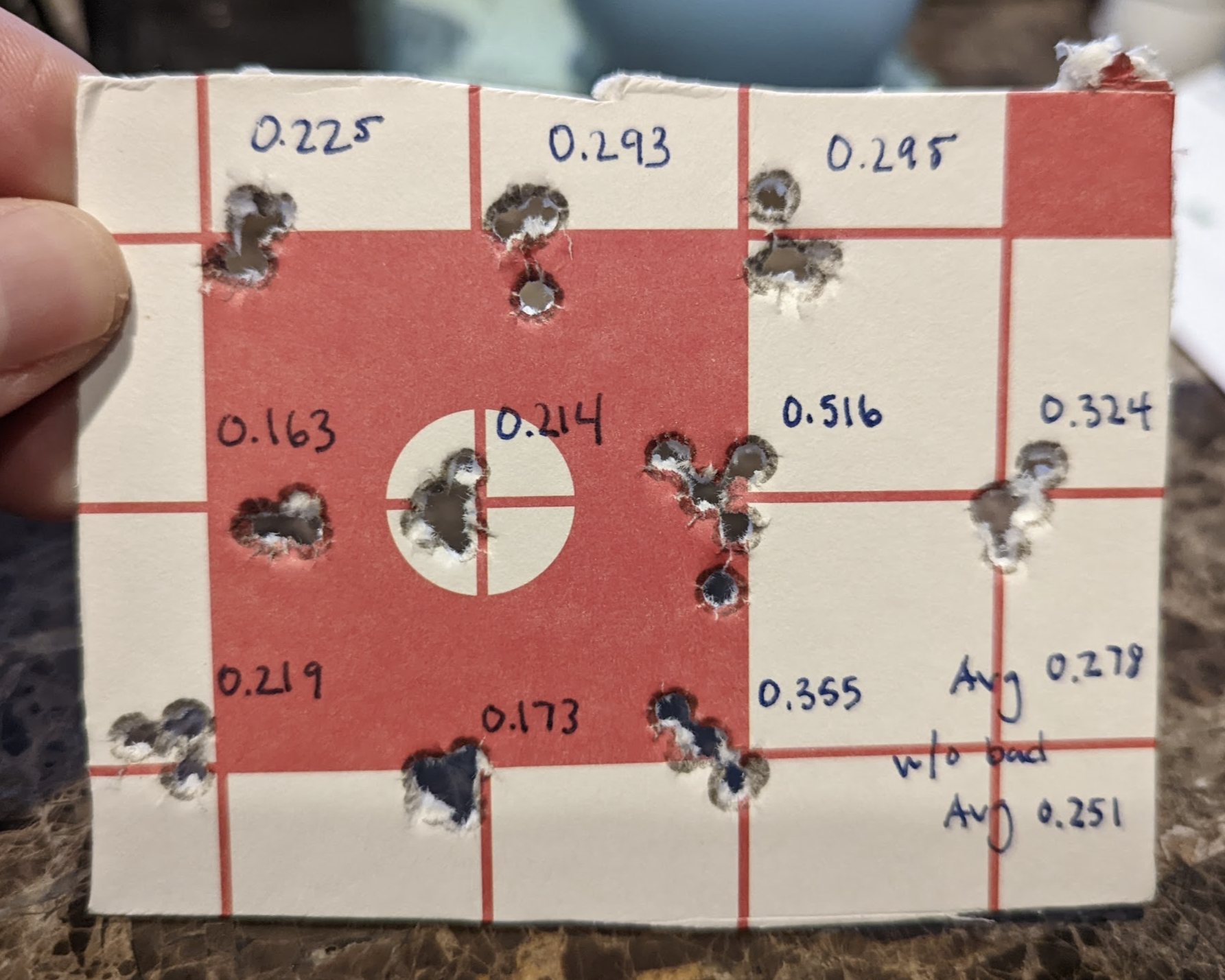

Okay, I got some time to actually do the real measurements for Purdy - https://www.rimfirecentral.com/forums/showthread.php?t=544427
Stuck a rod down my muzzle hitting my bolt, subtracted headspace etc...
Muzzle to Bolt21.9375
Headspace (Assumed)0.043
Barrel Length (Muzzle to Bolt - Headspace21.8945
End Correction (Inner tuner diamter * .3)0.1905
Quarter Wave = Barrel Length / 82.7368125
Acoustic Length = QW * 924.6313125
Physical Length = Acoustic Length - EC24.4408125
Rod Length = Physical Length + Headspace24.4838125
So I then taped a little piece of tape on my cleaning rod at the Rod Length measurement above.
So yeh I'm really close to the setting. I'll do some more in depth tuning from like setting 10-20. Right now my tuner is at 11 and I also found 13 to be really good.

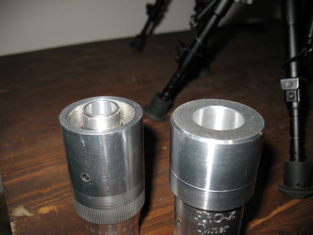

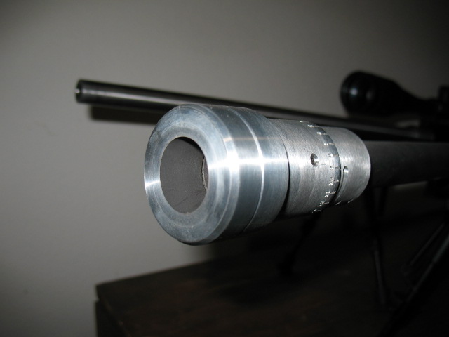

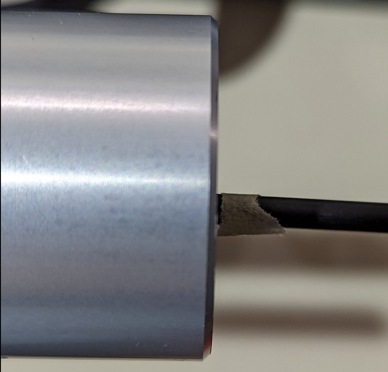

Here is something to consider. The 2 tuners shown without inner tubes extending are both Purdy RX tuners, the JNL Chacon tuner on the rifle, the other is the is a CST SFP Pro X tuner. The Pro X has a 1" bushing for a 24" barrel, the JNL preset by Joe for a 20" Kidd Barrel. I have a 1/2" bushing to try on my 19.75" GM barrel. I believe the reason the Purdy prescription may not be working well is, I believe it is based on tuners with an inner tube some distance from the outer. Orkan's success with the Harrell's I think is due to his addition of a 1" extension which brings the design more in line with Tonys formula. The Harrell's set at low numbers does not allow the outer section to function. The outer tube subtracts the second EC in the equation. Just a thought. When I finally get around to being able to try these out, I may put the Harrel's on but, will probably wait until I have my 26" barrel finished and will use the light, 1" extension. Interestingly, I looked at info on the Ezell tuner which has a protruding inner tube and Mike indicates these are cut to lengths to correspond with Purdy RX for specific barrel lengths. As I mentioned before, when I checked the setting on my JNL tuner using the very precise calculations on the ProX website, the number was within 2 of what Joe had set for my 20" barrel and it works.
I agree with your analysis. Bottom line. If you use a Harrels design tuner, the Purdy method may or may not work. You're better off going with a tuner designed for that tunning method.
Does Purdy ever say that Harrell tuners may or may not work with his "method"?
I've never known him to make such a statement. He even uses some of Harrels tube measurments for illustrations. When Purdy first developed his tunning method there weren't a lot of tuner options available. Harrels was pretty much it. It simply does not have enough linear adj. to tune some length barrels to the 9th. Now we have tuners designed for his tunning method. I could go on and on with tuners. I've spent hours and hours and countless rounds of Eley10x ammo playing with tuners. Just when I think I know what I'm doing, I find out I really don't. I guarantee you half the people on this website that think they have their barrels tuned. REALLY DON'T!
Reactions: todde and Williwaw

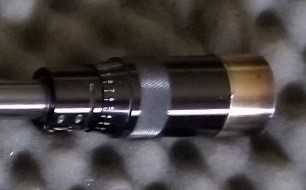

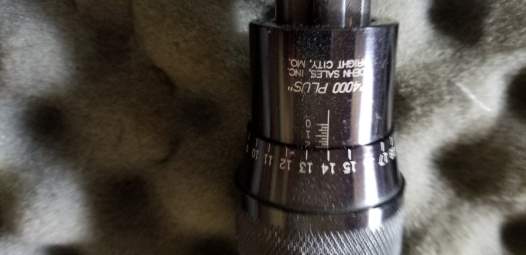

This is the only picture I could find of the tuner that was on the benchrest rifle I had. What I remember from the muzzle end, it had no protruding inner tube like the Harrell's, much more like the ProX and JNL which are basically the same from what I can see.
To get some precise info on tuning these 2, I recommend going to http://cstmtech.com/sfp-prox-tuners. The number I got using the info provided gave me the same ( +-1) number that Joe set on the JNL tuner for my 20" barrel.
I have a 1" "bushing" for my 24" barrel, 1/2" for the 19.75. I don't know which was the first, CST introduced their tuner in 2014. Their page on the website is quite informative and the directions for tuner setup very precise i.e. for a 24" barrel, you use the 1" extension, which is for barrels 22.424" to 25.624", and use the formula 24-22.424=1.576/8=.197 which is the micrometer setting. The only problem with the ProX is, they only provide it in .75" so you need to get it machined to your barrel diameter, KSS will do that for you as will Joe.. I believe the setting formula for the ProX will work with the JNL.

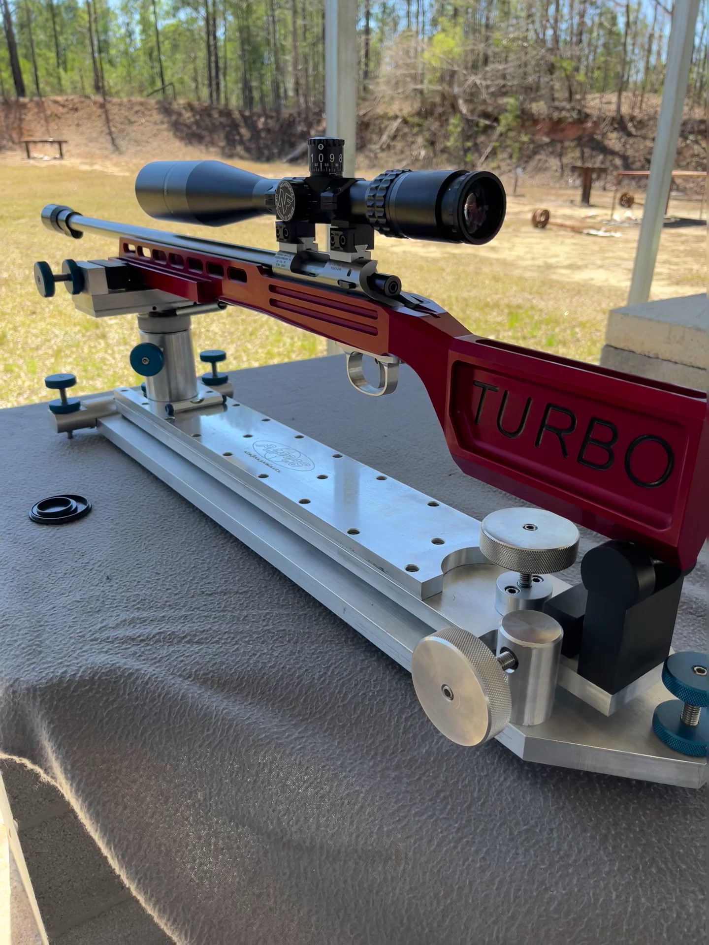

The gun that I'm currently competing with at 200yds is a Diorio V3 Turbo. Shilen ratchet, Bix trigger, Nightforce 12x55. Diorio tuner which is basically a modified Harrels. I shoot off a Pappas one piece and sometimes a Seb Neo. The barrel is weight tuned using my own tunning procedure which is a modified Hopewell.
Thanks! Did you tune at 200? Or did you notice that the tune you found was universally good at all distances?

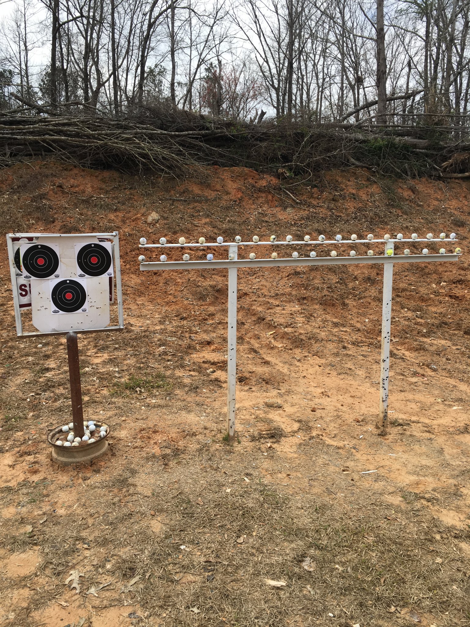

I tune at 50 and let it ride. If I had access to a 100 or 200yd indoor range I might give it a try, but I don't. I've said this before. It's impossible to tune a 22lr outdoors at 200yds! !00yds outdoors? Maby with the right conditions .but it would still be very difficult. My statements are based on my own shooting experience. I have been shooting a 200yd golf ball match for over 5 years. We shoot all 12 months no matter what conditions. 10 sight in shots 10 shots for score. I've put a lot of 10x and Midas+ down range. In five years I've never shot clean! 8 out of 10 is my best. Actually no on has ever shot 10 for 10. A 22lr is simply unpredictable past 100. no matter what gun what ammo or what tune.
I tune at 50 and let it ride. If I had access to a 100 or 200yd indoor range I might give it a try, but I don't. I've said this before. It's impossible to tune a 22lr outdoors at 200yds! !00yds outdoors? Maby with the right conditions .but it would still be very difficult. My statements are base on my own shooting experience. I have been shooting a 200yd golf ball match for over 5 years. We shoot all 12 months no matter what conditions. 10 sight in shots 10 shots for score. I've put a lot of 10x and Midas+ down range. In five years I've never shot clean! 8 out of 10 is my best. Actually no on has ever shot 10 for 10. A 22lr is simply unpredictable past 100. no matter what gun what ammo or what tune.
Yeh I believe you! Outdoors golfball is really hard... I have tried it a few times, and while you might get on a streak of 4, I think the best I've done is like 6-8 out of 10 shots for golfball, and I also have a backing that lets me spot my misses easily to make corrections.

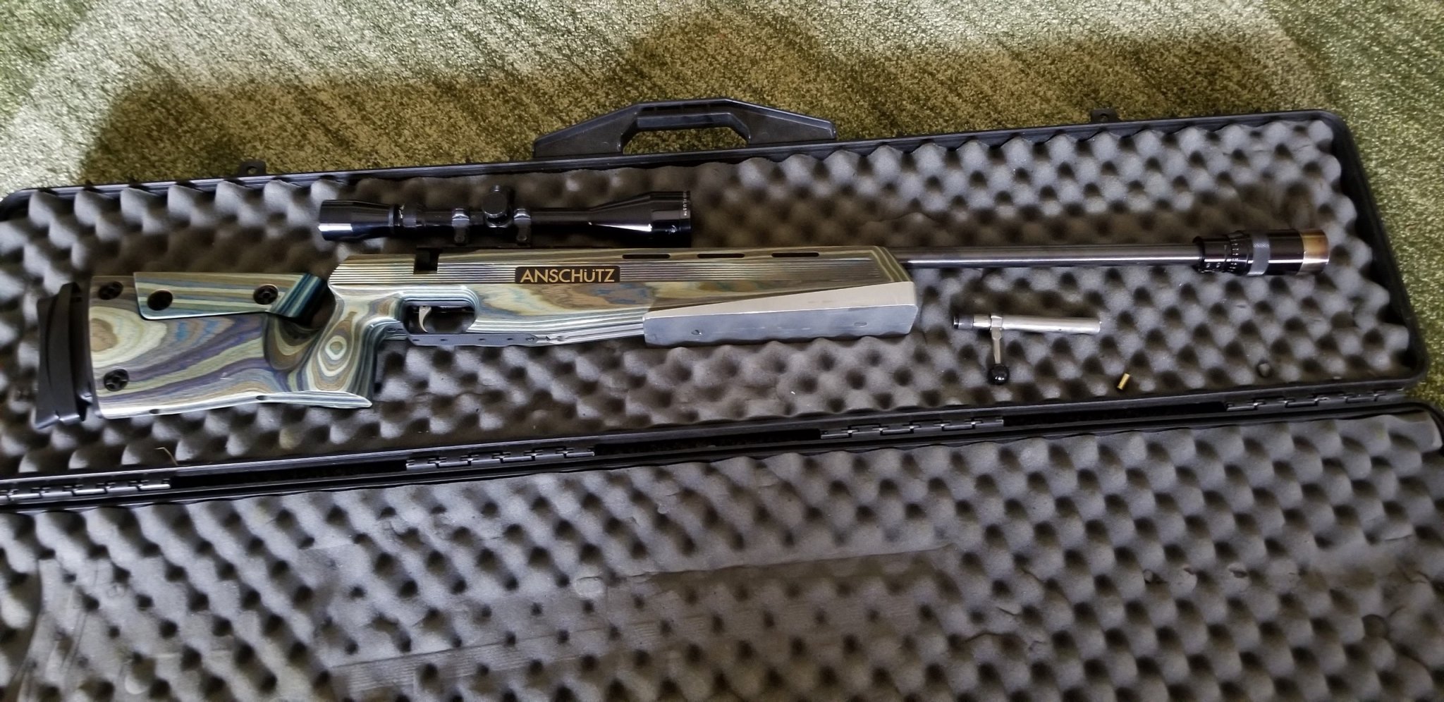

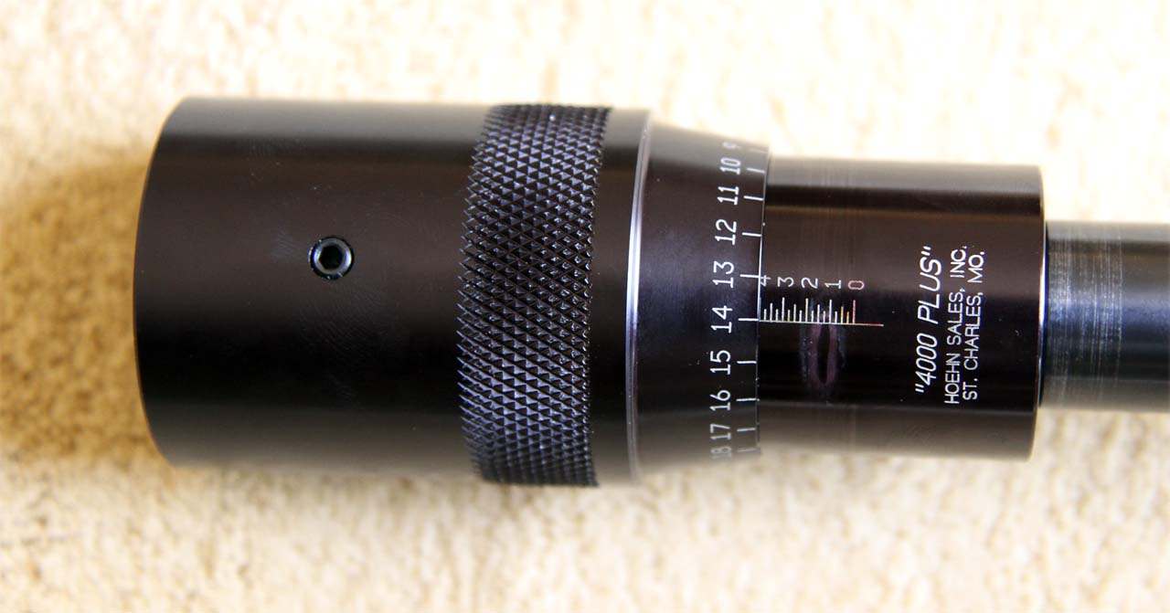

I need to mess with the numbers and see how this corresponds to the PRX tuners. BTW, rifle was a thing of beauty. Part of a number of rifles built by an old shooter who apparently developed Alzheimers. He took what looked like a german barrel (from the markings) a Vostok action which he apparently cut and sleeved on a beautiful Anschutz cadet stock. He built an aluminum (plank) to go in the forearm groove for the front rest. It was a great shooter, just didn't fit me. The young fella who has it was able to shoot it in a match and won. It got a good home.. Looking at the full picture, I see that it looks like about a 1" weight on the front.

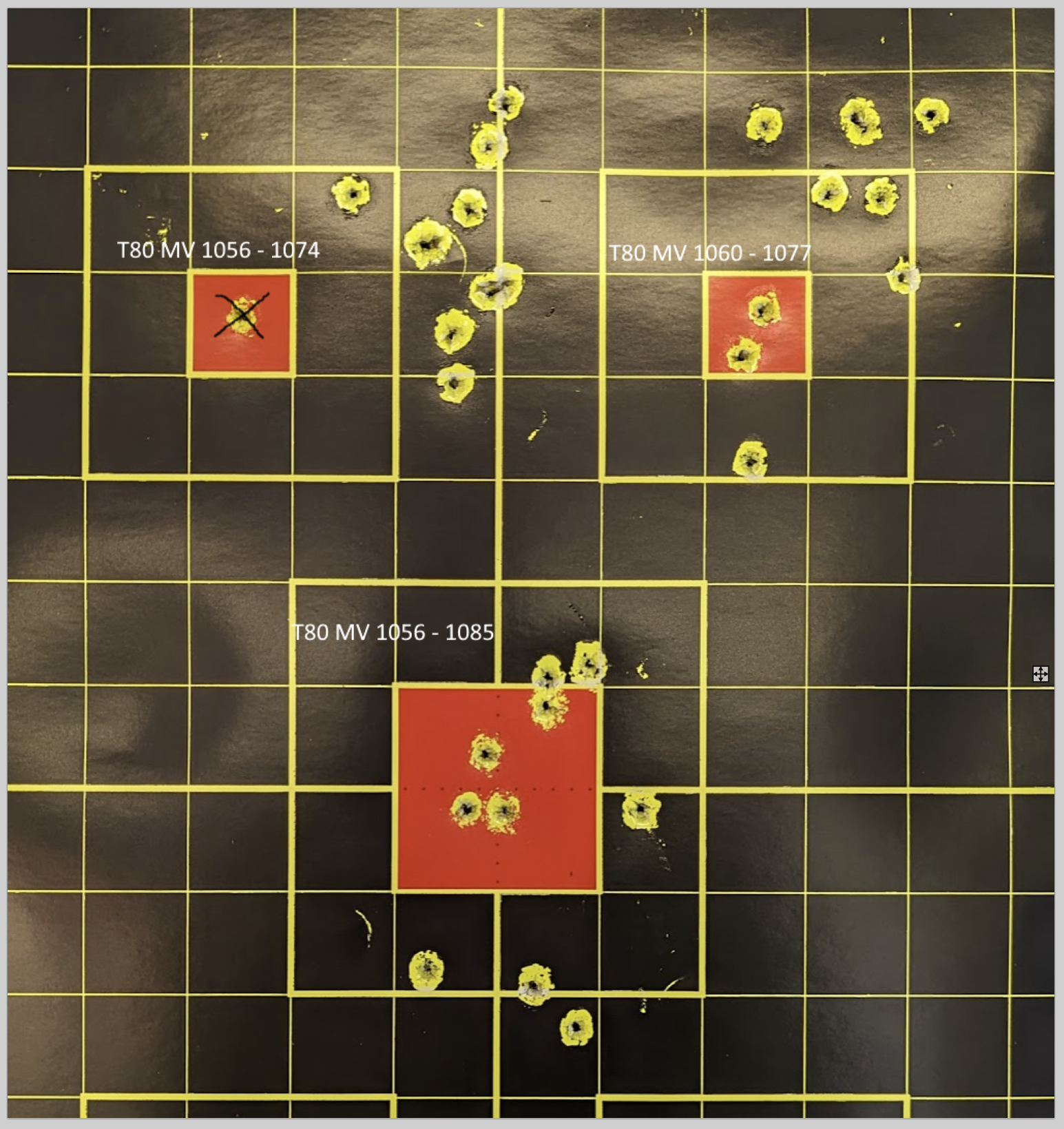

Went out today to try tuning at 50, it was a calm day with only 3mph winds and tuning at 50 versus 100 to see how the tuning nodes would be. I dialed .4mils down from the center so I could have a consistent aiming spot.
Last time I ended up with a tune setting of 11, and also I had a possible good node in the 75 bracket, so I should test 65-85 to see. I also chrono'd every round I fired to see if the group was really being tuned well or if it was just a good ES/SD group, so every time 10 shot group I could see the ES range and how it affected the group sizes.
Here's 50 yards, all 10 shot groups. T is the tuner setting, then the MV velocity range. I started at 11, then I tried 13 and it did not look good. Then I did 65, 70, 75, 80, 85. And it looked like between 75-85 the groups handled the wide 30 ES pretty well. Tuner 70 looked pretty good, but the ES for those 10 rounds was only 14. I then tweaked between 79 and 81, and landed on either 79, 80, but I have it set to 80 right now.
I shot my friend's CX, which averages an SD of 7 and an ES of 24 and it was amazing. My Midas+ is generally an SD of 9 and an ES of 33, but it does have the occasional swings, like an ES of 48 (1043 to 1091!)...
At 200 yards it's hard to tell if the tuning is doing much at all... ES seems to dictate most of the group size. I don't think tuning could make it worse, but for some of the strings being only an ES of 17-18, I expected more in the 2" group size

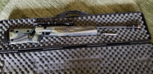

Got a pleasant surprise the other day. I have a chassis sitting idle and since I ordered some Vudoo mags to try with the Rimx, decided to pull the trigger on a Vudoo action. I was quoted a 4-6 week wait but, 2 days after placing the order was told it had been shipped. I have a GM barrel, that after initial problems, had rechambered to 52D. I had Dave Manson cut one of his Bentz reamers for me since other than the leade and length, the dimensions were the same.. The 52D has a lot of engraving which goes against most "conventional wisdom" however it shot extremely well. Dave's Bentz is definitely tighter than published Bentz specs, .227 taper to .2255 and at 50 bucks, a good buy. Since the Bentz chamber is .090 longer than the 52D, I decided to have JElrod rechamber the barrel again to reduce land engagement and see how it shot before doing another barrel. Land engagement is .050 so it is a good range according to Kevin Nevius' recommendation. .030 for Lapua and .090 for Eley..
I just got in from initial testing. I needed to check the scope after swapping barrels and really wanted to wait since the wind is gusting at 20-25. I shot at just over 40 yds and initial group was .19". It shot well with the 52D chamber, but as expected, this is better. I am now comfortable going with the Manson Bentz chamber with the 26" ratchet Vudoo. This will give me another test bed to be able to do the Pro-X/Harrell's comparison. When/if it calms down, I'll do some bare barrel and tuner testing with the GM and then the 24" Shilen. The GM barrel ended up at 19.75". Who knows, maybe this will be a "magic" length and all the planets, harmonics, and weight thingies will fall into alignment. :)
It will be interesting to see how it "tunes". The Pro-X with 1/2" bushing puts it in a good range. I just need to put up a bunch of non-tuner targets to settle on a lot/type of ammo and then do some tuner testing.

The good news is, I just heard from Jelrod and he has finished my 26" Shilen ratchet Vudoo which I had him chamber with an Eley Ultimate EPS reamer PTG had in stock. I chose this since I will be primarily shooting ELEY and saw a recommendation from Calfee that with current barrels being close in tolerance to use his #2 reamer which is a straight no taper .225", the same specifications as the Eley Ultimate. Taking that recommendation plus Kevin Nevius recommending .090 land engagement and 2 degrees for Eley.
Since I chambered my Rimx Shilen with the Bentz, which is close to Kevin's recoimmendation for Lapua with a 1 1/2 degree leade and .030engagement, I will be able to make some comparisons using various types of ammo I have stocked up. At some point, I'll put the 19.75" barrel back on and see how the tuner works. Unfortunately, initial comparisons look like it may have shot better with the 52D chamber which was a Manson Bentz I had cut back to 52D specs.. I won't be able to do a Harrell's/PRX comparison. I had to send the Harrel's back (again} to be recut since my .850 barrel mealsured .860". What I may do, is try the Harrell's with and without the 1" outer tube extension. Externally, it looks a lot like the Hoehn with the extension added.
Now, all I need is an extended break in the weather.
Looks like my chamber search may be over. I just got this test group from Jonathan. 26" Shilen ratchet with Eley Tenex PTG Ultimate EPS Reamer Vudoo action. The chamber has the same specs as the Calfee 2 (.220 no taper) which he says is the one to use with current barrel dimensions. It will be interesting to see how it does with the tuner. I have it set up to start with the number Orkan provided with the Harrell's and 1" weight. I have an assortment of Eley and SK to test with. I have another Shilen with a 1.5 degree leade I chambered since Kevin Nevius recommends this for Lapua on the Rimx that I'll probably let go and use the EPS reamer on my last Shilen to go on the Rimx. I need to do some shooting with it first as well as the GM I have inbound with Eachus chamber.
It's nice to have a gunsmith who takes the time to verify his work and not just machine a blank and send it out.

OK I’m confused. My Vudoo v22s has a muller 26” barrel w/.044 head space & 11^ crown. I use a Harrell without any added spacers. It’s set at .167 for now. My question is what is the Purdy length I need to be at and which spacer to add to get there, also Aluminum or Steel?
After so much discussion of pros and cons and the different numbers I have come up with comparing Purdy formula and the lengths I have observed measuring Purdy formula based tuners, JNL-PRX and SFP Pro X, I decided to try something different. The Pro X gives very specific settings for different barrel lengths and the pre-set PRX I have corresponded with these measurements however, when I did Purdy calculations, they differed a little. I have no explanation but, the set up Joe sent me and the SFP setting work. I'm not convinced I can get a good OAL calculation for the Harrells so I took a known result. If you go got post 129, you will see some actual results from a well known and respected contributor, ORKAN. This is what I based my build on, 26" barrel and when I measured my Harrell's, I saw that I needed the 1" extension to achieve the 3.553" I need to duplicate his results, I am moving and have packed my gear so I can't verify the numbers, but I think if you get the 1" aluminum extension and do the measurement and stick it on you will be very close to your desired results.
Short answer, 1" extension, stick it on, mike the tuner to 4.7553, 4.7553-1.2=3.553 and go shoot.
I had my Vudoo in reach, too long with the tuner for the case but the tuner measures 4.75" and the setting is 219.
OK I'm confused also! Why are you wanting to add weight/length to your stock Harrels? A standard Harrels will tune a 26in barrel without adding any weights or length. If you can't find a good tune then you need to look at the gun for other possible problems. As to the Purdy method. I don't use it. I've checked it against guns that were known to be in tune. Sometimes it would be close and sometimes not. But we're not playing horseshoes. Close isn't good enough. You're either in tune or out. One click on a Harrels can make a difference. One other thing. You can't tune a barrel over the internet
