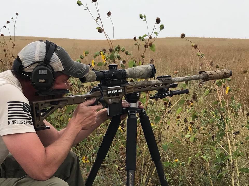

I have a RAP 223 that used AR-15 magazines in the factory stock.
I dropped the action into the Indian Creek Design MoFo chassis that uses AICS magazines rather than the chassis version that uses AR15 magazines, because I wanted the longer COAL of AICS magazines for loading heavy bullets.
I’m using the now discontinued Ruger 90458 magazines, which are the long-lipped Accurate Mags....they feed flawlessly.
If you haven’t seen it, I highly recommend checking out the Indian Creek Design MoFo chassis. It’s the only American made chassis available for Ruger Americans...it uses a modular fore-end system so you can swap out to new or different fore ends when they make them/if you want them....and the customer service at ICD is amazing. I prefer the Johnny fore end right now. It has m-lok on all 3 sides, and the bottom is a full length Arca Swiss rail. The HERO adapter allows you to run any AR15 handguard if that interests you
did you wrap your barrel?
Yeah, same stuff (tape) as the scope. I found the blued barrel started generating a mirage, just sitting in the sun. The tan colored camo of the tape helped knock that down. Some think it's some OAF shit, but really, it's just necessity being the mother of all inventions so-to-speak.

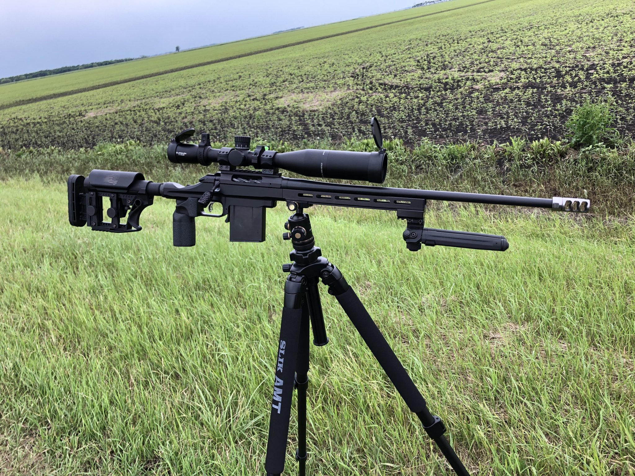

I saw that one. Torn between it and the oryx with the oryx beinga bit more inexpensive but the icd coming with the built in arca. Tough decision! Thanks for your input everybody
For me it was easy. The only thing you can change about the Oryx is the hand grip. With the ICD accepting virtually any AR15 handgrip, any buttstock that works with buffer tubes or buffer tube interfaces, and multiple styles of fore ends...the possibilities are vast and ever changing as long as AR15s are popular and companies keep making new products for them
If all I was after was AICS magazines I’d get the Magpul Hunter for $200 or just get the AICS DBM setup for the factory stock for like $30 from Ruger. I think the Oryx would’ve been more competitive at around $300 but that’s just me.
I was going to go with the boyds and their aics bottom metal but I found the oryx on sale from oplanet for 350 on labor day or something which was only 20 more than the boyds would cost for a real chassis. I wanted best value without overspending and that’s what I came to. I’m pretty pleased with it.
