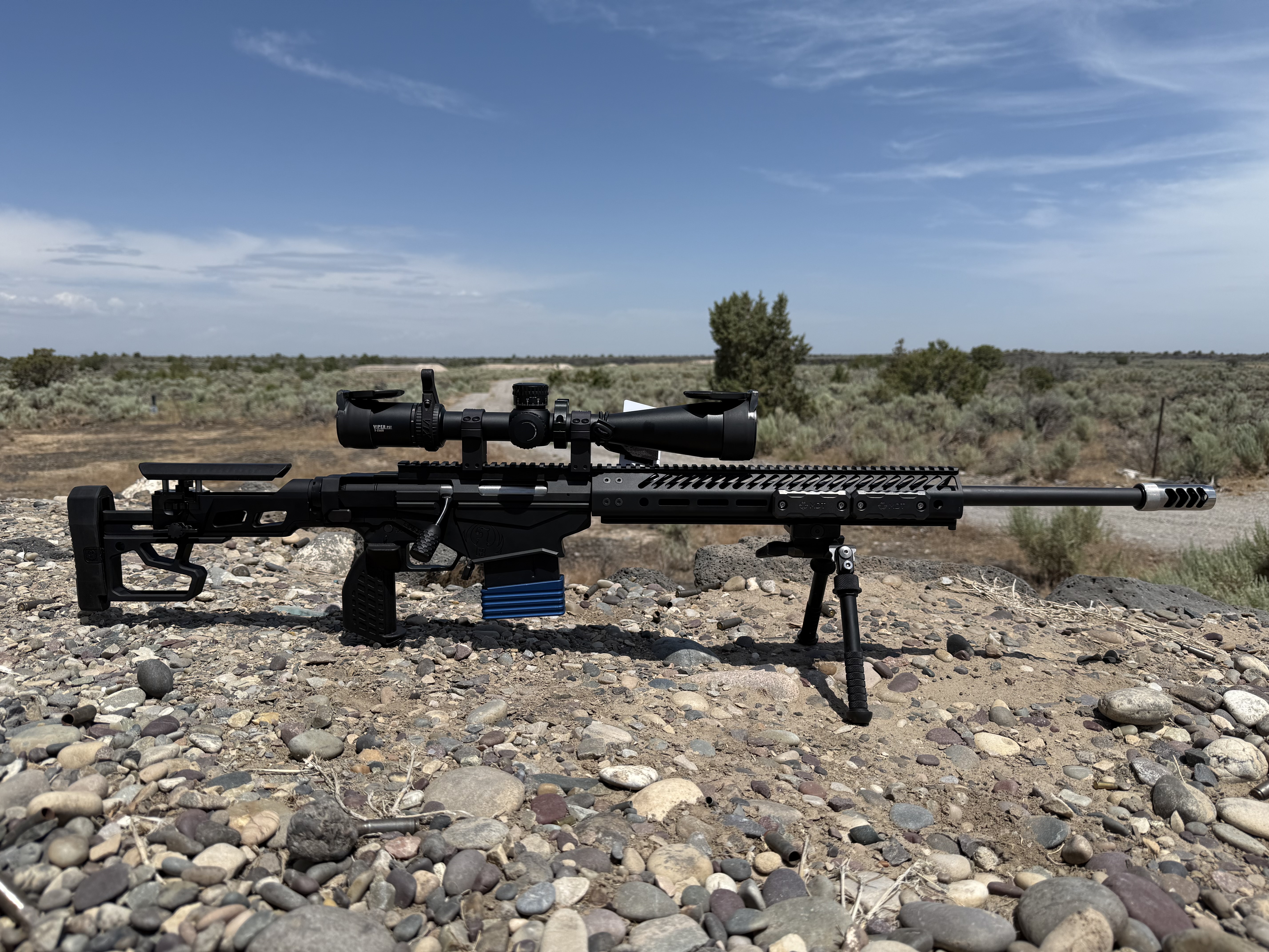

Finally getting to spend a little time with the Gen 4 butt stock. I am really enjoying it, I didn’t hate the original stock but like this one a lot more.
Anyone else have an issue with cases ejecting straight into your knuckles? I don’t remember ever having it happen but it has started lately.
