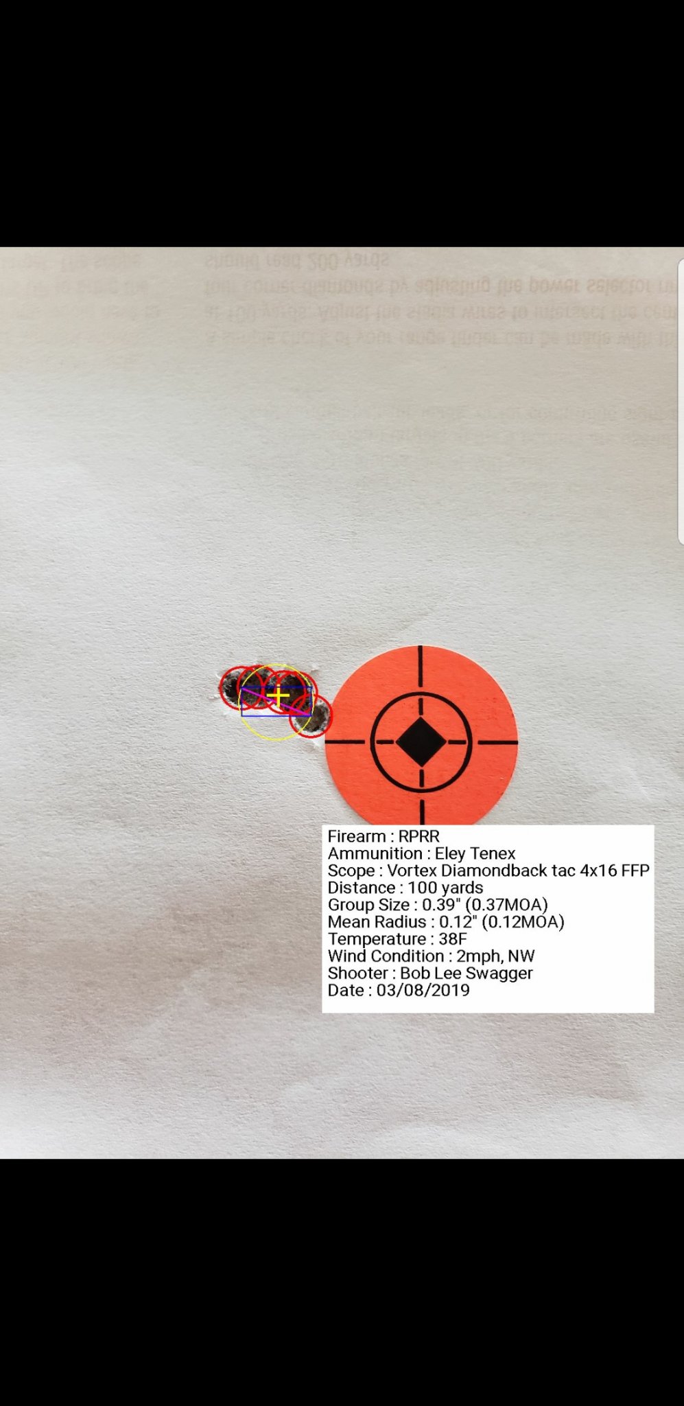

Here's a pic of the crown and a typical 10rd group. Once I get it back I'll hopefully post up better looking pictures.
Ok, it's been a while but I was finally able to get the rifle back together and out to the range. The conditions weren't the best with some wind gusts, but I did my best to work around them. Looks to be an improvement over the groups with the crappy crown. In all fairness to the rifle the last shot (farthest upper left) was the last of the 10 and there was a wind gust right as I let it off. Even with that one it shoots a bit tighter. I will probably now do the bedding trick with the aluminum tape and do a little more testing of some higher end ammo.

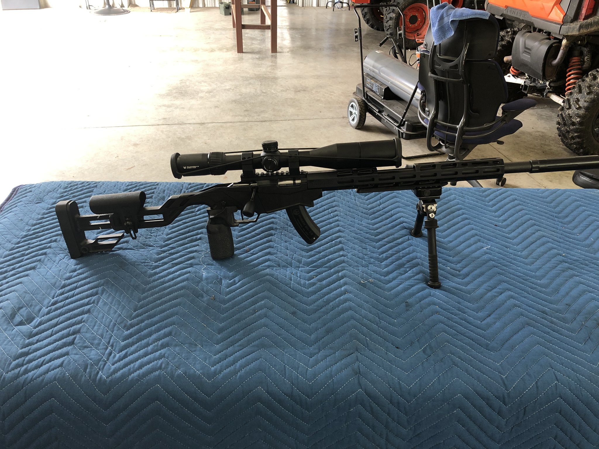

Here is mine. MOA vertical grip, mod to fit trigger guard. Hand guard cutout for scope cap clearence. Timney RPR trigger mod to fit, 15 oz. vortex diamondback tac scope. The group is 5 rounds at 50 yards.

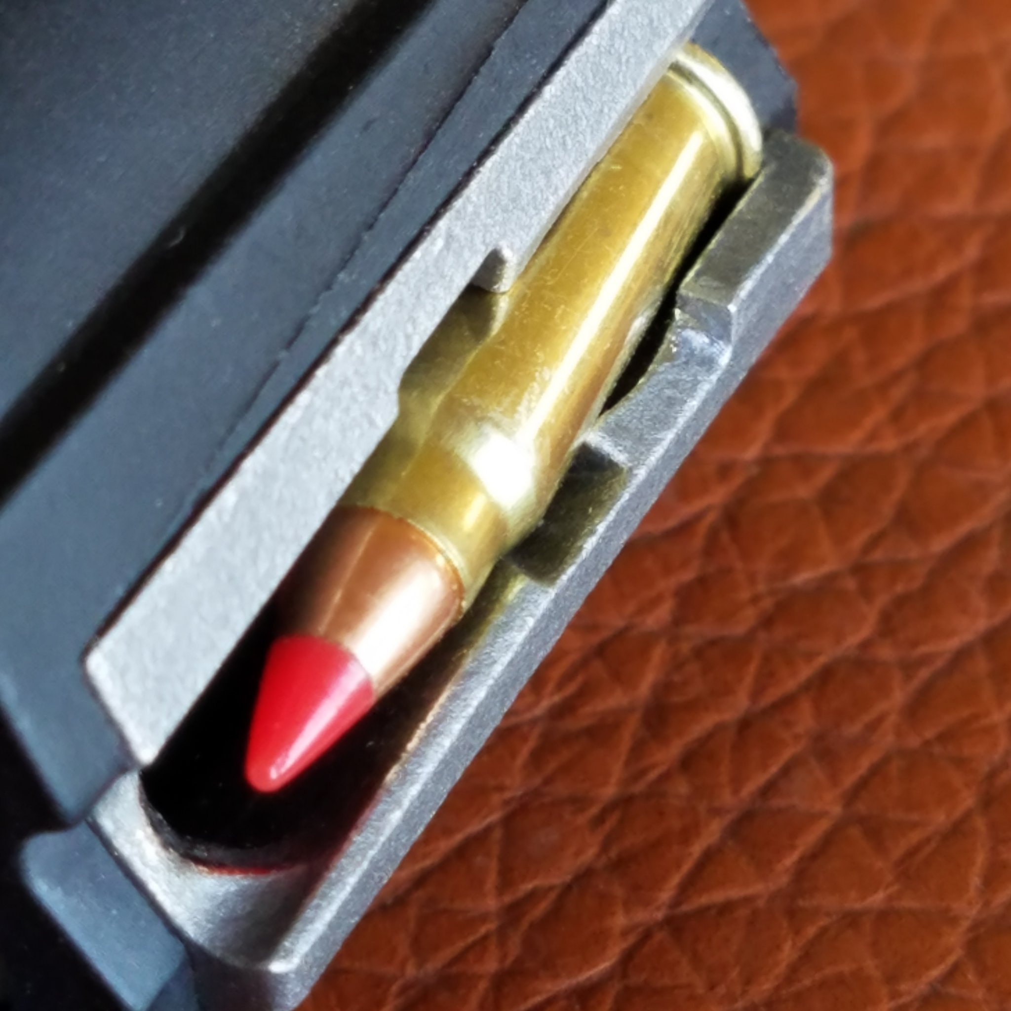

I used to have a problem with a lot of FTE's and I tried modifying the Cartridge Positioner Spring (e.g. bending it slight in towards the middle of the bolt) and that seemed to help, but it didn't really solve the problem completely. It did help in keeping the cartridge more firmly held to the bolt. Eventually I got around to taking a closer look at how the Ejector Blade was contacting the spent cartridge to get it to eject and found that it was not making good contact with the spent cartridge as the bolt slid backwards. There's just a small area there for the Ejector Blade to do so and I could see that if I could move that blade closer to the surface of the bolt, it would make better contact. So . . . I removed the Magazine Latch Assembly and took out the Ejector Blade and with some vice grips I bent it ever so slightly until it was almost touching the bolt. FINALLY! This solved my ejection problem. Though when using the short throw, the ejection is weak, but reliable. In the long throw configuration, ejection is plenty strong.
There's probably no need for a picture, as you can look into your own mag well to see how that blade is making contact with a cartridge. But I'll put one here anyway:
Are you shooting using a magazine?
Reason I ask is without a magazine installed it does use the little ejector blade to eject the case, but with a magazine in place they actually eject off of the little raised squared edged tit on the top of magazine. (case ejects well before it even reaches the ejector blade)
I have been fighting an ejection issue with mine off & on for a while now. Without a magazine it will reliably eject as it uses the guns blade ejector.
With a magazine in place it will eject without any problem with the gun sitting on my bench in my shop but at the range during usage I will usually get 1 (or more) lame ejections that leaves the brass just laying on the top of magazine.
I have been seriously thinking about modifying a magazine to remove the ejection tit so the spent case travels all the way back to, then uses the guns blade ejector to eject. (anybody else tried this yet?)
I haven't really looked at it with the magazine in place. I'll take a closer look at that and see if I can improve the ejection on the short stroke, as it's still a little weak . . . though reliable.

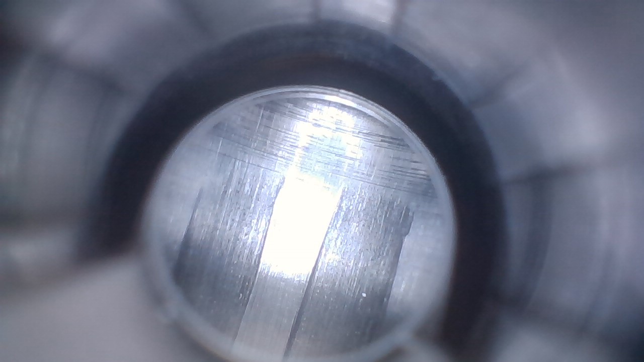

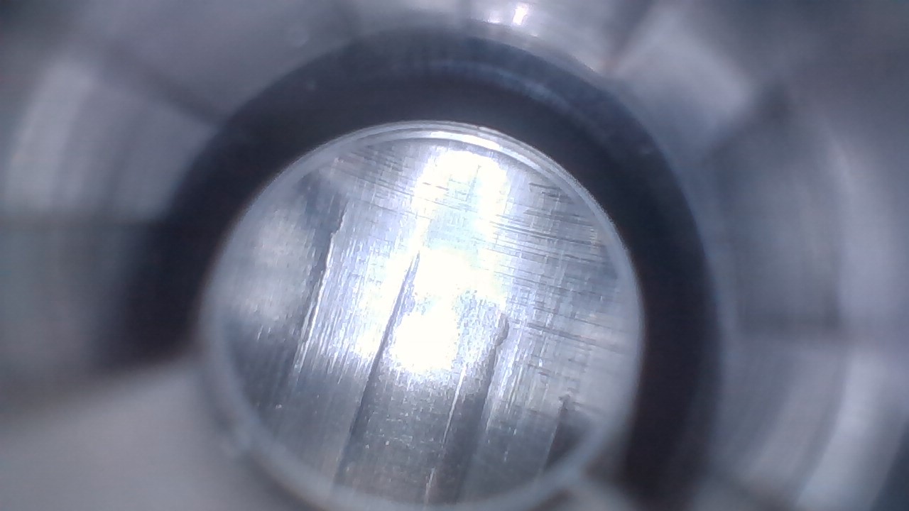

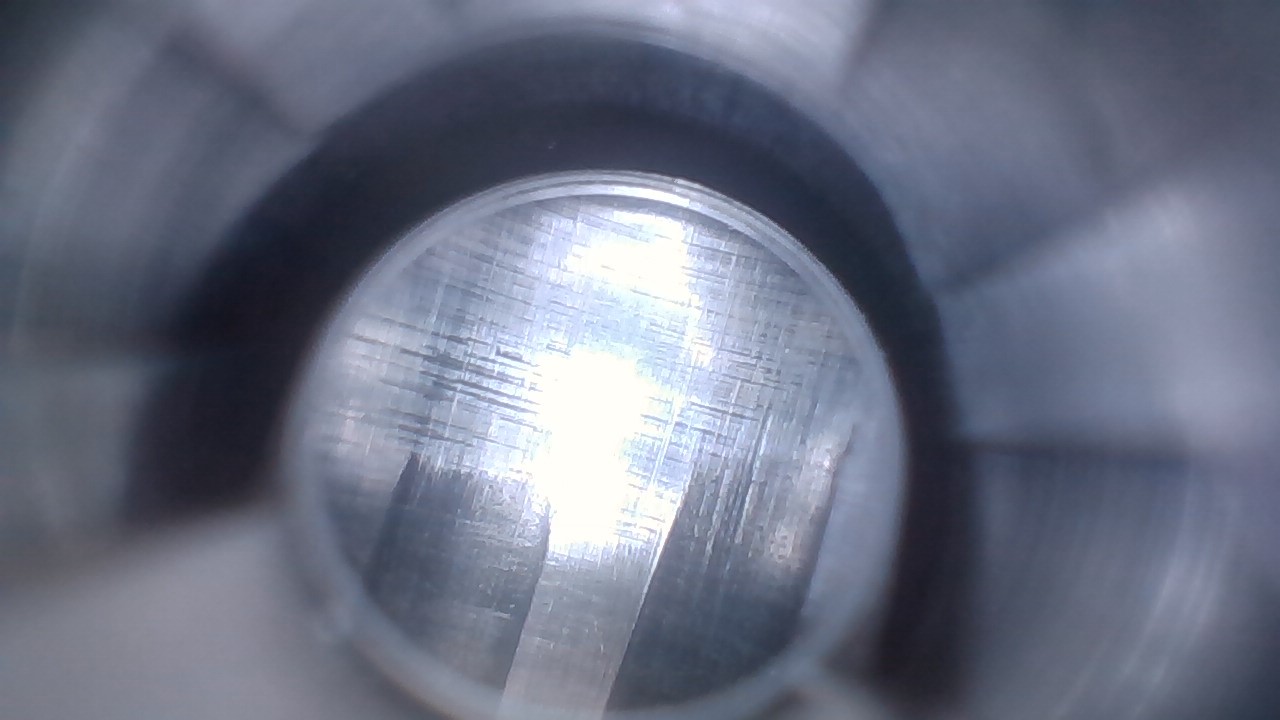

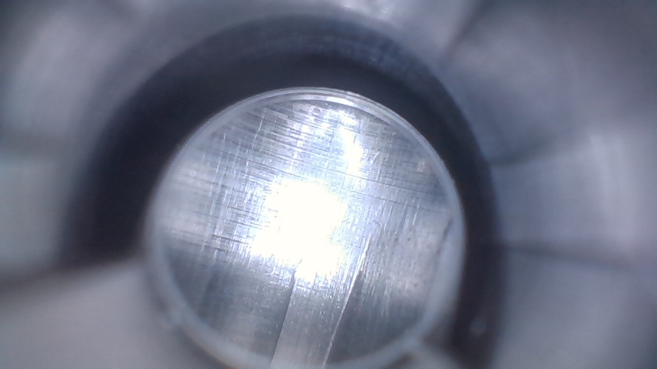

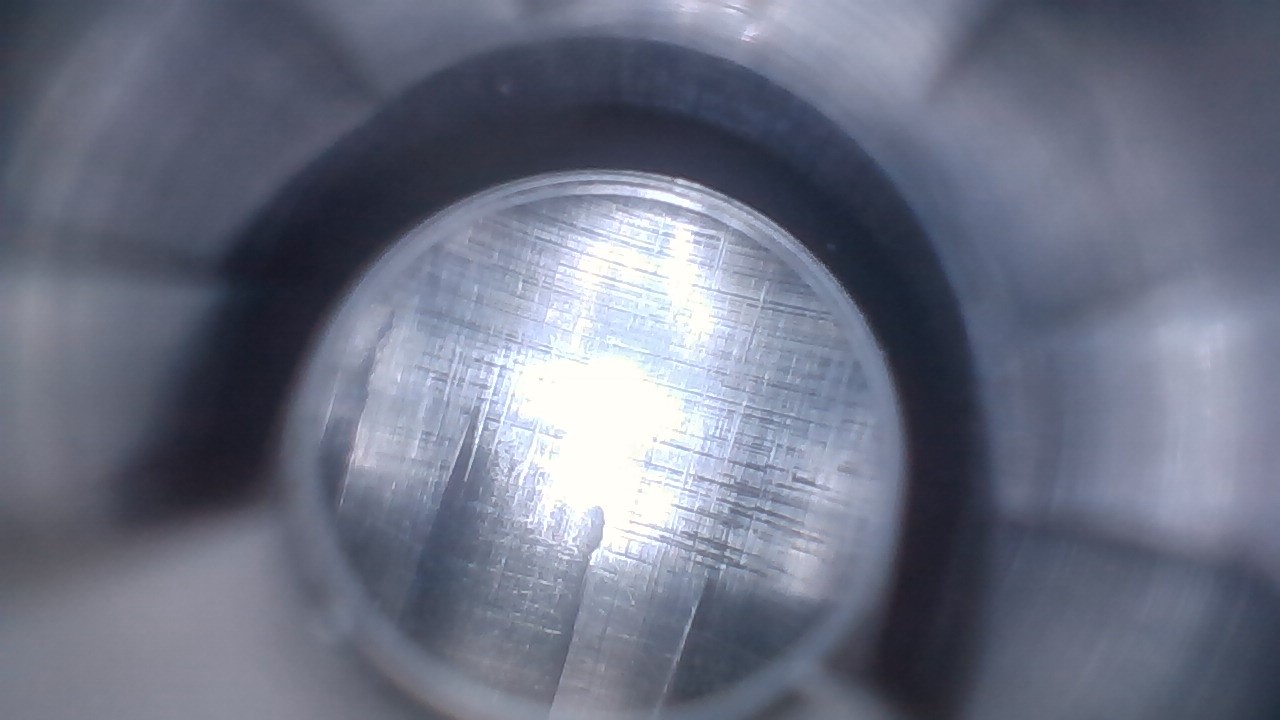

Here was mines main issue, chamber cut crooked.
