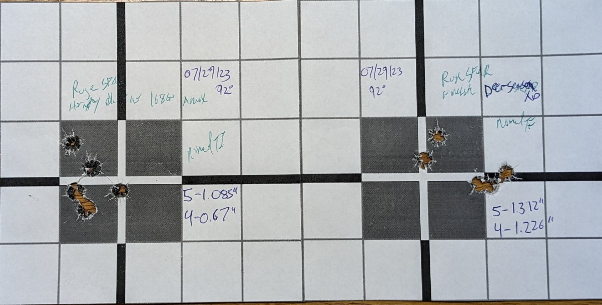

In my sample size of 1, The PA-10 shot the same as the sfar accuracy wise. Ran the PA-10 through the whole accurizing process and accuracy didn't react at all. It cycled better and felt better to shoot but accuracy didn't change until I changed the barrel.
Ran another 40 rounds through the sfar. This time with the h3 and suppressor. Feeding and ejection were great. Brass looked really good. After the first 10 rounds the gas regulator was bound up again. I'll try to get pics of all the copper flakes that come out this time. Just ordered a SA clamp on adjustable gas block to replace. This gas block isn't worth messing with if it's not going to be easily adjustable and makes it a pain to make sure it isn't touching the handgaurd.
The accuracy went to crap this time. First round of a cold barrel would hit point of aim and then the rest would group 2" to the right. Either I over adjusted the gas tube or the barrel extension doesn't like being tight to the receiver.

I bought one at release, a 16”. Didn’t have any ejection or cycling issues but was getting 3.5-5” groups with Hornady match. I moved on after that. I might try again down the road

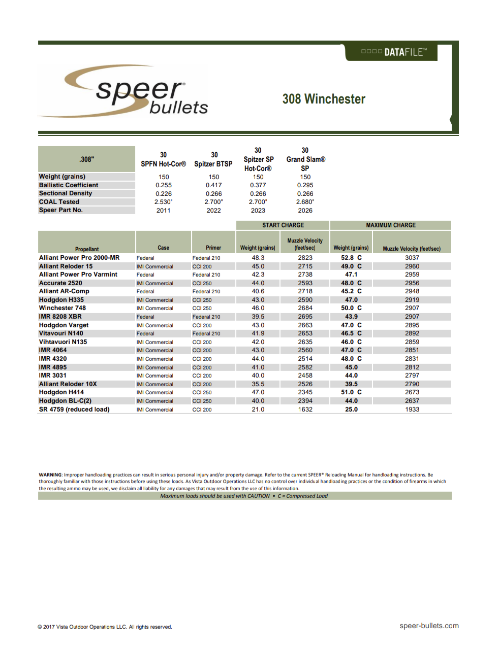

I ran some Hornady Black 168gr Amax and some more Win 150gr Deer Season XP through my 16" last time I had it out. The XP group was almost twice the size of the earlier group out of that box, could be the 300 WSM load work I was doing was starting to get to me, kind of looks like trigger control issue. Either one would be fine for plunking a deer, brass got roughed up, but is reloadable. As someone else mentioned in the thread, service rifle level loads and LC brass have been working best for me, current go to is 40.5gr AR-Comp under 165gr TGK.

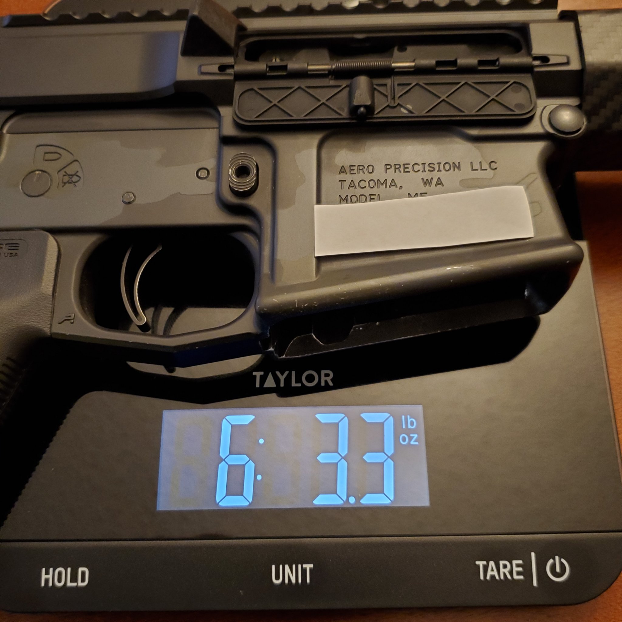

AR 10, 6 lbs 3 oz built for $1150 and it does Not have a pencil barrel...but a 16" Wilson Combat fluted Recon barrel, 5 oz heavier than a pencil barrel. AR 10s can be built in the 5.5 lb area with light components. And no issues to feed and function when set up properly.
And it shoots...I started with maximum bolt loads to see what it would do, and if any would group. 16" 308 AR 10... The best was 168 gr Berger .6", 5 shot group average velocity 2721 fps, 150 gr Gold Dot 2813 ave 9.4 S/D, and 208 ELDM 2437 fps Ave 13.3 S/D 5 shots under 1" and consistent.
Fastest load from a 16" 308 AR was 155 Lapua average 2900 fps average, 2922 highest velocity.
155 Palma 2867 fps ave. 155 tipped SMK 2850 fps ave. Plus a host of others tried.
You can fuss with the Ruger if ya want but the AR 10 is a proven platform, and tons of aftermarket accessories and parts to build it your way.

AR 10 ...16" SS fluted barrel, 7 lbs 12 oz field ready, sighted in for 100 with Leupold Mark 4 M3, note 30-06 elevation turrent on scope, 20 moa scope base. Good for 1200 yds. 208 ELDM at 2437 Ave fps, or 168 Berger at 2721 fps, and various 155 gr match 2850 to 2900 fps. Using Lake City brass.
What's your parts list for that rig, aside from the WC barrel?
Roam magnesium upper reciever, titanium bolt carrier, Jacob Grey carbon fiber handguard, SA adjustable gas block, 1 oz titanium muzzle brake machined by me for free.
Attached to an already acquired, standard Areo lower, with aftermarket 2.5 lb trigger, mission first stock minimalist stock. Leupold Mark 4 M3 3.5-10 X mil dot, with 20 MOA Warne 30 mm ultralight rings & mount. For 7 lbs 12 oz ready to hunt with Leupold calibrated elevation turrent.
You can build AR 10 even lighter in the 5 lb area with more expense on the lower and a pencil barrel. But 6 lbs 3 oz is light enough for me with a decent barrel that holds under moa for 5 shots, some close to 5 shot .5 moa. I only went for top velocity to find if any bulllets will preform there, and found 3 excellent choices, out a bunch tried, and more bullets on the way to test. All tests were with cheap military LC brass, not Lapua, thats for more serious bolt action work. This light 308 AR 10 has taken hundreds of heavy loads and performing great. No barrel breakin, no case prep, 1000 LC primed brass resized without the decapping pin. This brass will shot .3" and .4" 5 shot groups in my heavy Proof Barreled 18" AR 10. On a small 308 Win test in a bolt action target rifle, the difference between lapua and LC brass was about .1" in group size. Not important for this work.

What is your load data.
It's in the Speer manual, under 150 gr..take out half gr for the 155 gr. bullets. Ran 155 Palma, 155 tipped MK, & 155 Lapua as part of the days test, of 125 gr to 208 grs. Have some 169 and 177 SMK on the way, along with 168 & 178 eldm, for better BC.
My 28" douglas 308 was 2950 with 47grains of varget and a sierra 2156, I wanna see how you are getting almost the same velocity with a barrel that is a foot shorter.
Go read the Speer manual for 150 gr bullets they are over 3000 fps in a 24"...I run 155 gr Lapua 3100 fps on a 22" Bartlein 9 twist, with that load and 3200 fps in a 30" 308 8 twist and 2900 fps ave in a 16" AR 10 with softer LC brass. I was not using Varget...but it depends on the lot number and the barrel, I ran 3033 fps with Varget and in a 26" barrel for 8000 rds and a new 27" Shilen barrel which was 2980 fps in bolt guns with Lapua brass. Do some research there are powders other than Varget for the 308, and see how it's done...or not.
I don't understand why we have to guess the load, but here are the 150gr .308 loads on Speer's website. One breaks 3k in a 24" barrel, 52.8gr of PP2000MR, is that what you're saying your load is?
