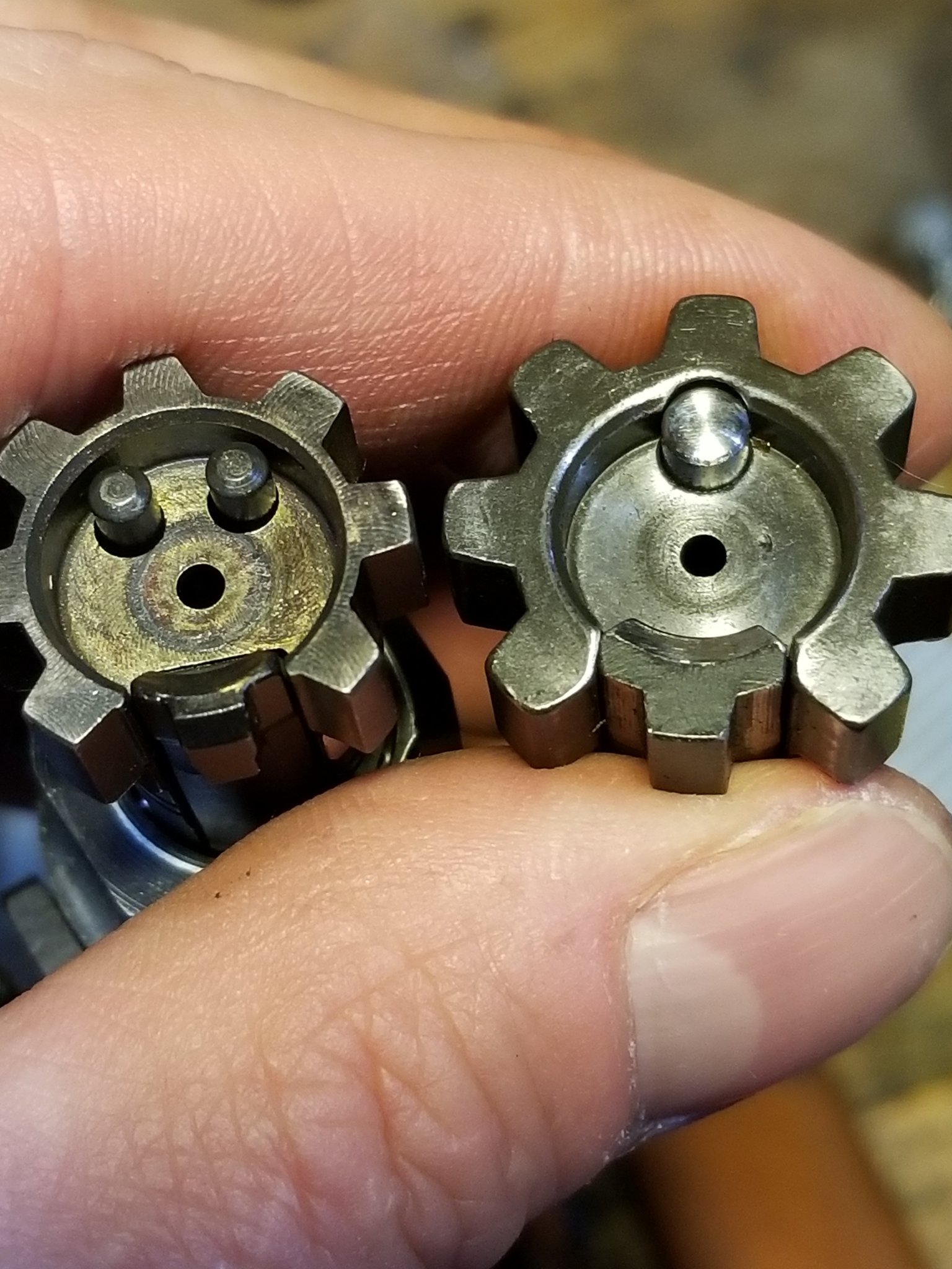

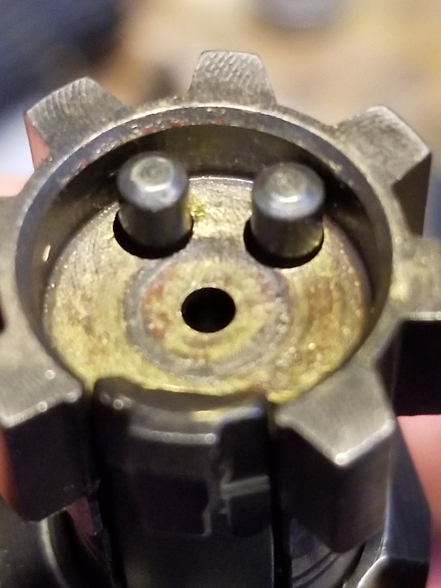

One of the things I've done so far is disassemble the bolt, took out the ejectors and extractor. The goal was to maybe take a little of the raised edge off the rims of the hole for the ejectors and extractor which I think I've accomplished. Hoping this will help with the issue of peeling brass off the bases.
But in the process I noticed one of the ejector pins was hanging up on some kind of burr where the hole for the retaining roll pin was drilled. Made it a real challenge to get the ejector pin and spring out of that hole so I ended up deburring the inside of both holes as well.
My first thought when people were having those nasty ejector swipes was "wonder if anyone has polished the bolt face". Picked the sfar up at lunch. When I'm putting the suppressor mount on tonight I may pull the barrel and see how the reciever fit is. It may get a shim and thermal fit.

My memory may be clouded but IIRC there were marks from the ejector pins on my some of my cases as well as cuts from the ejector and extractor port edges. The bolt face also has a "fingerprint" marking over the whole face that transfers to the base of the case ... maybe Ruger's idea of a traceability Easter egg. I haven't full out polished it but maybe knocking the edges down will help.
I think the image is deceptive, mine seemed round to me when I wrapped some sandpaper around a drill bit to get the burrs off the walls.
I also smoothed over the ends of the ejector pins for whatever good it will do.
Ruger built this thing to some amazingly tight tolerances in some places but put slop and left unfinished edges in some really critical places. It's like the work was split between two Hyde and Jekyll machinists.
The hellbender thread about polishing the bolt/ejector/extractor is worth reading
No wonder they eat brass. The amount of gap is disgusting. They kinda dont look round either. Must have struggled drilling the holes in their fancy steel.
They look oblong is that yours or another persons pic? It could be shit lighting/shadows otherwise that’s terrible.

That's the sfar I brought home a couple hours ago. You can wiggle the ejectors around in the holes. Put two half round .001" shims around the bottom of the barrel extension and still didnt meet any resistance seating the barrel but it doesn't wiggle anymore when seated. I dont know what I'm going to do with the gas block clearance. I measured. 01" of difference between the width of the gas block and the gap where it resides. I don't think its possible to misalign the gas block to the gas port and still get the handgaurd on. The hole in the bottom of the gas block is 2-3 times the size of the gas port. Also mine shows significant gas leakage from around the gas block. Brown soot all over the barrel and handgaurd.
I'm not dogging the rifle, just relaying what I find. If it runs well suppressed and get 1.5moa or better I'll be tickled.

The bolt on the right is the way things should look. The slop in the SFAR holes is undesirable, especially since it makes so many brass chips that will find their way into everything.
I'm trying to hold off on doing too much before the function testing. I'll leave the bolt alone. I shimmed the barrel/reciever and swapped the handgaurd because .308 is pricey to shoot just for function without getting any accuracy info.

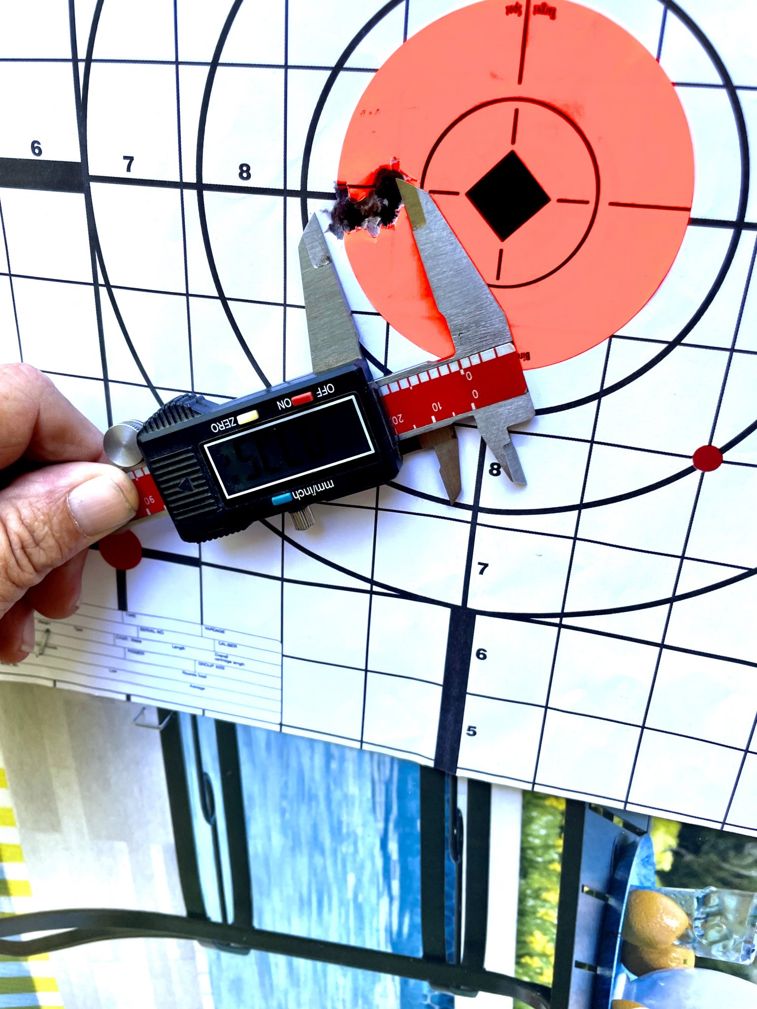

That's nice shooting. Hope I can pull some groups like that. Unfortunately I don't have any good factory ammo so my results won't mean much to anyone else since its all reloads.
I put a lightweight 18x power scope on the rifle to facilitate accuracy testing but allow me to feel what the rifle will be like to carry once I pick out an optic to live on it. I'm leaning towards a 2.5-10.

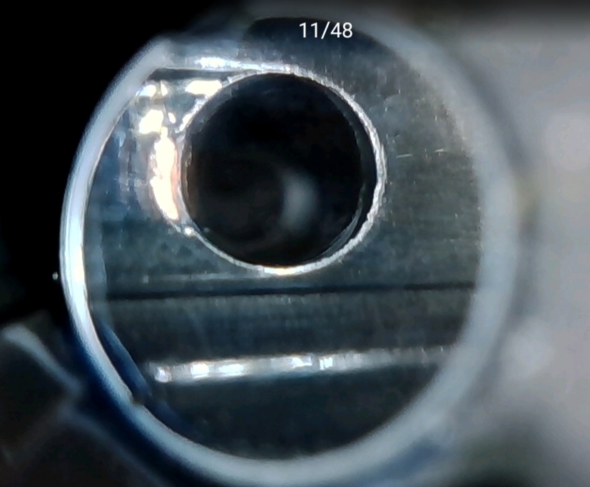

Maybe a snap of the port from the inside. Mine is almost as wide as a groove inside the barrel.

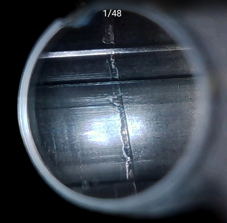

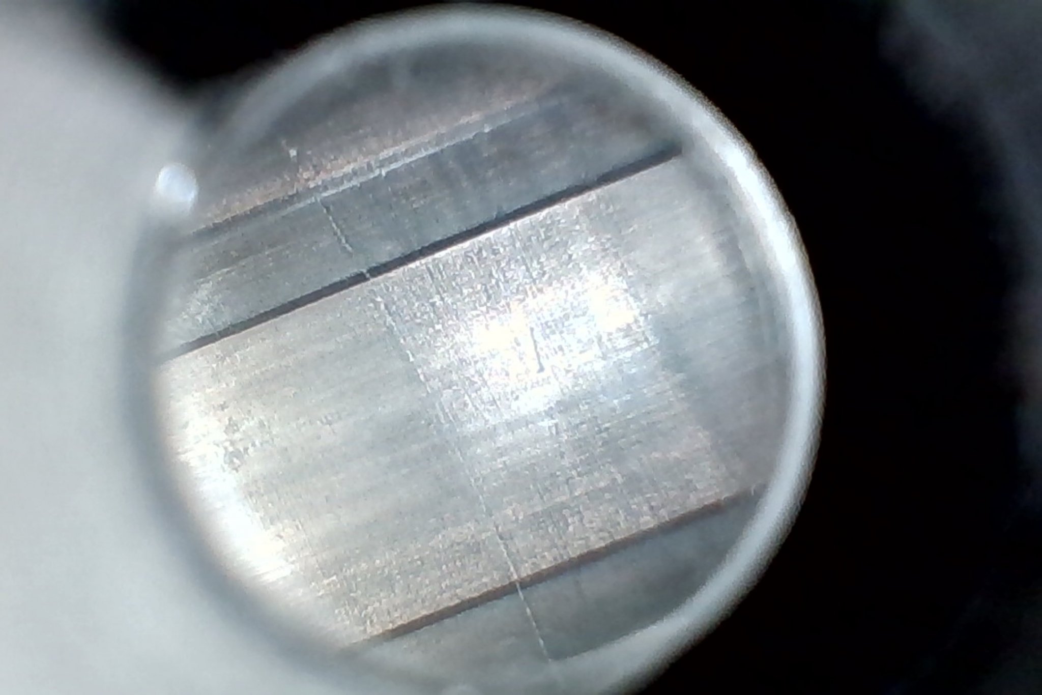

Wish I hadn't scoped mine. Chamber is just a tiny bit wonky. There's a ring all the way around in the bore halfway between the chamber and gas port. Probably something left over from the hammer forging but was where that copper was coming from. Gas port looked fine. Had a touch of copper on the back side. Weighed it with the 12" hg and different brake and it was 6.51lbs with out a mag or scope. Ordered an H2 just to have on hand.

Yep, that port looks as big as mine and about the same on the back side.
Rifling is as good as mine, maybe better. I have at least one ring like that but not as pronounced. As long as it shoots it's hard for me to worry too much about it because I have other rifles that look like crap compared to the SFAR but shoot well also.

I'm not going to worry about it unless it wont shoot. That's the most pronounced side. Being close to the chamber it should shoot out fairly quickly. The rifling does look nice compared to a button rifled barrel.

I’m wondering if they are using a reamer pilot and it has galling on it from not being changed out enough. It’s a long shot, but would cause that sort of deformity. Volume Production machining experience.
The freebore/etc area of my chamber was all chatter, like they used a single point fly cutter with some runout as a reamer. It was very ugly.
