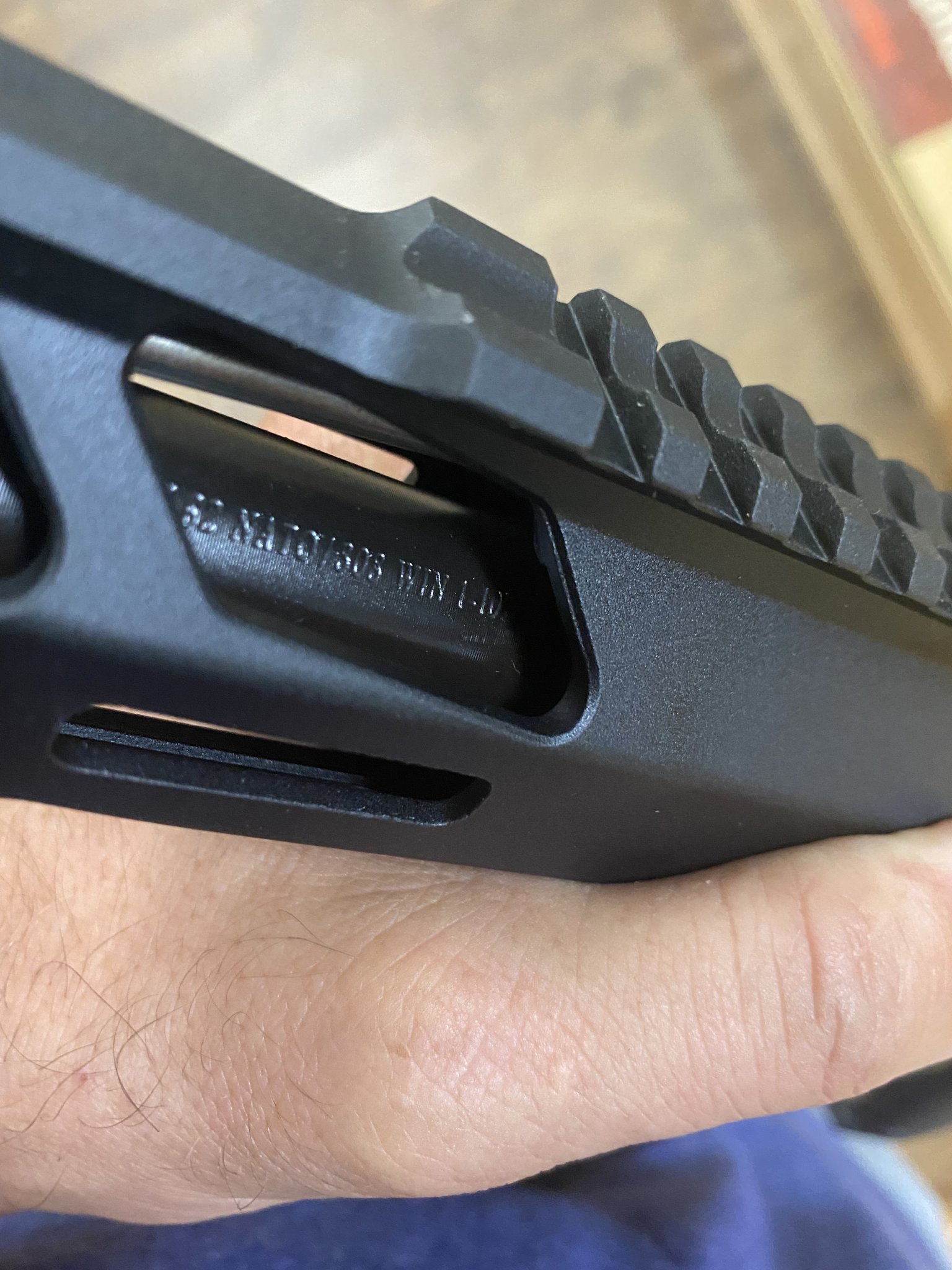

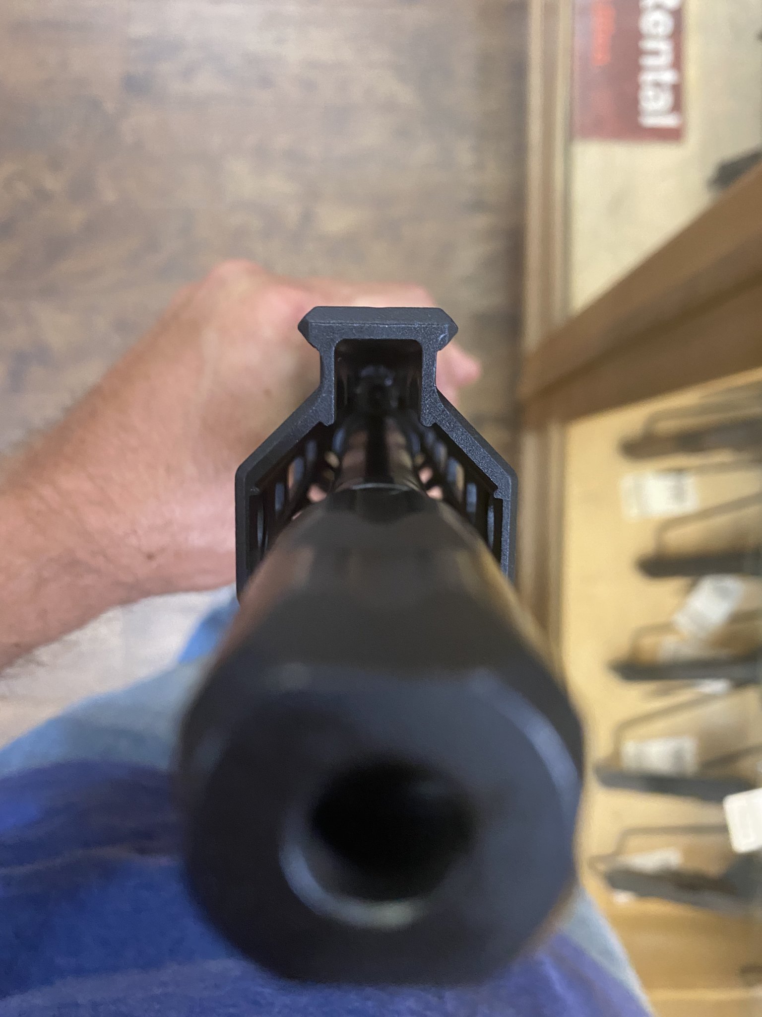

Is the rail actually flexing or the barrel. You would have to lay the rail on the counter and push down on the receiver to know for sure. Maybe he did this. If you just grab the rail and barrel and squeeze then its probably the barrel.
The rail was flexing. When I mentioned that it felt flimsy, the manager did just what you said except it was on low shelf behind the counter instead of the glass. Side load, not pushing from the top or bottom. He said he felt it touching the gas block when the left side was facing up. Like I’d stated earlier, the barrel nut didn’t look to be much over an inch long. Looked shorter than a BCM barrel nut through the gap where the rail is tightened to the nut. He let me step behind the counter to do the same.
Yes there was barrel flex. The contour was fairly light. Any pressure on the barrel to the left caused it to contact. You had to push harder to the right to get it to touch.

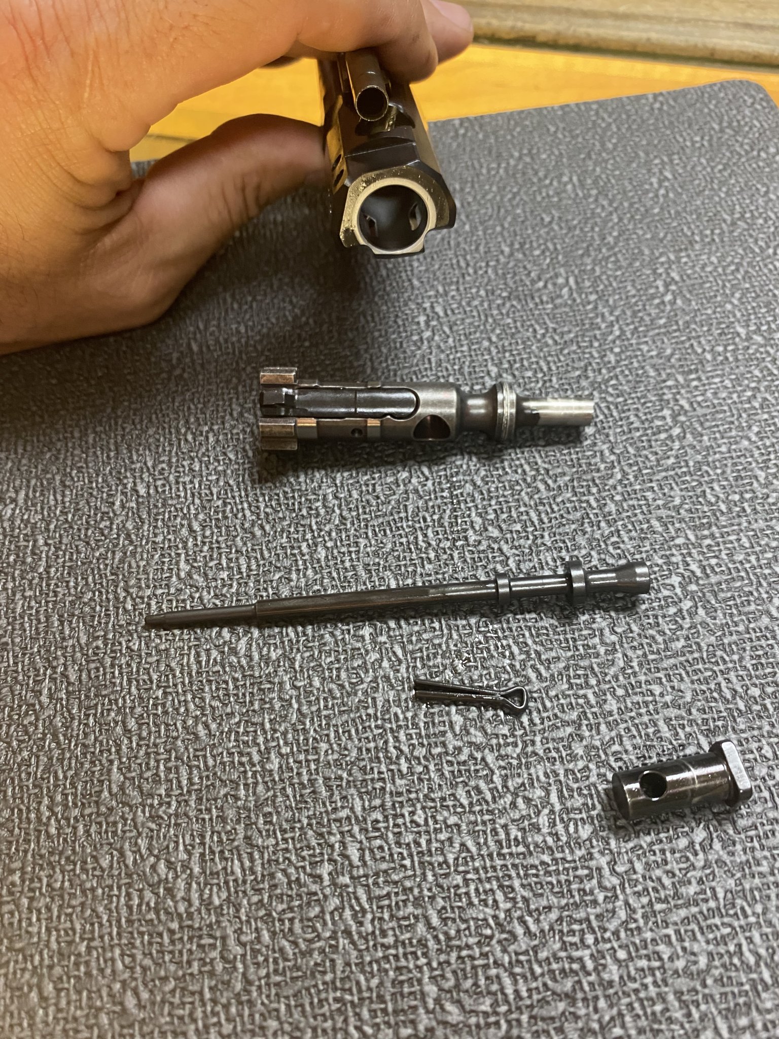

The bolt and barrel extension are both a high nickel content alloy, possibly Inconel?
Where are folks getting Inconel from? The bolt and extension are not Inconel. Inconel grades are expensive and in general their main benefit is relatively high strength and low creep at high temperatures, that a bolt and extension will never see. At more or less room temperature + a few hundred degrees, there are many steels with better properties for bolts like this.
Ruger's cut sheet says: "Bolt and barrel extensions are CNC-machined from high-strength super alloy steel that outperforms traditional C158 bolts."
Inconel is not a steel, they are most likely referring to an ultra-high strength steel, something more along the lines of Aermet or maraging grades (which coincidentally have high nickel content, something that I believe was mentioned in one of the intro videos).
Also, the Ruger cut sheet says the firing pin is titanium, someone above mentioned that it was light weight, that's why.
Yeah you are probably right, Aermet would make more sense. On the video he says “high nickel content, high strength super alloy steel, commonly used in aerospace applications “.
I said inconel as a possibility because it is high nickel content, super alloy steel, commonly used in aerospace applications, as is Aermet. While inconel IS a steel, I shouldn’t have specified any material without knowing.
I don't want to derail the thread, but no, they aren't. Inconel is a brand name for a series of nickel based alloys, none of which are steels. Steels are ferrous based with carbon and other alloying elements added. In the UNS alloy destination system, steels will have a D, G, H, J, K, S or T series designator depending on type (maraging 300 and Aermet are both K series for example).
The Inconels are all nickle based alloys with other elements added (including iron) but they aren't steels, and they have N (for nickle based), or R series designators in the UNS system. Some of the more common grades ones you hear about like 625 and 718 have only 2.5% and 19.5% Fe respectively.
Special Metals does make an Inconoly line of alloys along side the Inconel line, while most of the Inconoly line are nickle based alloys, two are S (stainless) series steels.

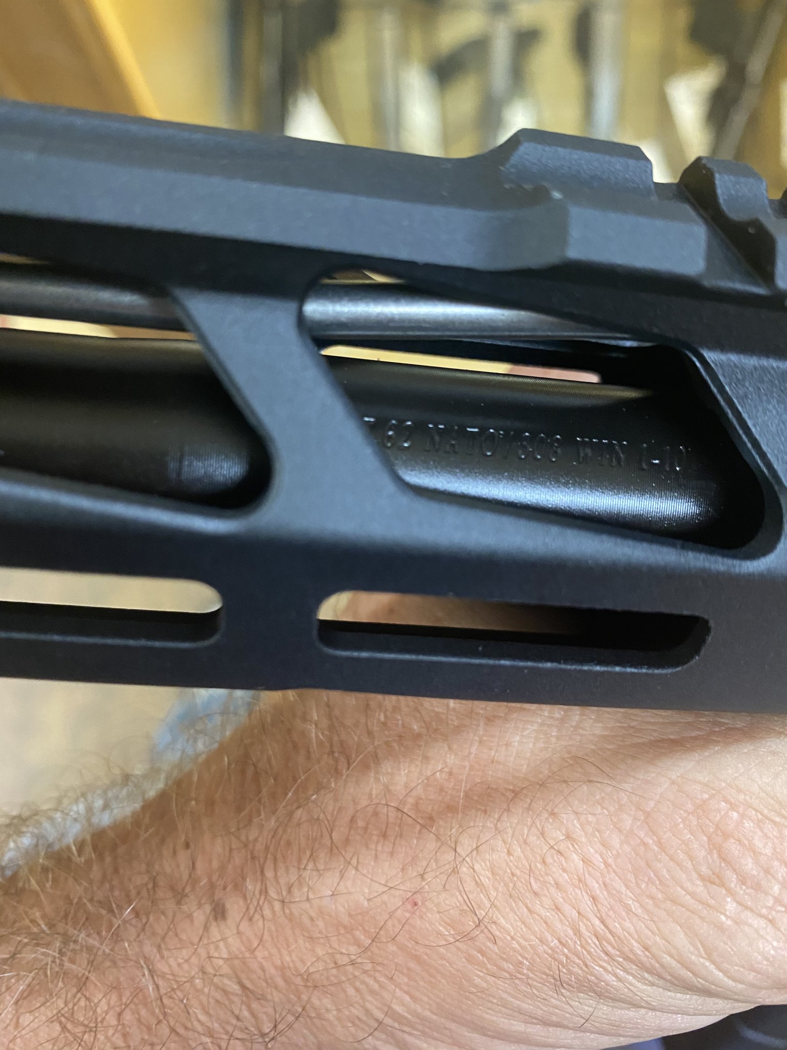

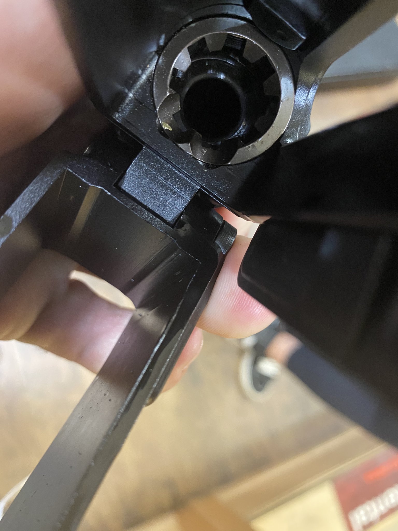

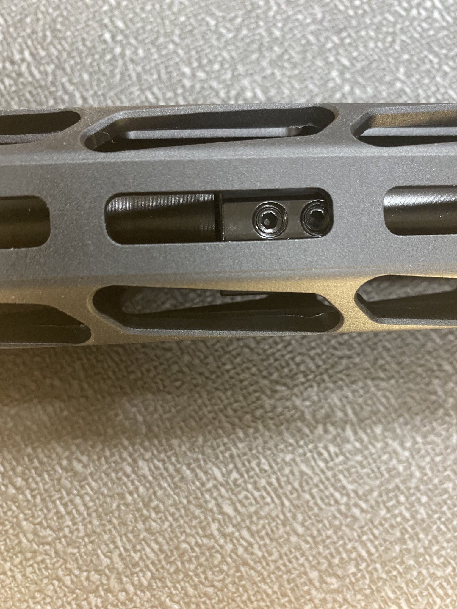

The handguard was flimsy. It flexed enough to contact the gas block.

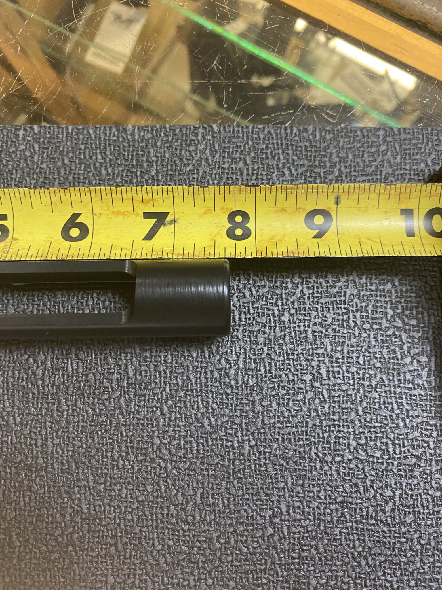

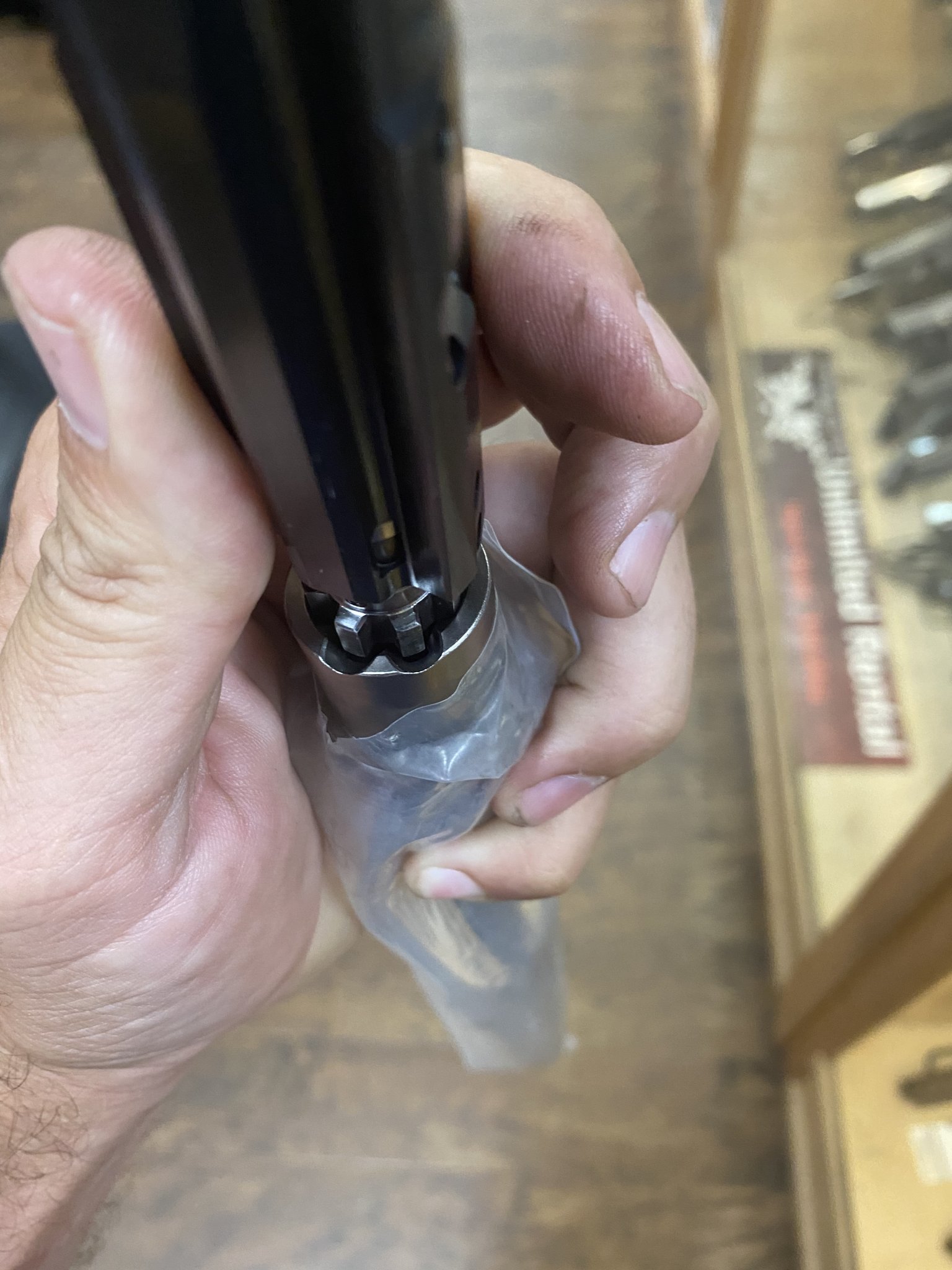

From what I could tell in the shop lighting, the barrel nut looked to be about an inch long. It looked like an ar15 handguard would fit. Without disassembly, I couldn’t tell.
Barrel was stamped 7.62Nato/308win

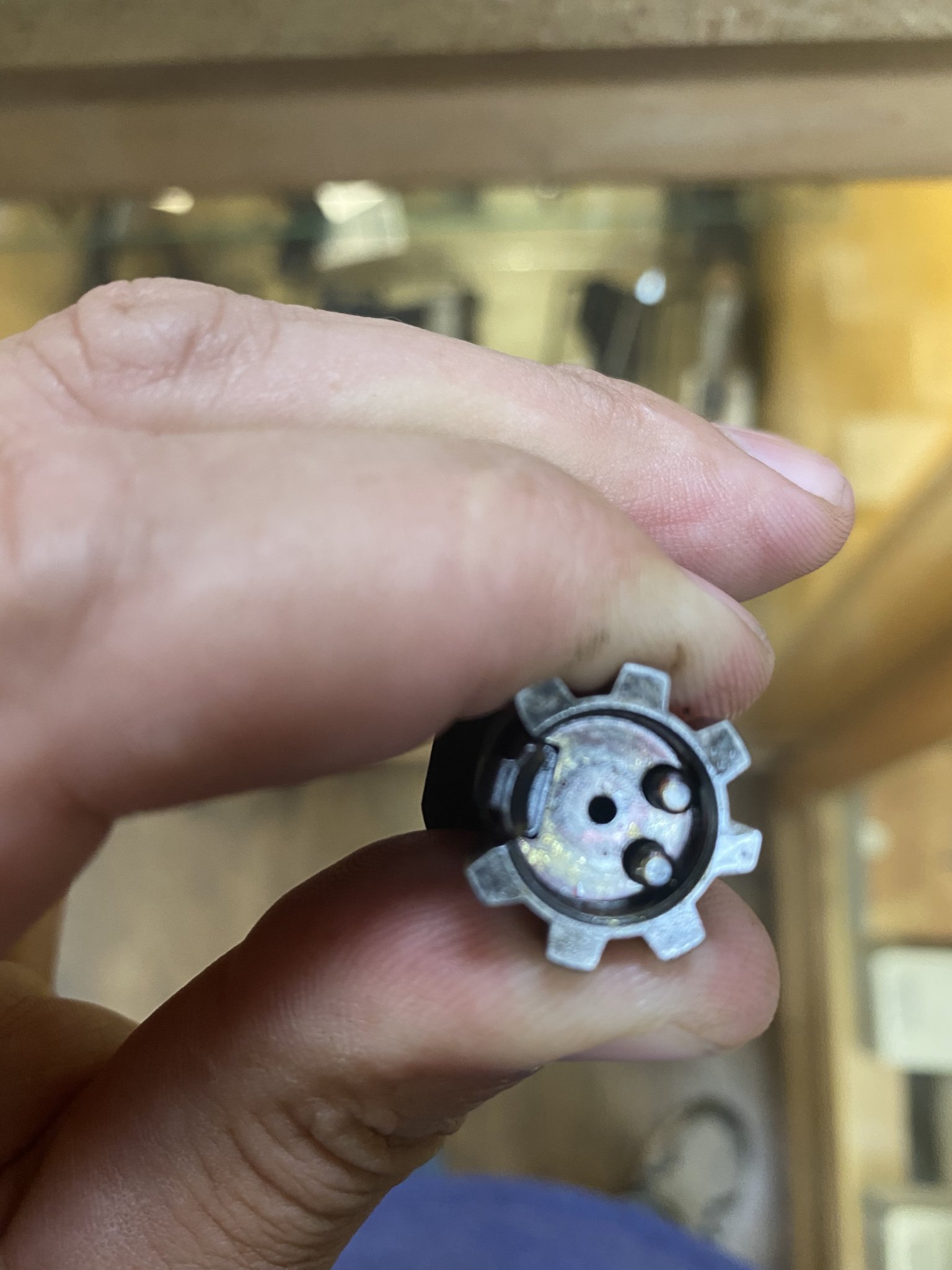

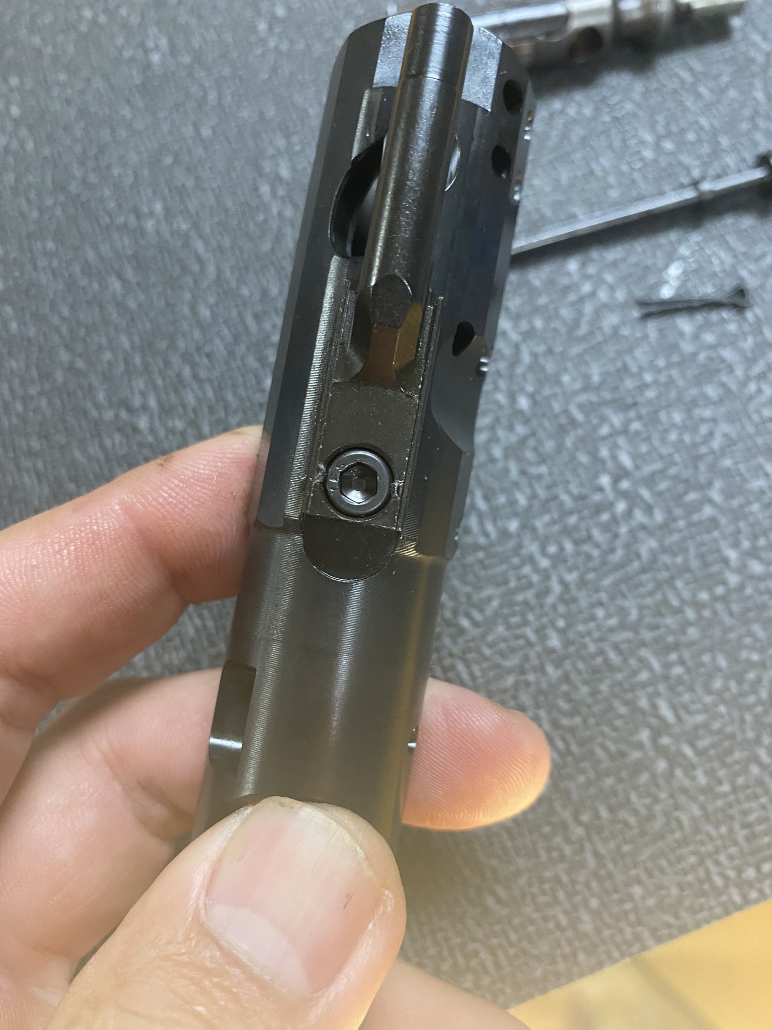

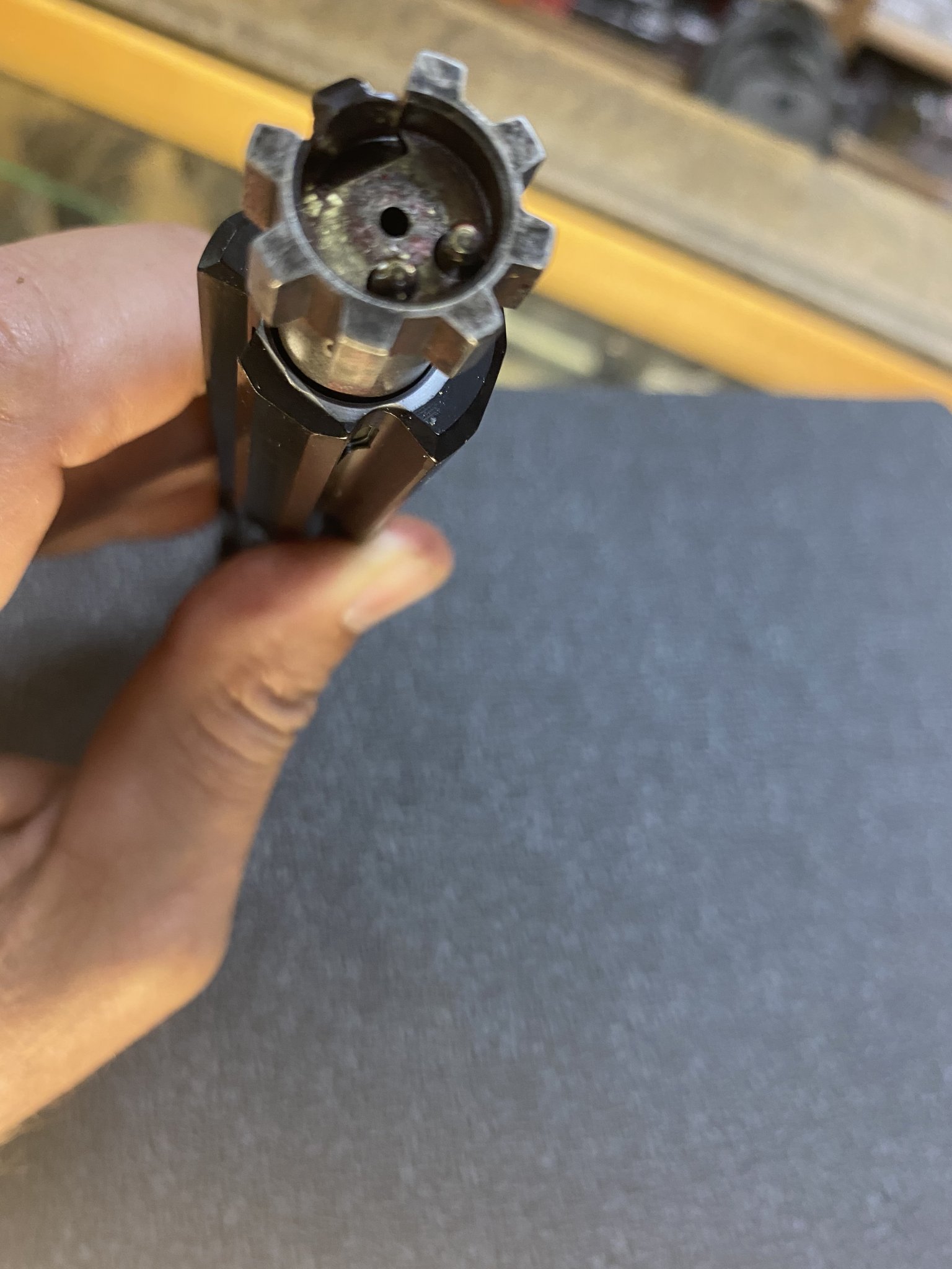

Bcg was interesting. Seemed to be melonited with a chrome bore. Gas key was melonite as well. Vents on bottom of the bcg. Carrier got really thin at 5&7 o’clock.
Barrel extension was vented on each side.

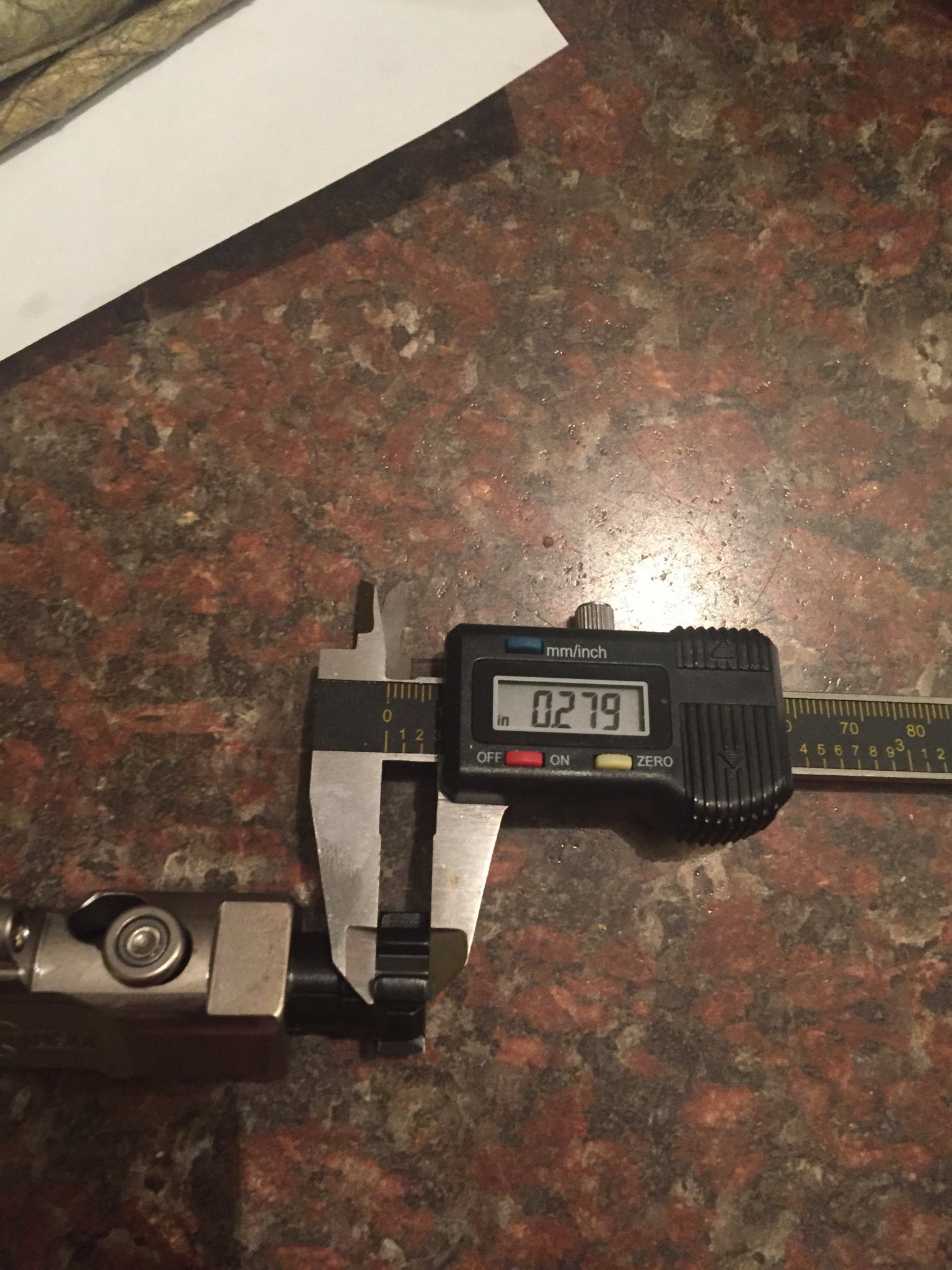

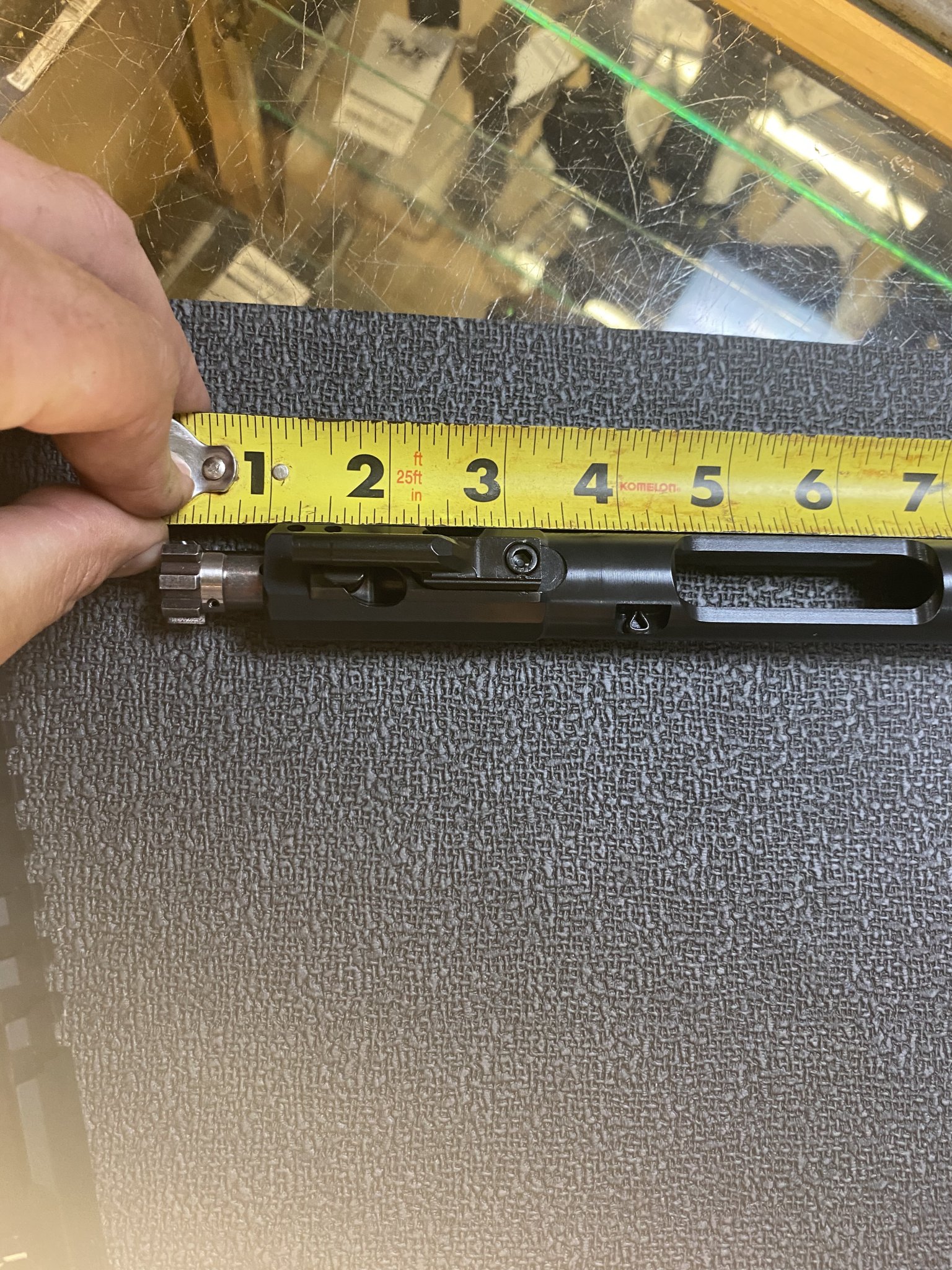

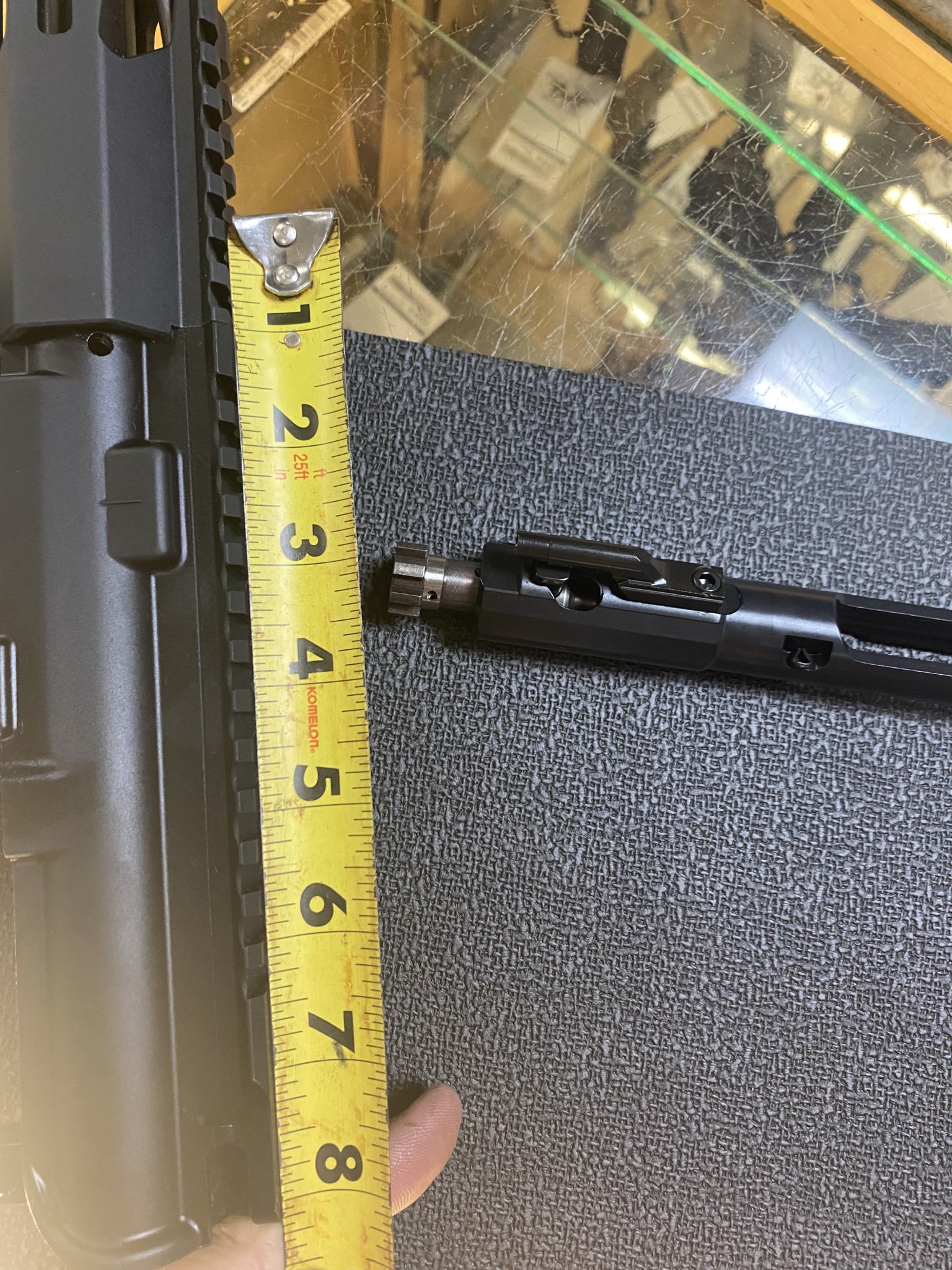

Measurements were taken starting at the 1 inch mark. The shop started getting busy so I put it back together so the staff could work.
View attachment 7957584View attachment 7957585View attachment 7957586View attachment 7957587View attachment 7957588View attachment 7957589View attachment 7957590

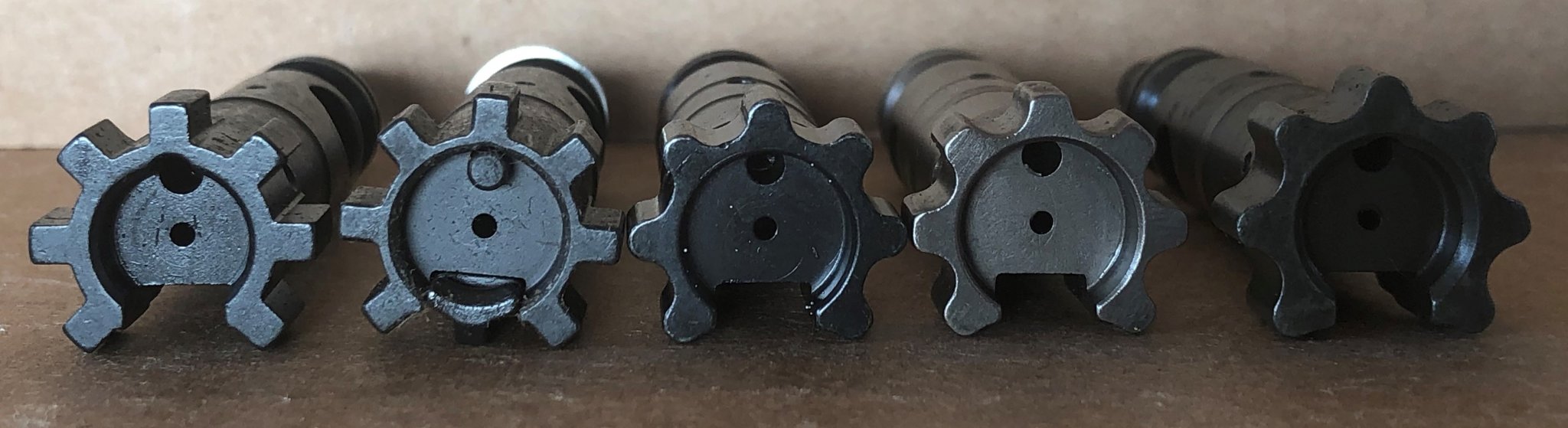

Could it be a 450 Bushmaster bolt in a 308/AR10 carrier? They have the same rim diameter, correct?
The AR15 bolt on the far right(800 series) is .800" diameter made from 9310. We have been using those since 2009 with several 308 sized wildcats. The 6mmBRX, 6.5BRX, 270AR, 270 MSR can all handle 65000psi and no one has ever broken a bolt. The rim around it does look thicker than the Ruger bolt shown in the photo. The one second from the right (750xd)is .750 diameter 9310 and used with the same cartridges, the rim looks closer to the Ruger, no one has ever broken one of them either. If the Ruger lugs are longer than a standard AR15 (.277") it will more than likely be okay. Time will tell if the Ruger bolt can handle it.

Well there goes me hoping the bolt and Barrel extension would be a standard size with POF.
SFAR bolt.
Pof rev bolt below.
I wonder if the extra .020” is on the bolt face or the side of the bolt lug that engages the extension lug.

It’s light. The handguard felt cheap. Gas block had minimal clearance. The barrel extension has to be proprietary. The bolt will almost fit in an ar15 barrel extension. It almost looks like a Grendel bolt. Firing pin has to be titanium, it weighs nothing. Pics aren’t loading right. I’ll post more later.View attachment 7957540View attachment 7957542View attachment 7957543View attachment 7957540View attachment 7957542View attachment 7957543View attachment 7957554View attachment 7957554
That's gotta be the laziest staking I've ever seen on a BCG
