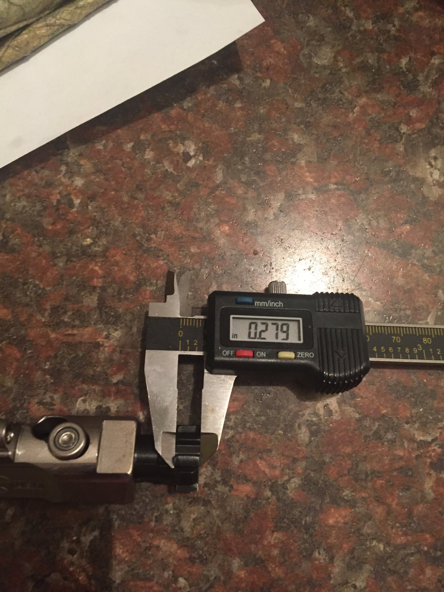

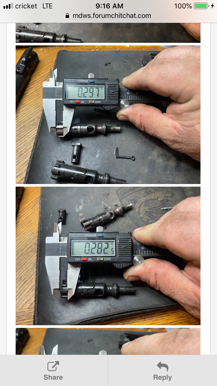

SFAR bolt. View attachment 7963644
Pof rev bolt below.
I wonder if the extra .020” is on the bolt face or the side of the bolt lug that engages the extension lug.

Seems they are different measurements, extractor is different.
