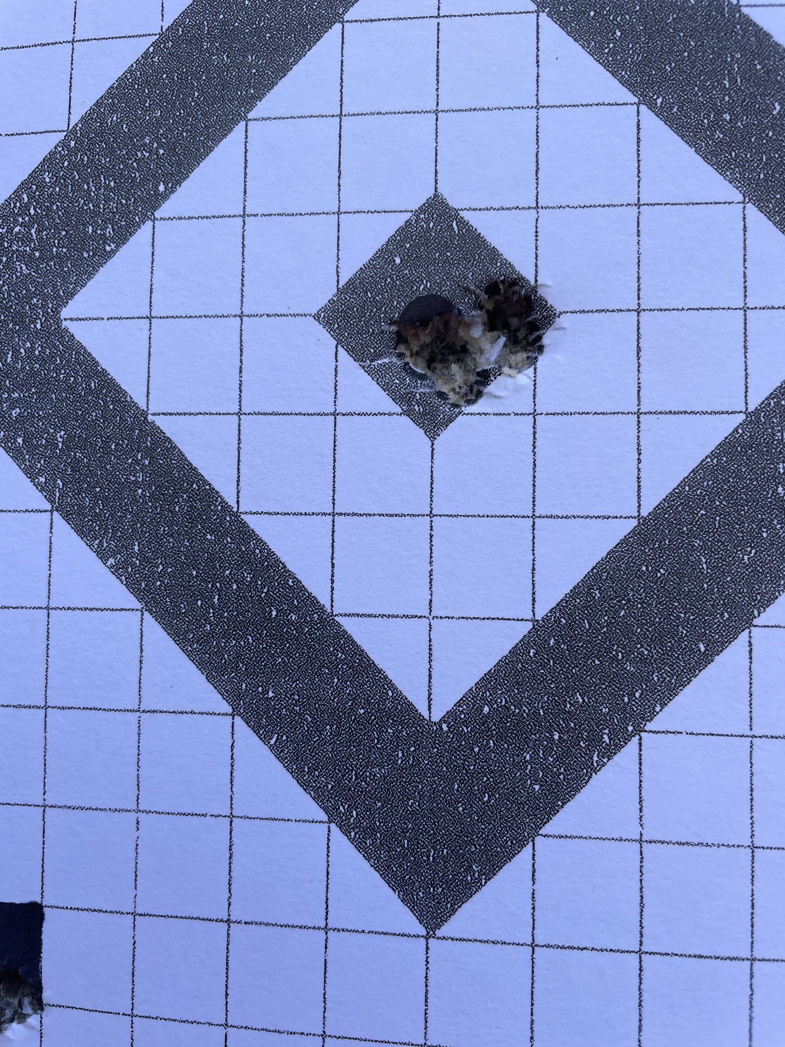

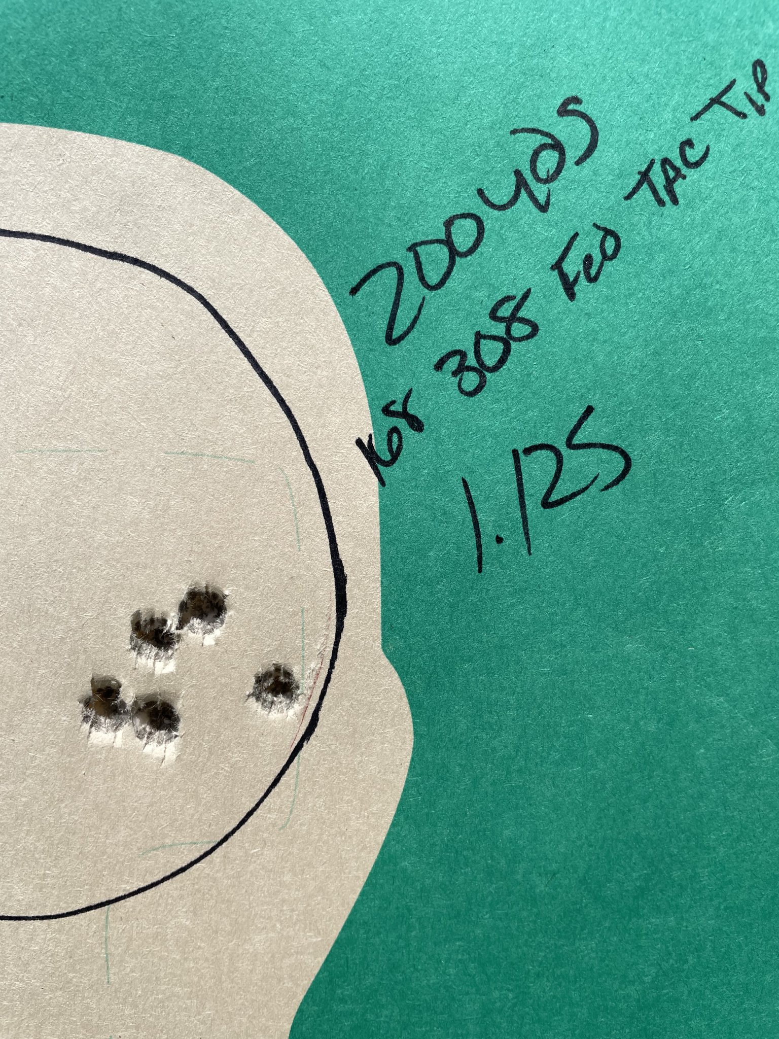

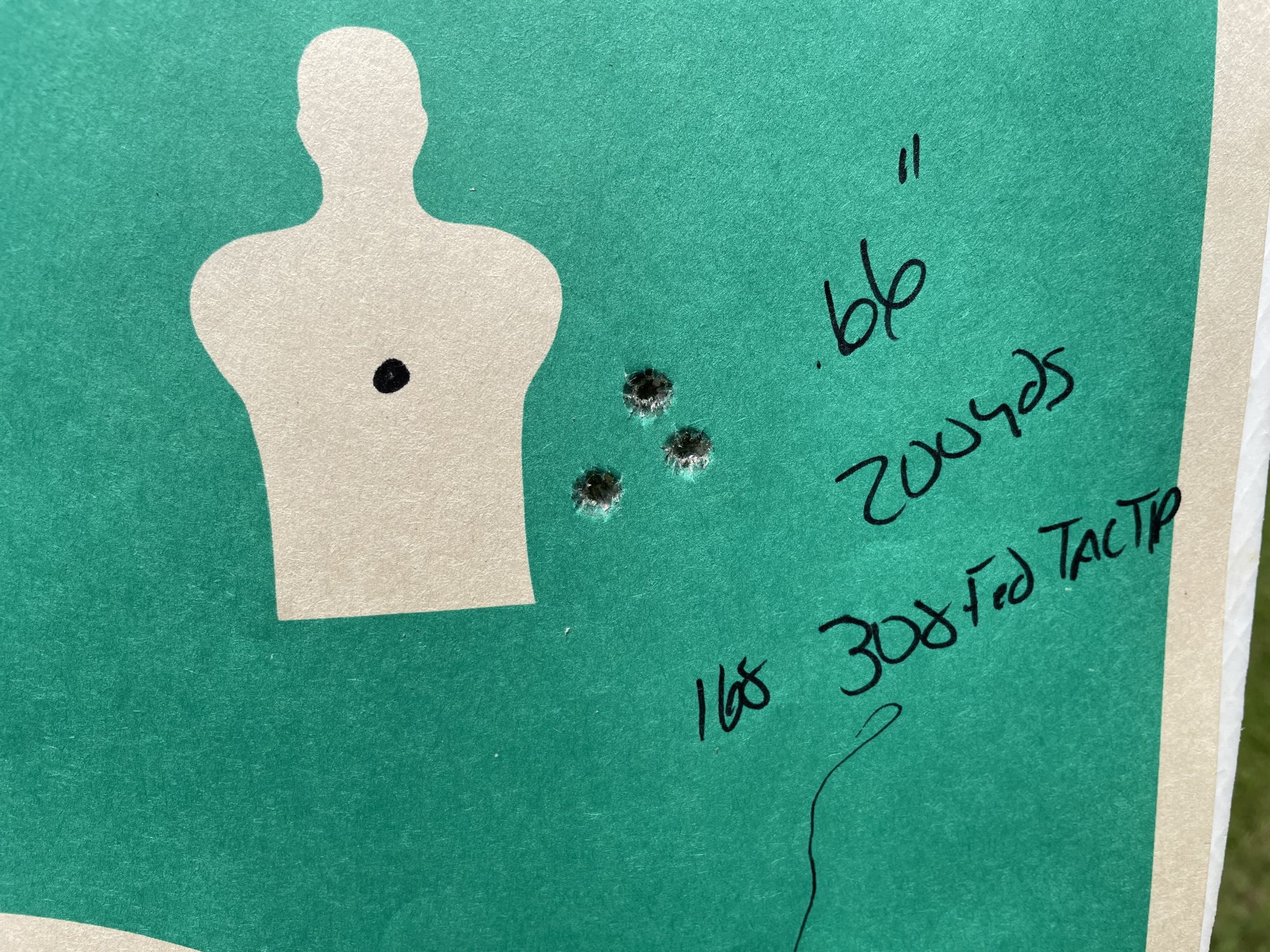

So is the overall consensus just it's "hit or miss" depending on luck? I have had my 16inch version for just over 2 years and I've only had one malfunction in the last 550+ rounds. It was my fault as I turned the gas up, by mistake, when I mounted the suppressor. I don't shoot it a lot but I feel its been very reliable so far. It's had a strict diet of Federal 168 GMM and Federal 168 Tactical Tipped Matchking, with 90+% suppressed with a Sig 762SRD can. Both shoot well.
First picture was my 50 yard zero confirmation with 5 rounds of 168 GMM. The second and third are 200 yard groups with Federal 168 Tipped Matchking. At the price point, I've been very impressed. I've since pulled the Leupold Mk4 off and I'm currently running a 1-6 LVPO and using it as general purpose carbine.
