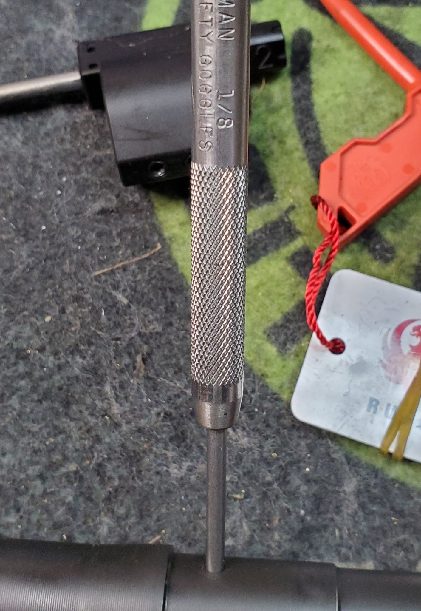

Just pulled the gas block off in prep for ordering parts and measured the port in the barrel.
1/8" diameter tunnel (0.126x") 😲
ETA:
It has plenty of wiggle room ... what's the ID of a 1/8" roll pin? can I buy/make a sleeve for it like an engine cylinder?

The port in the SFAR barrel is ~0.126" ... HUGE ... bigger than anything else
The #3 valve in the SFAR AGB is ~0.114" ... HUGE
The #2 valve in the SFAR AGB as returned to my by Ruger CS is ~0.103" ... HUGE
The #1 valve in the SFAR AGB is 0.068" and still over gassed
The port in my LR-308 would seem to be ~0.096" as reported by Tactical Machining (I've never measured it myself) even with a heavier BCG and a heavier buffer than the SFAR and the LR-308 was over gassed to the point of denting cases upon ejection before I installed a JPE AGB and adjusted it ... no more dents
The SFAR AGB restricts the gas flow insufficiently ... Ruger failed
ETA:
That is huge.

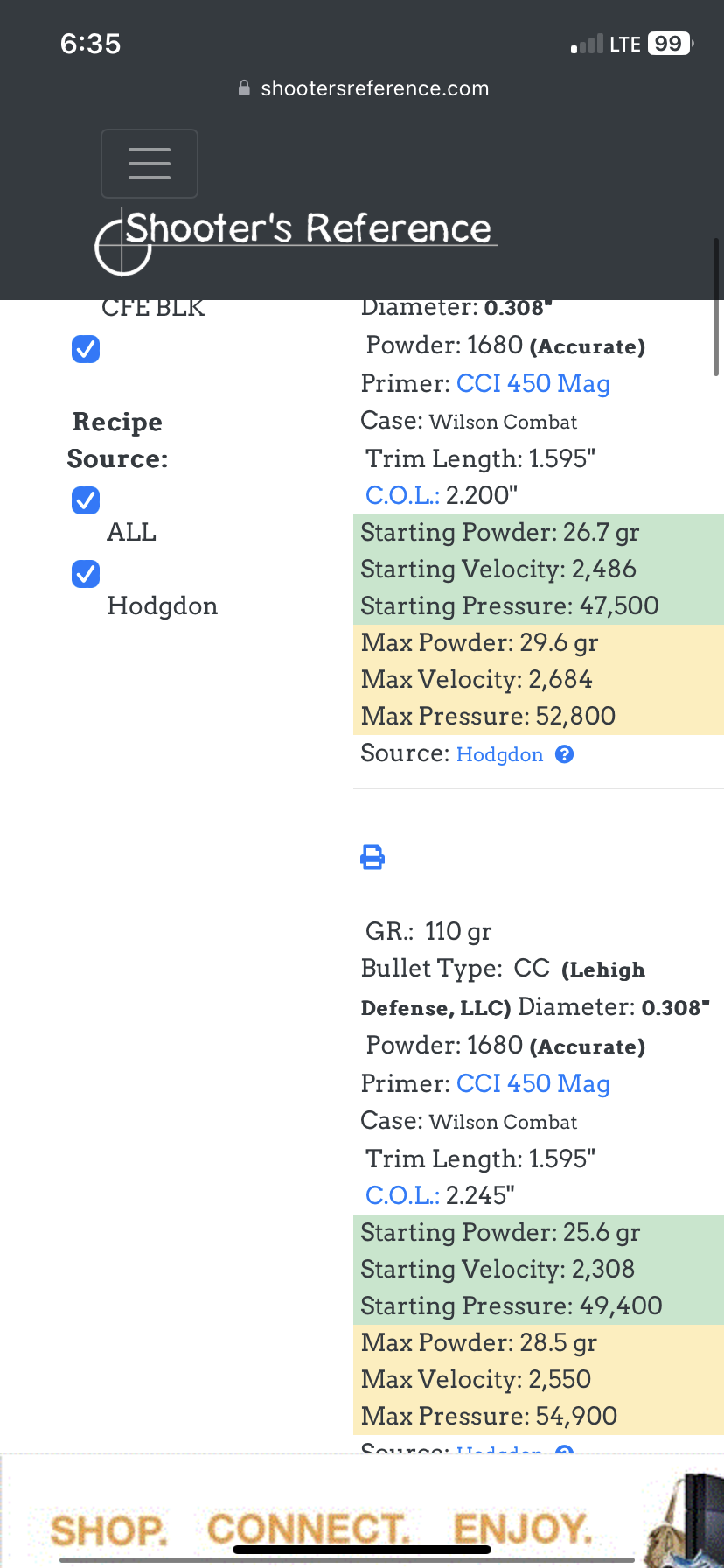

So the small frame 308 is going 2900 fps with 110 gr bullet...the AR 15 300 hamr does 2876 with 110 Varmageddon with 29.3 gr of AA 1680, in 18" 300 Hamr barrel. The 150 gr at 2398 26.8 gr CFE Blk with 8.0 S/D and a .264" 5 shot group at 100 with a little 300 Hamr no issues, with feeding or ejecting. Light AR 15 with almost the same performance, up to 150 grains as this heavier malfunctioning 308...it would appear...interesting. What happened to the 30 Remington AR? Or neck down a 450 Bushmaster case a lot of capacity at moderate pressure 308 casehead AR 15 platform. A 16 in 450 Bushmaster is range limited but with the fast twist resized 502 gr bullets can be used...and over 3000 ft/ lbs of muzzle energy available in 16" Bushmaster, AR 15, with standard off the shelf parts to configure any way you want it...a firearms main goal is to go bang, and function 100%. This Ruger experiment seems prematurely dumped on the public, without much testing, like so many manufacturers these days. And lacking in quality with priority parts...needs improvement before I'm interested. I'll just carry an extra pound or 2 with the AR10 for now, or go to the AR 15 if I desire something lighter.
So you are running a stupid hot load and going to come on here and brag about how bad ass it is.
Most published data for 110 loads is in the 25-2600 range.
I could load some 110’s way over pressure then brag about some high velocity but you know, I’m not as cool as you are
But this thread is not about that and I’m not trying to derail this topic so if you want to cry and bitch and a PM me or something I’m out

My load is .3 tenths gr under max of the one you posted, at 2700 fps, mine were chronographed maybe different bullet, and longer barrel but still 110 grs .... so there's that...Total LOL...
And even if it's 200 fps difference your still carrying around more weight with less fire power, with non commonly available components, found everywhere, magazines, bolts, even on a battlefield, used parts and mags everywhere.
And a big plus and no issues feeding, ejecting, tearing up brass, a long proven, reliable, light weight, system. Against a heavier, faulty, unreliable, specialized components system... for a few hundred feet per second, not even using my data of 3 tenths under max...but super hot loads according to you ...that you printed! LOL...
The point is, not much gain in performance for the extra weight, specialized one of a kind, unreliable system, and all its problems...the juice ain't worth the squeeze,.. for me. I'll just carry my regular heavy reliable AR 10...or 300 Hamr, reliable, common parts everywhere.

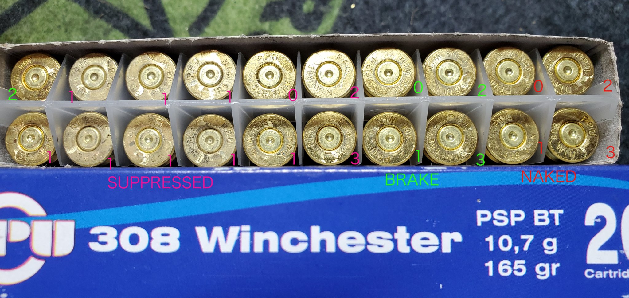

Went to a nearby indoor range to do some tests because it was easier to work it in while running errands than packing for a day of accurizing at the club range.
I added a weird twist just for fun, don't know what it proves but it's numbers so there's that.
The SFAR is in the condition as returned from Ruger after service
There are still definitely some scrapes and some imprints in the bases but the lugs are virtually brass chip free. The brass itself also looks 90+% better than it did before the service. Annotated brass picture at the end of this lengthy and boring post.
I ran 4 rounds, one on each regulator setting, with a naked muzzle, the factory brake and suppressed with the old Liberty Freedom then most of the rest of the box suppressed with the regulator set on 1.
It ran flawlessly except for the two rounds shot unsuppressed on regulator setting 1, they did not eject but that was the expected result.
The #2 regulator port is bigger now than it was when I measured it new out the box but everything else is the same. And yet ... different results. I don't know if it was widened by Ruger or if it just eroded that quickly.
They did say they replaced the bolt and now I wish I'd spent more time taking measurements on the bolt because I believe this is the only known change to the original build but I don't know exactly what they changed. So what could they have changed on the bolt?
I still think it's overgassed but it seems obvious from the results today that there was something fundamentally wrong with the bolt ... I just don't know what.
I plan to run it as-is for a while and check for regulator erosion and brass chips for a while. I still plan to replace the gas block eventually and play with tuning the spring and the buffer but I'll give Ruger a nod today for working some kind of magic.
