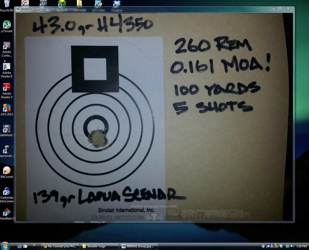

Here's a pic of a 5-shot group of my pet load for my 260 REM (43.0gr H4350 with 139gr Scenars) shot prone with a bipod:
