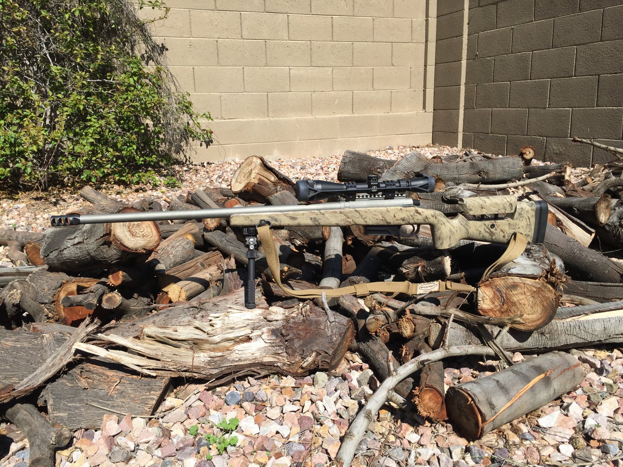

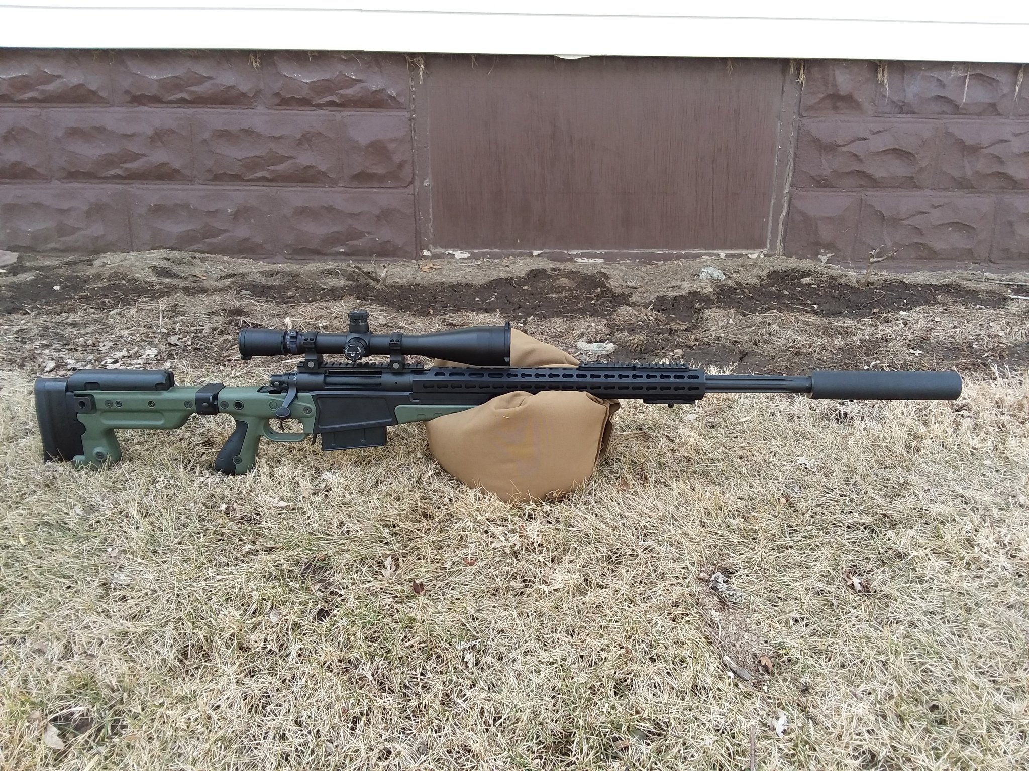

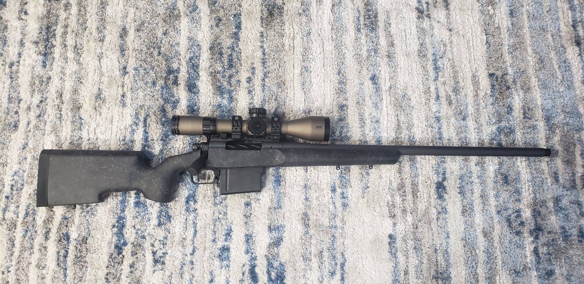

300 Norma Mag barreled action done by RWS. 700 ultra mag action/PTG 1 piece/ rock creek 9 twist. RWS was helpful with all of my questions as I decided what I wanted. Only a few rounds down range to start breaking her in but it looks very good so far! I'll update once I do some load development.

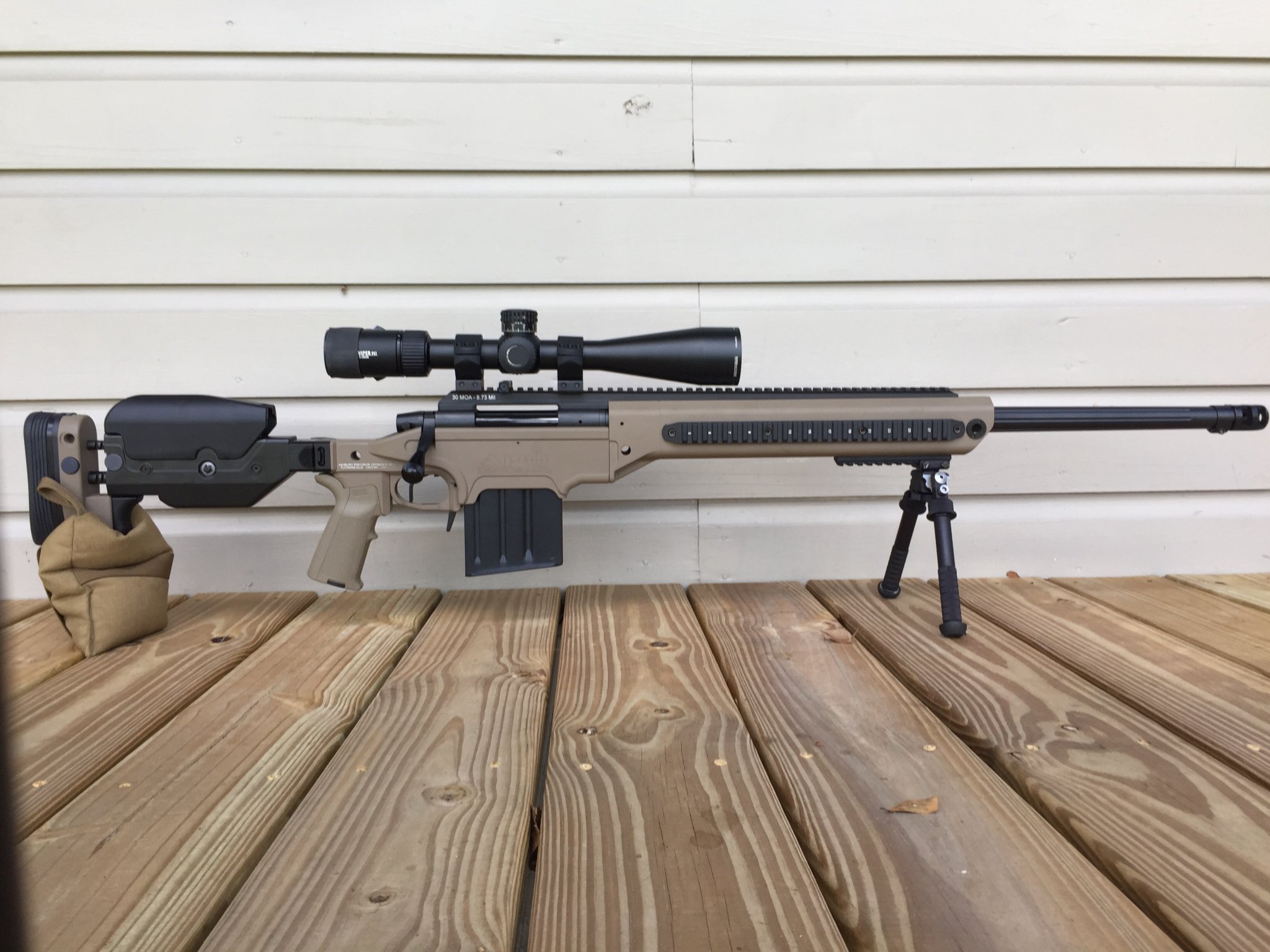

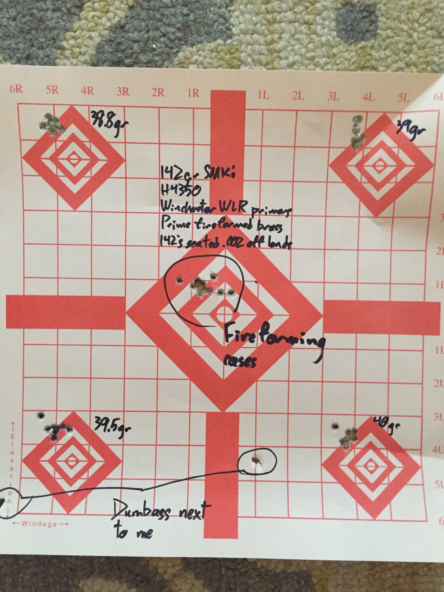

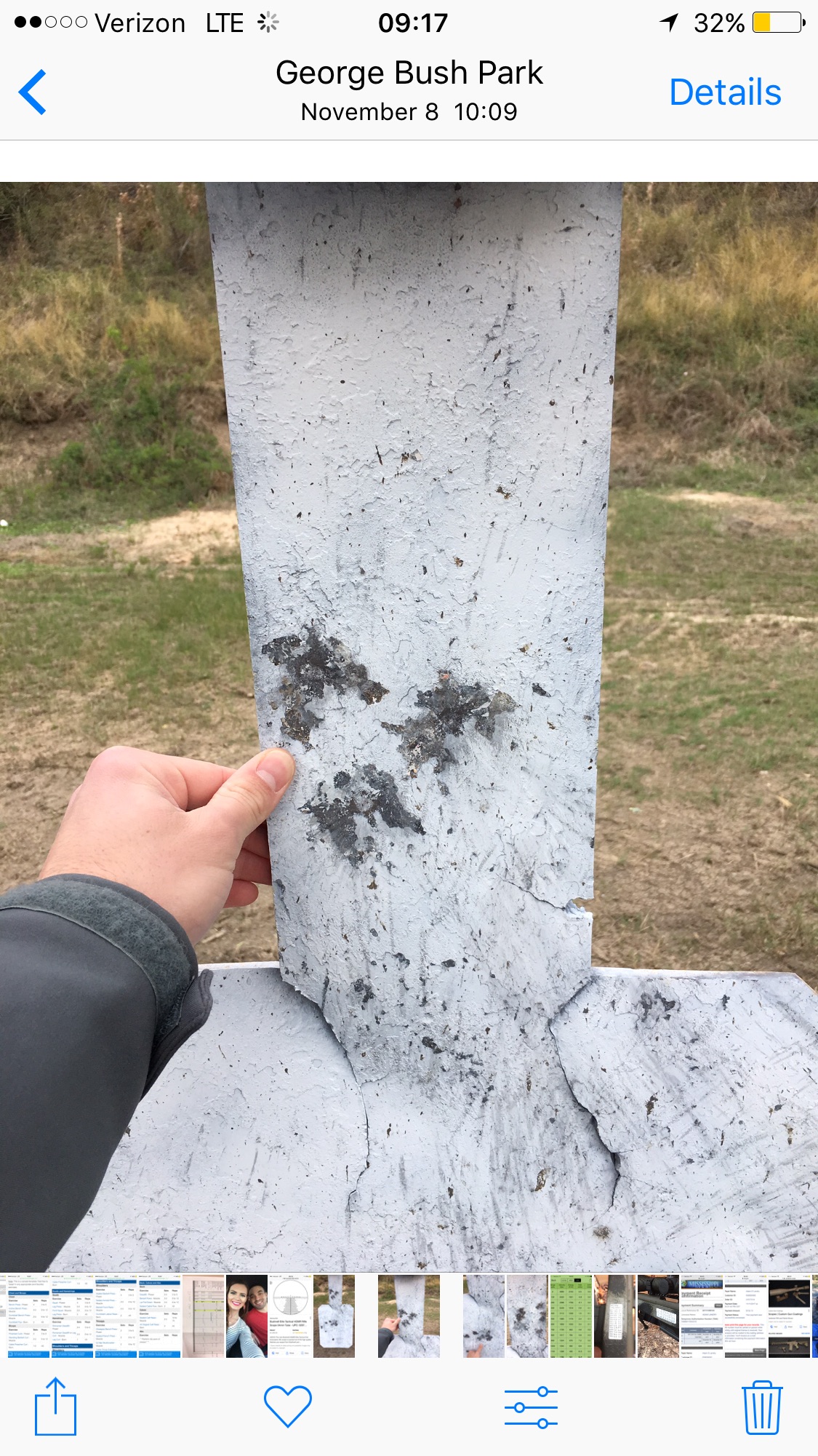

Rem 700 6.5 Creedmoor barreled action that Robert spun for me about a year ago. Here is a three shot group at 600 yards!

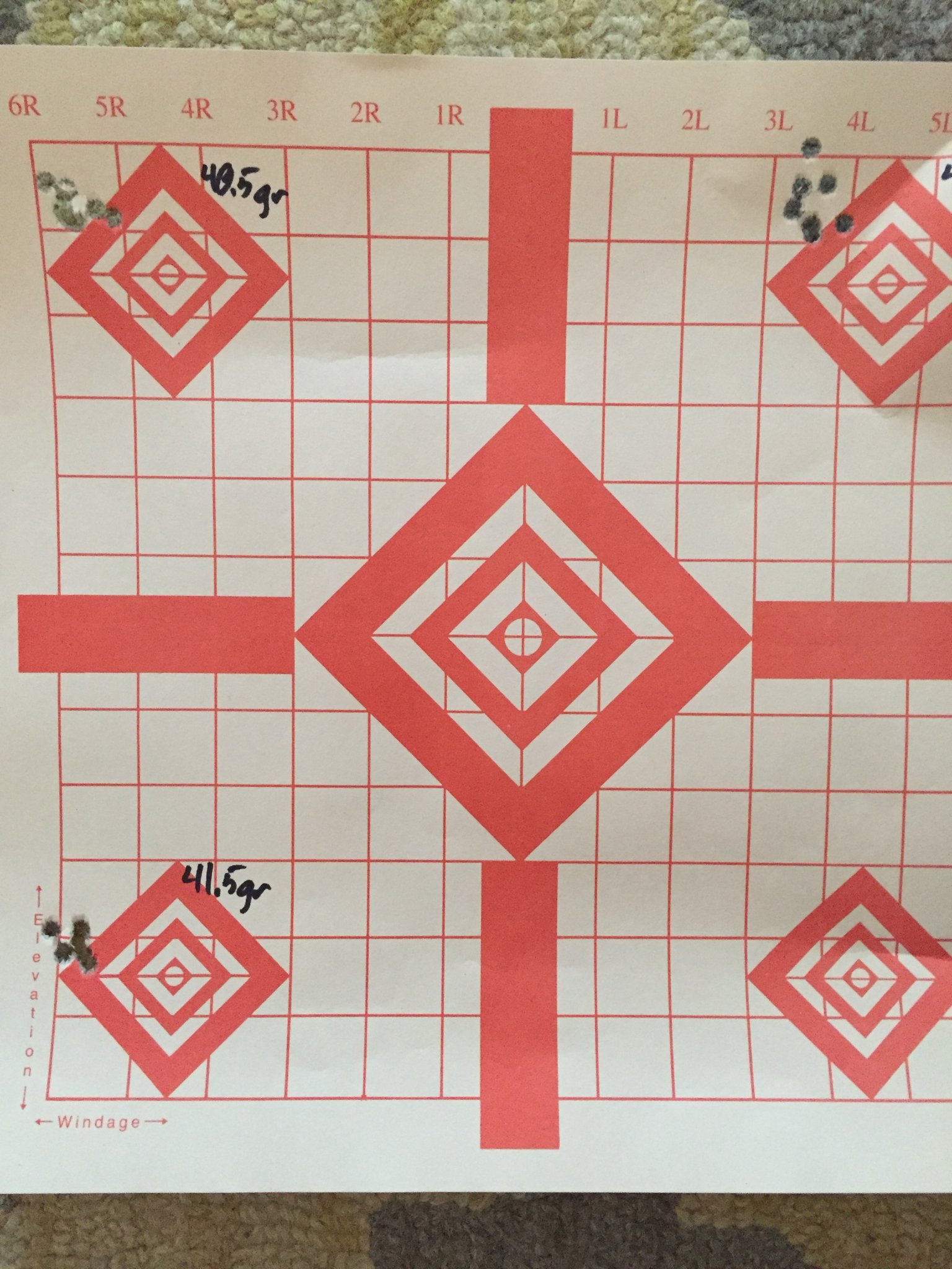

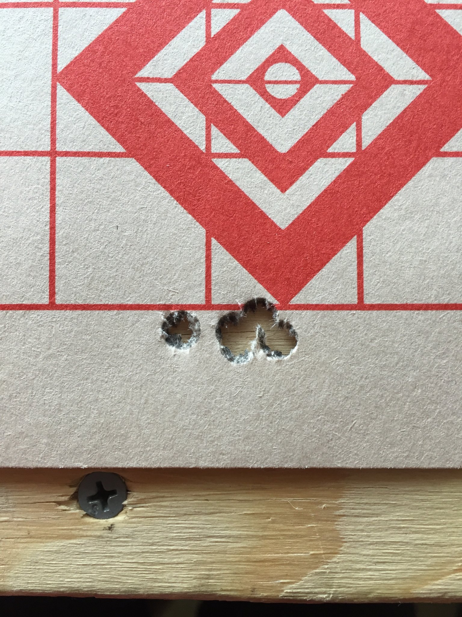

Any rifle has the potential to make a group like I posted above, only a properly bedded rifle will do it consistently even with different charge weights while ladder testing. The man knows how to bed a rifle.

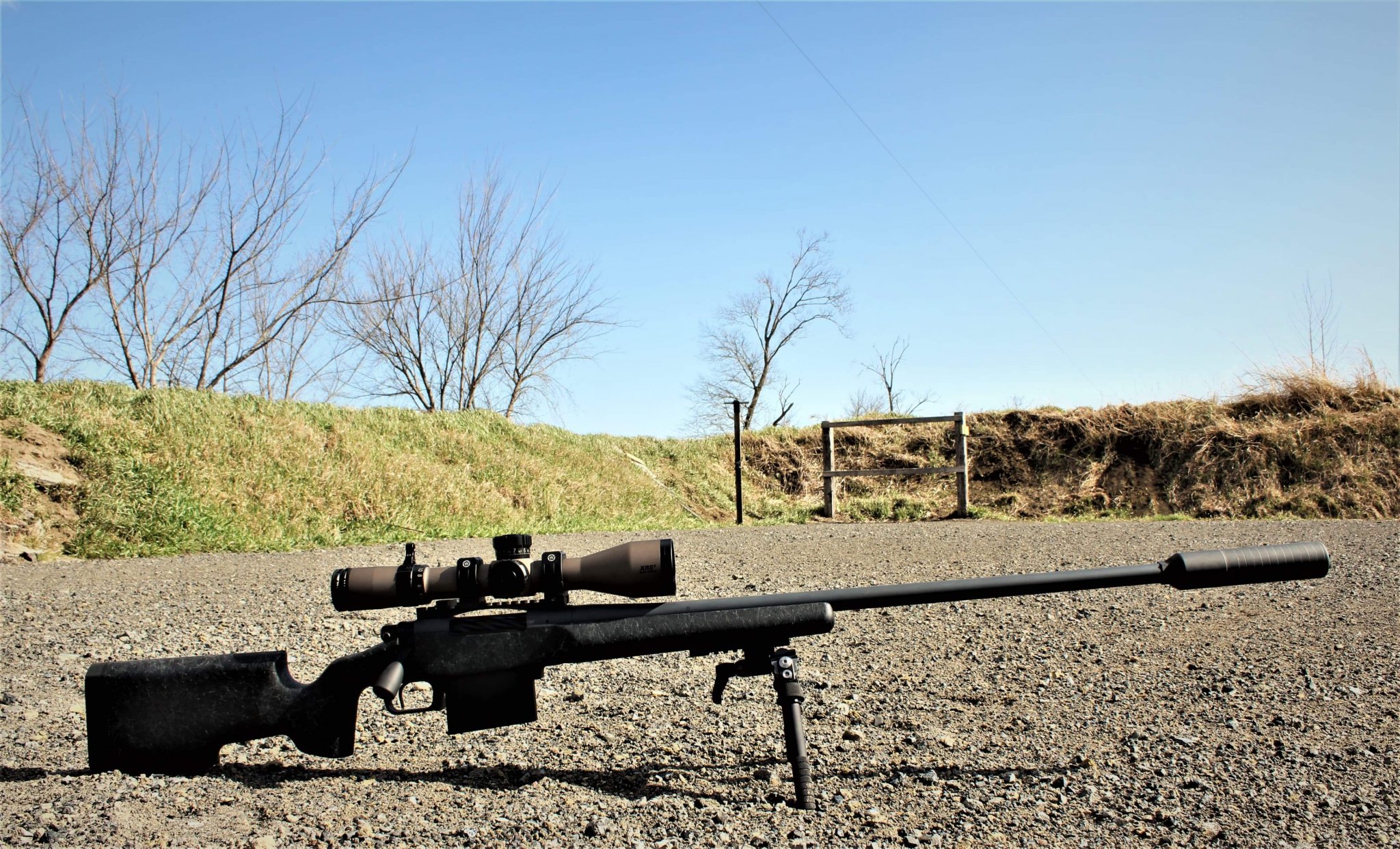

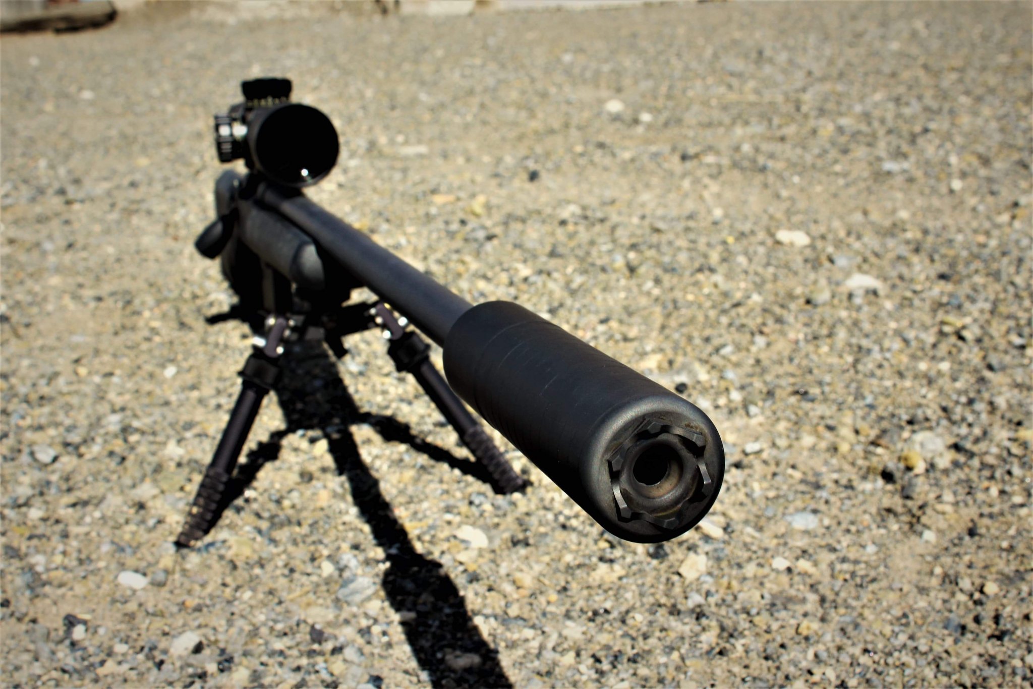

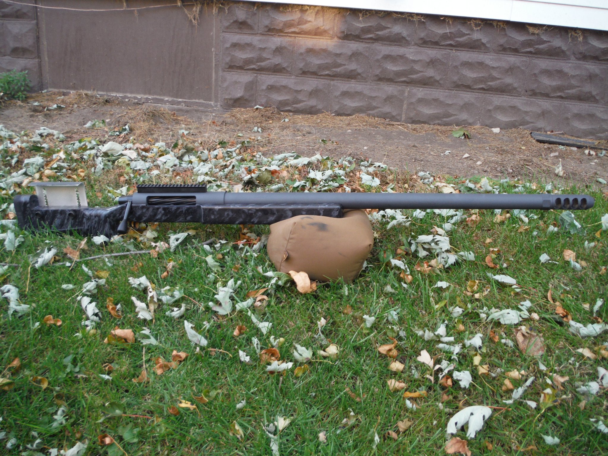

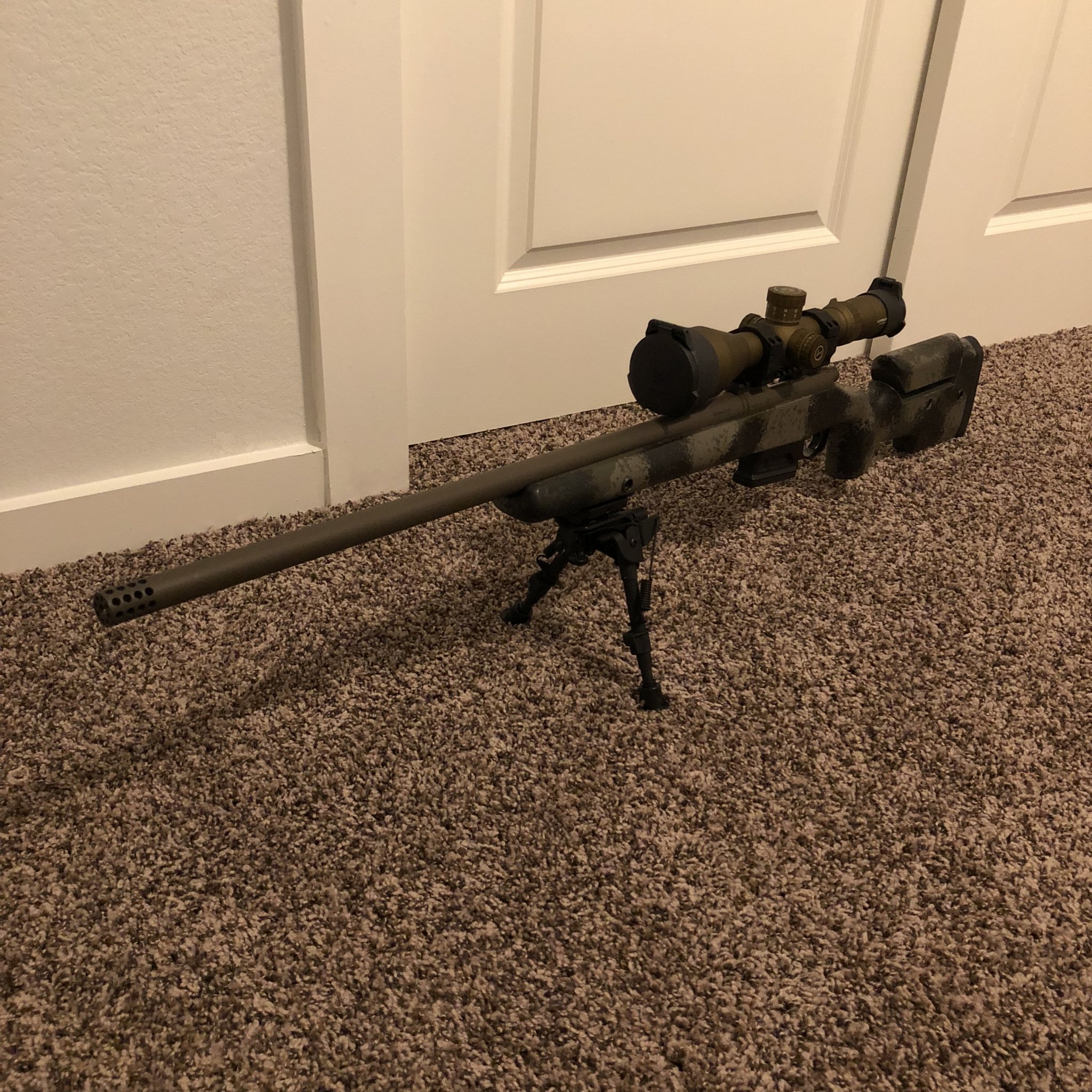

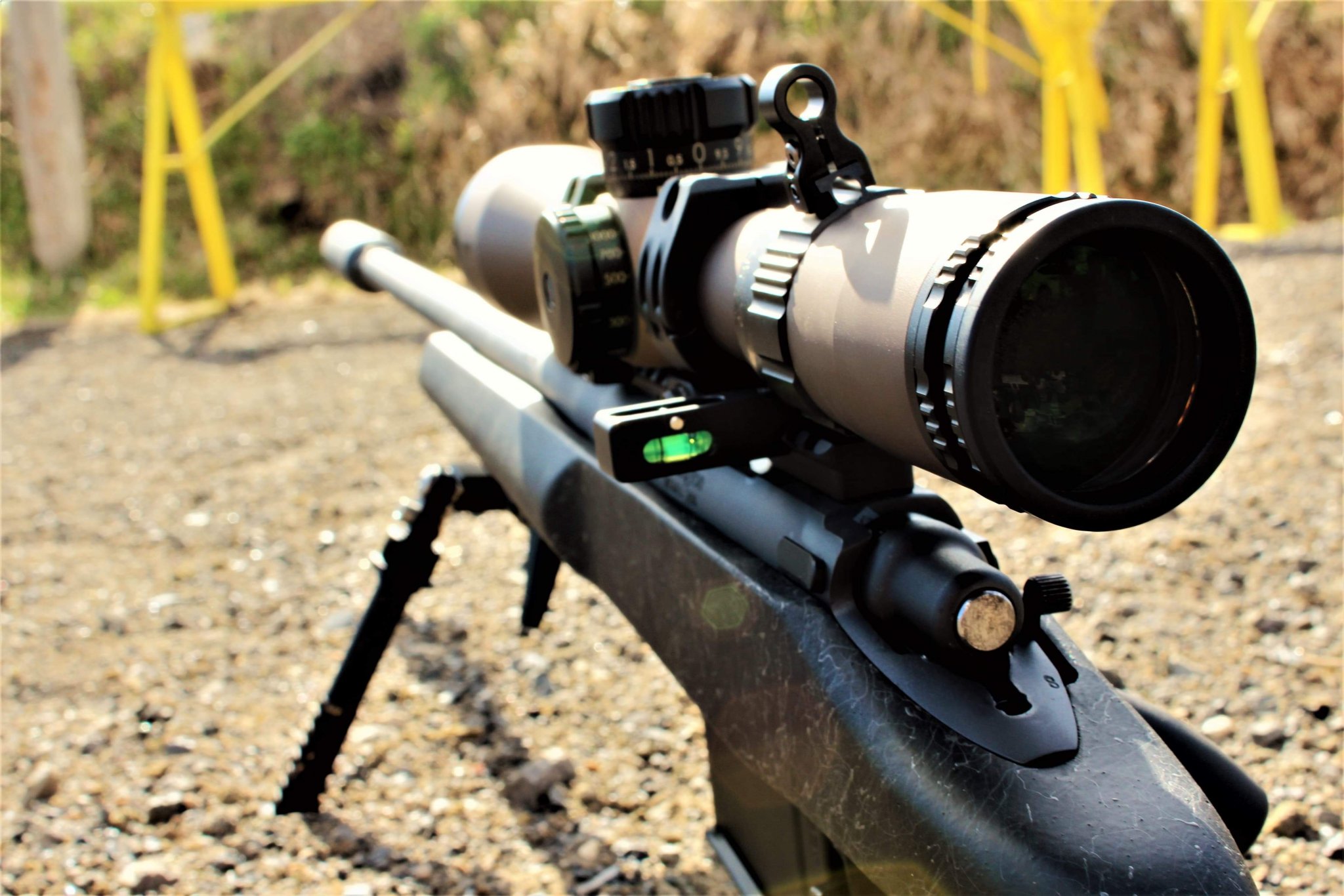

Had Robert rebarrel a R700 300WM to a 7SAUM. True/blueprint R700 LA Rebarrel, side-bolt release install, thread muzzle 5/8x24, enlarge and true rail mount screws to 8-40, helical flute bolt, open feed ramp/rails. Bartlein 8 twist 26", thread bolt handle/install bolt knob. Barreled action sitting in a Grayboe Renegade with Grayboe bottom metal, Area 419 20moa rail, timney calvin elite tigger, american rifle company rings, bushnell xrs2 4.5-30. I will be back to RW Snyder gunsmithing for more. Shooting sub-moa out to 1570yds. Will try to get some pictures uploaded.

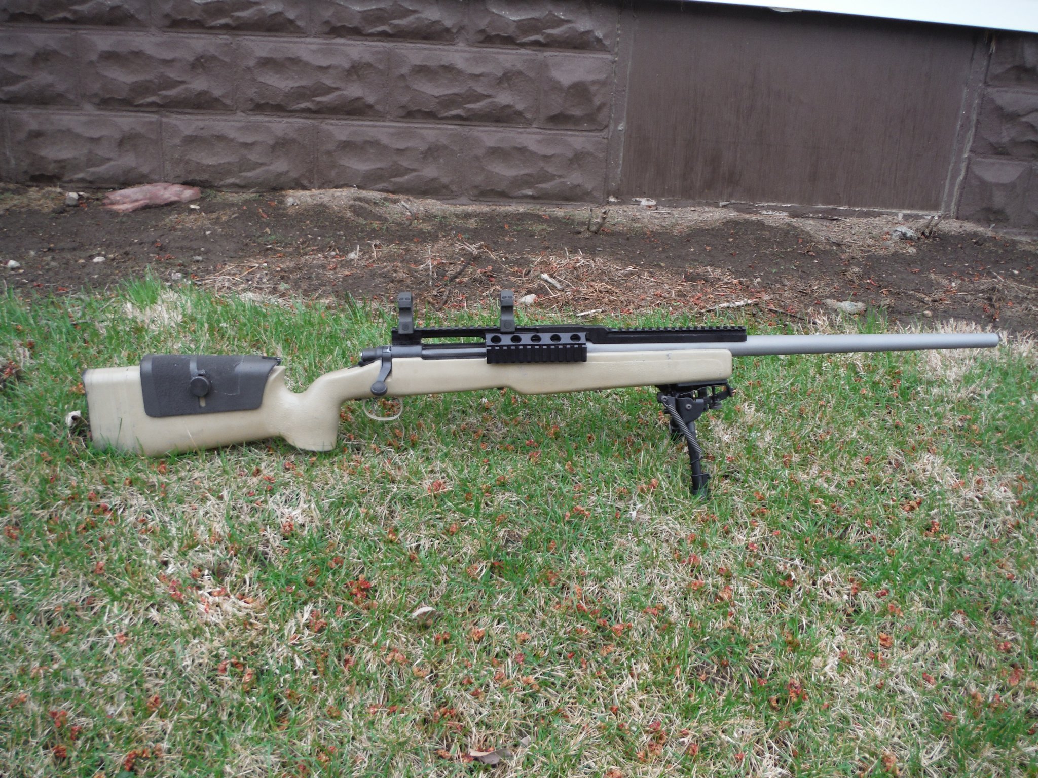

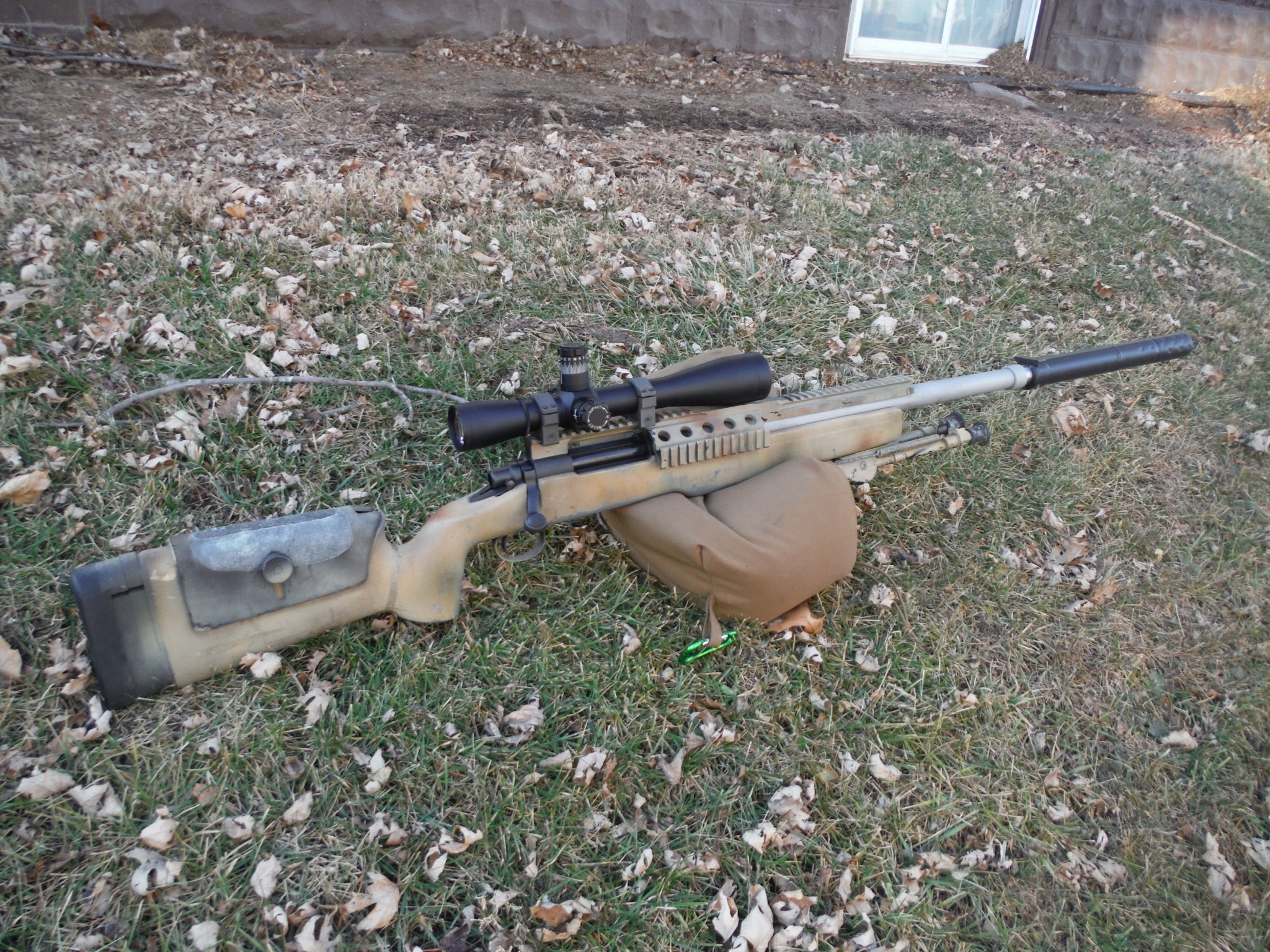

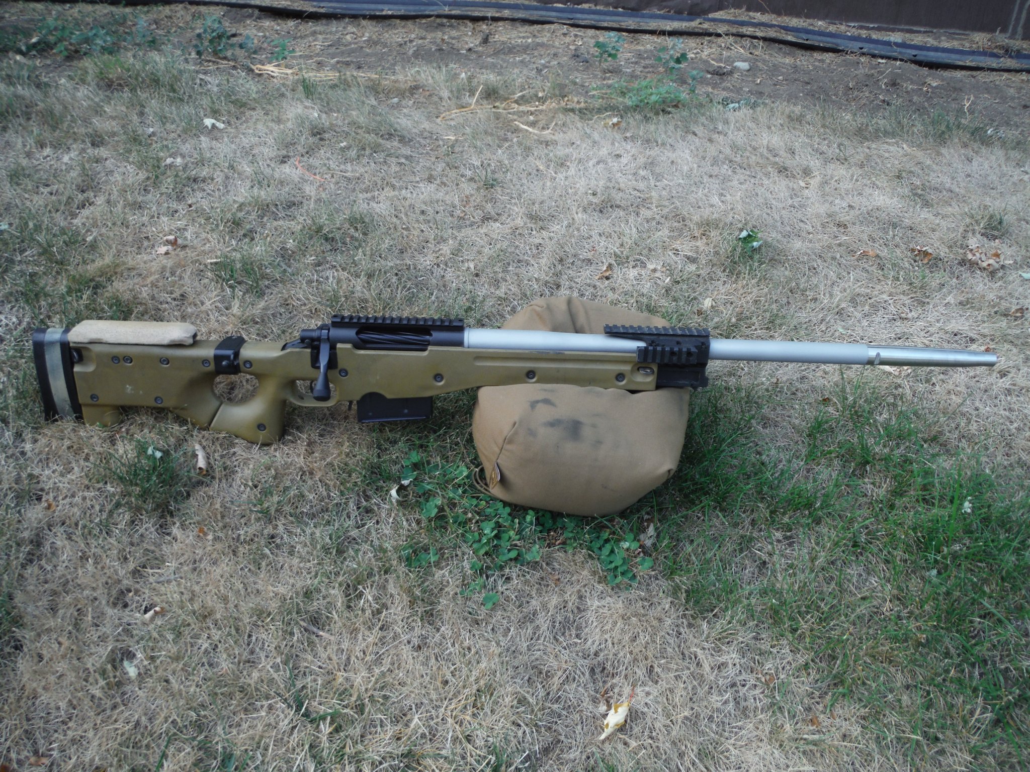

This guy is currently up for sale.
Mk13 Mod 5 sniper rifle clone. Built on a original return military stock. Receiver is a stiller. Correct Lilja profiled barrel with a 1-10 twist. Now I decided to try and replicate the markings as close to what the original had with hand stamped caliber and my label is at the bottom of the barrel so it isn’t visible when the barreled action is in the stock. Will ship in an ORIGINAL Mk13 Mod 5 case! Even though this is basically a brand new gun the stock and the case will obviously show signs of use, after all they are original military issue!
