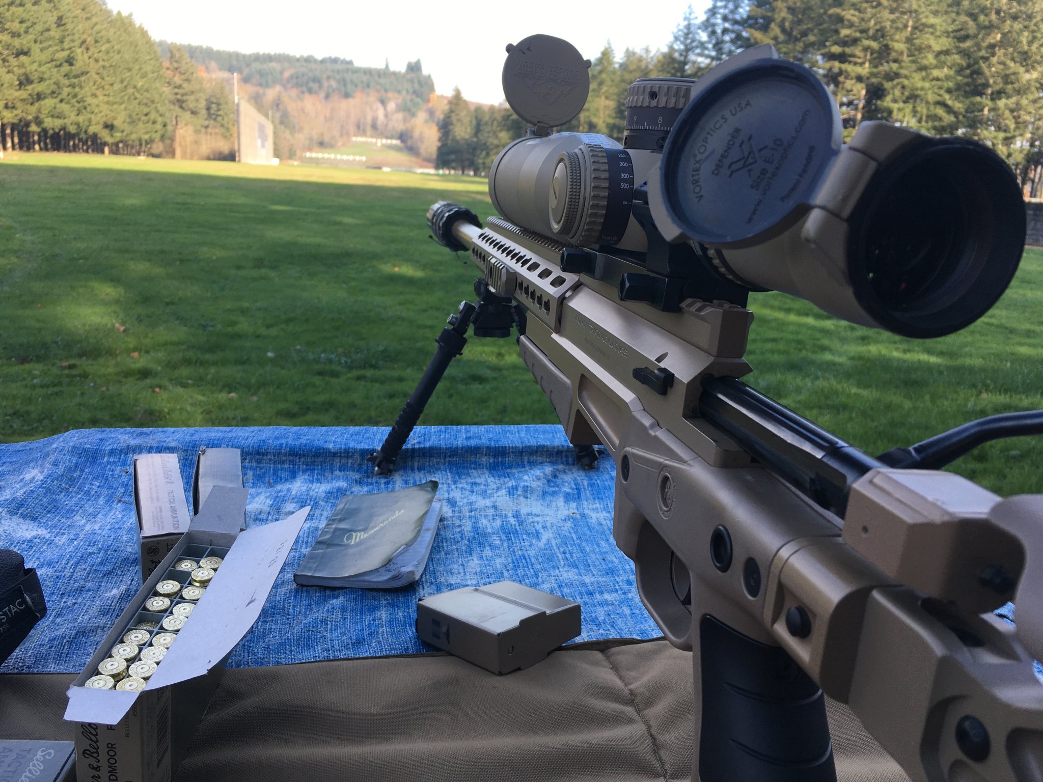

I just got back from the range and wanted to share my experience in testing the muzzle velocity of the S & B 6.5 CM 140 gr. My rifle has a 24" barrel and I was using a Magnetospeed Sporter chronograph. High 2,703 Low 2,672 Average 2,689 SD 12 ES 31.
