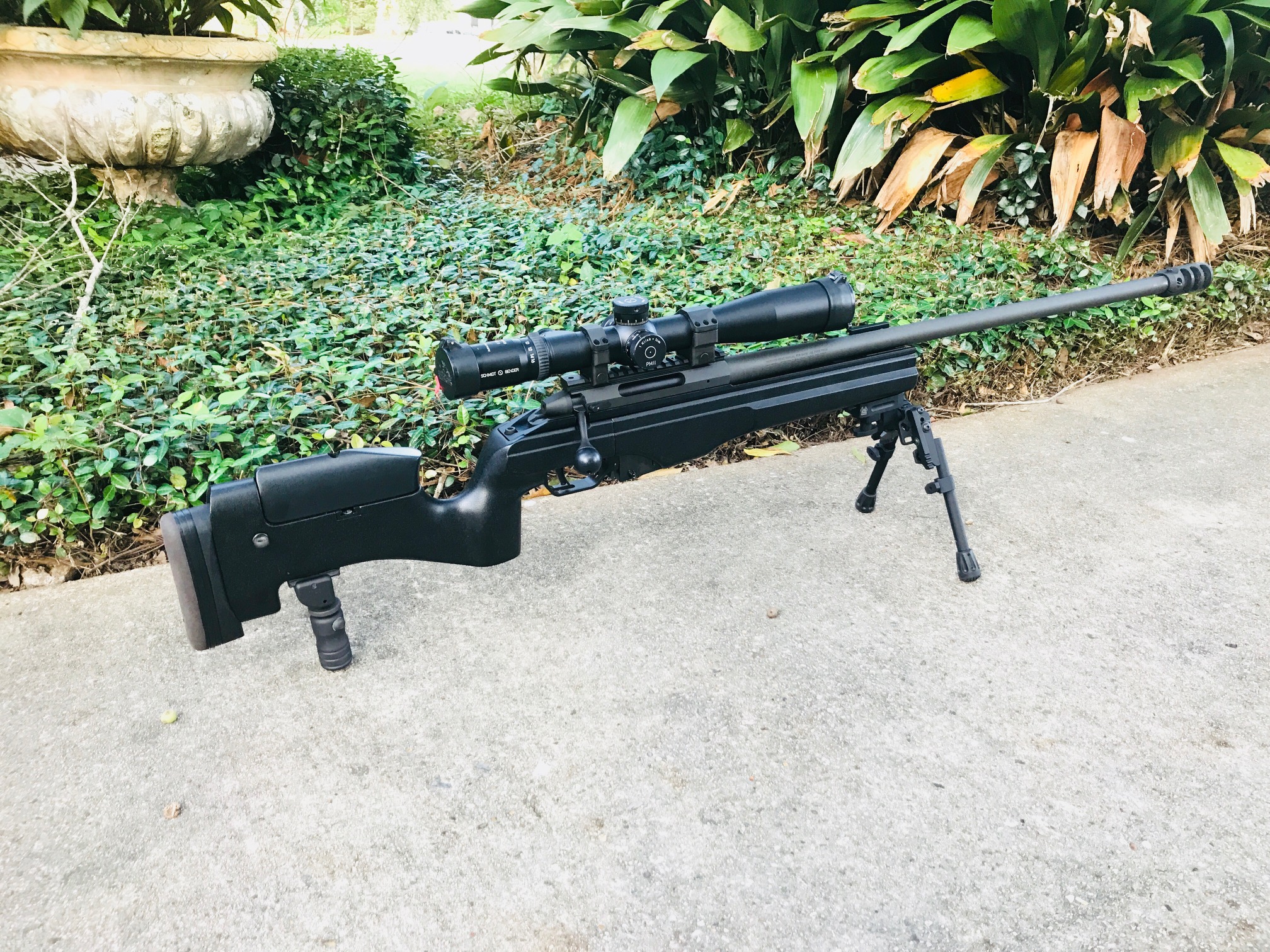

SAKO TRG-22
Re barreled in 6BR, other one i have in 6.5x47, both superbly accurate when i do my bit. Great rifles, parts are pricey, but they shoot sooooo good

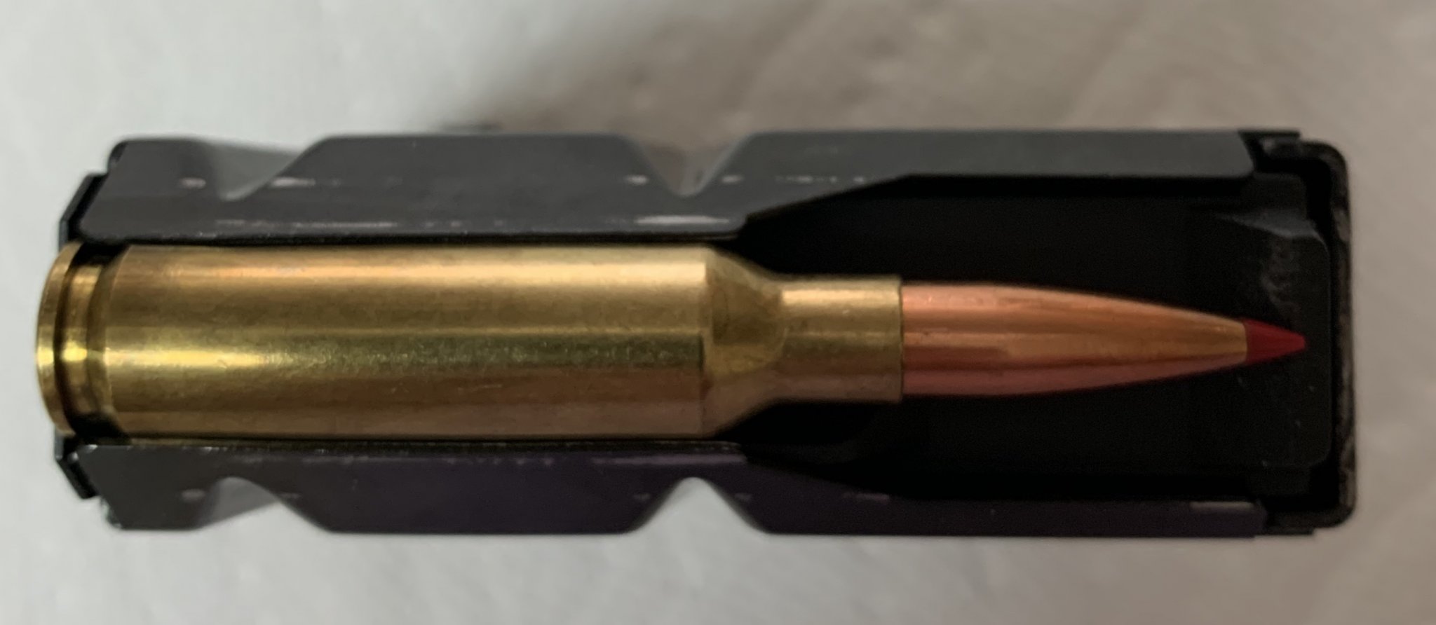

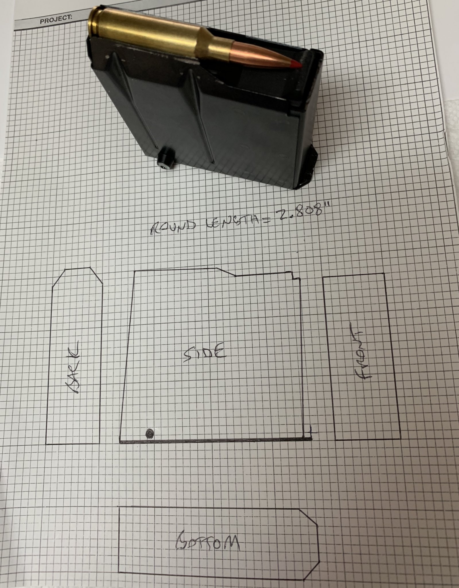

Question
What are the outside dimensions of the TRG-22 magazine and what is the max OAL/internal length?
I switched my TRG in 2013/2014 to the KRG AICS backbone, so I don't have a magazine anymore to measure.

Yep, not an easy magazine to measure, here’s a rough sketch not precision but you get the idea. (The squares are 1/8”) 2BE68FF6-2815-4885-A96F-F06714CB2068.jpegA7F84676-FE80-4F56-A440-34C006FA7CA1.jpeg
