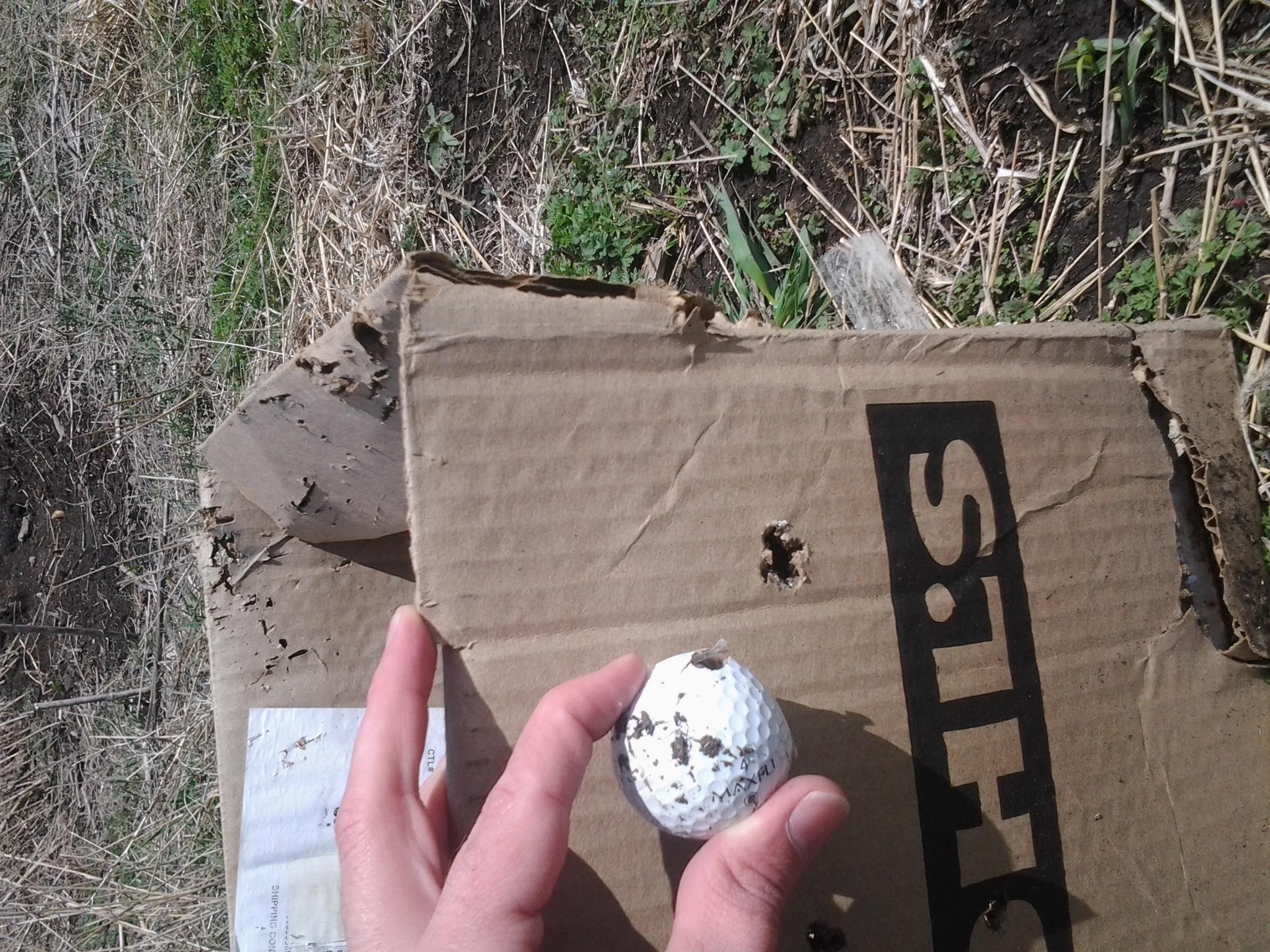

    I have the 110 BA in 300 Win Mag. It if you handload, you can get some really good accuracy out of them. This group was a 7 shot group from 100 yds.
    IMR 7828ssc
    208g Amax
    Nosler Brass
    CCI magnum primers
