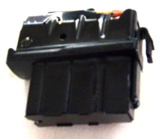

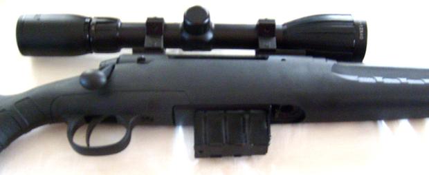

***I got a testimonial from a good customer... thought I would share. Thanks Alex!!***
Donnie,
Well here are some images of how the mag looks once its seated. The first time I tried seating it, it took a little effort to get the clip in the front to click into place but after removing it a few times and reinserting it, it can be done now with little effort. I loaded 10 rd’s in the mag and cycled through them all with no issues.
I am extremely happy with the mag and on looks alone, I love it! Again, thanks so much for the great work!
Thank you,
Alex

We've been working on another Savage design flaw for a few days and will post pix here. The plastic clip for these mags is a real problem, and we've had soooo many people ask about them...so we did a little R&D and came up with a "fix" for it. Everything we do on the .223s also translates to the .308s, so things should go quickly now.
We're anxious to hear what you think, so we are hurrying :)

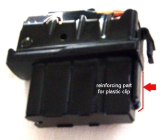

For those who have been asking us through our website, here is a picture of the "fix" we have developed for the plastic clip on the Savage Axis rifles. Makes it much stronger and easier to clip into the gun. Note the new piece welded just below the clip. This one goes out to a customer tomorrow :)
Magman2
Snyder Magazines

For jimtebow, and others who have read his amazing comments, (I blushed when I read them :) this issue with the metal back clip on the original Savage Axis magazines is a problem. In response to the issues some people have had with the metal back clip, our conversion process does nothing to this clip, it is just a faulty part we've inherited from Savage. Cartridges will not feed into the chamber if the magazine is improperly seated. However, we were able to do something about the front plastic clip, so we decided to make an adjustment to the Savage floor plate that might help that back clip a bit. We are also showing in all our videos that you need to "smack" the back of the magazine to be sure it is fully clipped in, once the front clip is engaged. You can actually hear the metal clip grab hold. This will prevent any problems with improper seating of these magazines, and should be done whether or not you are using an extended magazine or the original. DO NOT PRY ON THE METAL CLIP to try to make it fit tighter. It is a heat treated metal and will just snap off...we've learned this the hard way. I'm posting a couple videos below that shows this and if you go to www.snydermags.com Video Page, there are several more demos.

I would also like to mention, Tom has added a small piece of steel to the front of the magazine body to support the magazine band. This is a great addition to a solid design, and it has made the magazine AWESOME!! I have to say, Tom has got himself a WINNER on his hands!! Tom is good to go to take care of your magazine needs for the Savage Axis/Edge rifles... AND ALSO... The front magazine release tab can be removed to use with the Model 10, 11, 12, 14, & 16 rifles!!!!
