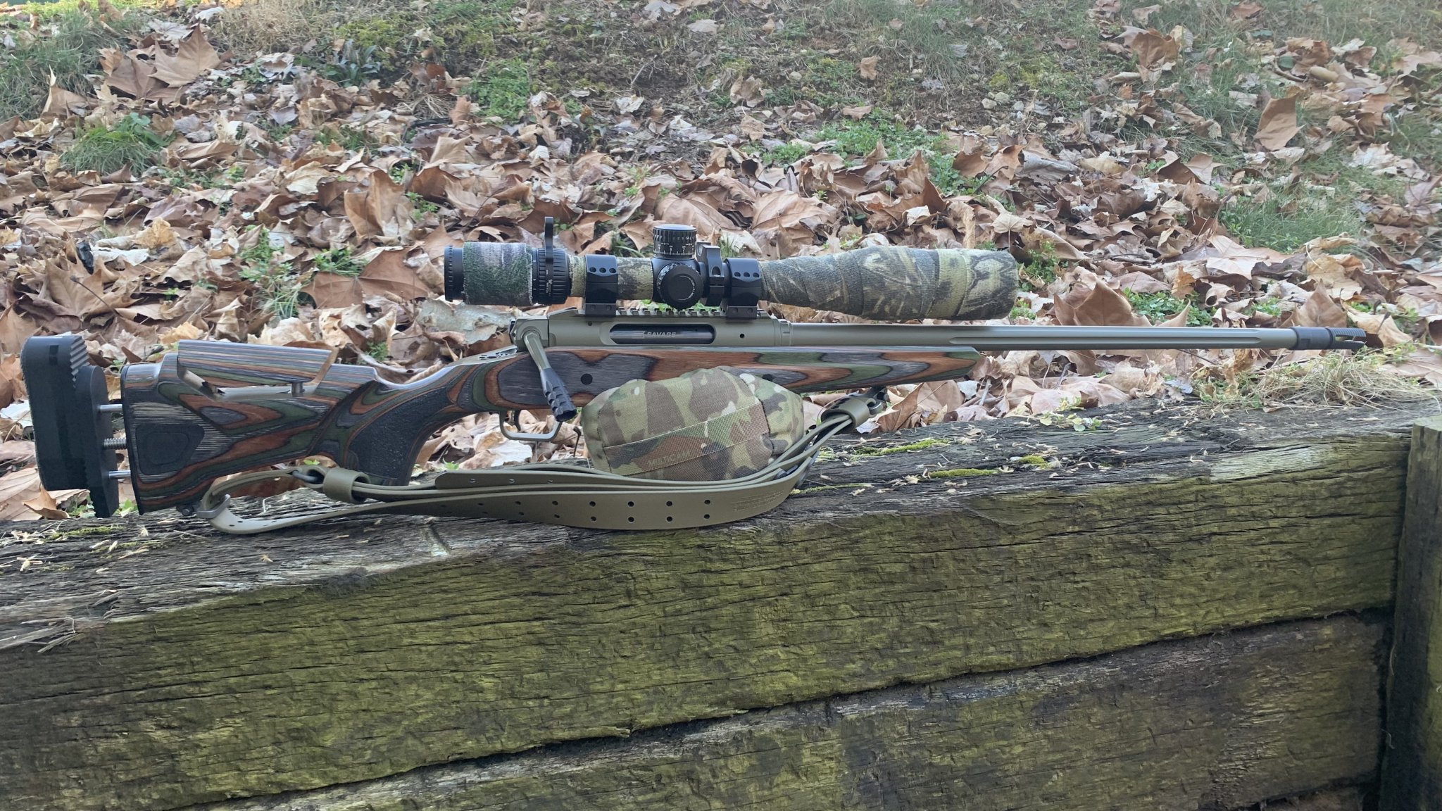

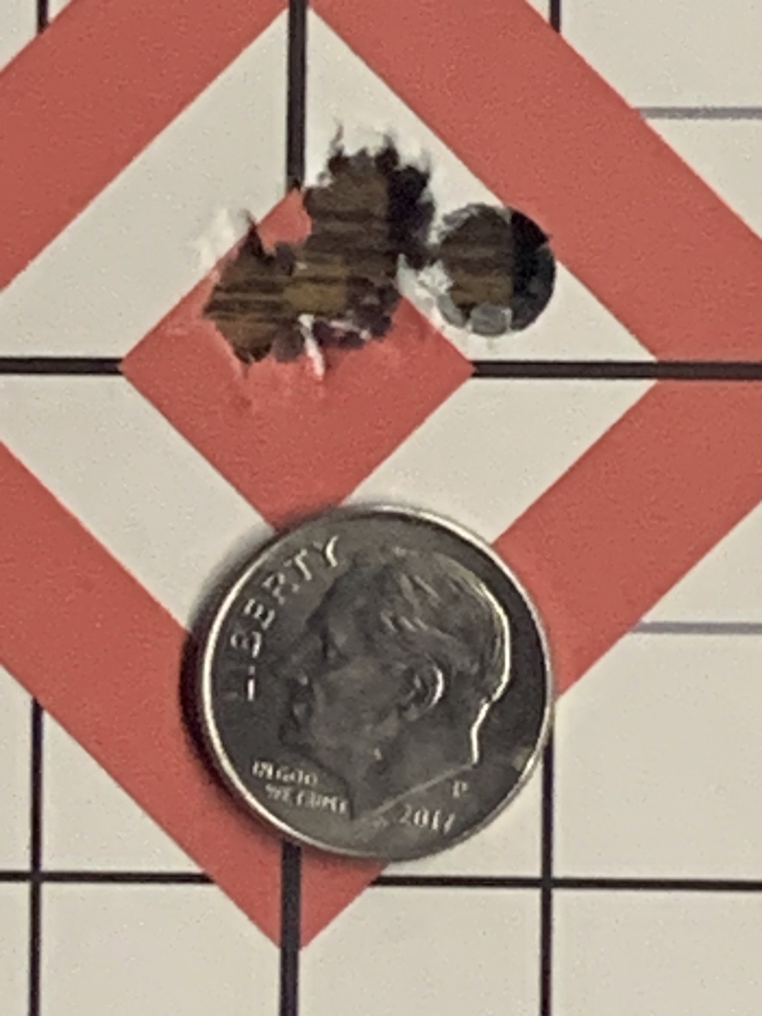

This is my Savage Impulse in a Boyd's stock and a group it produced. By the way, this thing hates bipods. It will only take a Harris or Magpul but with them the croups approached your 6 inch results.
I now shoot it prone, resting on the bags with my support hand under the fore-end pulled tight against my shoulder.
Before I did that, I tried everything and the groups were really large. So out of desperation, I pulled off the bipod and held it like I did my WW2 sniper rifles and Winchester M70 Bull gun, which don't take bipods. I really love this rifle now.

Thank you for your input and that is a very nice rig and an even nicer group. Two rules I have is never hunt/shoot with a clean bore, never chase the "0" after cleaning a barrel. Have a 7mm/08 that takes more than 9 but less than 12 to come back to true "0". I use an Atlas bipod for PRS and a Pheonix bipod for ELR, both excellent for their intended uses. I do appreciate all the input from the site but I believe it will take a trip back to the factory to fix this rifle, which is really sad. My Savage Axis II will shoot 0.75 on a bad day when I'm SWHUA (shooting with my head up my axx) and one hole groups when I do my part, which is why I'm really disappointed with this rifle.
