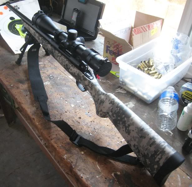

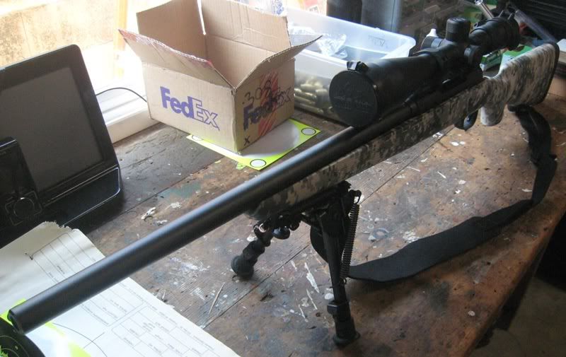

I finally got some time to give a range report from my new Savage Precision Carbine in .308. My wife bought me this rifle for my birthday in April (pretty cool eh?) and I then bought a Vortex Viper 6-20x50mm from Scott at Liberty Optics (excellent service) to put on top of it. I plan on using this rifle for pig / deer hunting since its pretty lightweight and nice to tote around since it only has a 20 inch barrel.
Here are the specs and some pics -
Savage Model 10 Precision Carbine .308 win
Vortex Viper 6-20x50mm w/ mil-dot reticle
Leupold Mark 4 30mm medium rings
Warne Savage base
Harris swivel w/leg notch bipod

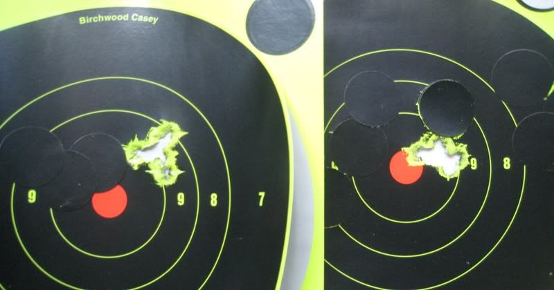

I have 220 rounds through this rifle now and. This last Saturday I fired 40 rounds and here is the two best five shot groups, one is slightly under .5 inches and the other is slightly more than .5 inches at 100 yards.
This is with Hornady match brass 3x fired, 42gr varget, CCI BR2 primers, 168gr SMK, 2.805" COAL.
So far I have really enjoyed this rifle, for a completely factory rifle its shooting 1/2 MOA already and I really haven't fully dialed in my handloads yet. For ~ $700 its a hell of a deal.
