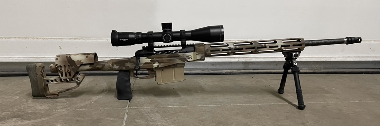

    finally finished the build. Got a used xlr evolution gen2 (really bad Duracoat job so it was cheap) and had it sand blasted and cerakoted. It came with a 3.850 CIP mag. Used a mpa feed lip tool to set the height correctly, but then the rounds would get hung up going into the chamber. I ended up trimming the feed lips back and polishing them. Feeds butter smooth now.

    Is that primarily a hunting or target shooting/steel hitting rig?
    Looks the goods though, cheap rattle can paint job aside
