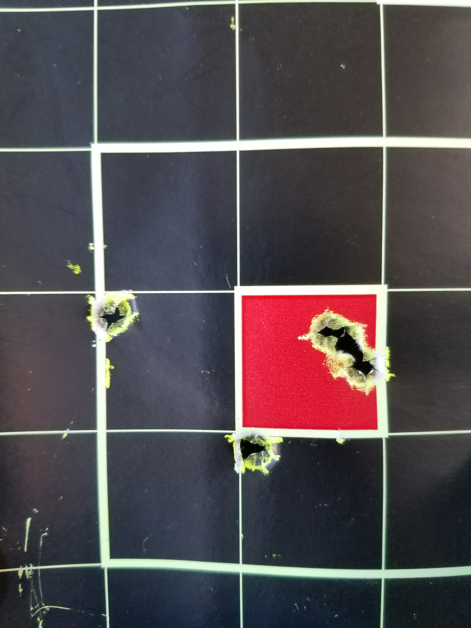

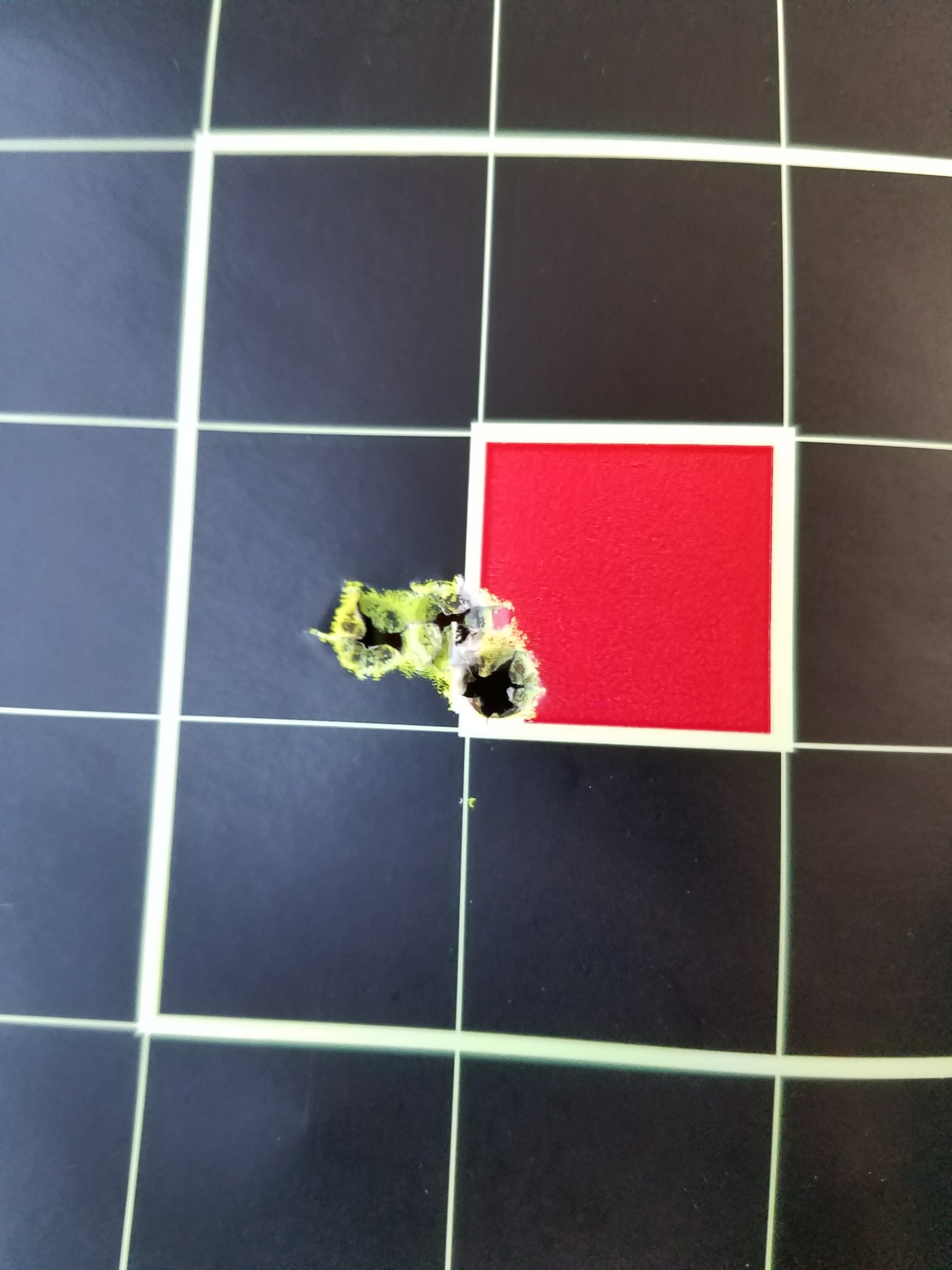

Okay guys, don't make fun since I'm still a super noob at this (aka, terrible at shooting groups still). I had 8 rounds left in the box so I decided to shoot a 5 and 3 round group. I pulled the first two of the 5 shot group (called) then settled down for the last three and the 3 shot group.
I think this rifle will shoot. .675 and .562 edge to edge, so .411 and .298 CTC.
Reactions: 10ring1
