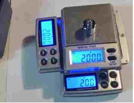

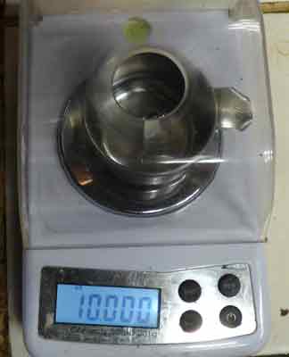

The cheap scale I use (Much less than $50) has a 50 gram full scale.
It reads to 0.02 grains but it's best resolution is in carats. Displays to the nearest 0.005 carats.
That's better than 0.02 grains (by a little).
Mine is very repeatable if I keep room temperature constant (between HVAC cycles) and monitor performance during a charging session.
I have no doubt believing my target charges are better than +/- 0.1 grain.
My vendor (in China) will not stand behind this scale that is a couple YEARS out of warranty.
Here's a short video of Charging on the CHEAP :)
EDIT, I just powered it on, let it sit for a minute and checked a 2 gram, 10 carat, M1 weight, without recalibration.

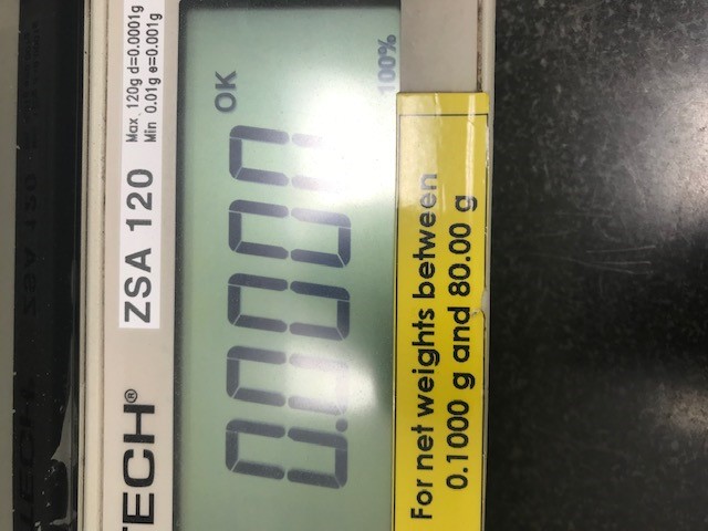

manufacturing pharmaceuticals we have scales up the ass around here.
scale example:
lets say we have a scale in the pharmacy that is a 500g scale +/- .1g.
you would think the range is .1g to 500g at +/-.1g.
nope
the +/- .1g is only for a range within the range:
its +/- .1g from 180-320g
its +/- .2g from 120-179g ..... .1g from 180-320g ....... .2g from 321 to 400g
and so on and and so on.
the booklet or manufacturer will have information on this.
we have different scales in each pharm room for different weights heres a pic from this morning.
this is sold as a 120g max etc scale but we only use it for .1- 80g of material.
for lager or smaller amounts we have different scales on the same bench.
the actual lab is a different story all together.
what im trying to get at, is if you are going to get anal about weights and are trying to do it on a tight budget research the scale you are looking at.
no use finding a deal on a scale the is worse than what you have now because of the range you are working in.
shit even our calibration weights that we use to calibrate our scales daily have to get calibrated once a year by a outside company.

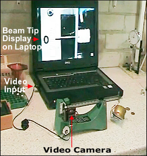

While I recently purchased an A&D Fx120 and that is and will remain my primary method. But I also recently bought a vintage Ohaus beam scale on eBay to play with. In addition to the excellent suggestion above, the link below has some good tips on how to tune up your beam scale yourself...
Beam Scale Tuning
1. Polish the knife edge (I used a ceramic hone for this)
2. Clean the agates and agate holder to ensure free movement of the agates.
3. Level the scale body, then adjust the weights inside the pan holder so that when the scale is zeroed out, the body is also pretty much level as well.
4. Adjust the hanger wire for the pan so it doesn't bind up.
5. Add a needle to the indicator at the end of the beam (will require you to adjust weights in the pan holder). Helps for reading when using a USB camera such as above (I haven't done this yet)
There are then tricks to ensure linearity throughout the range of the scales capability, but I haven't gone that far. Lastly, don't roughly handle your scale.
All of this (vintage scale via eBay, tuning/cleaning, USB camera) can all be done relatively inexpensively.
