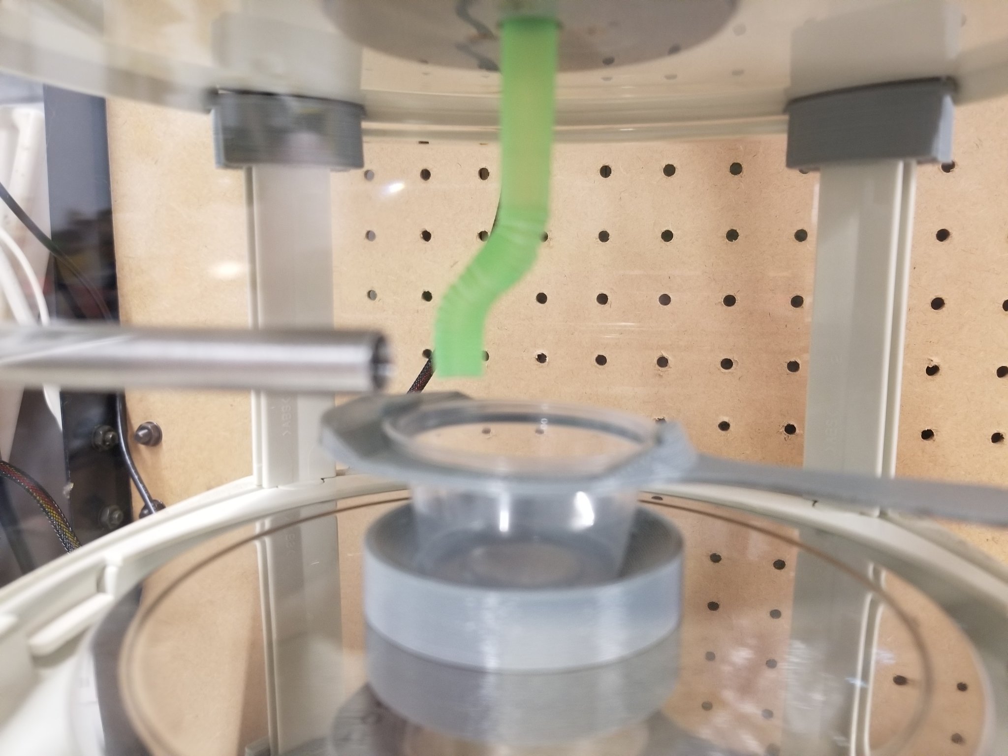

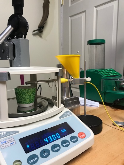

seriously though, I was annoyed with kernels jumping out of the cup and pill bottle I tried. Bought 3oz Dixie cups and cut them down. Work way better.

Looks like you cut off the bend in the straw like the instructions say to have, thats probably why you are having kernals hop out. They are shooting out too fast.
I have had one or two bounce out but nothing that has caused me to need to cut off a dixie or pill bottle.
I put a dogleg bend end at the end of the straw. It decerates the kernels before they dump into the plastic cup provided with the thrower, zero bounces. Haven't used it much; assembled an OCW with 115 DTACs (33 rounds) for my new 6x47 Lapua and 50 rounds of 6.5 CM. It works very well IMHO. Much faster than I can do it manually with -0/+1 milligram repeatability.

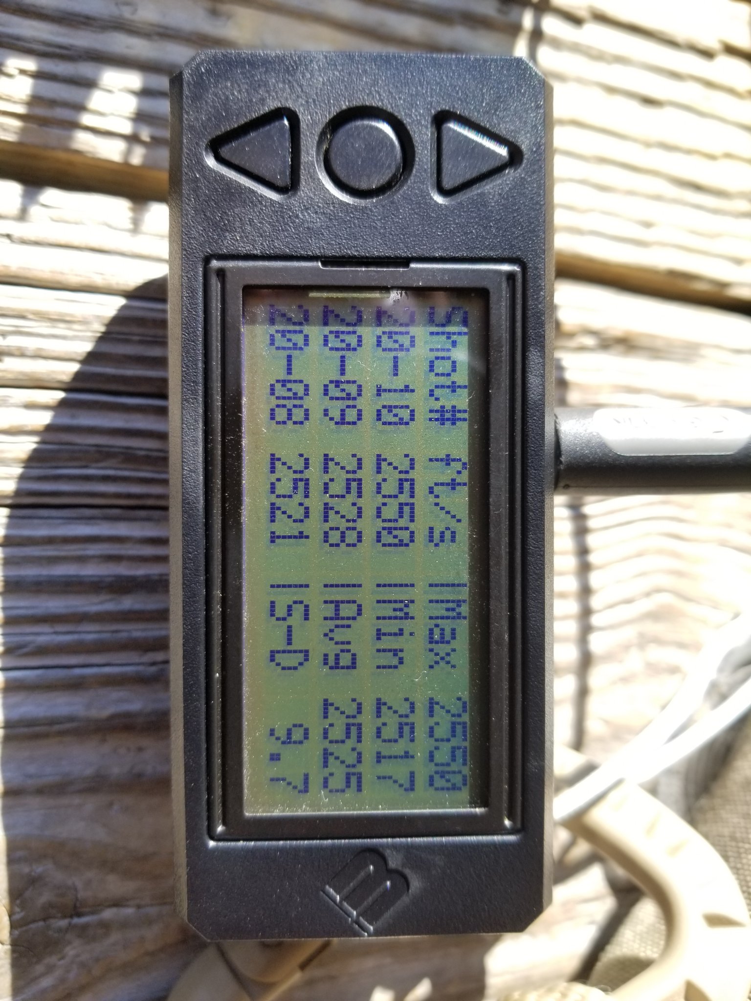

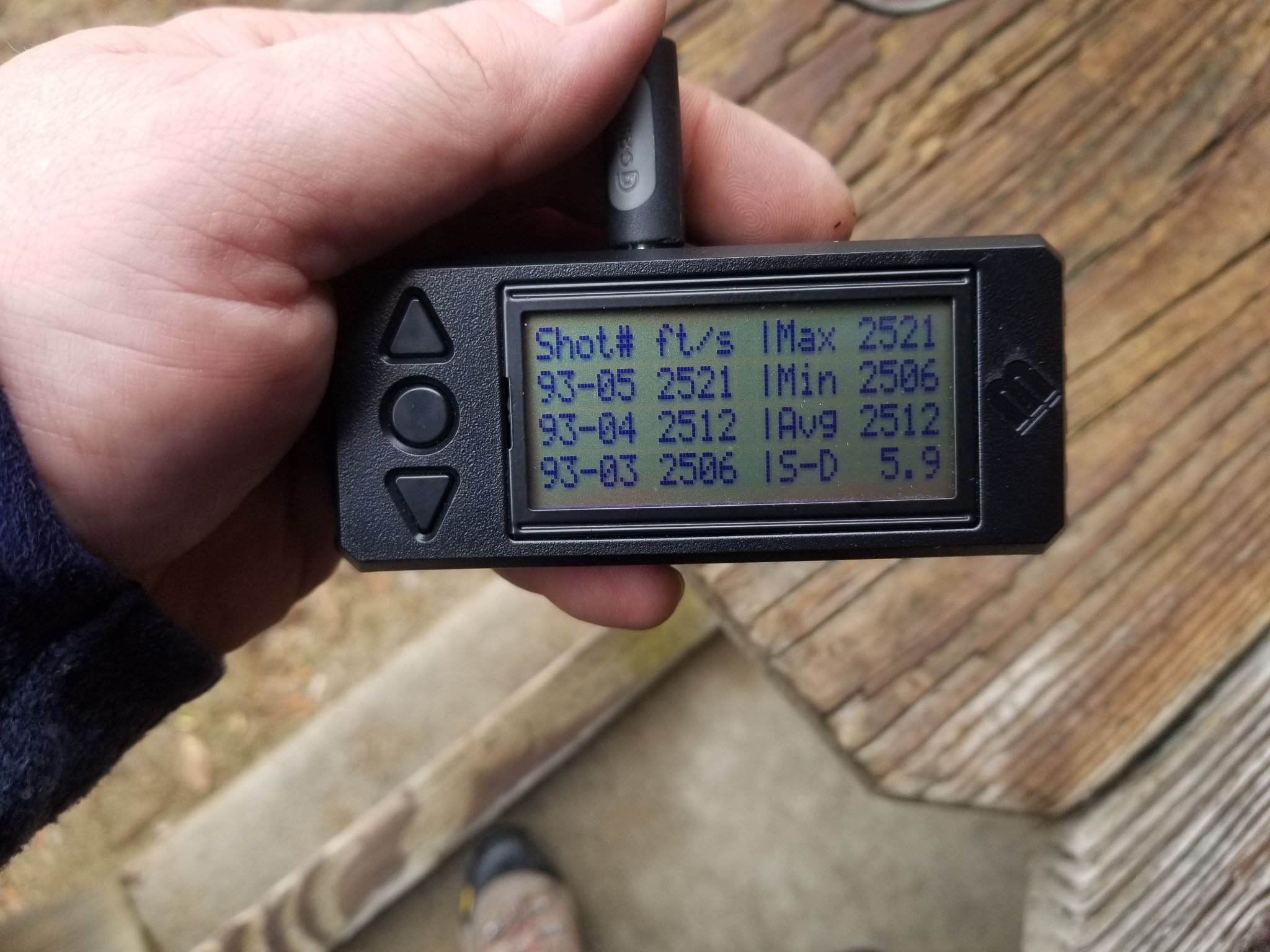

I have. My Magneto Speed mounts to my rail and not my barrel. I'll post a picture of that data when I get a chance, it's single digit as well.
I think it answers it and it doesn't if that makes sense? 600 yards is a good distance to check vertical but 1000 would've been better. On another note the Harrel's for instance with the 6x47 load had twice the sd/es but had almost as goo of a group as the AT and Prometheus. the ES was 34 with the Harrel's and 11 and 14 on the AT and P respectively. That being said I don't think the groups are the best way to measure the value of different powder drops(human error and such, wind, etc). The CM and Hornady both had worse groups but better SD/ES than the Harrel's. Either way the ES/SD from the AT and P were almost half the CM and Hornady. That makes a difference somewhere.
Interestingly enough in the 6.5 gas gun the ES/SD's were a lot closer. Maybe thats just a function of a gas gun and why they're harder to tune for long distance. Not a gas gun guy so I don't know.
