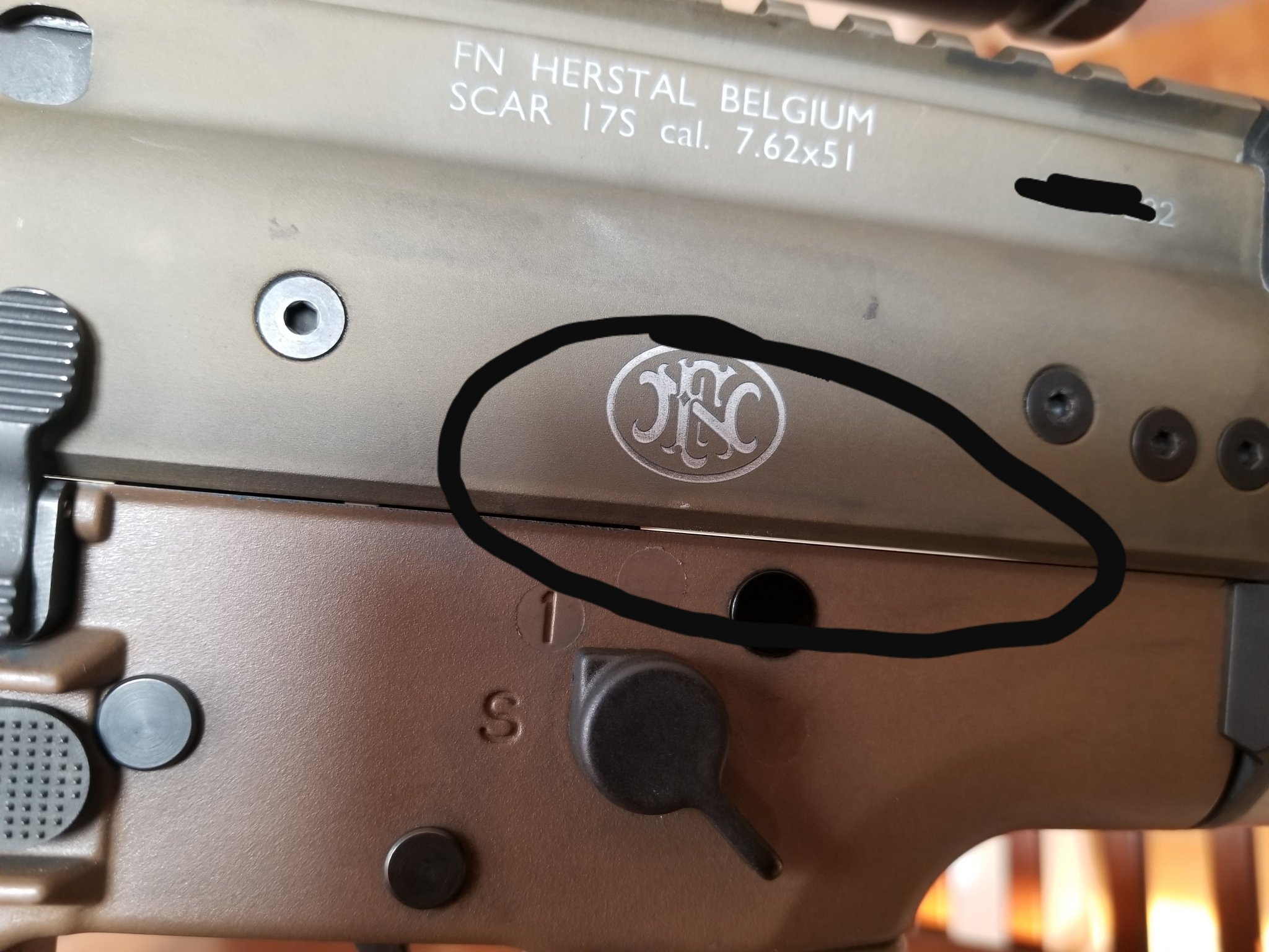

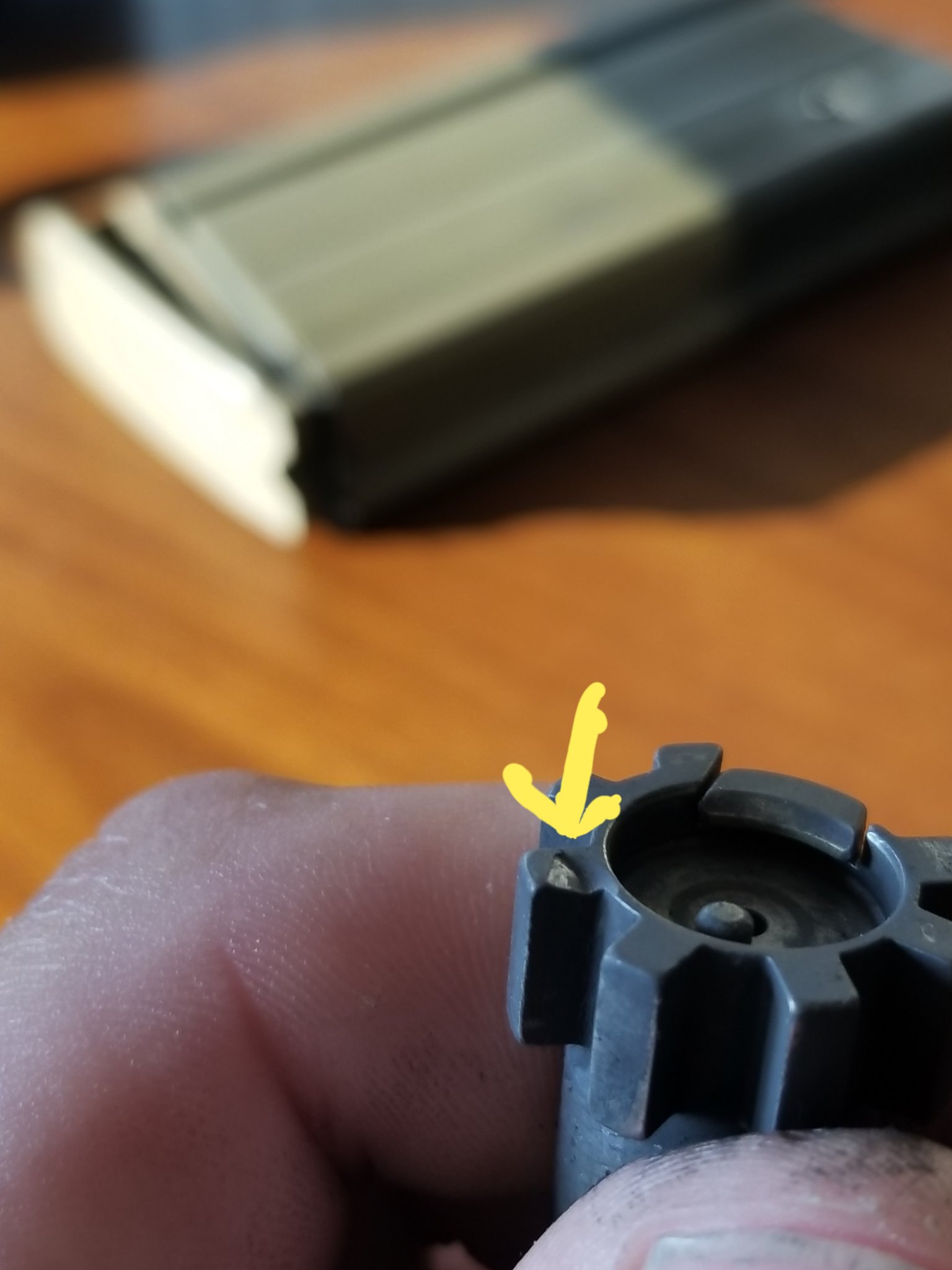

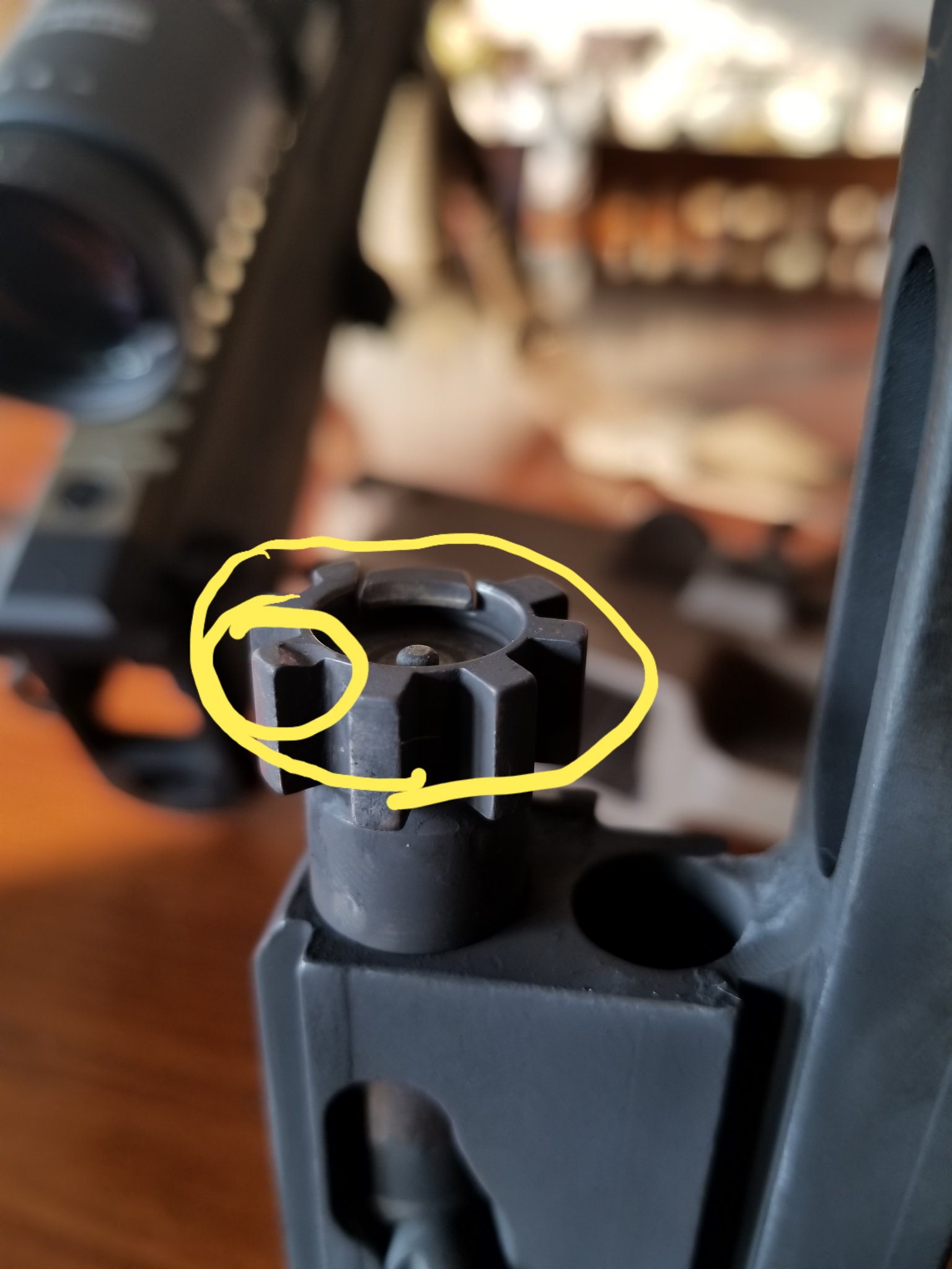

So was looking at the upper and lower last night. Theres a slight gap between the 2. Dont think it would be enough to throw it off tho? And just took it apart again and neve noticed this groove on the bolt head. Not sure if its supposed to have a large indent or not. If anyone has a scar 17 do you mind looking to see if yours does also?

the upper receiver TO optic mount TO barrel mount should be one 100% tight piece and lower slop shouldn't cause an decrease in actual accuracy maybe increase the difficulty to shoot accurately. That slop your referring to was probably also
there was the gun was factory and you had no problems. I would look for barrel flex in this type of setting and see what happens. However it still shouldn't be affecting your precision only changing your zero.

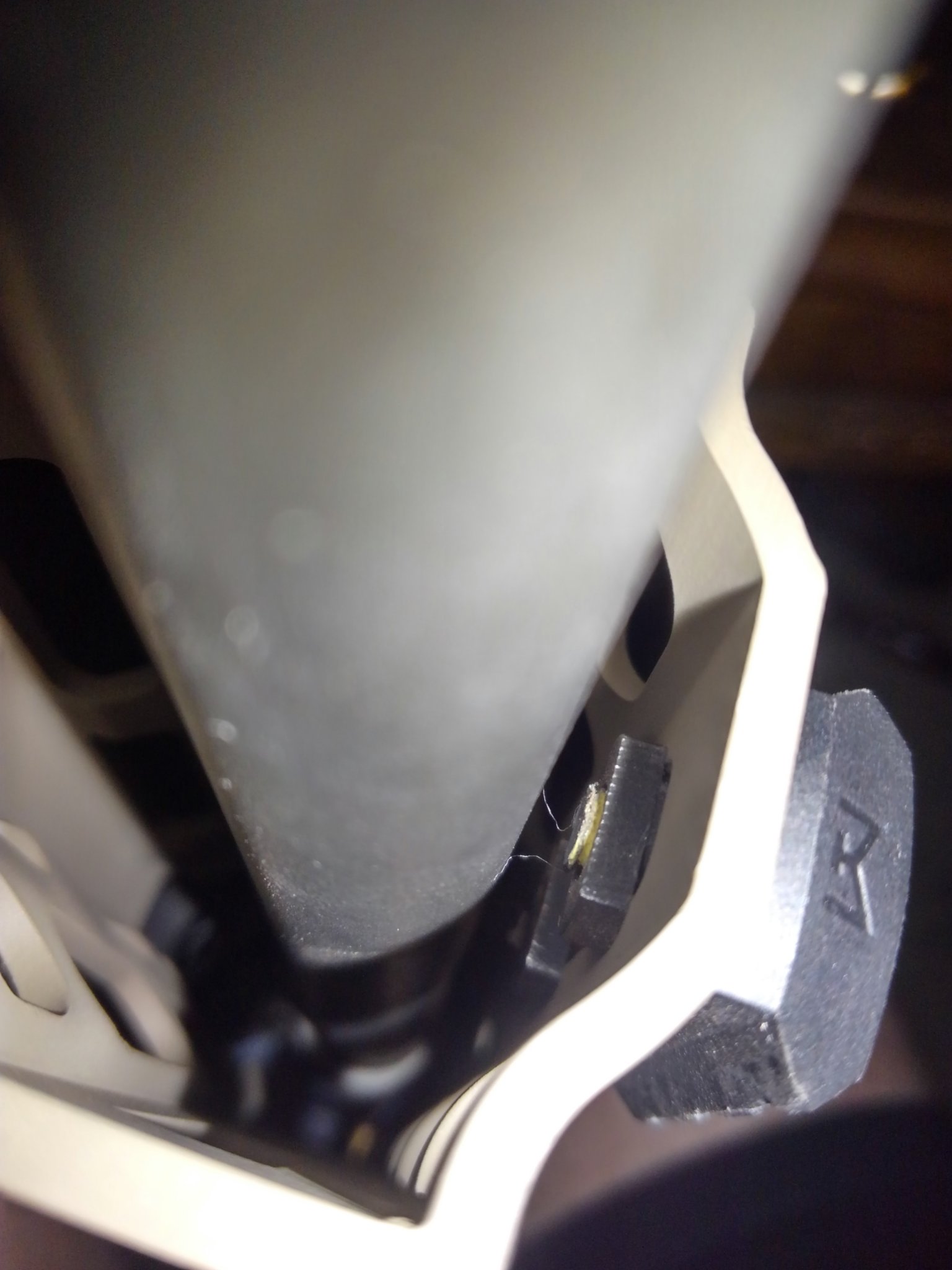

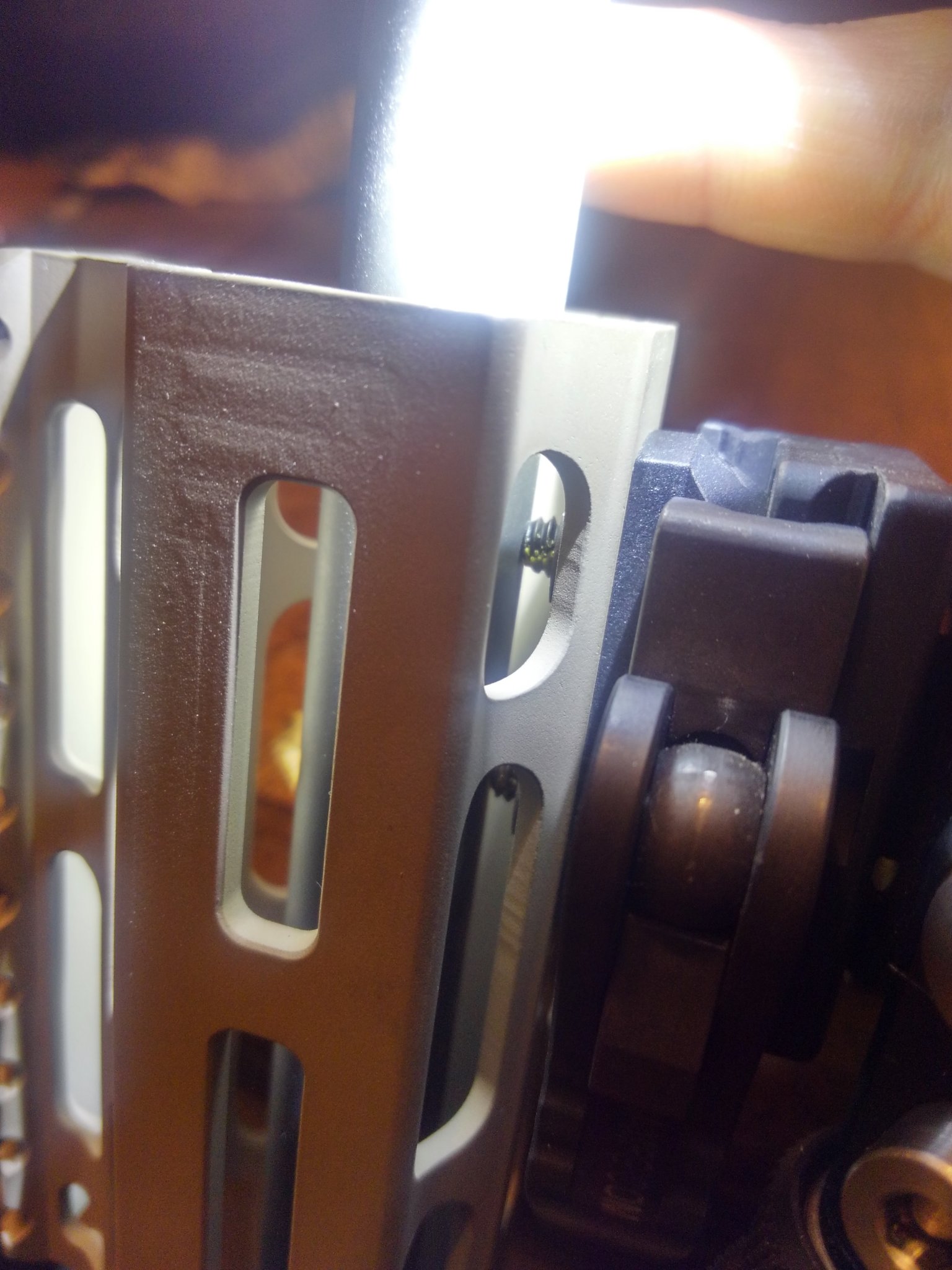

Stripped the rifle and everything looked good. Minus the grippod which was attached via mlock attachment, the screw was making contact with the barrel. Took it off and now holds 2 moa at 100yrds. Still not great but moving on the right path..
I have seen that same exact issue with so many Ar's in general to count. Glad you're getting it.
