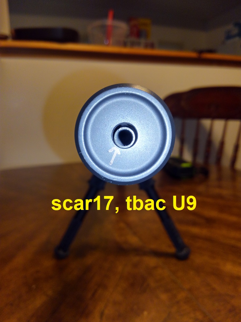

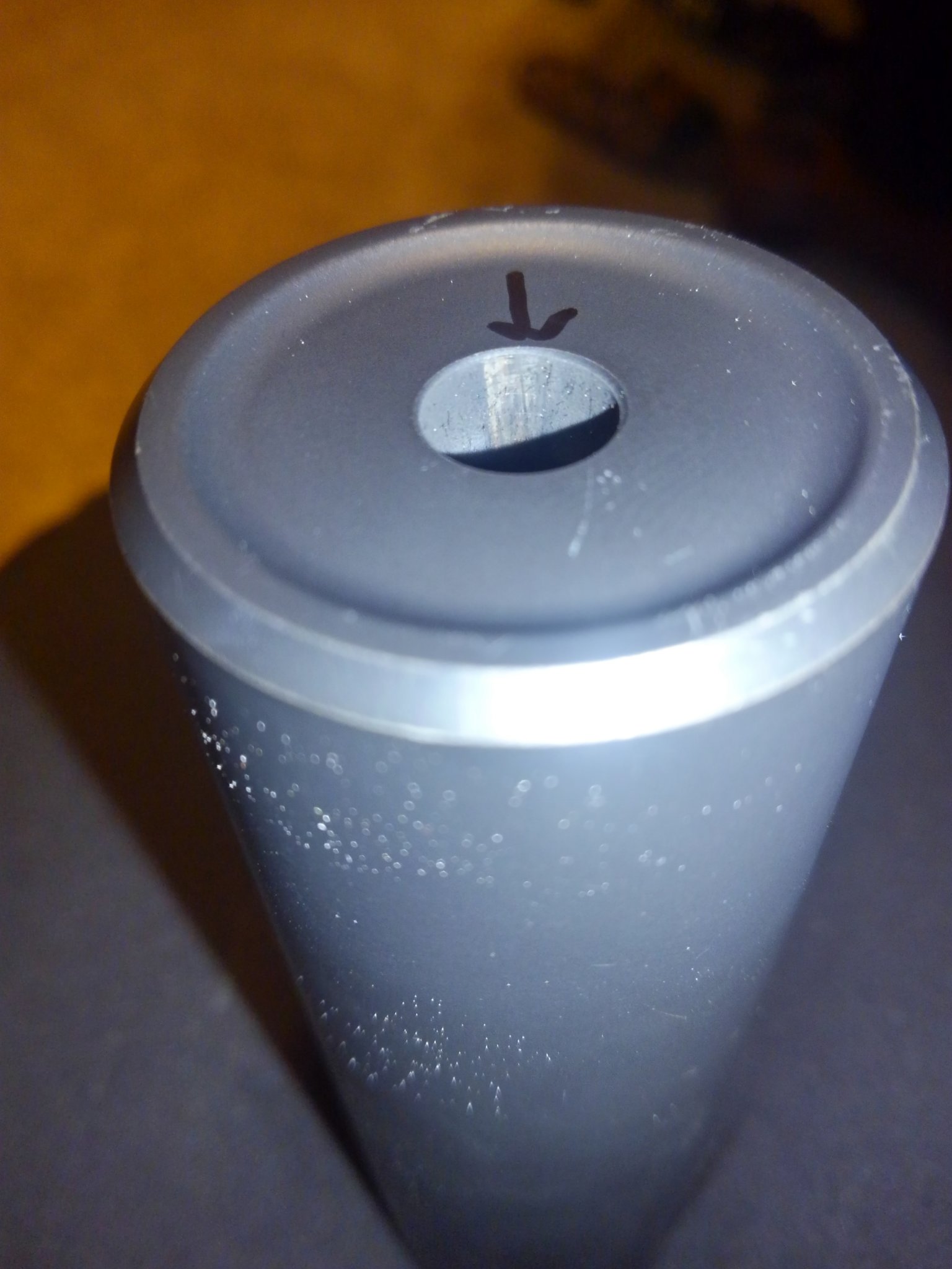

just got in from shooting my scar 17. i was zeroing my new trijicon 1-8 and i figured i'd try my tbac ultra9 instead of my saker 762. i was getting erratic shots, even at 50yds. totally not normal. when i got home i noticed this. on the inside of the can, at 3:00, it looks like it was beat with a brass hammer. i only shot 20 times because i didn't feel like wasting ammo. this probably explains the erratic shots.
i used a cleaning rod, but that didn't work out too well. other than that im not sure how to do it.

just measured the end caps holes
tbac .350
saker .370
so im thinking the extra length and obviously the opening compounded the fact i was out of alignment.

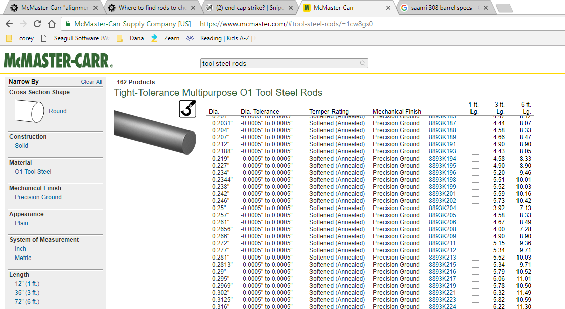

Suggested to me were these, which give options and are vastly cheaper than any purpose-built ones I have seen:
for 5.56 https://www.mcmaster.com/#8893K193
for 7.62x51 https://www.mcmaster.com/#8893K219
They have many other sizes though. Get the right size for your bore, cut them down to a few inches longer than the suppressor (and clean up the ends) so they snugly fit into the bore. Short enough, they won't droop any significant amount, so you can tell whether the suppressor is installed properly.
They are STEEL. Be slow and careful sticking them in your muzzle.
McMaster Carr is a generally awesome place to shop. If you have never seen it before, be careful, go slowly and remember to breathe.

i was just looking at those
im trying to figure out why people are using the .281 rod instead of the larger one like you suggested.
and why not use the next size up, the .302 one.
i don't see that listed. do you have a link?
I'd have to redo the math to find out why I got the ones I got, but they totally work. And barely. No wobble at all. Up a size at all seems like it would not fit in the bore.
But they are cheap, also. Try several.

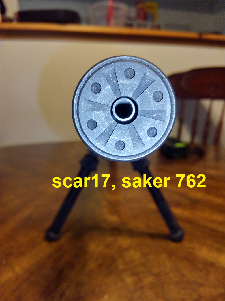

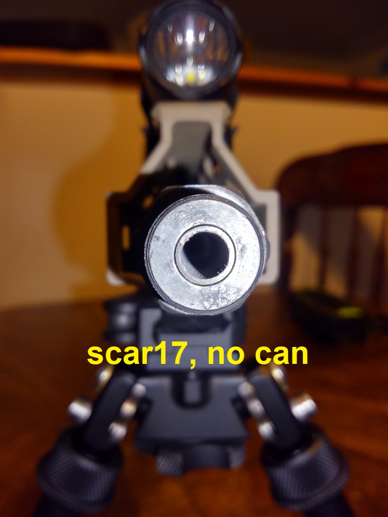

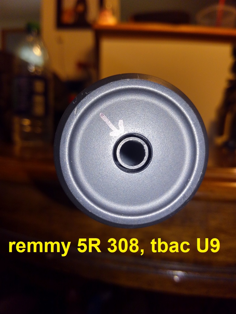

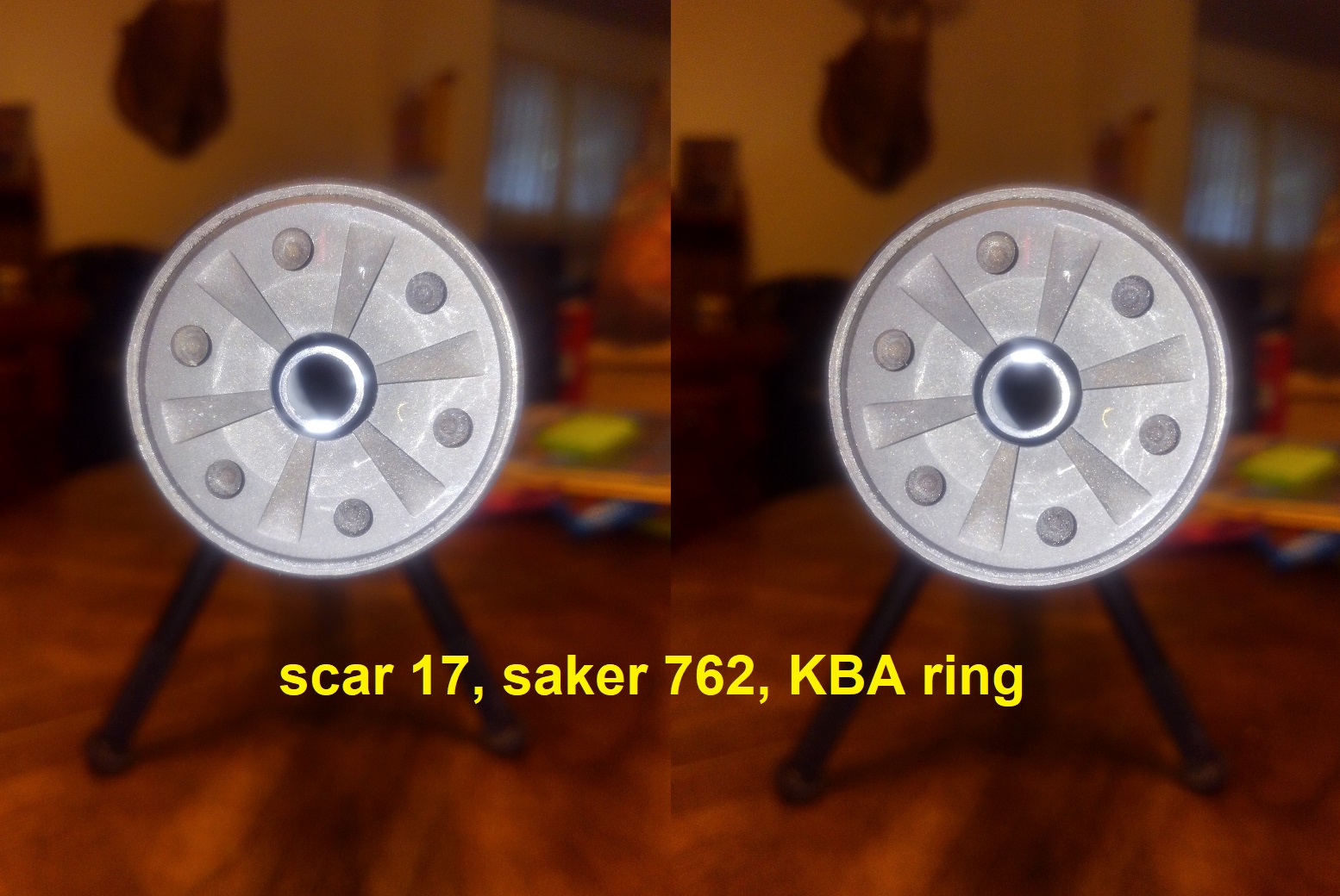

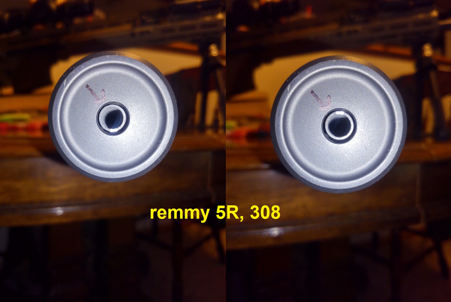

took a trip to the local archery store. i didn't want to deal with ordering a few different sizes of rods from mcmaster-carr. the archery store was kind enough to let me mic and cram a few different arrows down the rifle to get the best fit. you should have seen the look on his face when i was explaining what i wanted lol.
carbon express mayham hunter 250 camo...gotta get the camo. it has a coating that makes it a bit thicker. the arrow comes 50 carbon/50 camo. he cut me the camo portion to 18". the arrow mics at .2965" on the camo portion.
i didn't bother showing pics of my other tbac u9 or 30p-1 because they had the same result as the particular can in the pic.
Reactions: shoobe01
How did you make sure the arrow was perfectly straight and not bowed?
If you rotate the arrow 90 (or 180) degrees, while in the bore, does it look any different?
Looking at your pictures it is obvious that the arrow in the R700 with can is dead center, but in the Scar, it is off center for both cans, albeit at different positions and not as extreme on the Saker as on the Ultra. This would seem to support the view that it is a mounting issue on the Scar, as already discussed above.
Reactions: LSUbeatUby40

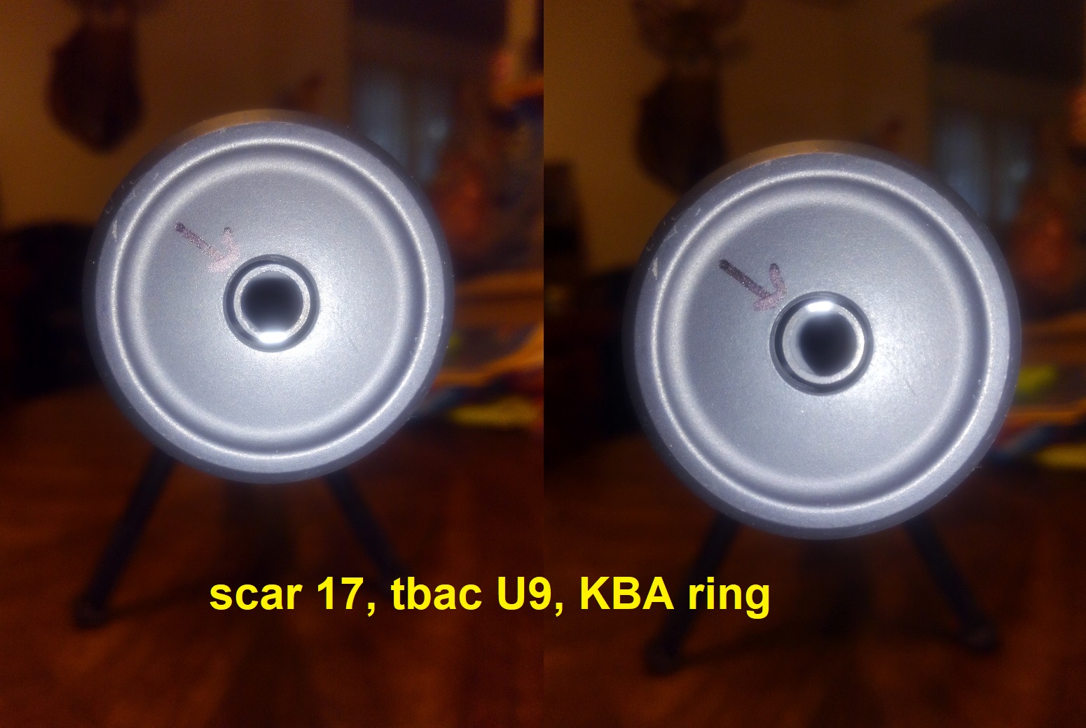

so my arrow doesn't appear to be 100% straight. i don't have a good straight edge or a glass table, but laying it on one of my windows, it doesn't look 100% true, but close enough.
also, i ordered the KBA ring on friday, and i got it TODAY...on a SUNDAY thru the post office?!?!?!? but hey, i'll take it!
the pics below are my arrow with a witness mark to show orientation. the pics are kinda blurry, i think due to the reflection of the silver paint pen. you can see that it still isn't perfect, i'm not sure if it's because of the camera angle or the arrow not being 100% true, or a combination of both, but there is a huge improvement with the KBA ring. for some reason it doesn't look as bad in person. now that i think of it, i should have tried the other end of the arrow as well. maybe tomorrow...
