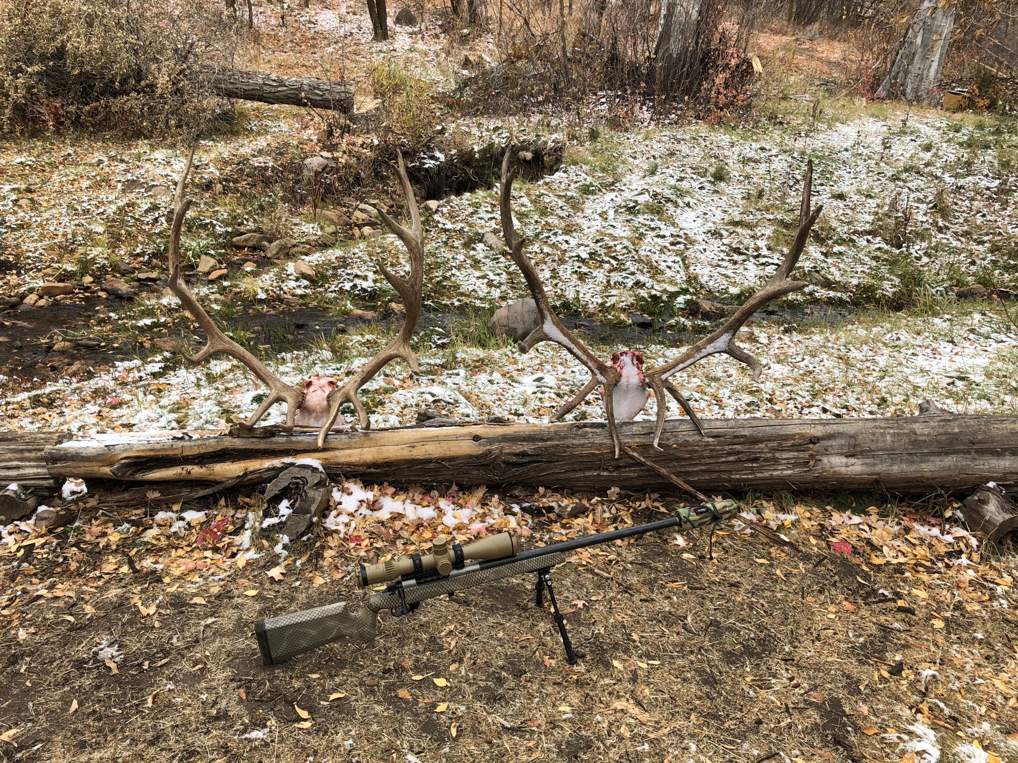

Perhaps I should’ve saved this one for myself but as far as the 624i being only PRS minded... Don’t know who’s contract is filled by the attached but yeah. I guess the point I’m getting at is scopes in this price range are built to be scopes in this price range regardless of use. The QC department fucking off is why we have issues like what you’ve posted.

To be fair S&B scopes have a long lineage of military service and I'm sure the higher durability needs of those mil customers are thought of in their scopes designs. Not every manufacturers scope is going to handle the exact same impact resistance, operating temps, and overall durability those things have to do with design not just QC.
Totally and no argument there whatsoever with regards to S&B or the later. Is there a standard that would classify one scope as “x” and one as “y”? Not trying to sound like a smartass.
