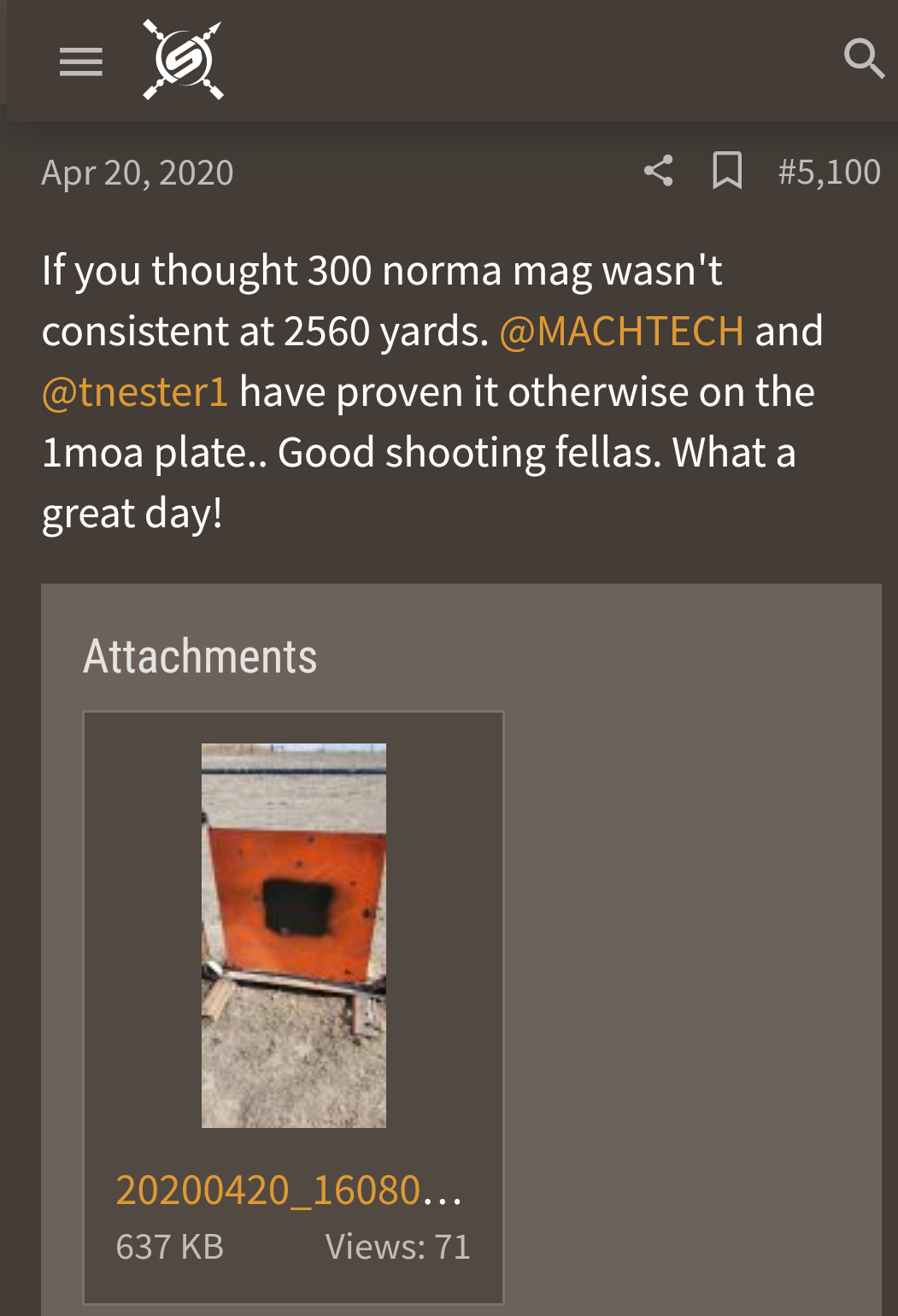

I just found this post in the AI section that Jake put up. He did make a mistake on the yardage too. It was 2640 yards. This just shows the capability of the 300 NM! I went 7/10 in some tricky winds.
