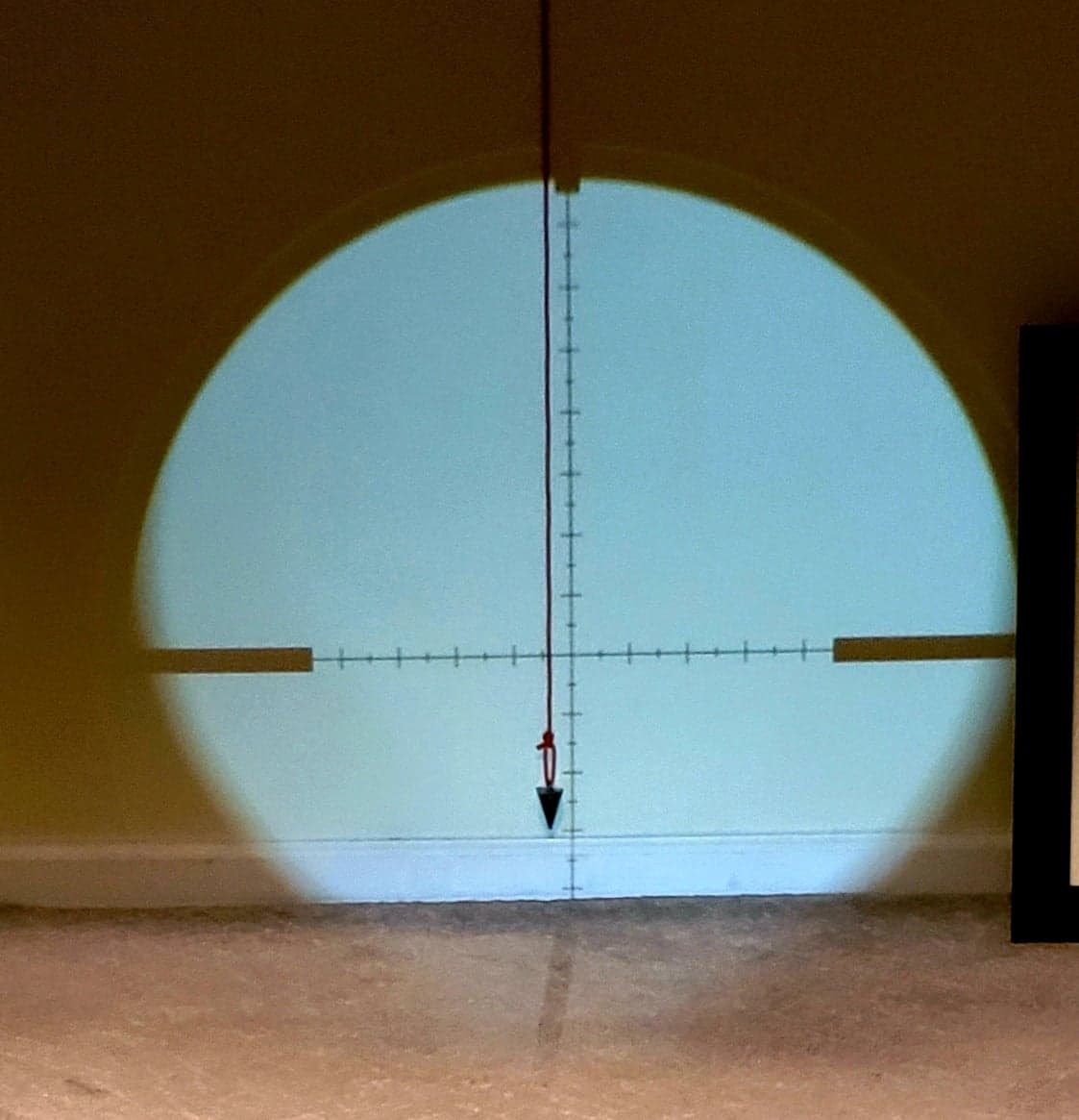

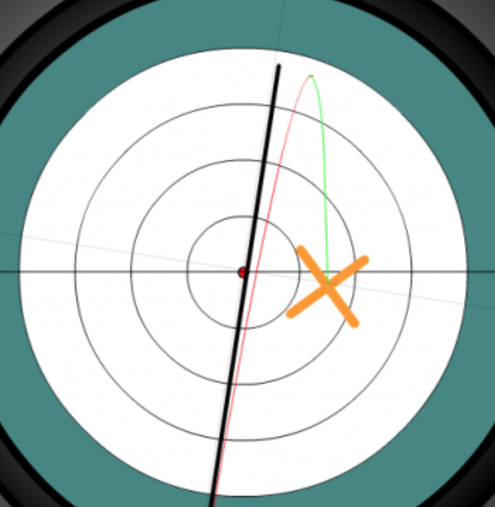

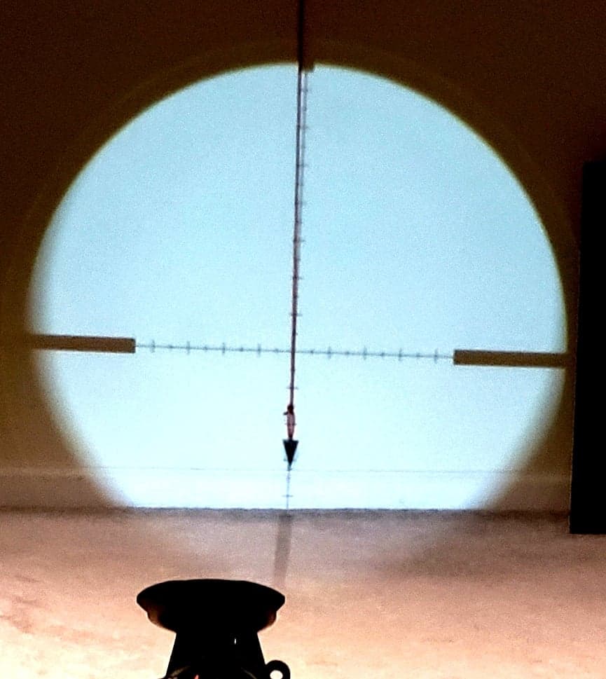

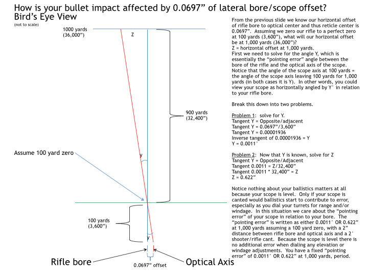

The reticle is what needs to be leveled, not the elevation turret. A video by Vortex worth watching;
What this does not address is that the reticle needs to be in line with the bore. Forgive my simple artwork, but I exaggerated the condition to illustrate a point. If the reticle isn't perpendicular to the bore, then you end up with riflescope1. Then, when you cant the scope either manually, or with a level, you still could end up as shown in riflescope2 if the scope/reticle is not properly aligned with the bore.
You realize even with your exaggerated examples that it won't have enough of an effect to matter. It would be about the same as playing with your scope center line above the bore measurement and seeing how little difference it makes.
Edit: Btw, you can adjust that in the ballistic app if you are really that worried about it

I found this article quoted above to be very interesting. https://www.shootingillustrated.com/articles/2016/3/28/rifle-scope-reticle-cant/
However, in discussing reticle leveling, the illustrations assume you start out by having the rifle "level." Just putting it in a vise or mounting it on a bipod, etc. before you level the scope to an external plumb bob does not mean that you started out with a level rifle. Someone mentioned above a 4" error at 1k yards. The article itself talked about errors of 14" at 1k yards due to scope/rifle cant. You can record this error in your shooting table and correct for it. Of course, when you correct that variable in your shooting table at 500 yds, it will not be the same at any other distance. Or, maybe you can remedy that with your ballistics program. If your ballistics program accepts that amount of misalignment and properly compensates for it at any distance, then that's great. But, why even bother having to deal with that in the first place? Just properly align the scope reticle with the bore of the rifle and be done with it. In practical application, sometimes you don't have time to haul that cell phone out of your pocket and run the numbers before you take a shot. Consistent accuracy is all about eliminating variables whenever possible.
If you actually shoot past 600 yards, you should have a rail mounted level of some sort by now.
Step 1: buy rail level, and keep it on gun forever.
Step 2: level the gun, with your handy level that you're actually going to use in the field.
Step 3: put a flat level ontop of the turret, and twist the tube till it matches your rail level. The vast majority of >$1000 optics have the top of the turret flat perpendicular to the vertical crosshair. 1 degree off? Oh, fuck off.
Now you have your scope leveled to what you will ACTUALLY use in the field. Not some temporary thing based on faith. You can get even more silly if you want: replace Step 3 with a plumb bob weight hanging off some string- gravity ain't gonna lie. Again, now your shit is matched to what you will ACTUALLY rely on in the field.

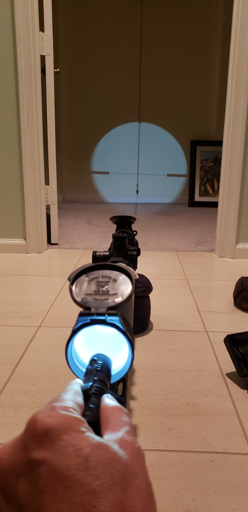

Shoulder the rifle(same way), line up .scope reticle to masking tape that’s level on a outside door tighten scope then perform tall target test.
No matter what way you level your scope reticle you should perform tall target test .

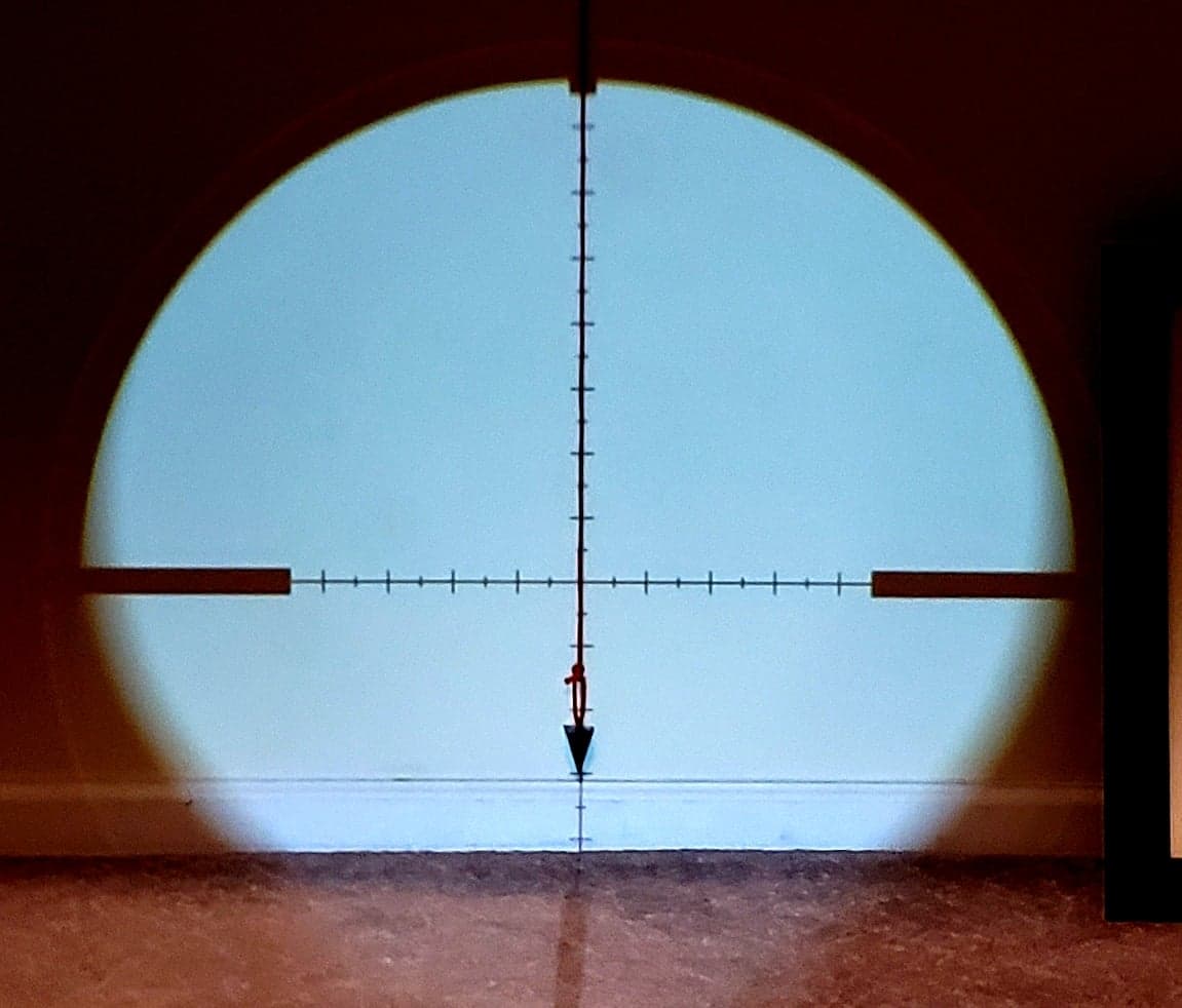

Throughout this discussion we have NOT established a reliable means for the average Joe to determine if his scope suffers from a canted reticle. IMO, this is a really critical piece of the puzzle for precision shooting.
I was happy to report in post #70 that I have found no discernable cant in my SWFA 10X42 HD, which leaves me free to either hold-over or dial-in elevation corrections without fear of the POI wandering horizontally with elevation corrections. I can hold the reticle level (as observed by the scope level) and know my elevation adjustment will track it accurately.
A cursory check for a canted reticle is quick and simple to do, and requires no trip to the range: hold the turret housing perfectly level (however you wish to mechanically do so) and then sight a plumb bob or other know vertical to see if the reticle is also perfectly level. If it is, great! If not, make a decision of how you're going to proceed from there (send scope back for repair, or when shooting use only hold-over with a the reticle leveled or use only dialed-in corrections with turret/tracking leveled.
Note - on my SWFA scope, using the top of the actual turret cap (as recommended by many) gave a false level. Removing the cap and using the top of the turret collar (that is part of the housing) gave a true reading. The flat on the bottom of the turret housing is another surface that can be reliably used to establish level of the of the elevation/windage adjustments.

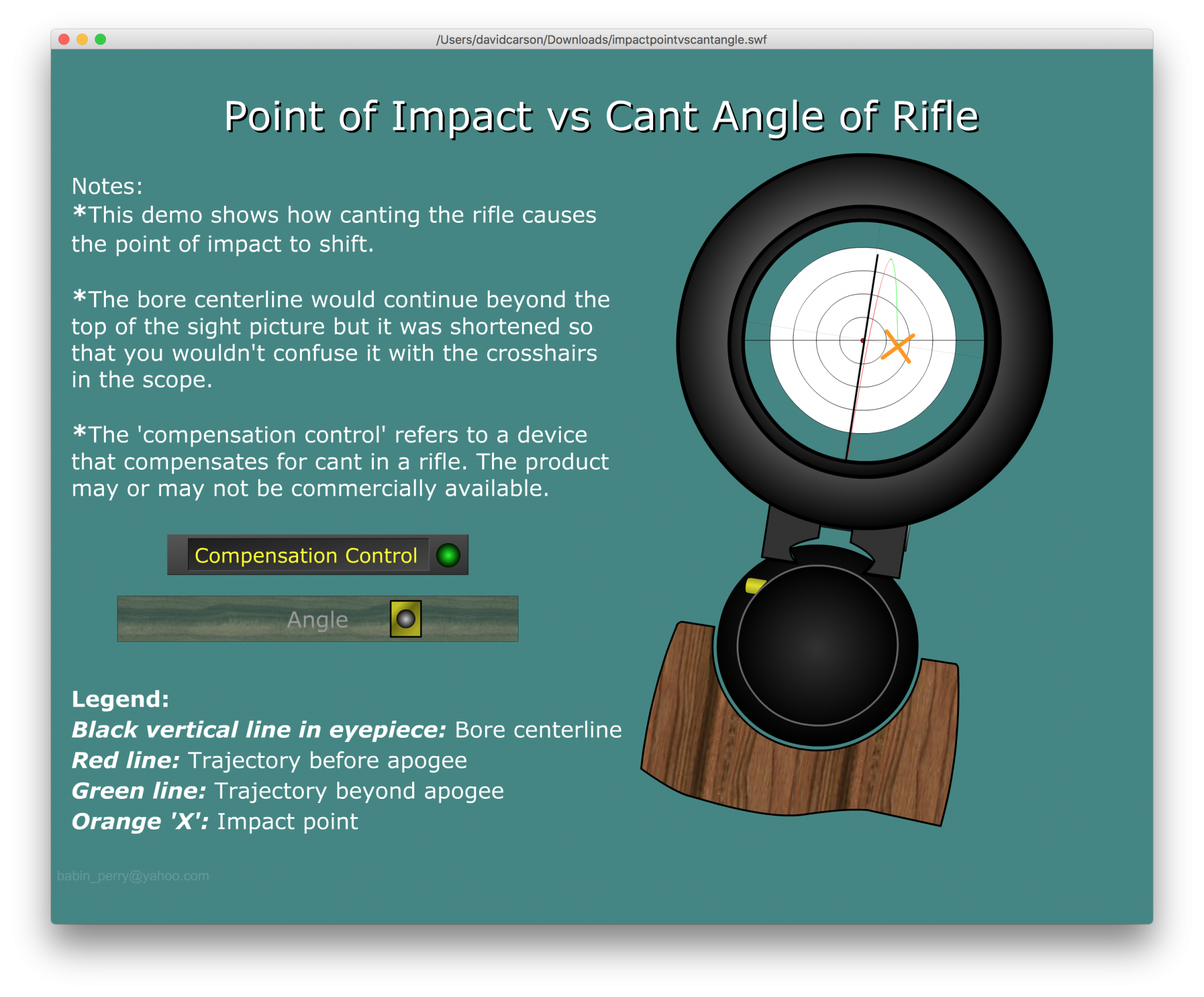

A side note on the EXD tool: it seems to work well for me, but keep in mind the tool's assumptions: the rifle bore is dead center of the barrel AND the ocular housing is concentric to the scope's optics. And, if I read lowlight/Nik H ‘s advice above correctly, the reticle/bore axis cant doesn’t really matter too much.
The best illustration of canting effects was an interactive tool I found by google searching, post #12 here: https://www.airrifle.co.za/threads/12512-The-result-of-canting
direct link: http://www.arld1.com/images/swfs/impactpointvscantangle.swf (it's a flash file, you'll need a flash player to use it https://get.adobe.com/flashplayer/)
I am NOT saying canting matters much, only that this interactive tool showed me how it affects the shot. I do not vouch for it's accuracy, and I ignored the "compensation control" button.

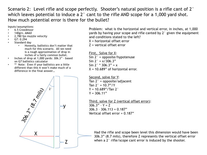

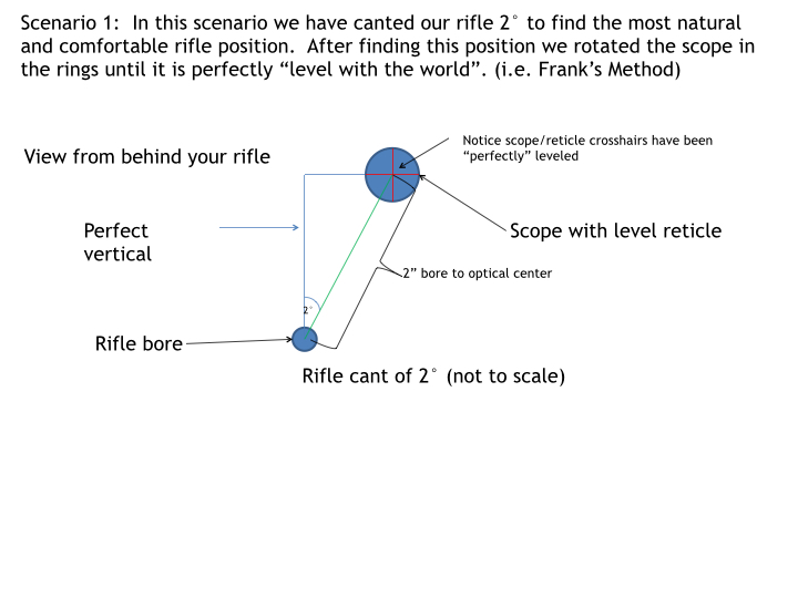

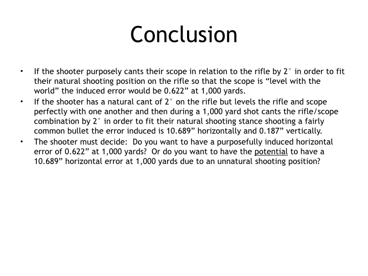

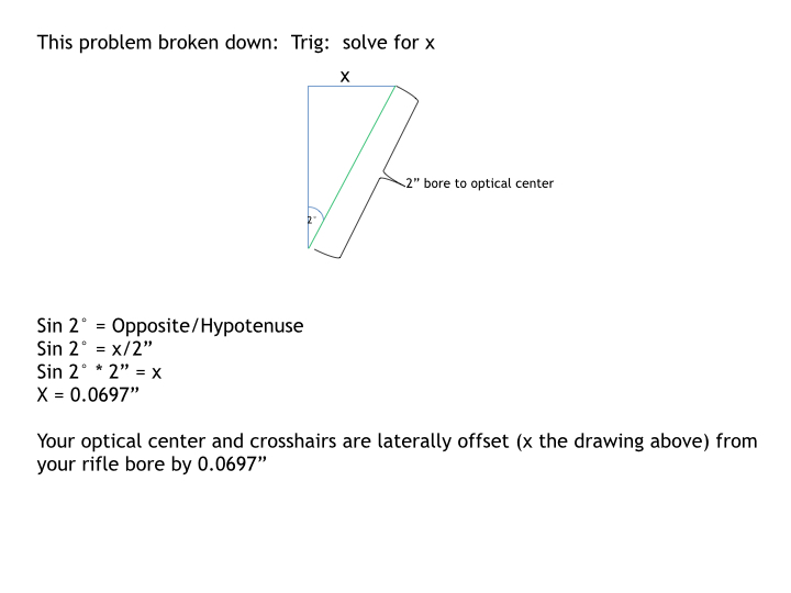

Here are the math examples, as I hate we keep going into the weeds, but two parts here:
1. Canting as a problem is not usually because of mounting, and you can absolutely mount a scope off-axis and it will work. Canting is from the bipod and Shooter Interface, their body position which rolls your head over and then bringing the rifle with you.
We do not cant the rifle because of how you mounted it, unless the reticle is canted inside the scope. If you mount the scope off the exterior and not the reticle, you can have an issue, doesn't mean you will, but you increase the chances.
2. Watch the recent video I did and understand Jeff in the video shot a great group at 100 yards. Sub 1/2 MOA. But look at the wrestling with the rifle. When he runs the bolt he has to straighten out the rifle every single time. This is where canting comes from.
Anything inside 2 degrees can easily be overlooked by the shooter, by that I mean they can miss the cant in the reticle. The examples of 5 degrees are absolutely positively stupid on every single level imaginable because it is highly noticeable. Nobody with a 5 degree of accidental cant is going to think it looks straight and if they do they have bigger problems. This error is usually tiny comparatively speaking, under 2 degrees.
So first here are why you can actually cant a scope or have it turned in the rings for proper tuning and set up,
This outlines why setting it up correctly for the shooter is smarter, because as I have said until I have turned blue in the face, we don't have an issue mounting, we have an issue shooting.
