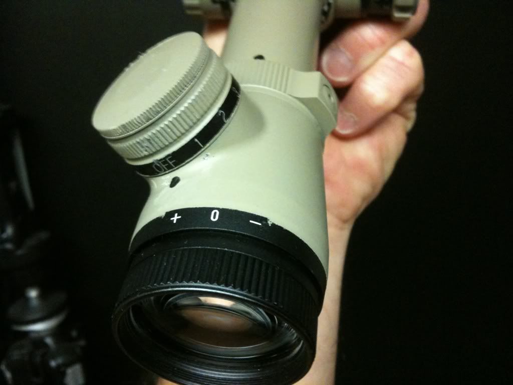

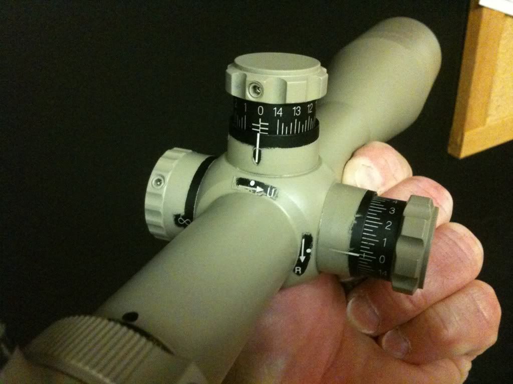

First time working with cerakote; HVLP at about 15 psi, used frog tape and electrical tape for masking. It'll get banged up and scratched sooner or later so it's good enough for now.

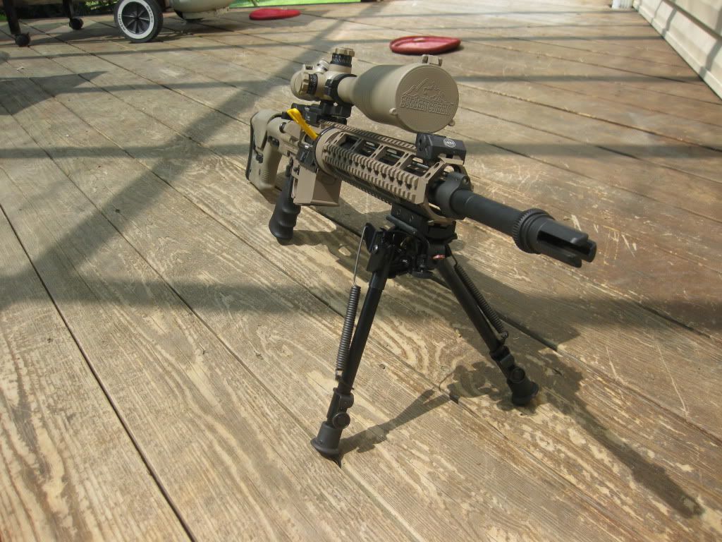

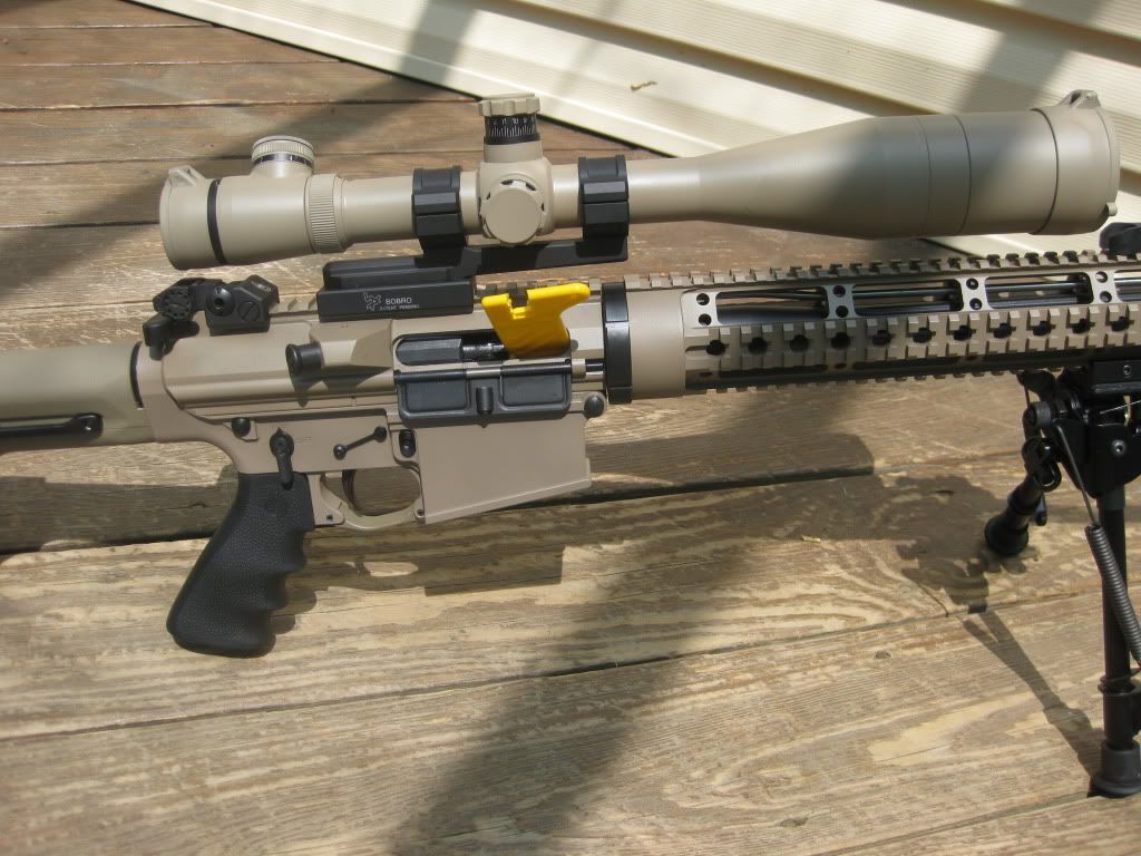

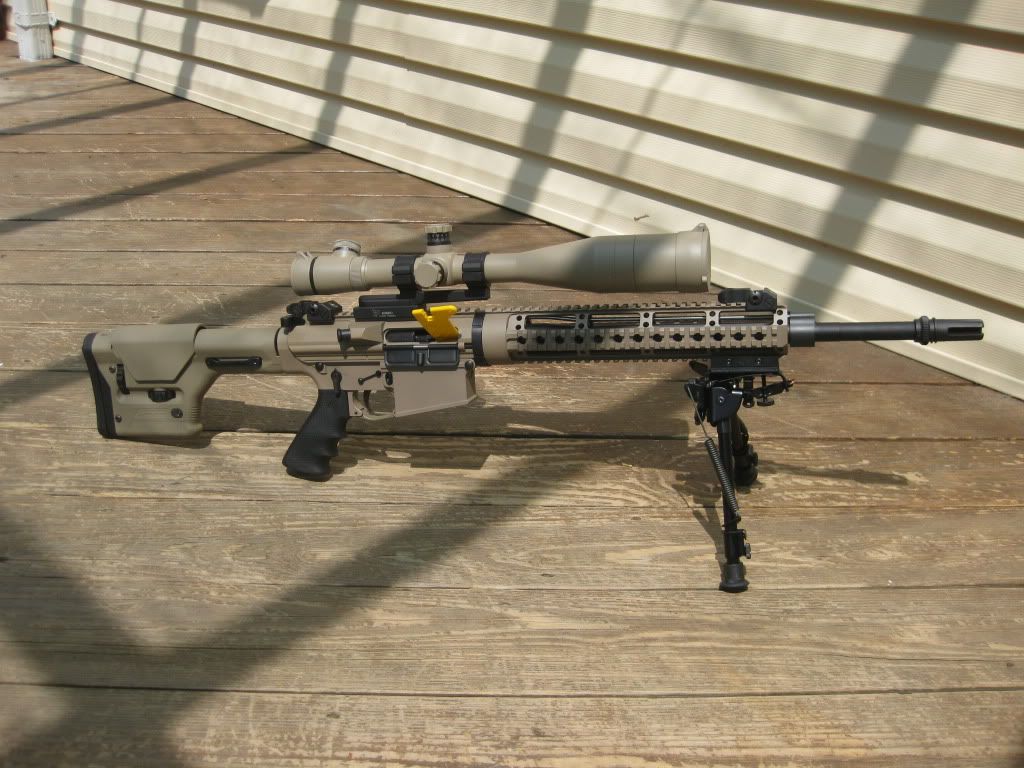

those were indoors. these aren't:
I sandblasted the covers and finished with the same cerakote. It holds up well to a thumbnail. I tried Krylon Fusion but it doesn't stick at all and came off without much trouble, a little lacquer thinner and a paper towel did the trick.
Interesting bits: DPMS says they use a proprietary version of a teflon finish in coyote tan they say is close to duracoat which doesn't work for scopes I'm told. In certain light, my wife (the paint and shade expert in the family, I can pretty much tell aviation red green amber all the rest is irrelevant), says the scope and upper is very close. The magpul buttstock and trigger guard are more of FDE shading, but you know, if it EVER comes to my using this at a distance it'll be covered up with lots of rag and brush anyway and who's going to know?
