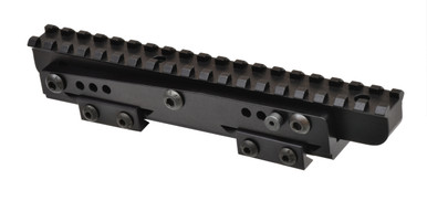

me Id just buy an adjustable scope base if your happy with your scope a new scope could run you 500 or more an adjustable scope base and there are a few of them the one I just got for my pops 22lr was only 395 +shipping and he has the elevation to shoot past 1k not that he will not with the 22lr but it's there if he decides to try it .
https://heritage-arms.com/product-category/gun-parts/cold-shot-llc-adjustable-scope-bases/ just another one more expensive
and the really nice but really expensive one

That's a cool device but won't work with this setup.

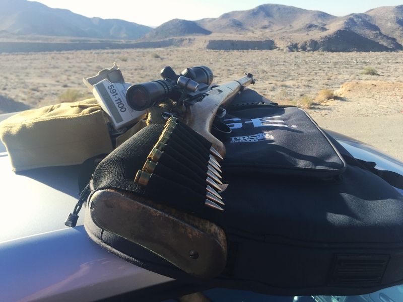

Here's a visual of the mount on a K31, though I can't the gun to the left while of course keeping the scope vertical.
