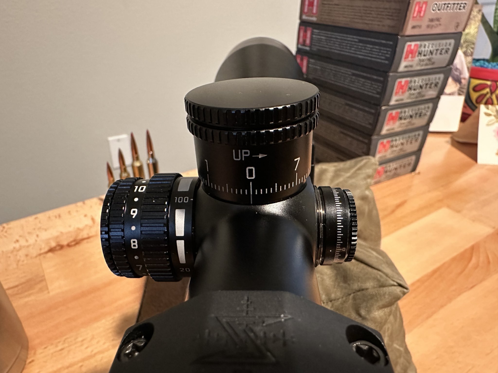

This is the only shortcoming I can find on the Leica and unless you dial wind it’s a non issue. It dials .1mil per click and the windage turret is engraved that it’s MRAD but the major and minor references on the turret ring are laid out like it out would be MOA.
That is weird how the windage turret is marked, but thankfully I’ll be holding for wind 99.9% with the .1% as a safety net. One of the reasons I like the BDC reticle on sale (actually a mil tree which is weird) is so that I can hold wind at max power.
How does the windage work on yours, is it accurate to .1mil increments? Did they install the wrong dial?
Yeah it dials .1 mil. I don’t know if they installed the wrong ring or just used the same one for both models. I personally don’t really care though since I don’t dial wind and it’s only for zeroing the scope for me.
