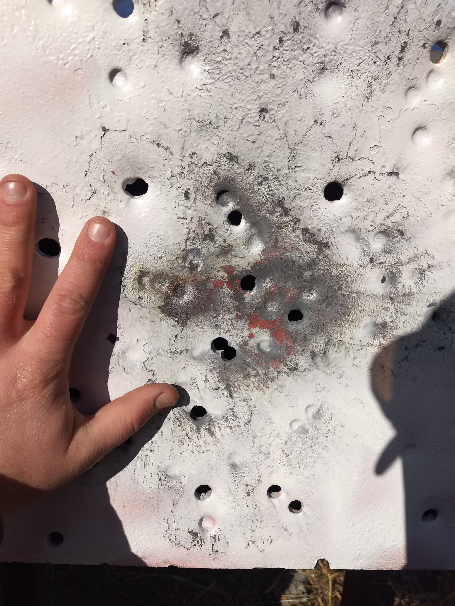

So tested it today and got results all over the map ...but still some solid loads I think . First load at .090" shot this group on steel ( this is the original load I developed when new )
The SD was 18-22 ( shot 2 5 shot strings )

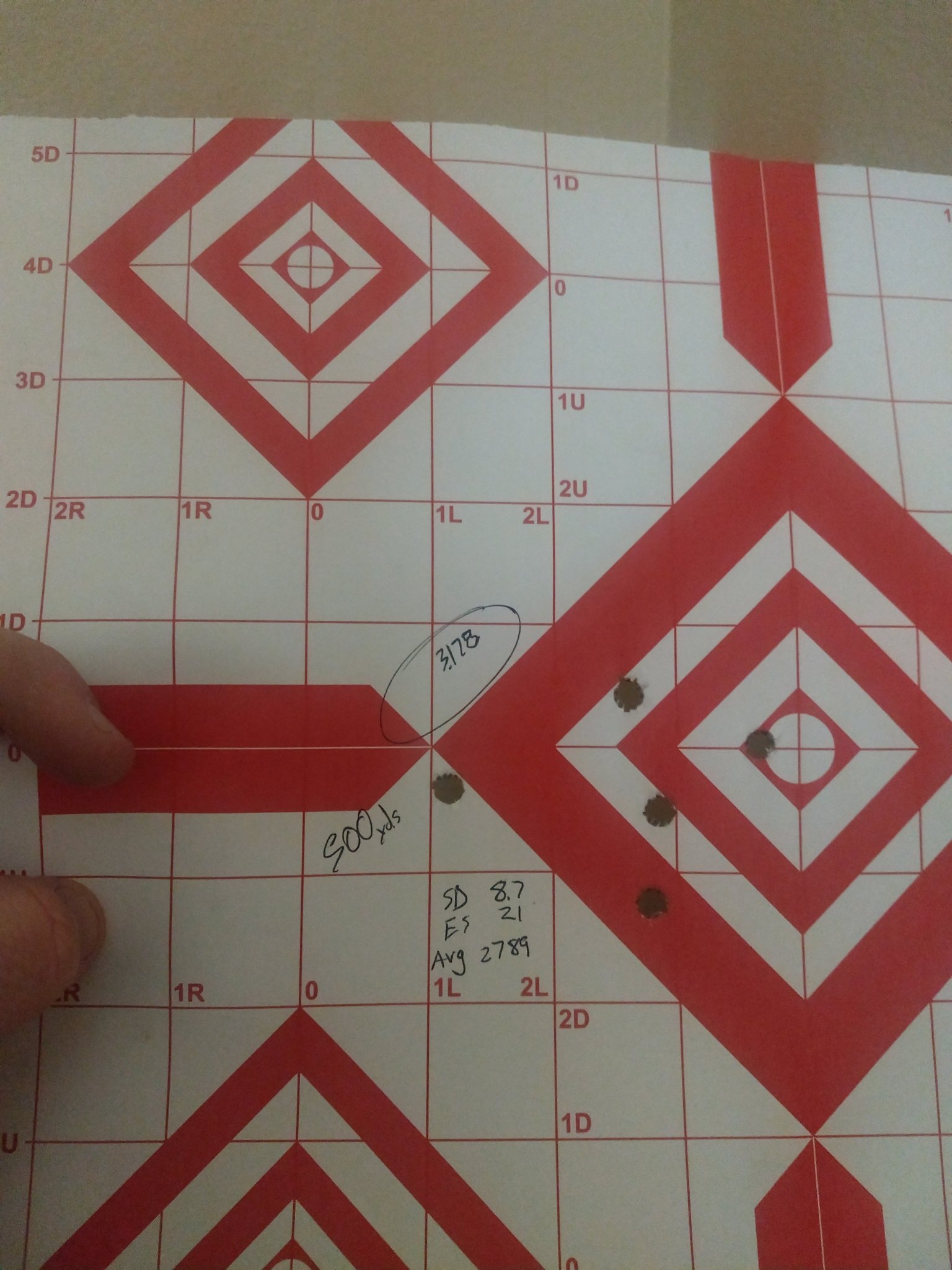

Then I got bad groups ( 1 moa) and SD in the 20s till I came to total length of 3.178 which is .077" off using original land measurements. This load is as follows .
143 eldx, h4350 41.3 g , .077" off . SD was 8.7 and es was 21 with avg velocity at 2789 . Here is the 500 yd paper

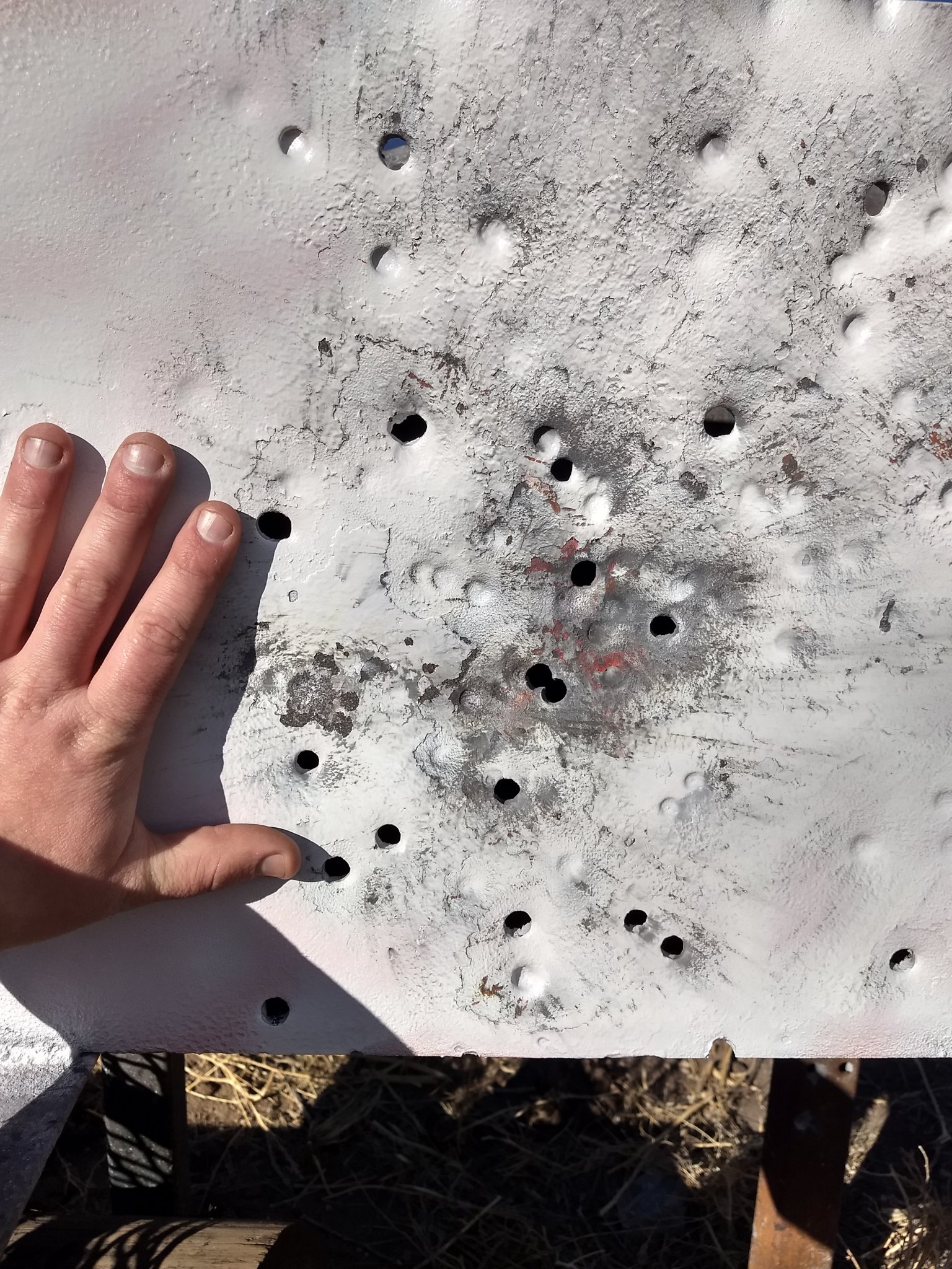

Also loaded 5 of the 140 eldm just for the heck of it . Same charge of 41.3 g at .084" off and it shot great ! SD at 5.8 , es at 12 ,avg velocity at 2807 and here is the target ...I shot the steel cause it was easy to see if I was even on target being this was a complete shot in the dark .

So all in all the original load still shoots pretty good but bad SD es numbers and gets a bit fickle at 700+ with all groups being at worst 1 moa . The load at 3.178 shot great, but that shot in the dark ... Shot even better I think ... What are your thoughts guys don't know which one to load !!!
He makes a good point, 10 firings is alot on brass that hasn't ever been annealed. We already know you have some throat wear, do you have enough mag length to load at .020 off the lands? I know you were getting good groups at your origional loads but 41.3 of H4350 at around .020 off the lands is almost like a magic recipe for alot of 6.5 CM rifles. If I was given a random 6.5 CM rifle and told nothing but the chamber measurement, then told I had to load for it and shoot it in a match the next day, I would load 140gr ELDMs or 143 ELDXs on top of 41.3gr of H4350 at .020 off the lands. If you want to try and anneal that brass I can do it for you on my AMP for free, you just cover shipping. Even with annealing you are probably only going to get a few more firings on that brass most likely, but if you'd like to try and keep it alive a little longer let me know.
