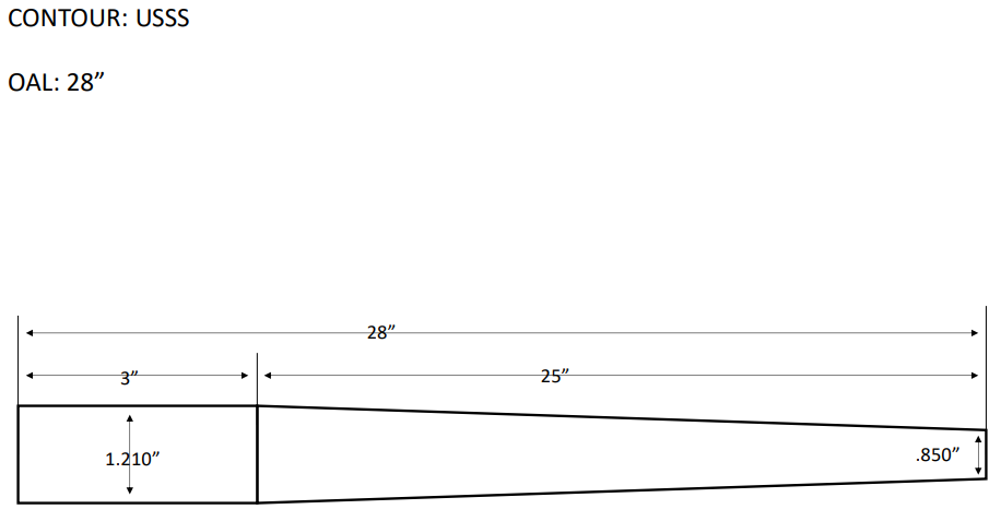

Your history lesson for the day…. The guy that was there when the JAR rifles were being used etc.. is still at SS. I talked to him an hour ago. He is still doing gun work there and guess who’s barrels he is using? :) I didn’t want to bug him with some of these questions and didn’t want to cold call him about this but we got in touch. He said anytime give him a call.
The contour was just a normal heavy varmint contour. They didn’t call out anything special per se. So depending on the barrel supplier over time you might see some variations in the HV contour but that’s all it is.
All 7mag barrels were 1-9 twist.
All 300wm barrels were 1-10 twist.
The 7mag conversion to 300wm was in the 2000-2001 time frame. So at the start of 2000 there where still 7mags in service but by 2001 there where no more 7mags in service.
The only reason and again the only reason for the change to the 300wm and he told me… we were perfectly fine with the 7mag and the performance. The change was due to the one range they shot at and the concern was over the lead bullets and the effect on the wildlife/preserve etc…. and they did do testing on 30cal bullets that had a tungsten core projectile that where already being made. They tested them and they shot good out to 600 yards and change. He said past 600 they got a little funny but it filled the role. They asked about getting tungsten projectiles for the 7mm but they were told they can do it but it would take over a year to get them made. So that was the only reason for the switch from the 7mm to the 300wm.
He said back in 2000 the cost for a single round with the tungsten bullet was $4.15 per round but they were not shooting a 100k rounds a year so no budget issues. Then go figure about a year or two later the range said…well the tungsten probably isn’t any better vs the lead so you can shoot what you want. That was funny shit when I heard that! He said what was cool about the tungsten bullets was they could vary how they were made. They could shoot a coyote at 75 yards with the bullet made to be more frangible and it wouldn’t go completely thru. Now think of that application for a SS sniper shooting in the town. Not worried as much about what’s behind the target but they could get the bullets made so they could take out an elk at 1300 yards as well.
All of the original barrels as I understand it were Harts. So he asked Ray Steele why are we buying Harts for the JAR rifles and Schneider for the match rifles? So he ran a test… the Schneiders at the time out shot the Harts. So he said done…we are not buying barrels from two different makers and everything was changed to Schneider. End of that story.
So hopefully that helps you guys fill in the blanks on what was used and the time frame on the 7mags vs the 300wm.

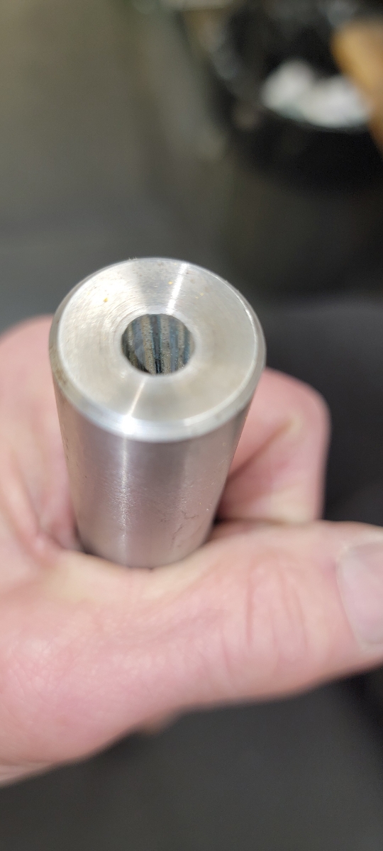

Bartlein Barrels
The finish length on the 7mag barrels was 26". The muzzle crown style was 11 degree target. This is the pic he sent me. Notice how big of a chamfer is on the outside edge and at the bore edge it looks like a sharp edge at the bore. We personally here put a 60 degree chamfer on the bore edge. I feel it helps with gas cutting, cleaning damage and overall help the life of the crown.

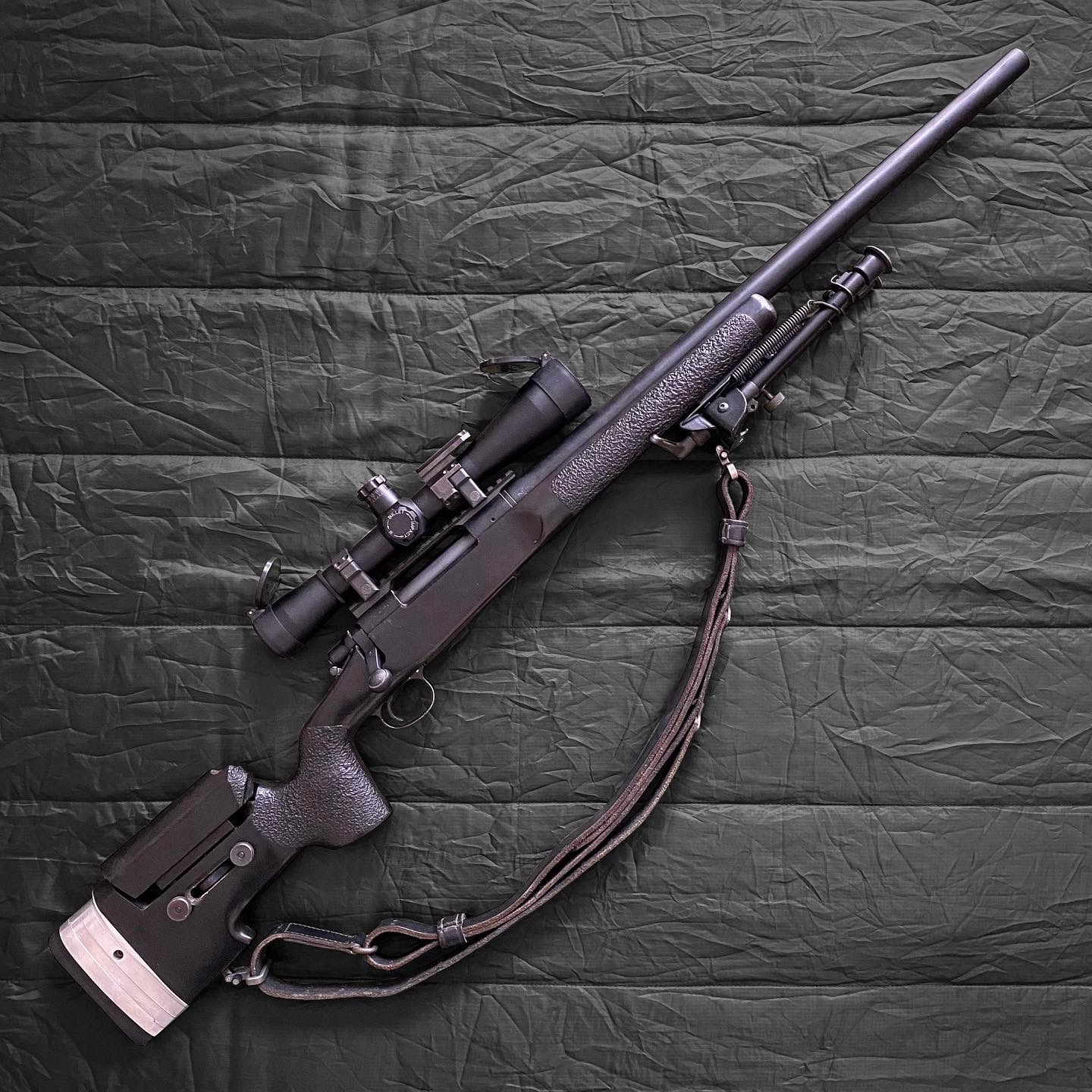

Haven’t started the build yet. I’ve got an M40a1, 3,5, and an XM3 to build yet also. Have parts for them all. Just not sure where to begin. The “JAR” is the easiest of them but the XM3 interests me the most. Hopefully soon!

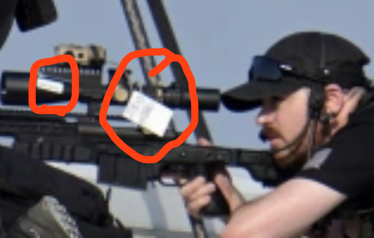

That’s appears to be a long action. the pic of the shooter doesn’t look like it was a 300 that hit his head to me. Could be wrong, things are still dynamic, but I would I have expected much more of his head to be gone.
He's missing his front teeth. It looks like it went in through the mouth and blew the back of his spine/neck out.
If it was a less than center hit ...... what you see is real enough with a 300
To my knowledge no magnum calibers are being used. I could be wrong.
All the replacement barrels we’ve made in the last few years have been 6.5mm for 6.5 Creedmoor.
Again doesn’t mean they don’t have older / mag caliber rifles in service.
I’ll have to make an inquiry.
Reactions: j-huskey
I saw this last night after I posted and reached out to a buddy who has “extensive” use on the mk13 platform over his 9 deployment to Iraq. His words, “no fucking way that was a 300WM, I’ve seen 223 do more damage than that”.
I have no idea. I can’t rule it out as that mag certainly looks to be a long action mag. But, I am with you and would postulate that what you’re thinking is possible as well, but I really don’t know.

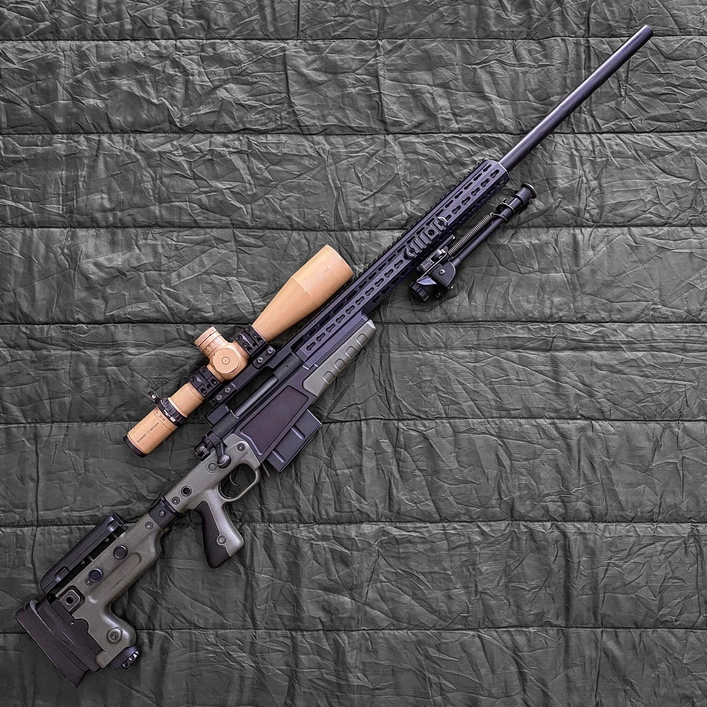

Top one looks like a mk13s with a green chassis I have the same rifle with a Stiller action, and it took a year to get that damn contiguous scope base built but Milehigh and AI came through for me.
Very, very nice builds.
Both the Mk13 Mod 7 and currently fielded iteration of the JAR use the pre-2014 long action AX AICS chassis. The major differences being color, fore end tube length, and with the Mk13 using a Stiller action, requires a special scope base for Stiller’s specific hole spacing. The JAR also seems to have adopted some parts from other programs and systems within its lifetime, such as the Ops Inc scope rings and diving board setup, as well as the tan S&B 5-25x56mm PMII from the PSR program.
Reactions: FatBoy
Looks like they're running NF Atacr's now.

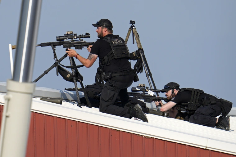

Really need that dope card for those 150yd shots eh
Having competed in Mid/Long range high power with a few SS guys, No. These guys can shoot, and all of them shot 220gr 300WM back then. Two of them were not big guys like Karl. I think many switched to 243Win around 2010 or so, for competition . I would I bet they had their holds plotted out to 1000+.
I have to believe that this roof was designated to be patrolled by a local or State PD, and these snipers were focused threats from further out, but this is an epic fucking fail.
