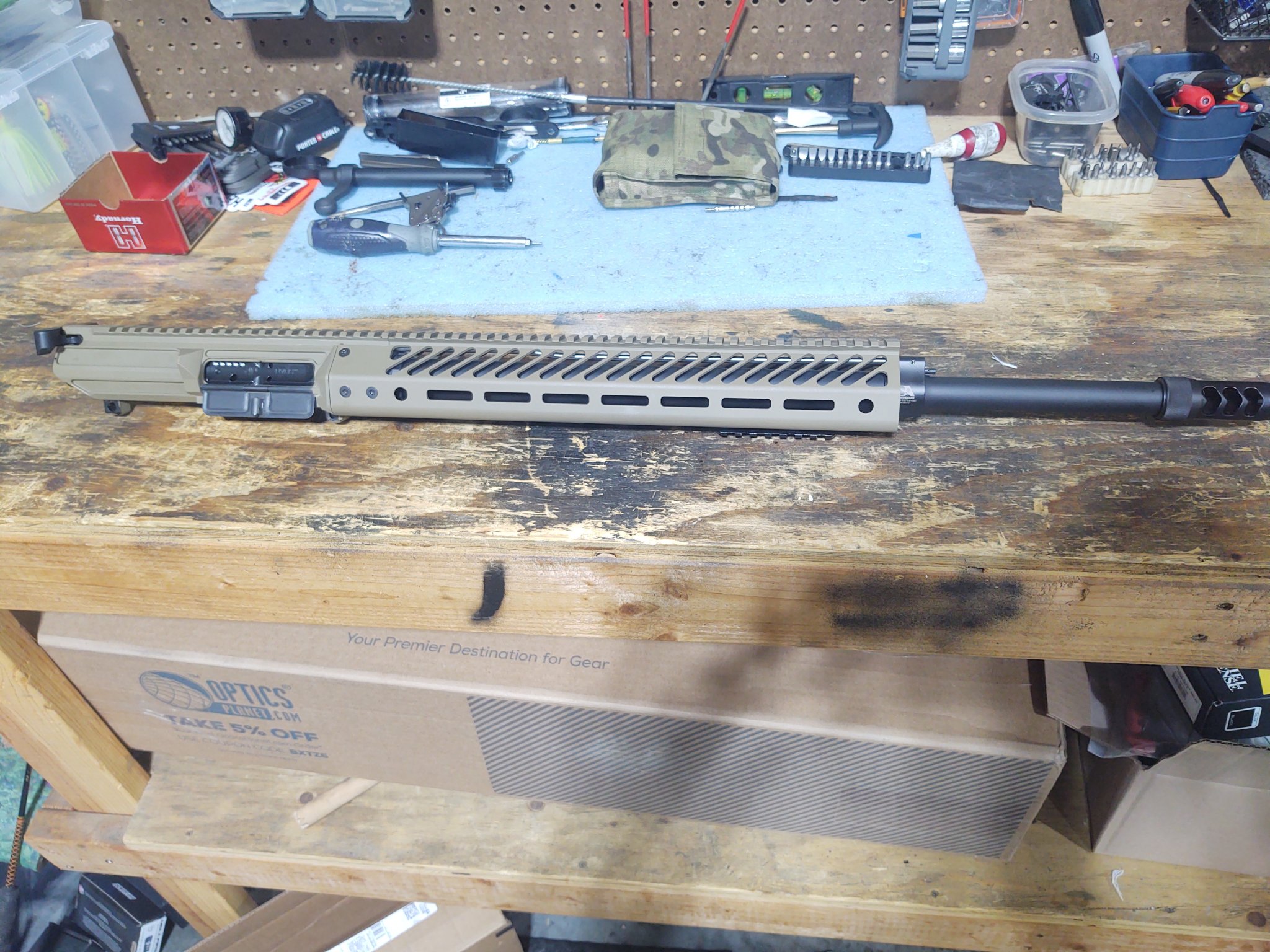

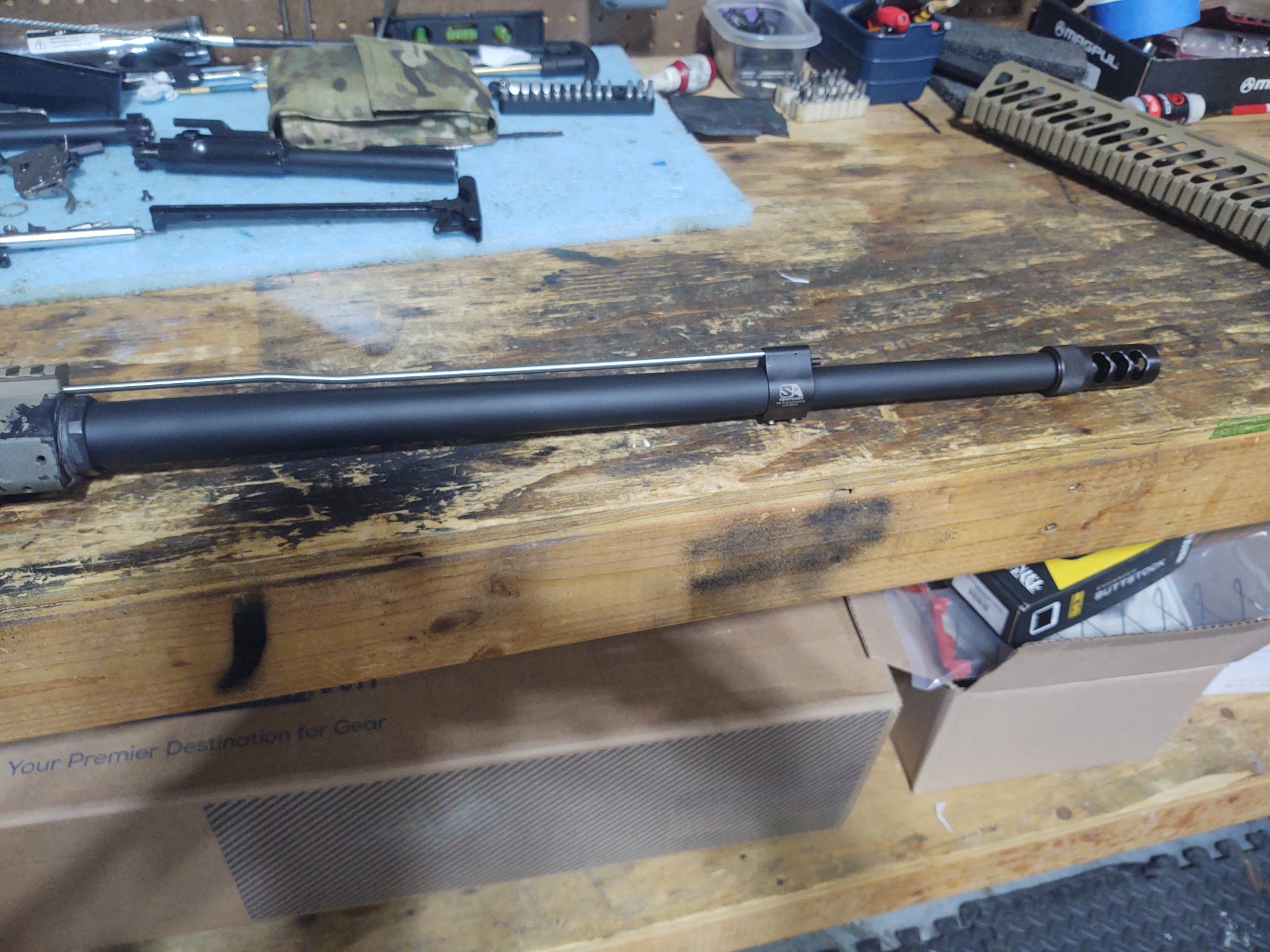

22" Bartlein 1-8 Twist/ 4 groove/ +2 Gas/ M110 contour/ .875 Gas port/ 5/8x24 Threads.

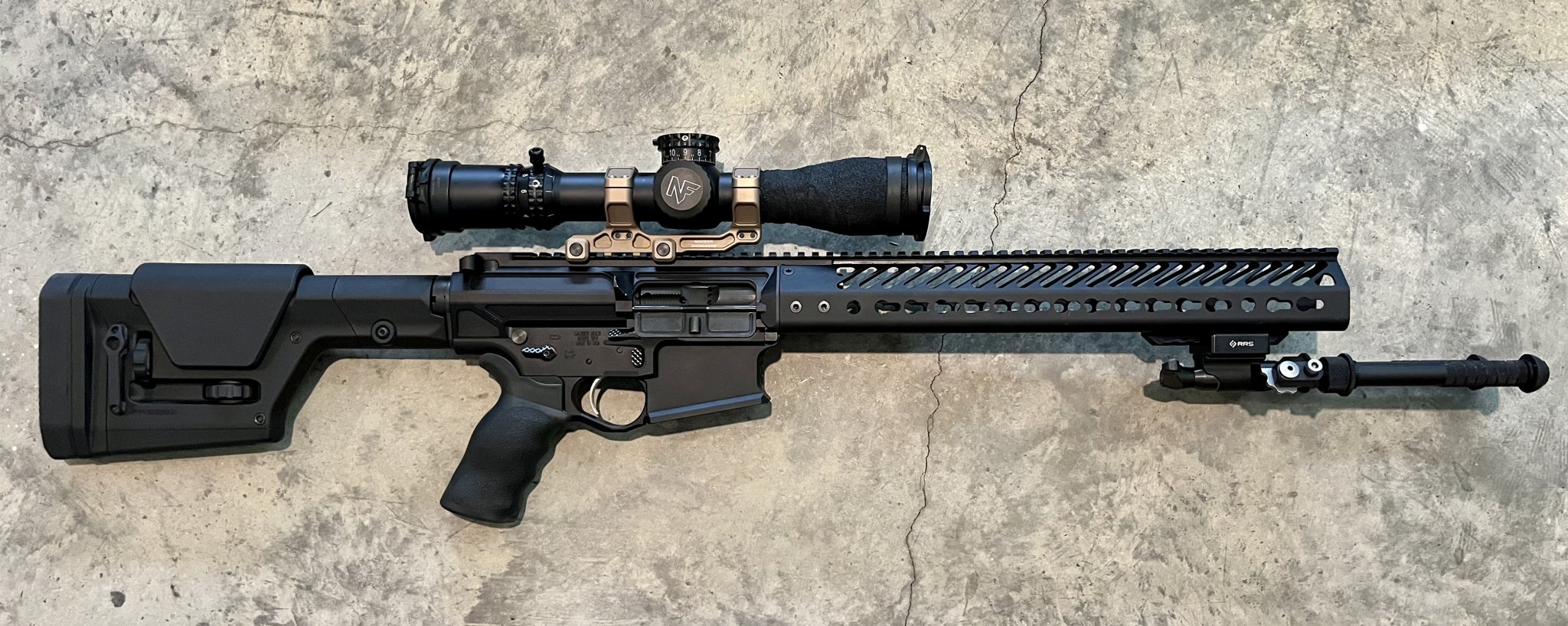

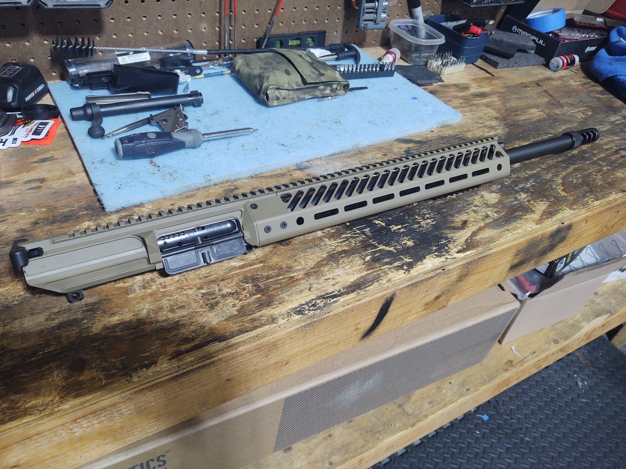

I just finished assembling a SP10 with that exact barrel, I'll post pics in a bit.
Yes definitely no POI shift with mine as you speak of. Just give Paul and compass Lake a call and tell him I sent you. Let Paul know you want a barrel like the ones I request.

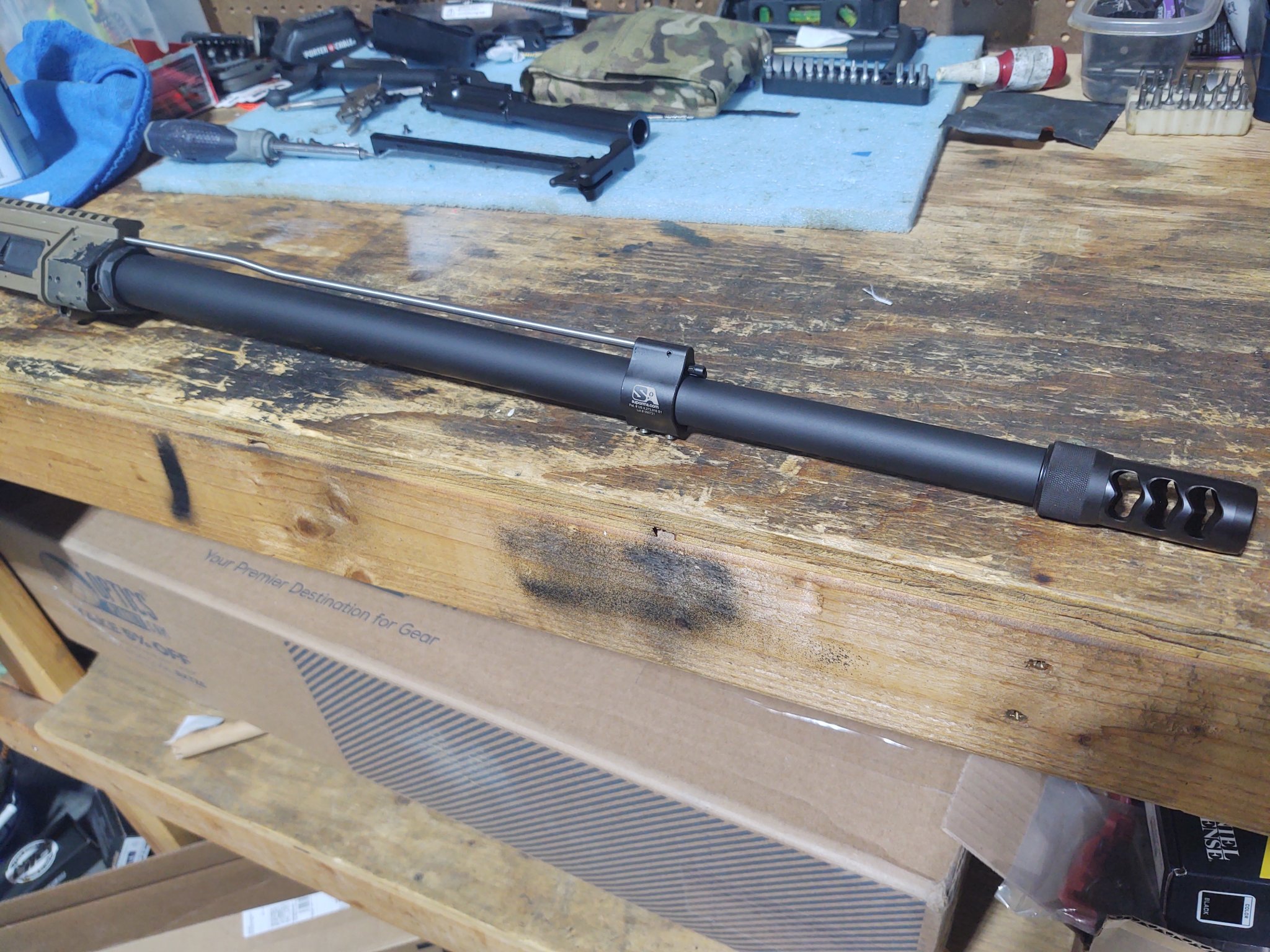

To follow up on my previous comment. After switching to 3 port Hellfire brake, the POI shift issue is gone.

@bigjake83 - very nice work, friend. I’ll be calling you here in a bit.

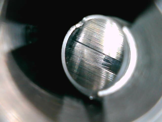

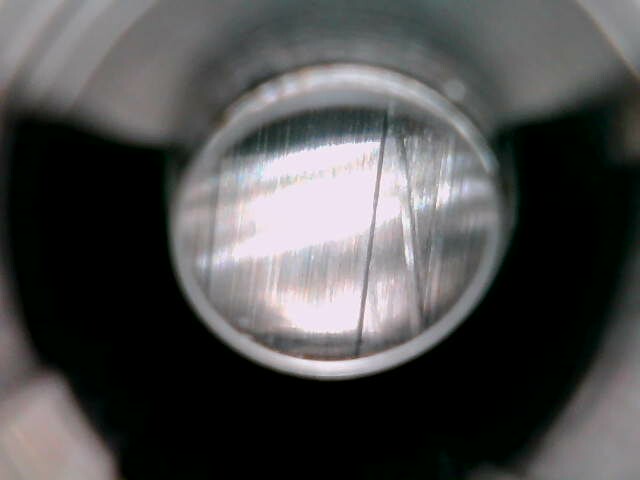

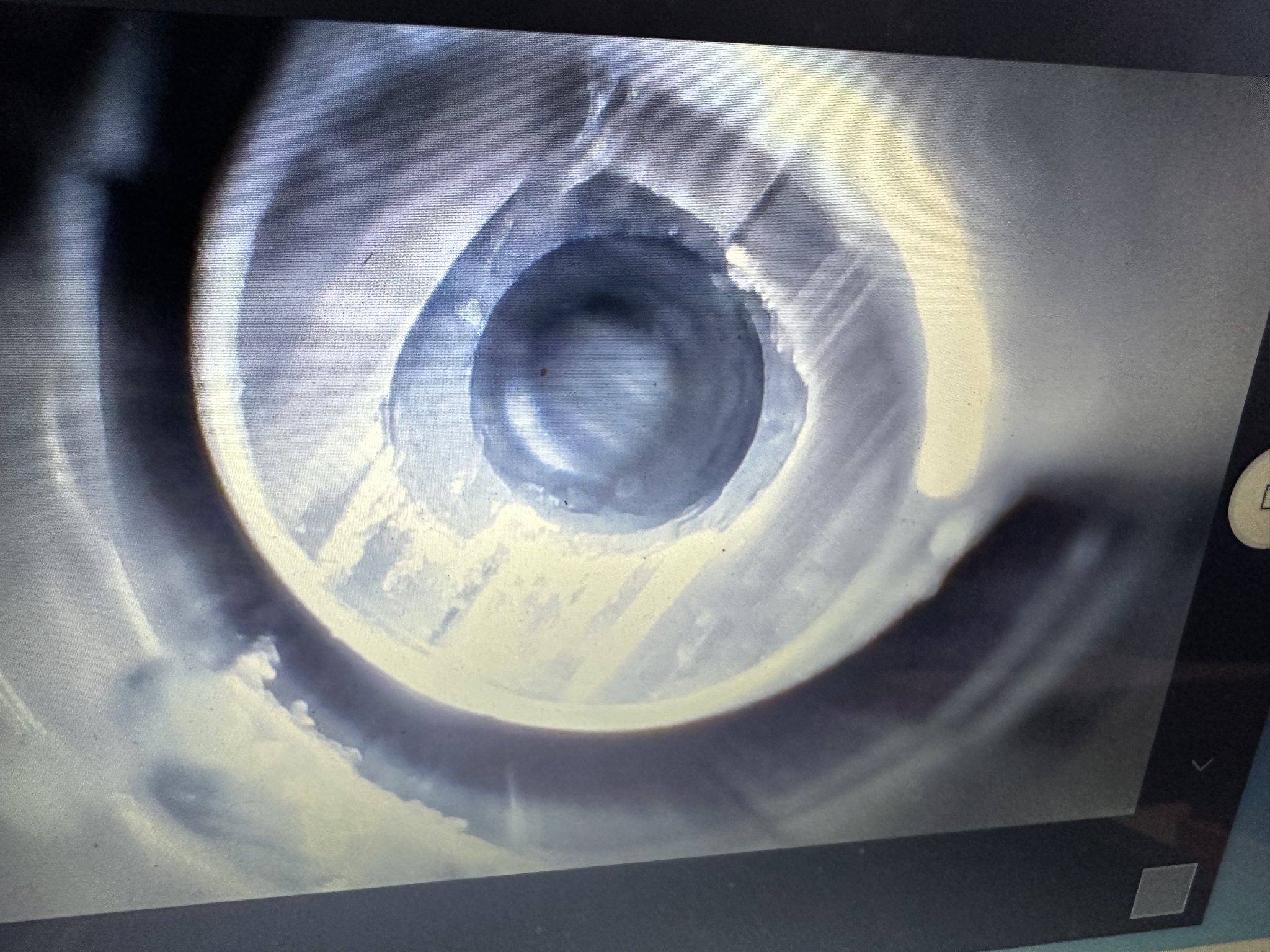

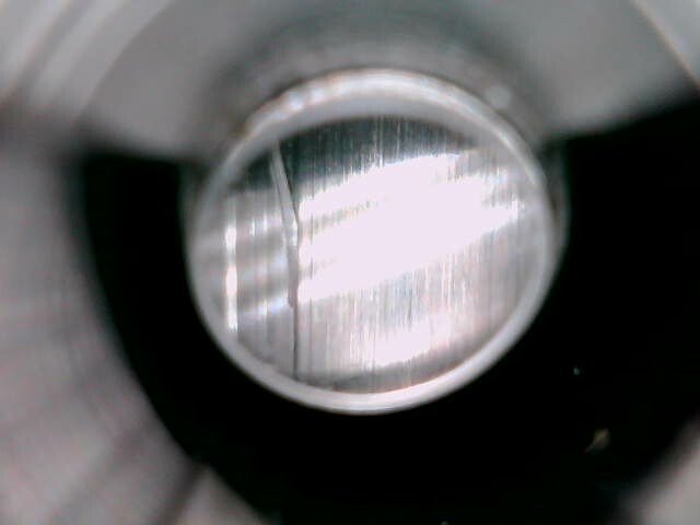

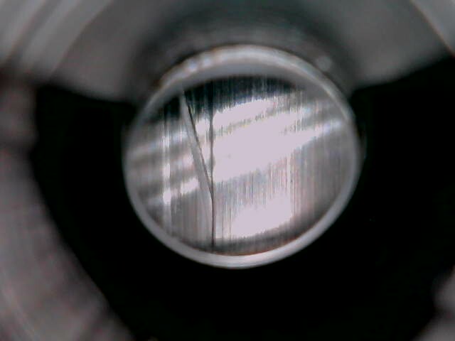

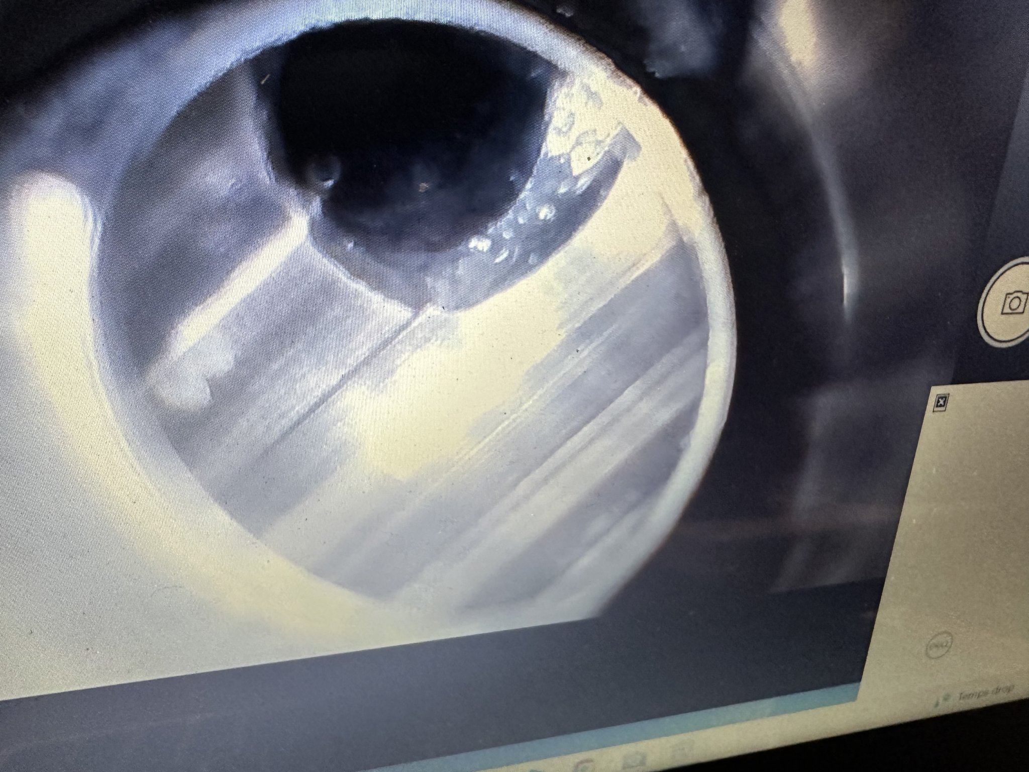

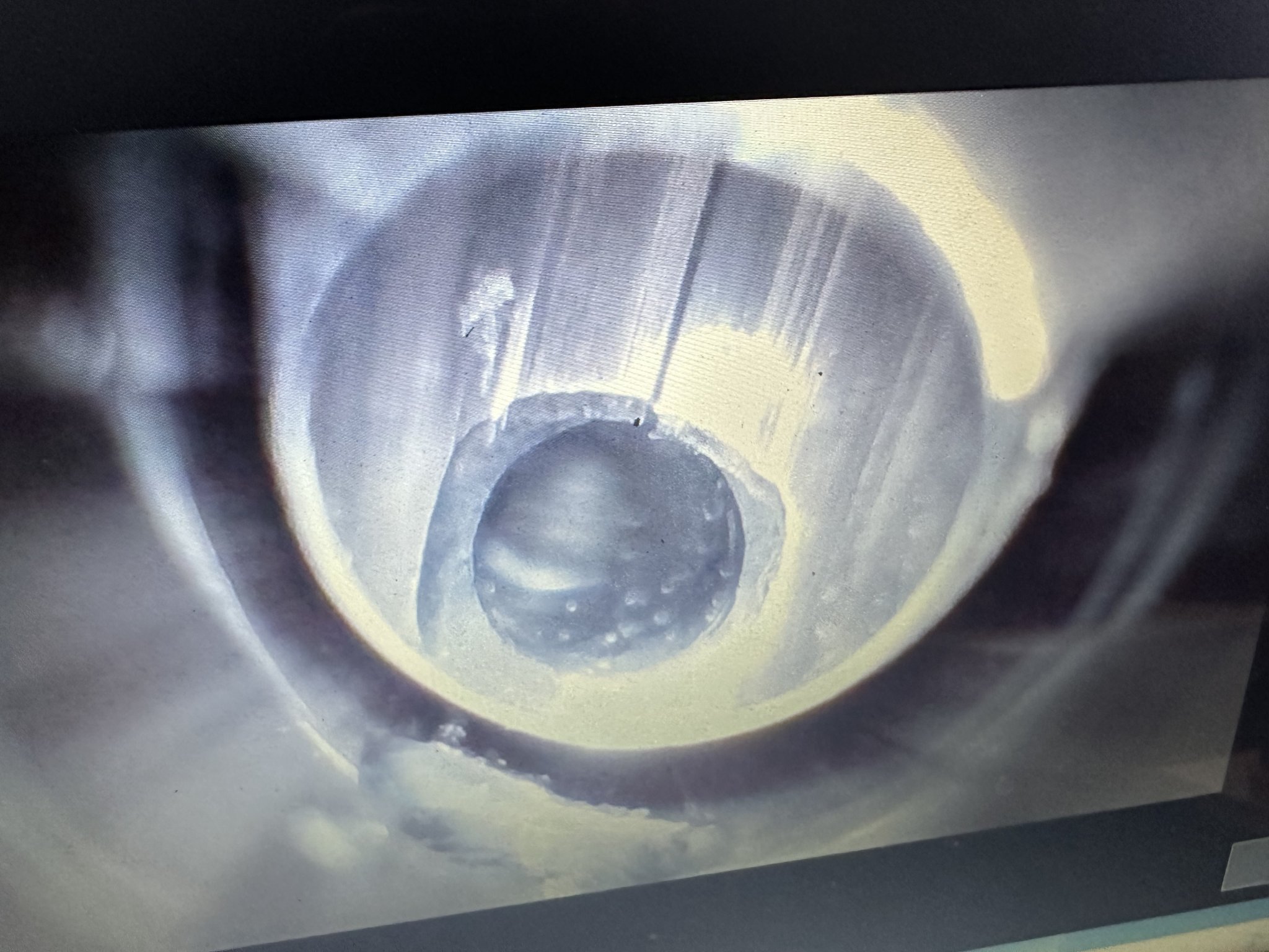

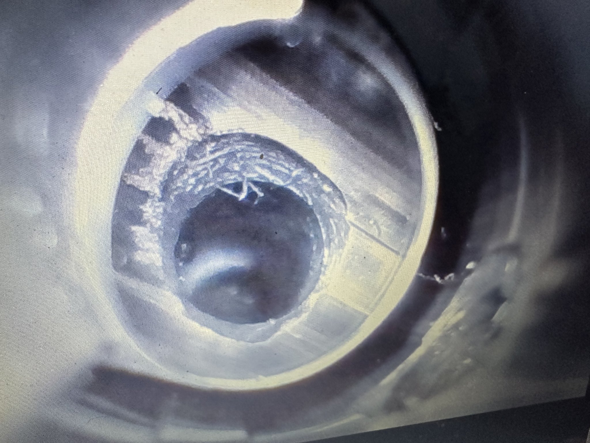

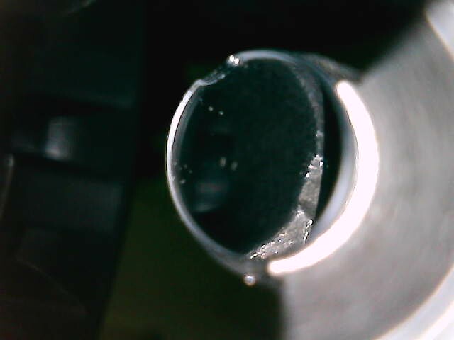

Have you ever seen a gas hole look like this? At first I thought they somehow chamfered it but it looks kind of chunky like it wasn’t done on purpose. The light on the borescope is so dang bright against the shiny ultra match barrel I had a hard time getting it clear so I moved it around to get some different angles. What do you think?
Also, I have both Craddock and Proof 6mm Creedmoor barrels, both shoot well and no issues with gas ports. Proof has 350 rounds and Craddock Bartlien has around 800.
I had the option of either to take to finale and chose the Craddock. I shot the rest of my match ammo this weekend without cleaning and every single group was under 1/2 MOA.
That doesn't look too bad to me. The issue is if its shaving large chunks of copper off the bullet.
For sure if it shoots well and doesn’t deform the bullet I don’t care what it looks like. I’ve just never see a port look like this and am hoping that’s not where the flyers came from. It very well could have been the ammo it was way too hot in the rifle.
I got the bore really dry and got a better look at it. It actually does look like it was chamfered but since it landed on a groove it made the chamfer oblong/not symmetrical. Looks like the groove will need a few rounds/cleaning to smooth out but that shouldn’t be a problem.
Ammo is expensive, and those barrels are 100% money back guarantee within 90 days of purchase. I'd send it back.
Shit it may have already been more than 90 days I didn’t realize they put a time window on it. I installed it a while back and just got time to take it out. If it’s past 90 I’ll take it out again with some non-nuclear ammo and see how it goes. If it’s not good hopefully they’ll swap it out since it looks so sketchy. If it shoots good I’ll let it ride.
Have you ever seen a chamfered gas port? I feel like I’ve heard of them but I’ve never seen one and can’t find any pics of one.

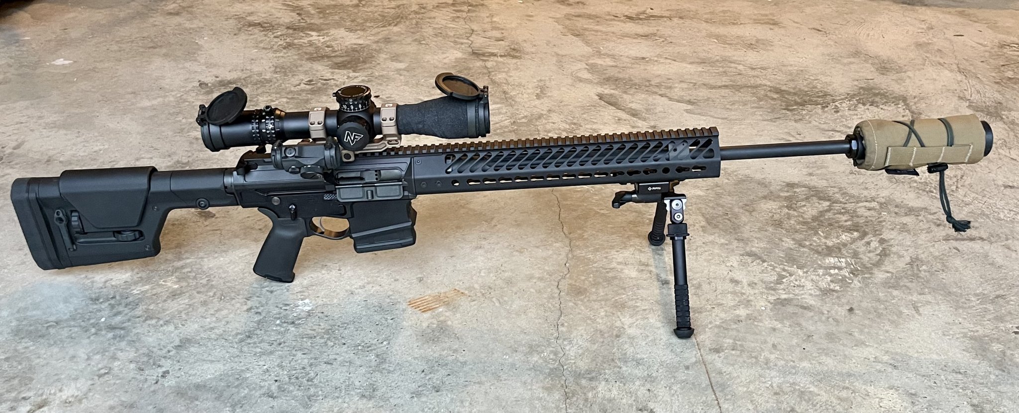

I wrapped the handguard with heat tape and used a F class Mirage Shield over the barrel.

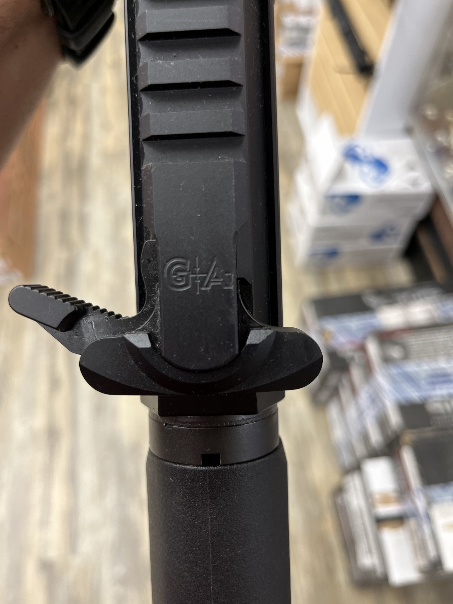

I caved and snagged an old SPX for too good of a price to pass up. Currently a work in progress to get re-barreled and some components replaced. Obligatory pic.
An interesting note that I have been unable to get an answer on, is the lower and barrel are marked Seekins, but the upper receiver is GAP marked. Any ideas on this?
Seekins makes the receivers for the new GAP 10 G2, so more than likely they used that upper to complete the order for your SPX which was the first generation of the SP10.

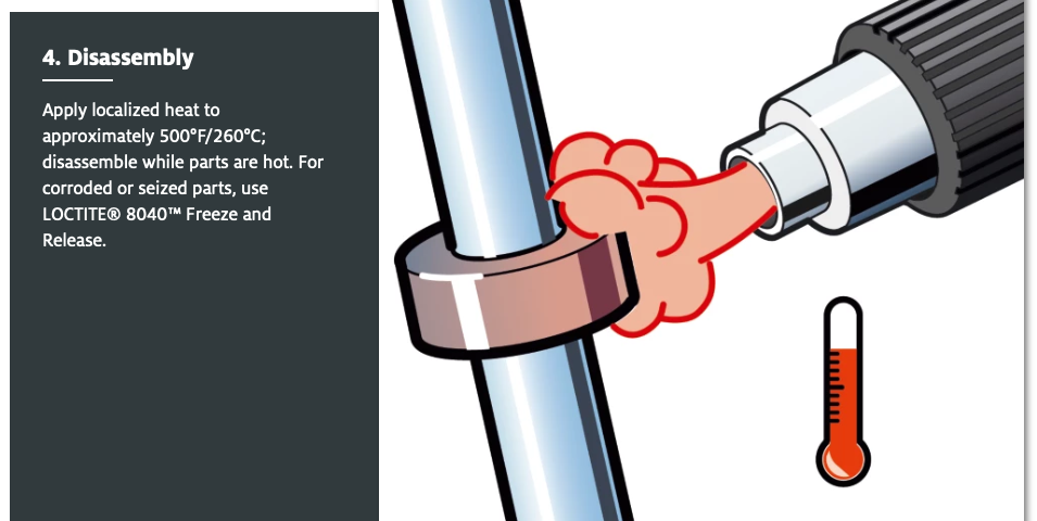

I did use Loctite 620 on both barrels
I’ve used Loctite 620 on several guns I’ve built and always had good results. Of course, I did not test them before using Loctite, so who really knows. What I have not done is remove one of my barrels that was bedded with 620. Have you removed a barrel bedded that way and if so, how did you do it and how much of a pain was it?
Reactions: Earnhardt
It's a pain in the ass, you just have to heat up the forward end of the upper and beat it out.
I used a propane torch (not acetylene). It doesn’t take very long to expand the aluminum. I bought a piece of wood that fit relatively snug in the upper and was expecting to have to hammer the barrel extension but ended up only having to tap it out by hand. The green loctite only bonded with the barrel extension and did not bond with my upper.

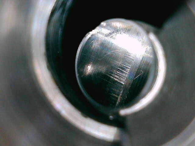

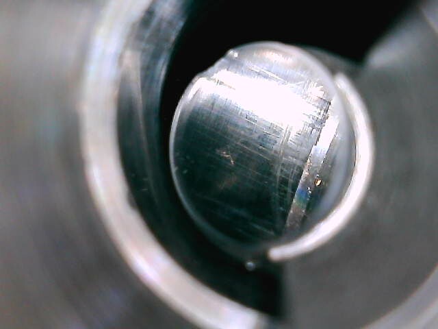

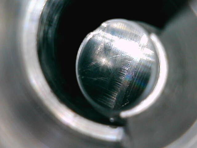

View attachment 8179842View attachment 8179843View attachment 8179844View attachment 8179845View attachment 8179846View attachment 8179847

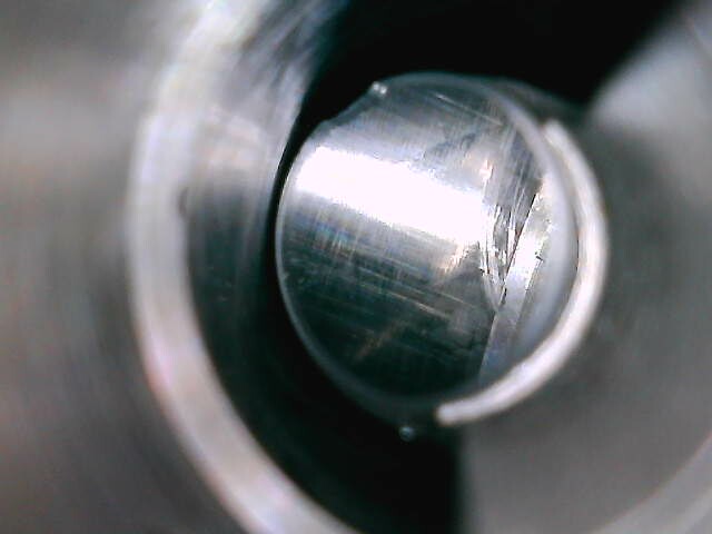

View attachment 8179853View attachment 8179854View attachment 8179856
Are you seeing this problem with their steel barrels?
No but I haven't bought one is probably 2 years.. all the SS proof research barrels I've owned have been very good so I do still recommend those to people especially for .308, 6ARC, 6.5G and .223 because they're still a single point cut Barrel in the $440 which is a pretty good deal compared to its competitors like the Rainier Arms Ultra
Match which is in the same price range, and every proof SS Barrel I've had has outperformed all of the Rainier ultramatch barrels that I've ever owned.
Just make sure to buy it from a company like Brownells, Midway USA or opticsplanet and that way when you get it home it looks like shit send it back..
Reactions: kriller134
You never know with this stuff it can cause your head to explode. I bought a BA barrel and it had beautiful rifling and an off center chamber.
BA replaced it and the replacement had a perfectly cut chamber with Savage style cut with a chisel rifling, but it shot good. My latest Proof steel barrel is good no issues with the machining.
