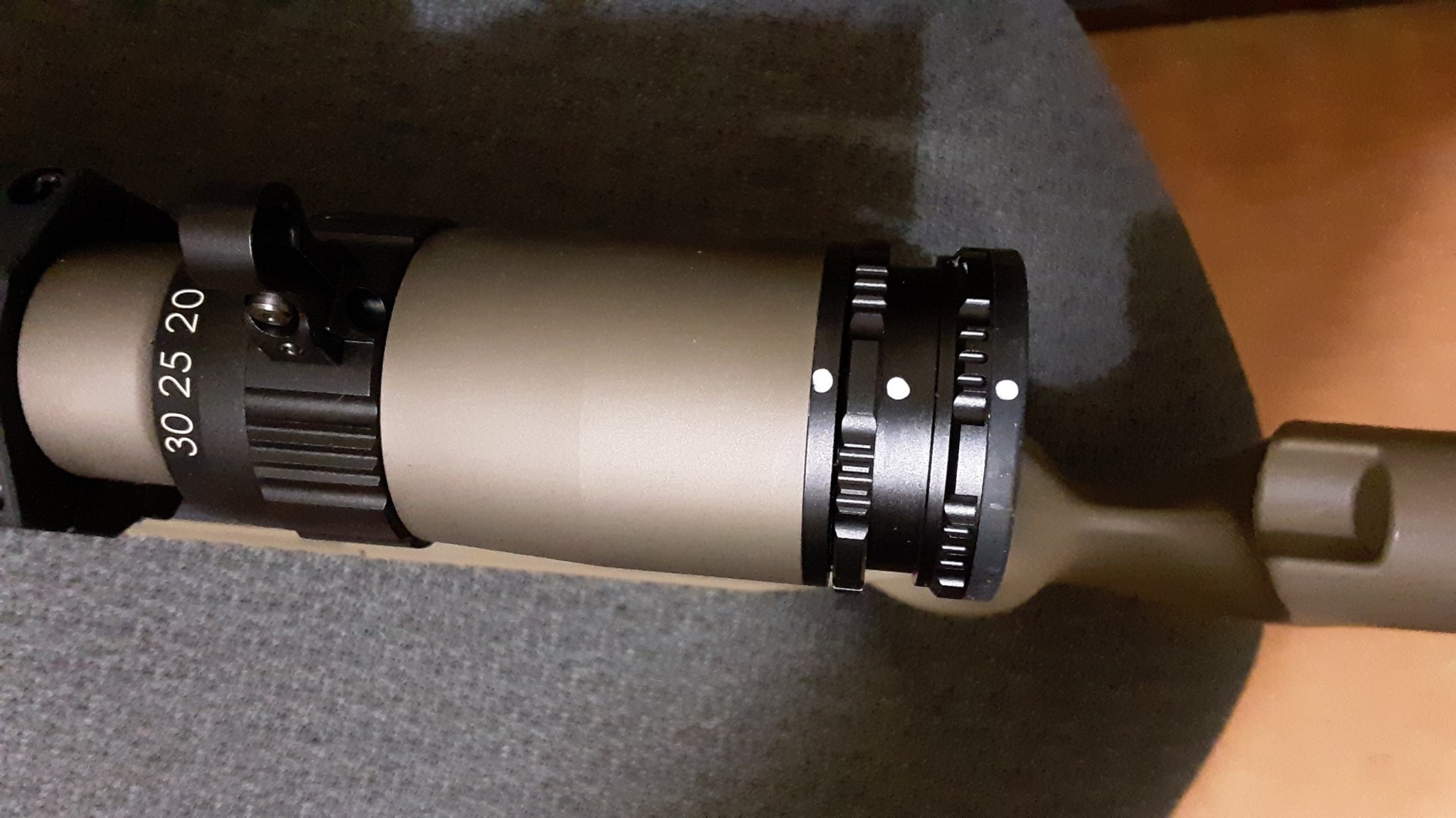

ATACR F1 synchronizing the Parallax, Focus and Diopter
An alternative method.

    I also used to use the blue sky, but switched over to using a blank wall on my last scope (2-10x50 for hunting), and for me it worked much better. I did not put the parallax on max though, how does this help? I have only used that scope at 200 and under if that matters.
    Walkalong
    Dec 31, 2018
    18
    5
    Anyone else almost never have to adjust a diopter out of the box?
    When I was young I didn't need to, but now? You bet I do.
    Once I get it set I mark it with tiny dots of white paint. That way I can go back to it if it gets off. Even if it has a locking diopter I do this, then if someone else needs to use it, they can set it for their eye and I can dial it back when needed.
    I have some Minox binoculars that have a scale on them, so I can set it for me, then just remember the setting.
    I use the flat end of a small drill bit dipped in paint to make the dots, works pretty well.

    Great information! Thank you! I got lucky that one of the raised portions on my diopter ring lined up perfectly with the "0" mark on my scope so I put a wee spot of blue paint from a paint pen for repeatably in case of movement. Wrapped the ring in electrical tape followed by slipping the scope cap on and I think I have a pretty secure lock. Thanks again!
