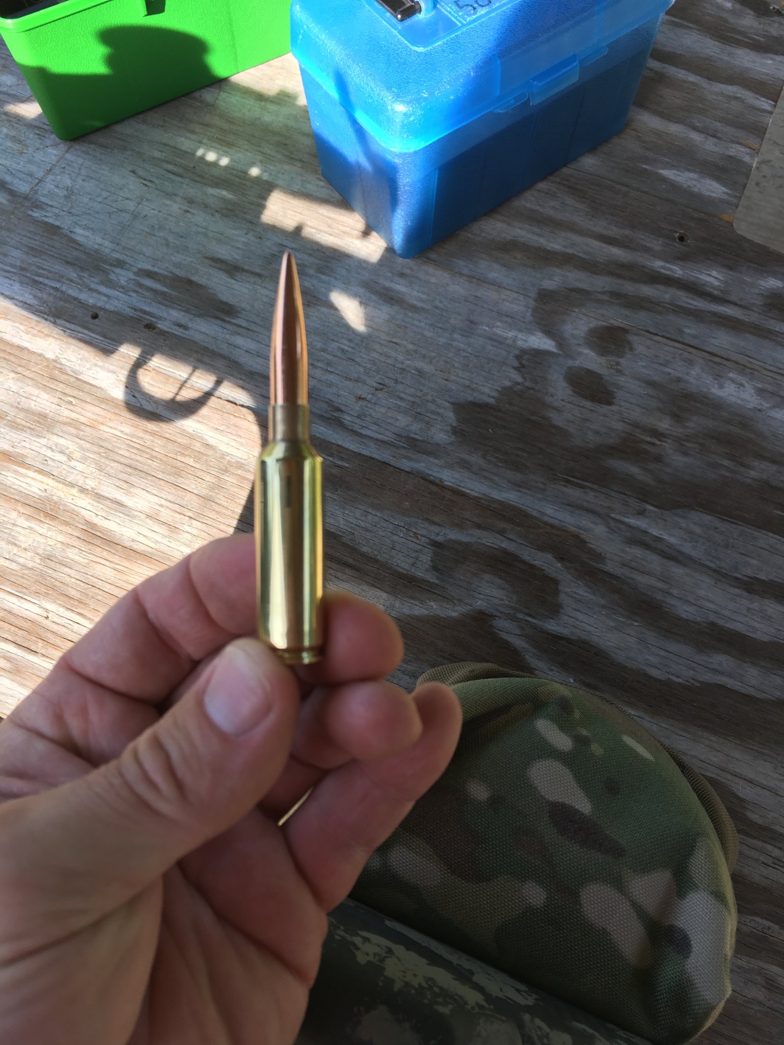

Tagging in. 7 MAX with a 195 Berger at 3000 fps on a medium action sounds interesting. Might have to bite the bullet and buy a reamer.
Was really thinking about doing a 7mm LRC, (338 Lapua short improved necked down to 7mm and 84 gr. capacity). There was a 300 LRC, too, but can't find a single post with performance data on either one after Swamplord announced reamers and brass were available last December. He must have let that project die for some reason and apparently nobody else built one. Too bad, should have been a fantastic cartridge.
While the performance may be a little less than the LRC should have been, I at least know the 7 sherman max will be supported by lots of data and regular updates (like all Sherman's other projects) so I'll know what performance to expect before buying in. May go this route.

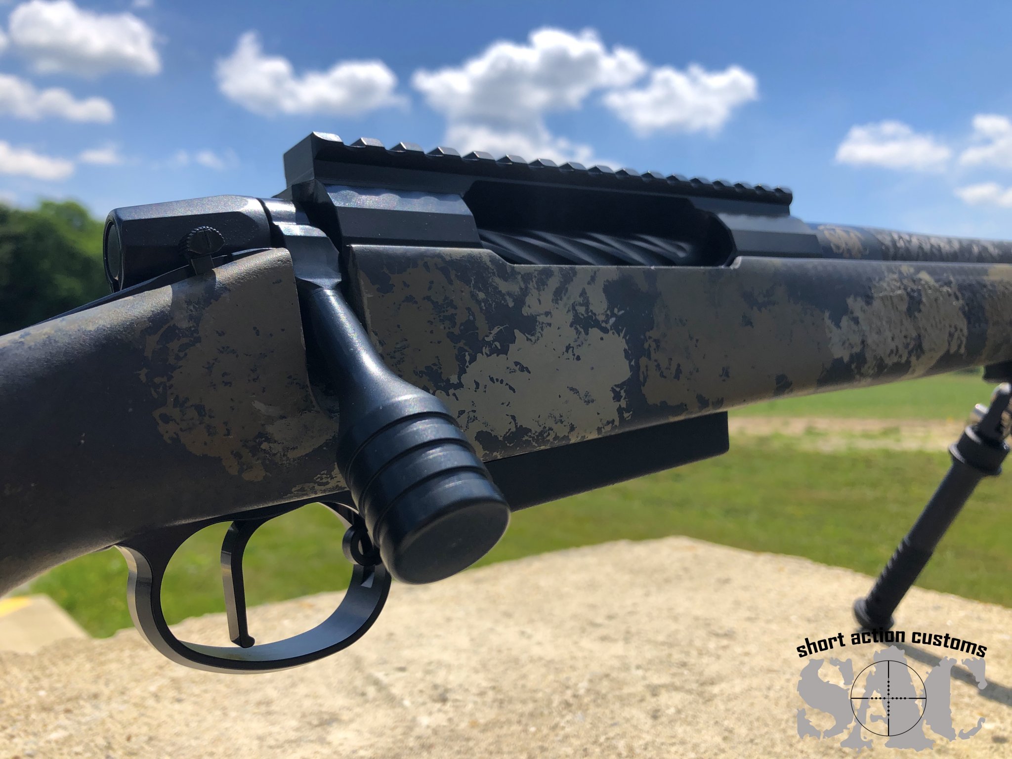

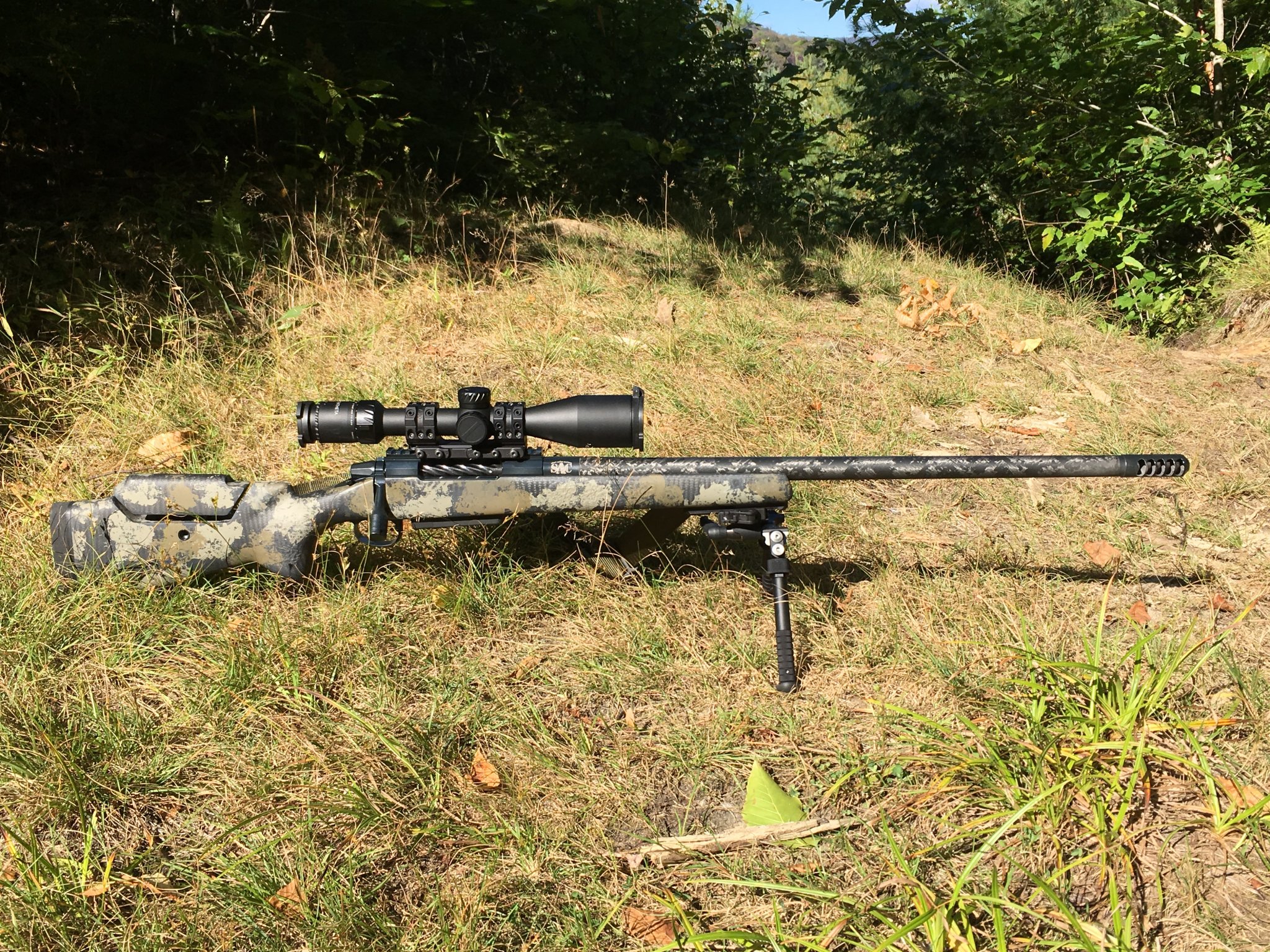

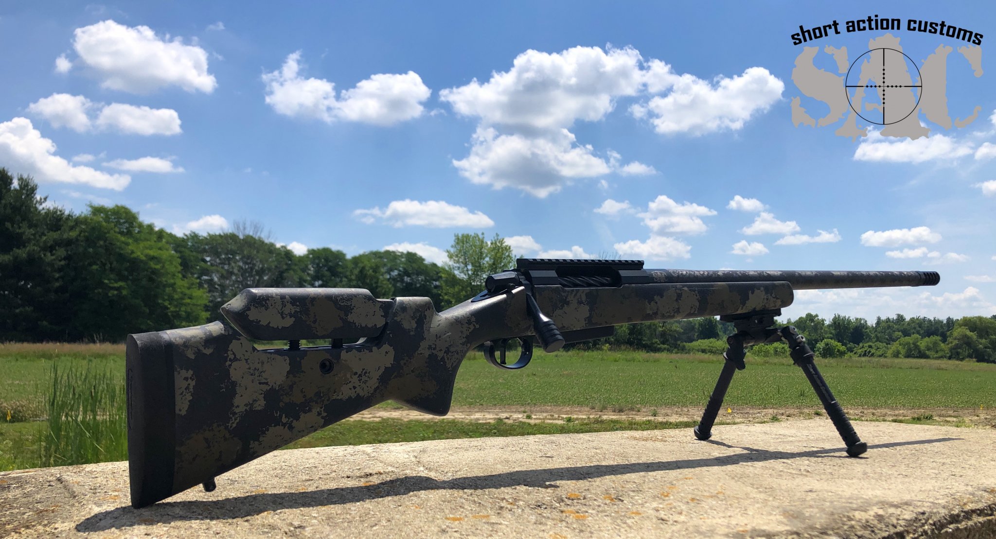

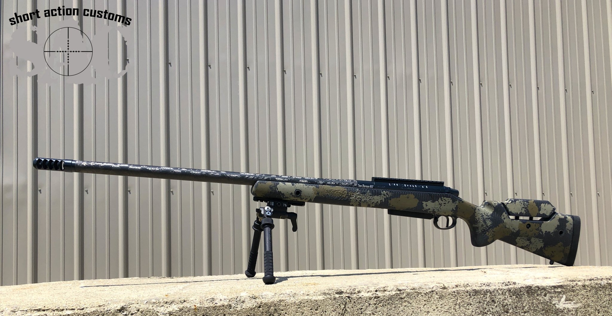

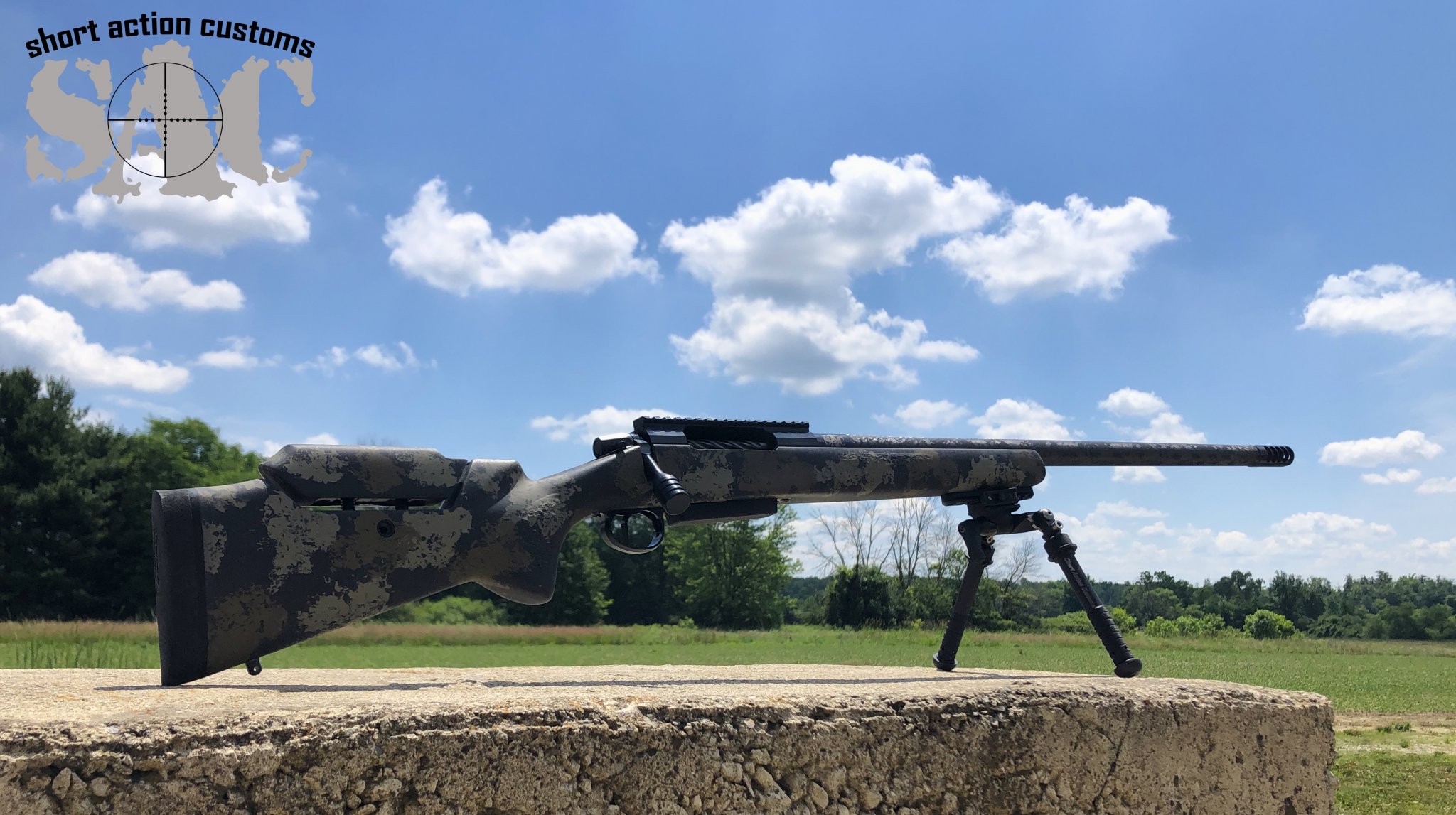

Thanks SAC! Little gun porn....
I loaded a few test rounds, testing in the morning. I did notice how easy the primers seated on once fired brass w a mild fire form charge. ADG brass is nice but the primer pockets are NOT tight like Lapua. I hope she holds tight.

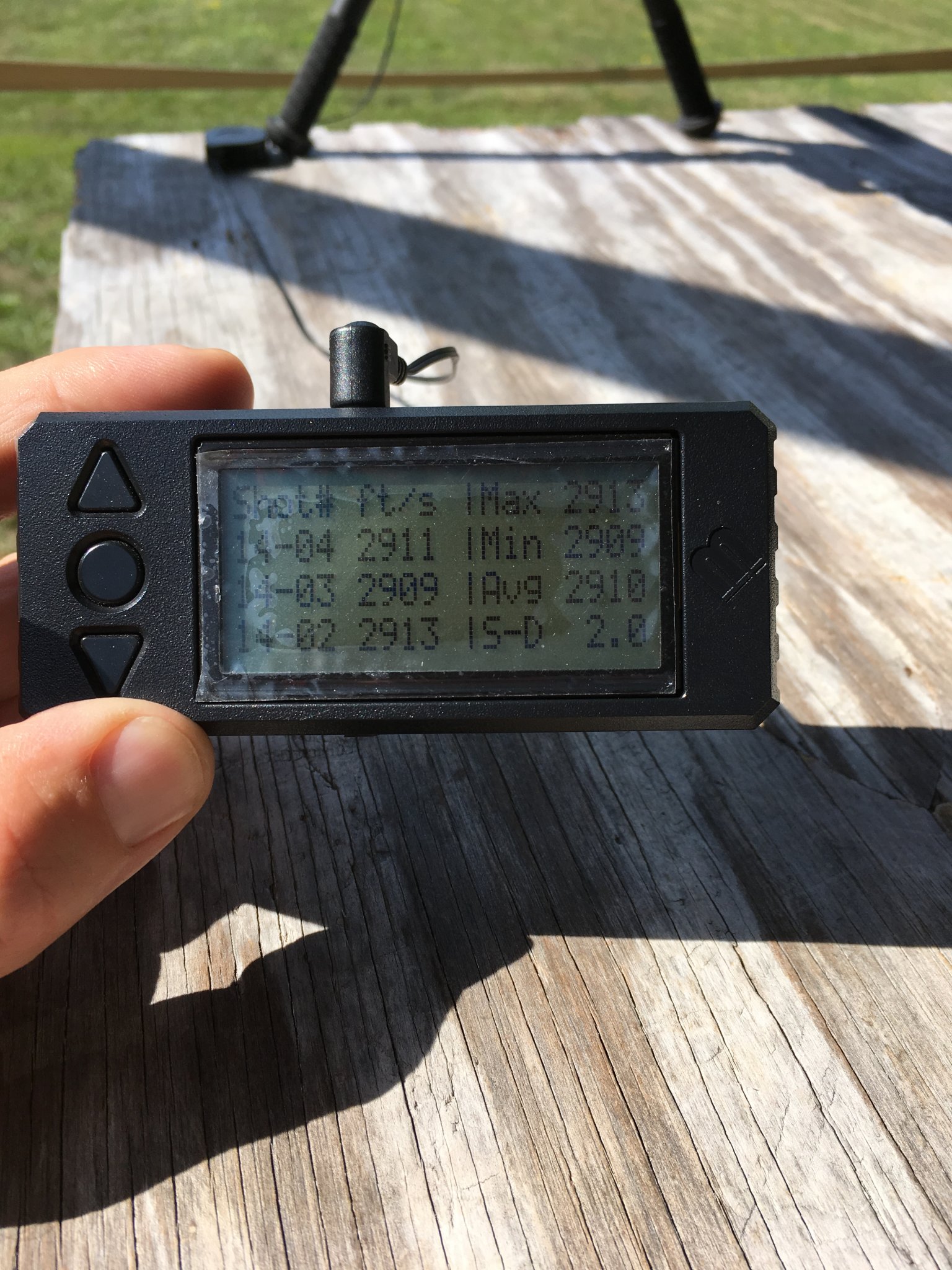

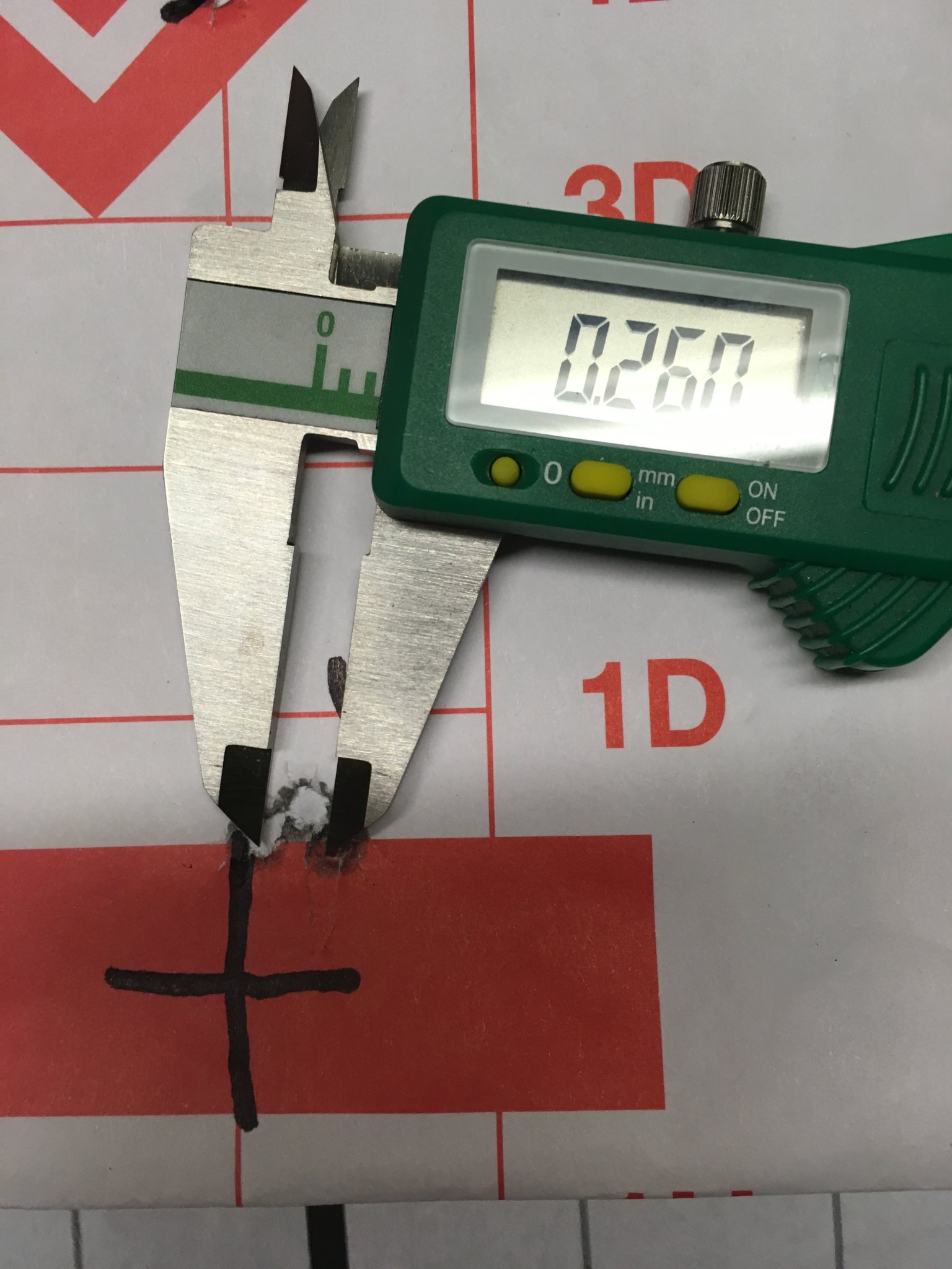

Tested both those loads at 1K this morning. The 68 gr N570 was the winner. Went 10 for 10 pretty much touching on a half moa round target prone from a hunting rifle. Love it....time to load some for Ohio and the 1 mile target. We will see how it holds up to my 338 LM AI w 300 Berger's.

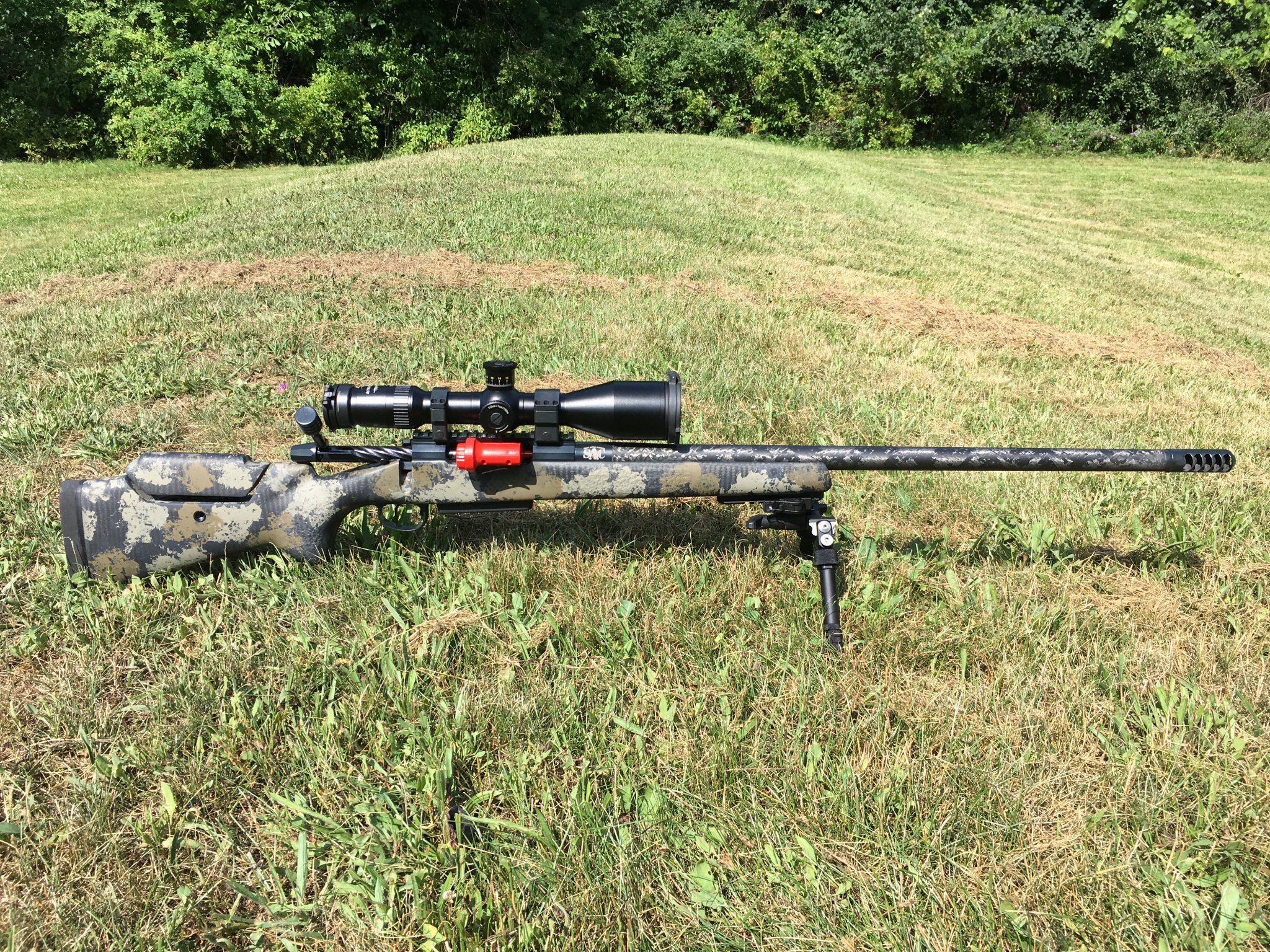

These 190 A-tips are very forgiving. All powder charges have produced groups in the .2-.4s being the largest. Just received my Amp pilot so time to get serious w load development.

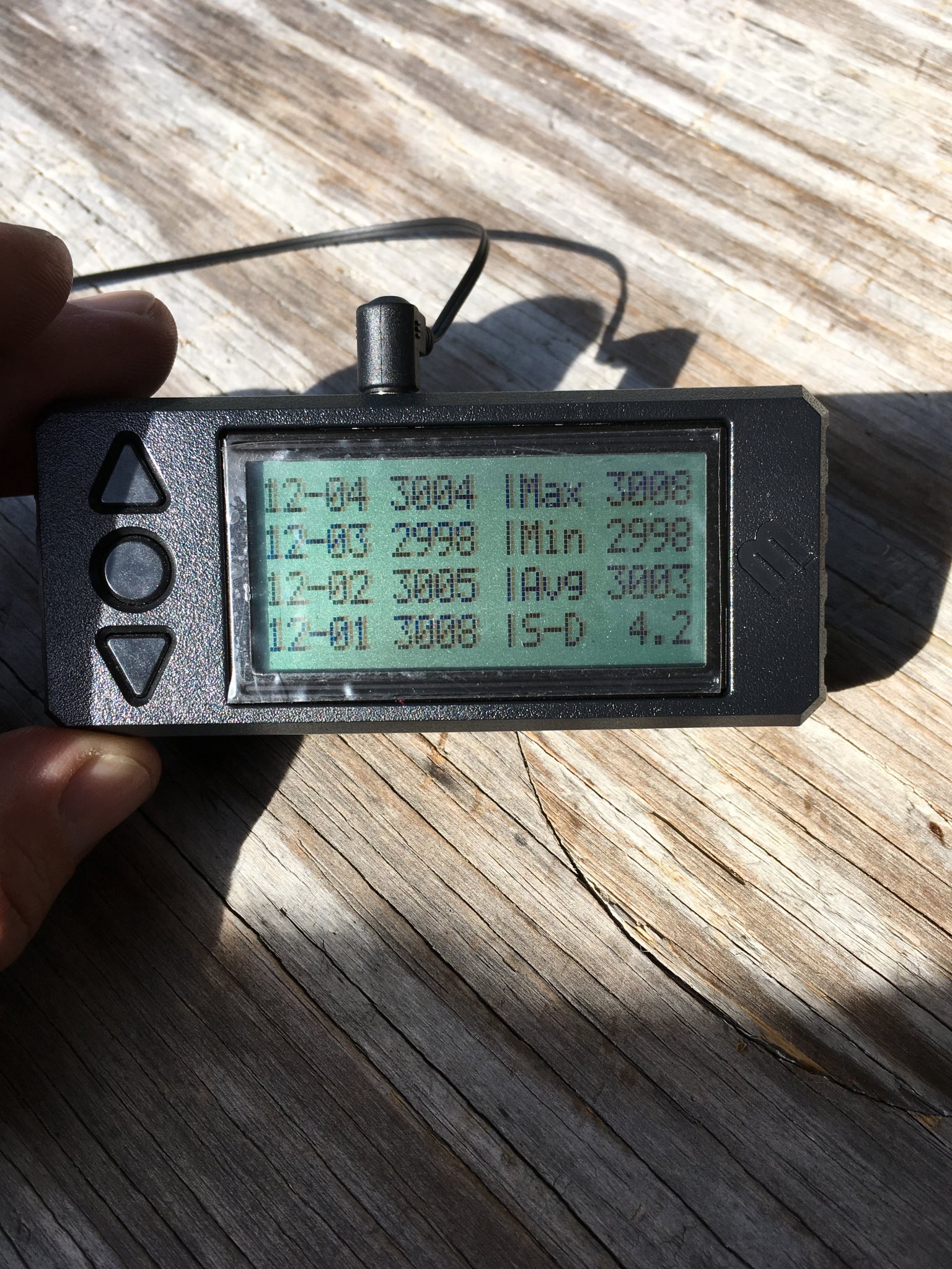

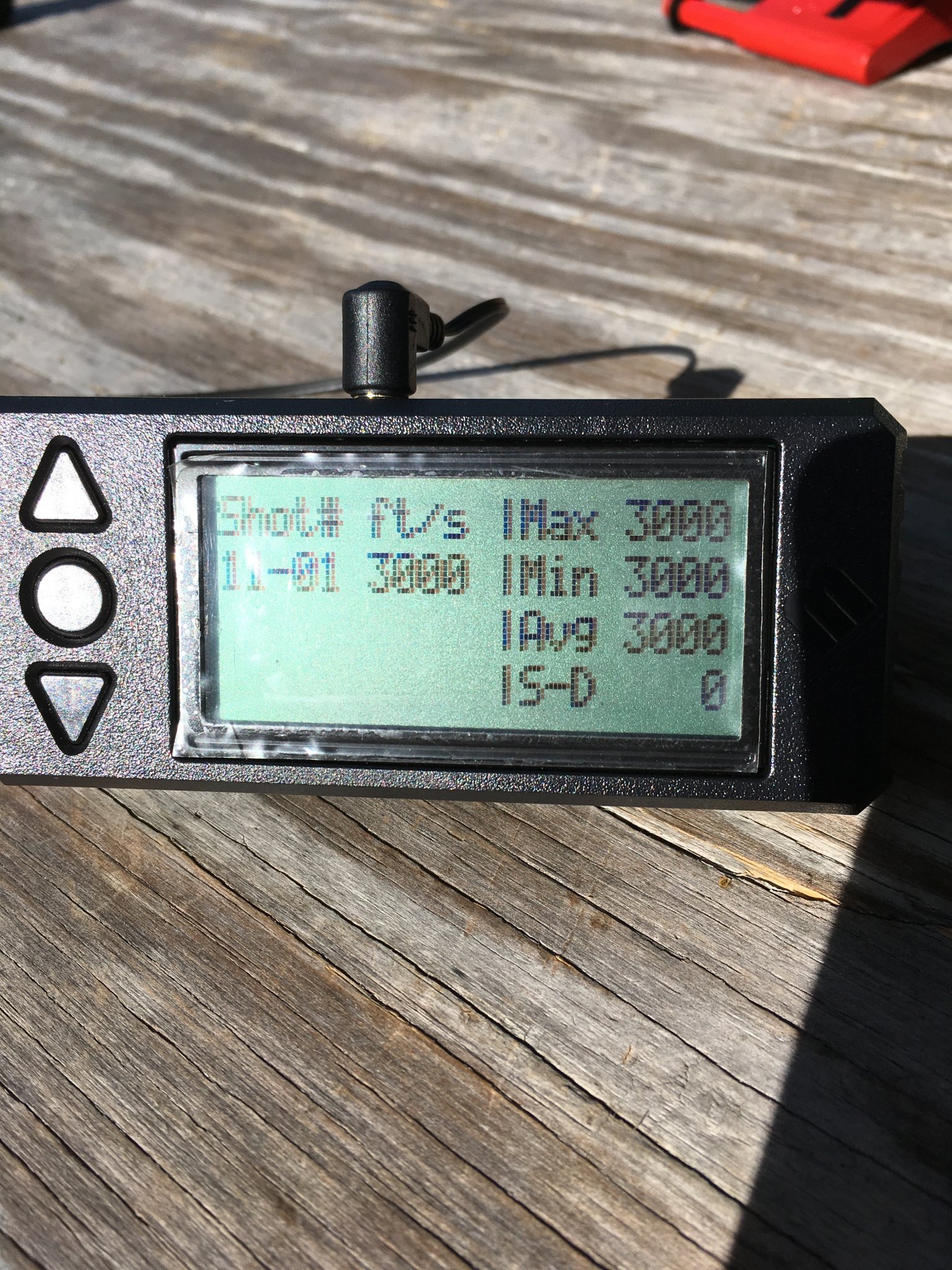

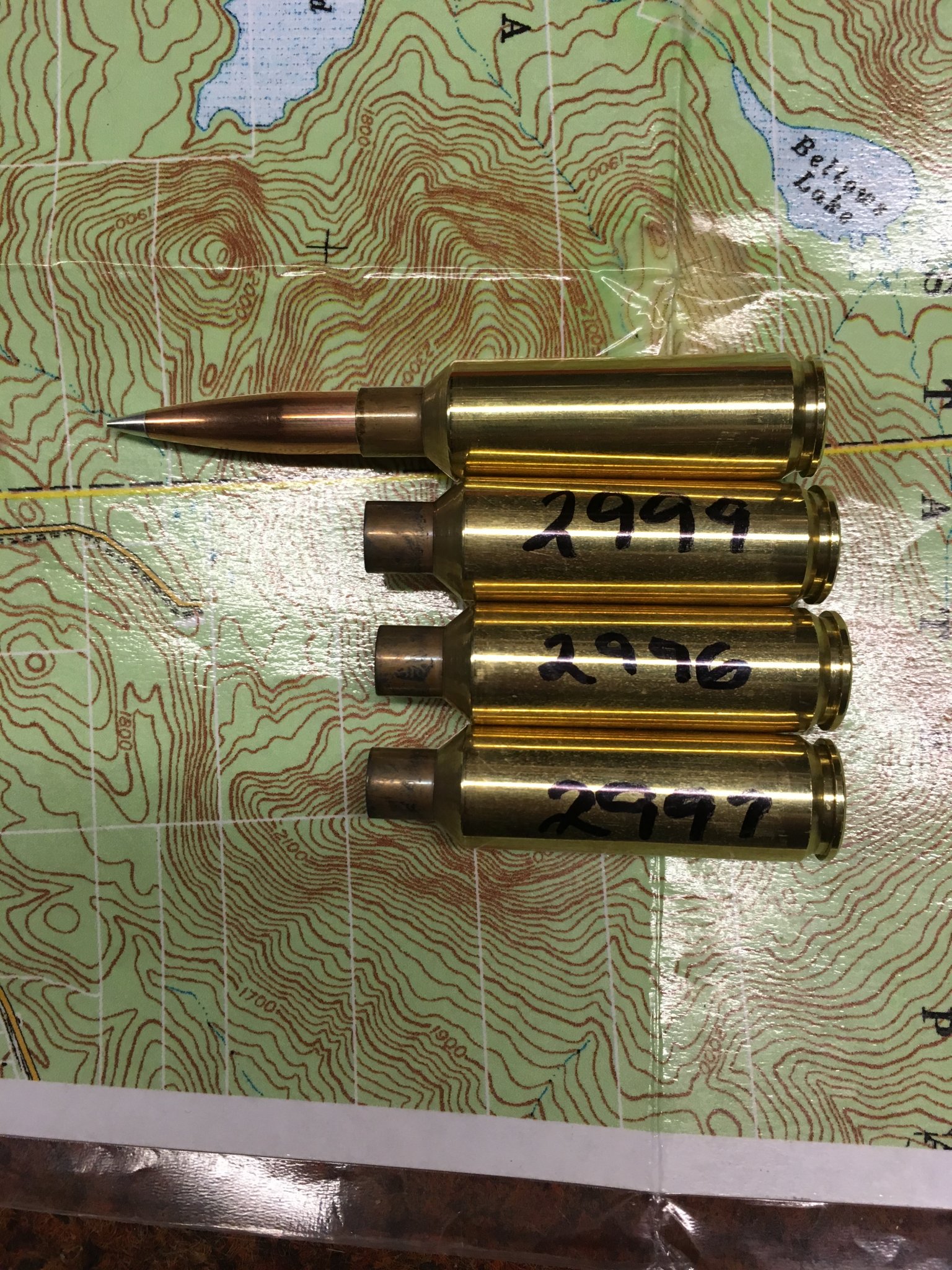

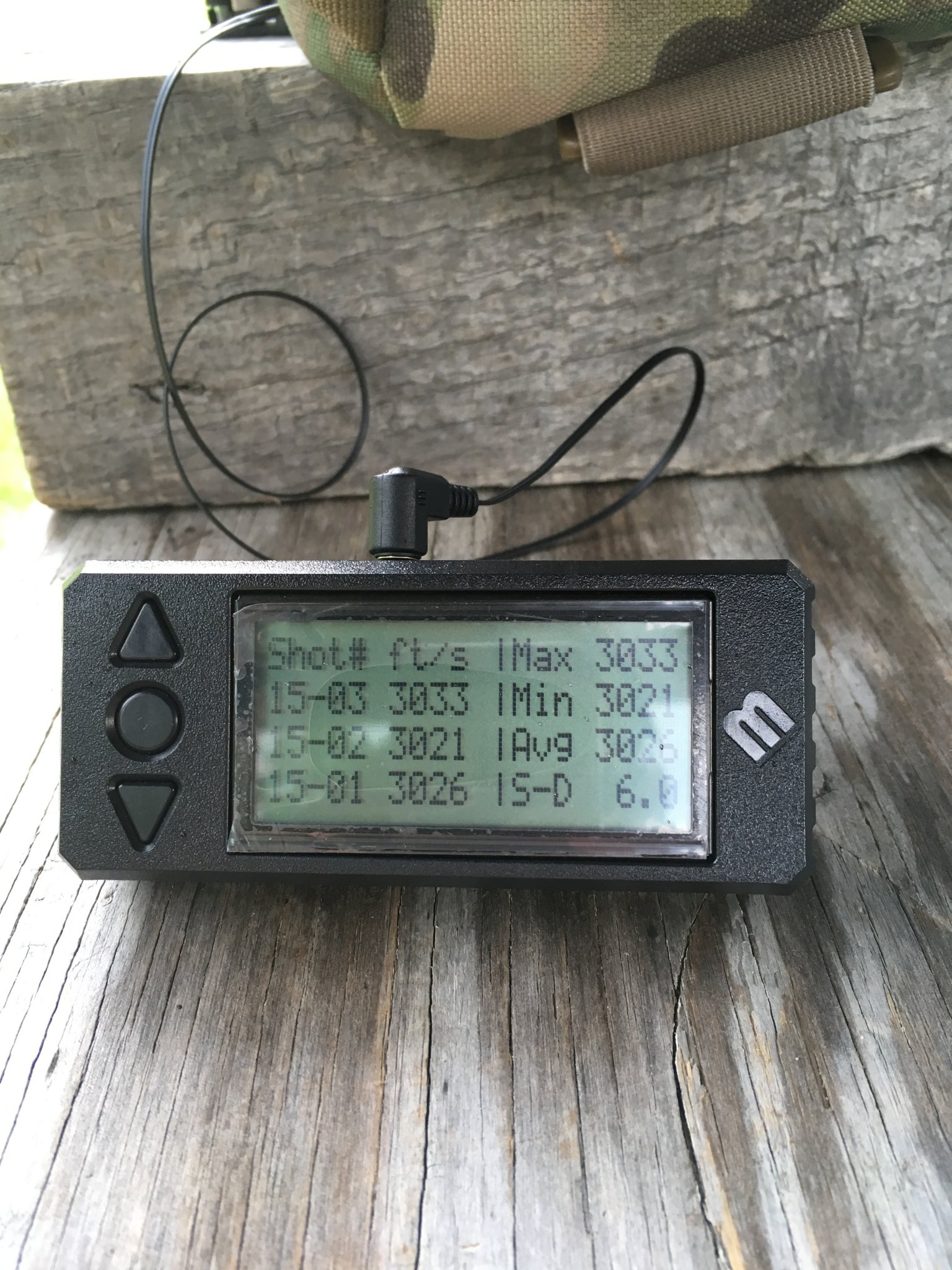

Ran the 190 A-Tip w N570 up to 70 gr... which is about max in my rifle. Light ejector marks, no heavy bolt lift. No change in velocity w 69.8-70 gr N 570 yielded 3033 FPS in 26 inch barrel @ 40 degrees. Settled on 69.1 N570 which gives me 3000 FPS w the best accuracy. Smacked a small rock at 881 yards to ck my cold bore shot for POI and the report says it hits w authority.
