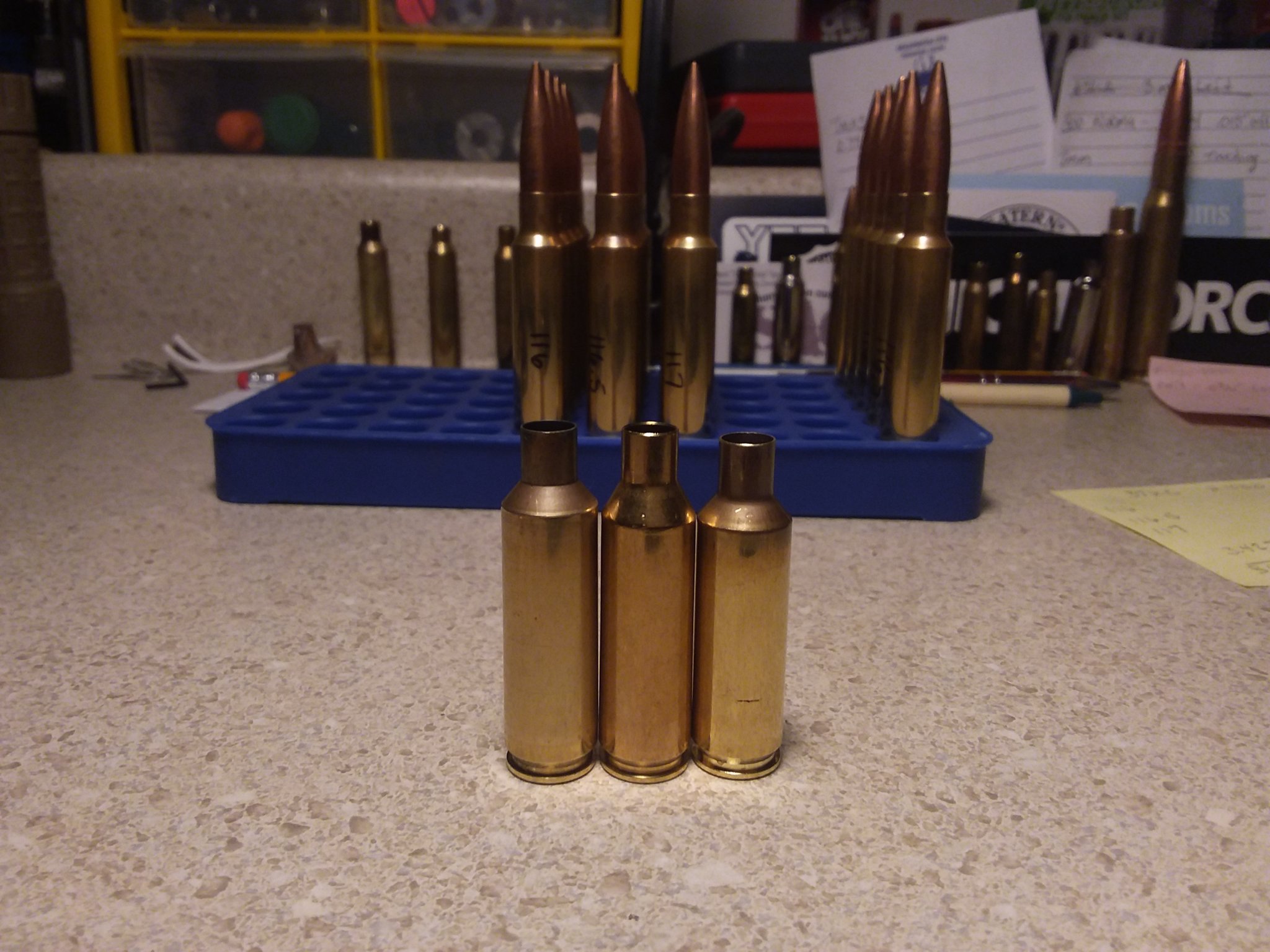

Not to throw a wrench in plans but sherman is coming out with a new case holding 6 grains or so more than 7 max like a wsm improved or something. He said planning on summer........ I will be making one og those for sureHi all. Been reading everything about 7 saum, 7 ss, and 7 Max. Can't decide which one to build. Already purchased a Defiance Tenacity long action DM, and 26" Bartlien Sendero 8t barrel. Want to shoot 190gr. Bergers accurately. Have R26, H1000 powders plus others. Will drop barreled action into a chassis for shooting steel and possible hunting. This build will compliment my 300 Norma mag and 37xc for shooting steel at a cost saving. L-R Max, Saum, SS.

Just a standard 7 saum reamer works very well with ADG brass and 190’s are touching at 3.050ish when brand new.Hi all. Been reading everything about 7 saum, 7 ss, and 7 Max. Can't decide which one to build. Already purchased a Defiance Tenacity long action DM, and 26" Bartlien Sendero 8t barrel. Want to shoot 190gr. Bergers accurately. Have R26, H1000 powders plus others. Will drop barreled action into a chassis for shooting steel and possible hunting. This build will compliment my 300 Norma mag and 37xc for shooting steel at a cost saving. L-R Max, Saum, SS.
The nice thing about the Sherman line of cartridges is none are Sammi, nor are the dies. If I build the saum I think I'd like to order custom reamer with tight tolerances and long freebore. Love to hear your thoughts.
ThanksView attachment 7598240
