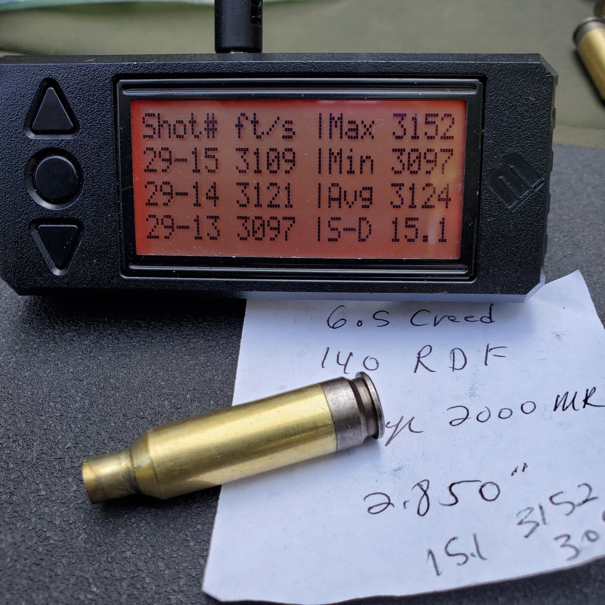

In one 10 shot group test, hybrid cases out shot Lapua LR and SR palma cases with 230 gr match bullets in 9 twist 308...best group, tightest velocity spreads...Lapua SR palma cases were the least accurate with the highest S/D in velocity.

Hand load you can run 150 gr bonded bullets to 3100 in a 22" hybrid cases...or 2875 fps in a 6 lb, 16" AR 10 with Lapua cases.

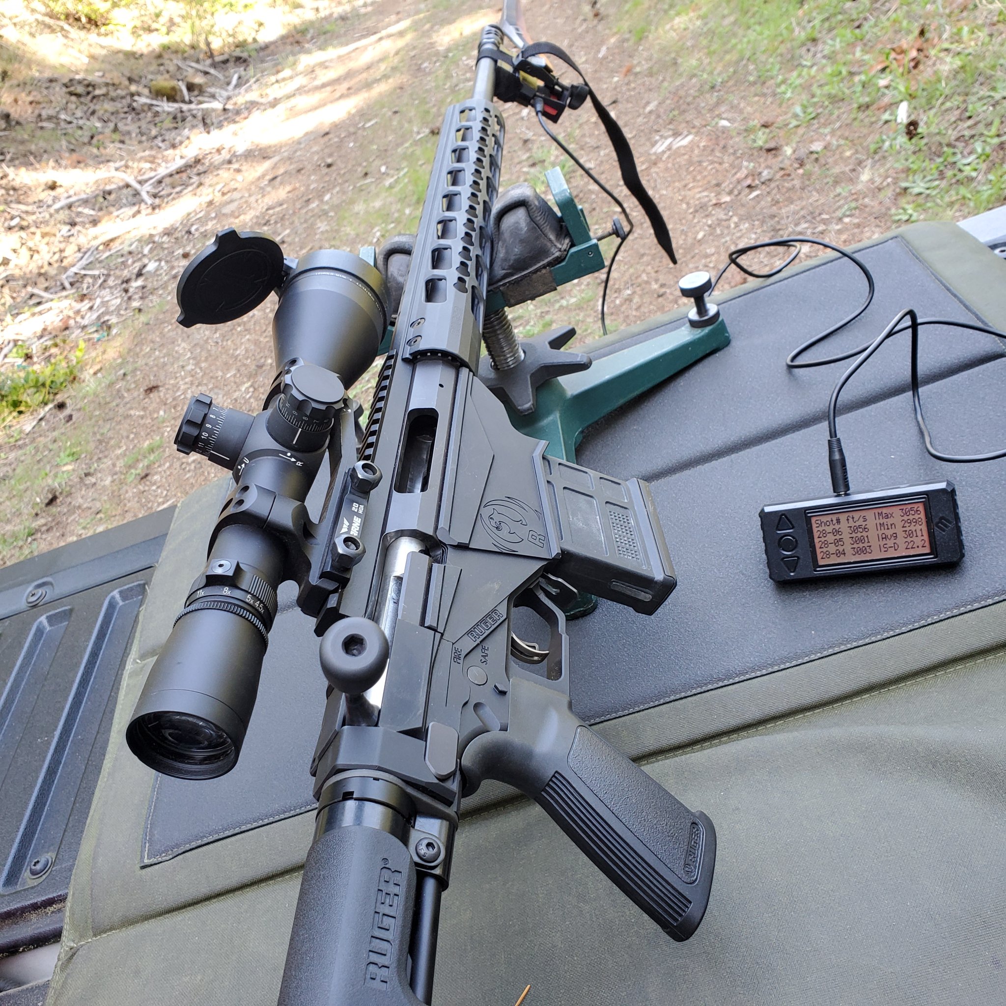

I run Ruger and Remington 700 actions with hybrid cases to 80,000 psi...according to QL. But all pressure is a guesstimate.

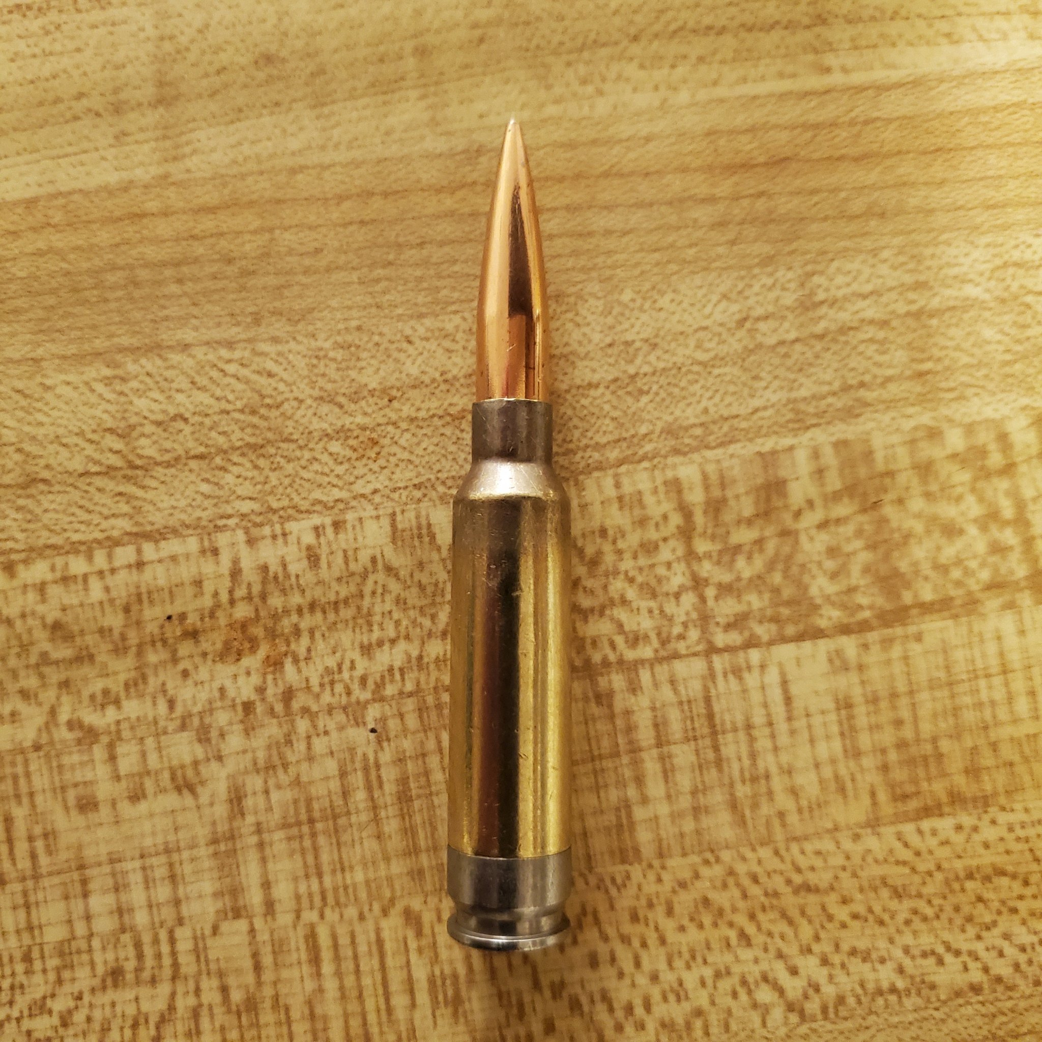

This will be fast in short barrels also, this is a 180 gr Berger...all I need is a finish reamer, and an 8 twist barrel.

Hybrid cases themselves are easily reloadable. Typically only the case head is steel. These are a full steel alloy case, including the neck which is where the resizing issue lies. You can not and are not just using regular dies, otherwise RCBS, redding, forester, hornady and everyone else would have dies released by now. They are still trying to figure out how to make them on a production scale where they actually work. And several of those manufacturers, including savage I would not want to shoot an 80k PSI through their action lol. A BAT? 100% would.

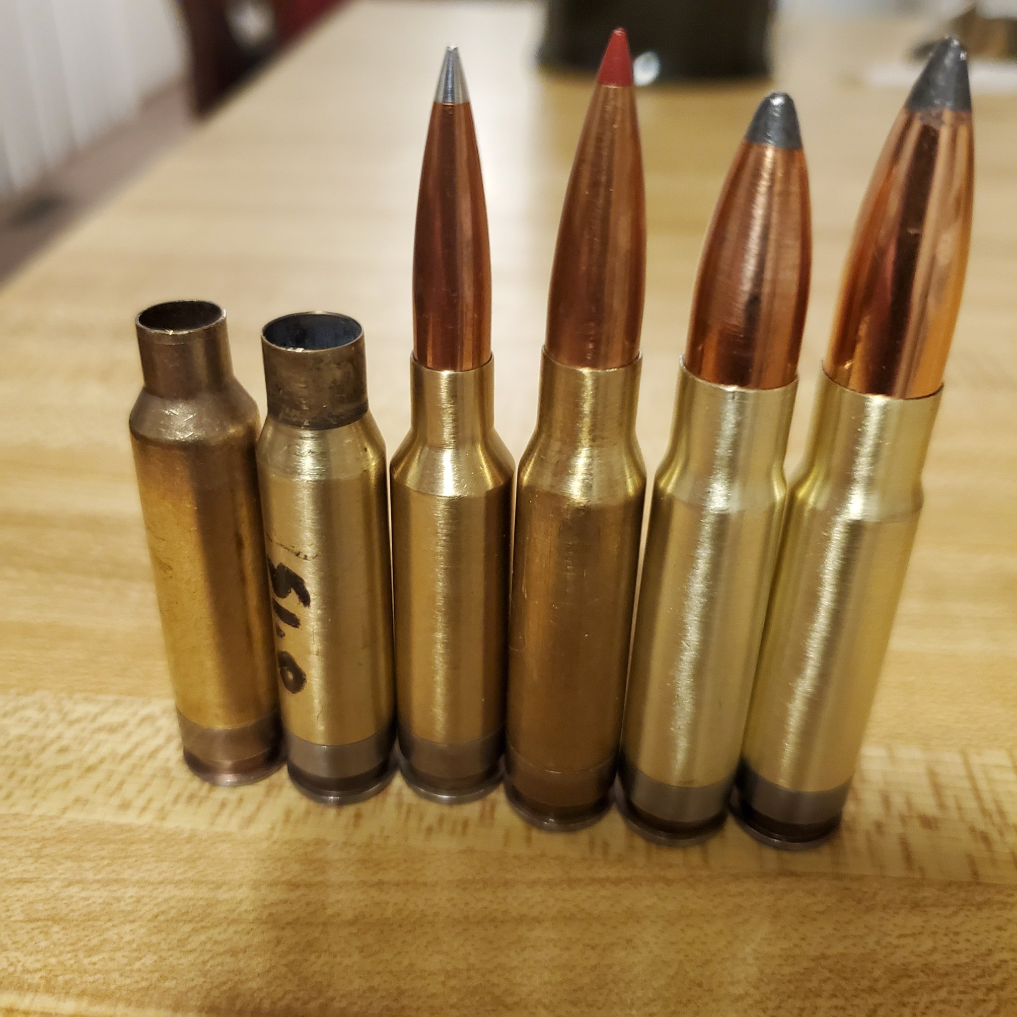

I've shot the hybrid cases in 308, 6.5 CM, 8.6 Blkout, 358 win, in severl different standard actions at that high pressure, for several years now in standard production here is a Ruger.

6.5 CM..." hybrid"cases 2.900" xx.x gr of RL26 (my load) = 2880 fps, from 16" barrel.
277 Fury hybrid cases 150 gr Nosler BT 2.900" COAL ××.× RL26 = 2932 fps from 16" barrel.

For bolt guns hybrid cases are available for more advanced reloaders in any 308 pattern cartridge, 7mm-08, 6.5 CM. 308, 8.6 Blackout etc for more short barreld performance.
