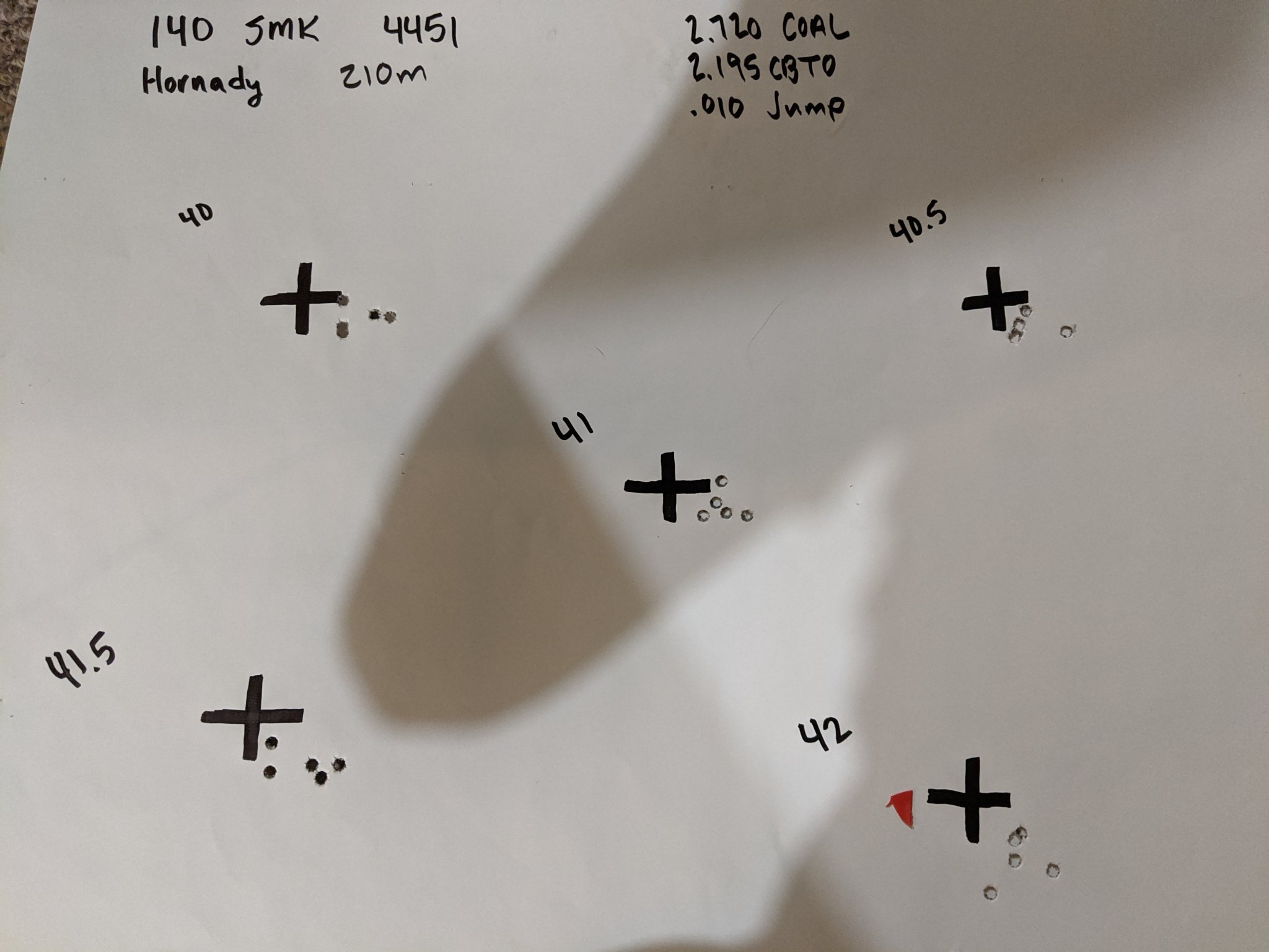

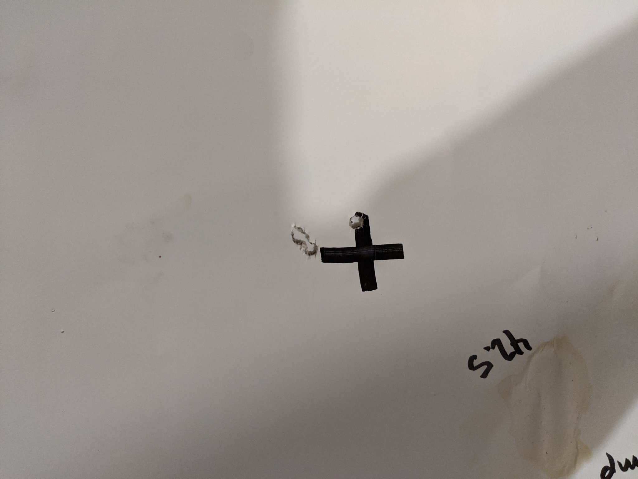

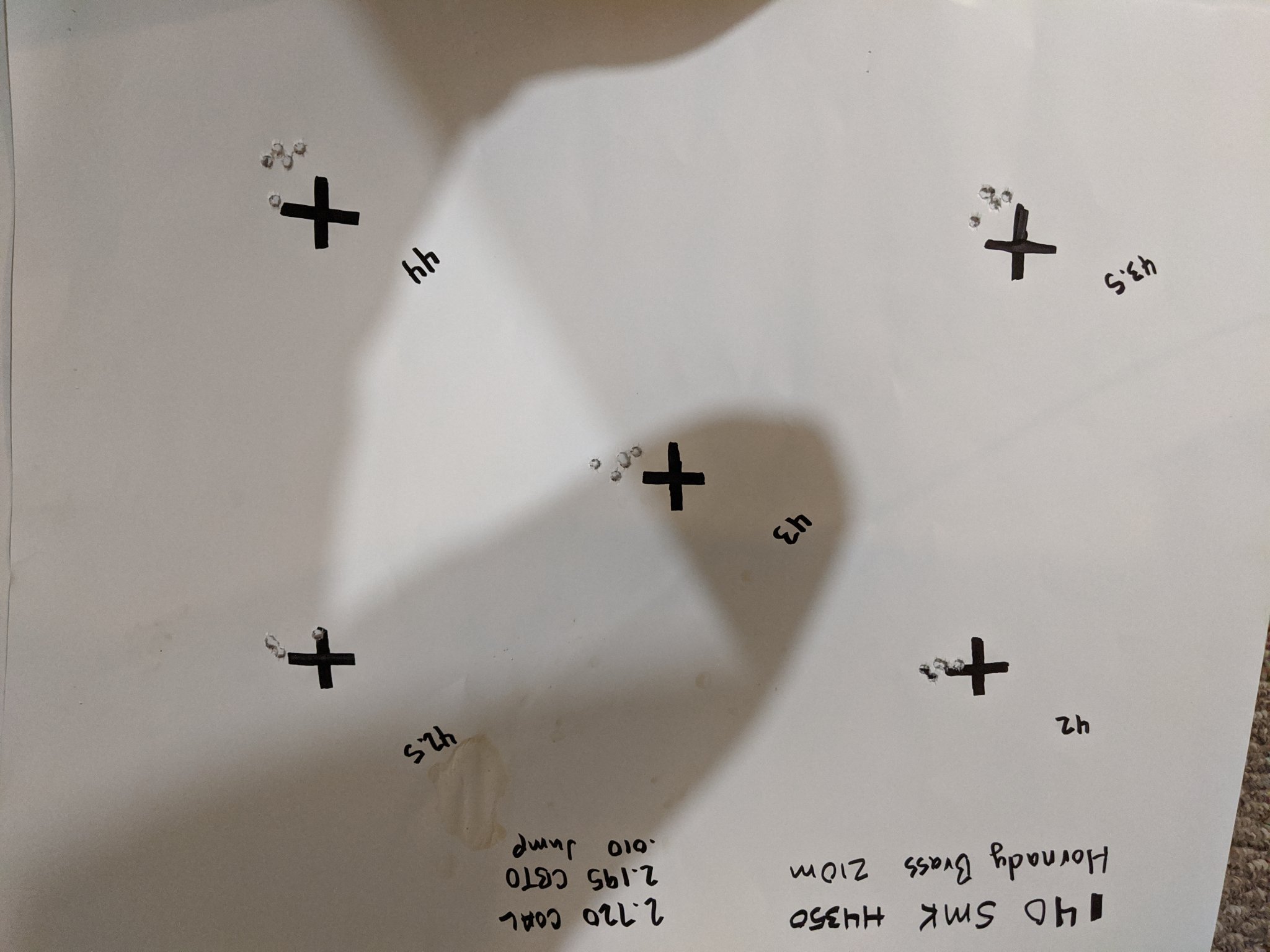

So one thing is I didn't read your title well enough. I didn't see that this was a PRC. I'm talking about a CM. As far as my CM went I'm sure I did have compression. This happened a while back. I know that I made a note in my notebook that in a string from 42-44 grains I wrote that 44 had ejector mark, heavy cratering, and the primer looked annealed in the center. These were loaded before I realized that mag length was 60k jam. I found that out afterwards but thought maybe I was getting a bad reading on my OAL gauge I was using and confirmed it when I went to load them at the range. I took them back and seated deeper knowing I had to pay close attention to pressure. The cratering prior to the 44 is common in my rifle but that load was probably a .5 grain from a Pierce. The accuracy was spotty but I was also sitting at 10k jump since I was already at a COAL of 2.720" which is shot as hell IMO. Between the COAL and the pressure I never revisited the bullet. One charge had a really good ( for me ) 5 shot with a flyer OFC. But I'm guessing none of this really factors since we are now not only talking about different rounds and rifles but now different cartridges as well. Not sure what the velocity on these were.

So one thing is I didn't read your title well enough. I didn't see that this was a PRC. I'm talking about a CM. As far as my CM went I'm sure I did have compression. This happened a while back. I know that I made a note in my notebook that in a string from 42-44 grains I wrote that 44 had ejector mark, heavy cratering, and the primer looked annealed in the center. These were loaded before I realized that mag length was 60k jam. I found that out afterwards but thought maybe I was getting a bad reading on my OAL gauge I was using and confirmed it when I went to load them at the range. I took them back and seated deeper knowing I had to pay close attention to pressure. The cratering prior to the 44 is common in my rifle but that load was probably a .5 grain from a Pierce. The accuracy was spotty but I was also sitting at 10k jump since I was already at a COAL of 2.720" which is shot as hell IMO. Between the COAL and the pressure I never revisited the bullet. One charge had a really good ( for me ) 5 shot with a flyer OFC. 3 in one hole, 1 touching, and one hanging out on a beach in Hawaii. But I'm guessing none of this really factors since we are now not only talking about different rounds and rifles but now different cartridges as well. Not sure what the velocity on these were.
