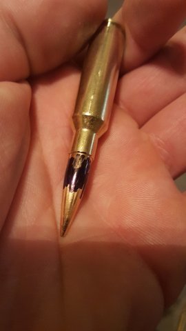

I will get a picture in a magazine tomorrow.Loaded factory ammo has marks on the bullet fromy what I belive to be the lands when loaded rounds are ejected. Thanks for the input
I would shoot 10 rds with appropriate charge, new chambers can have shards of rifling jutting out skewing oal length, then remeasure, if still off, re-ream the throat to your desired seat depth. Mag length is .2.800+

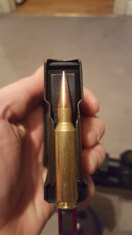

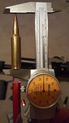

Here is a picture of the oal, loaded in a magazine, and a factory round loaded in chamber with marks from lands. (Rifle has 240 rounds through it already)

That's a train wreck, see if your smith has a throating reamer, if not, find one who does. 240 rds shouldn't, but make sure you don't have a carbon ring buildup in the throat area also.
