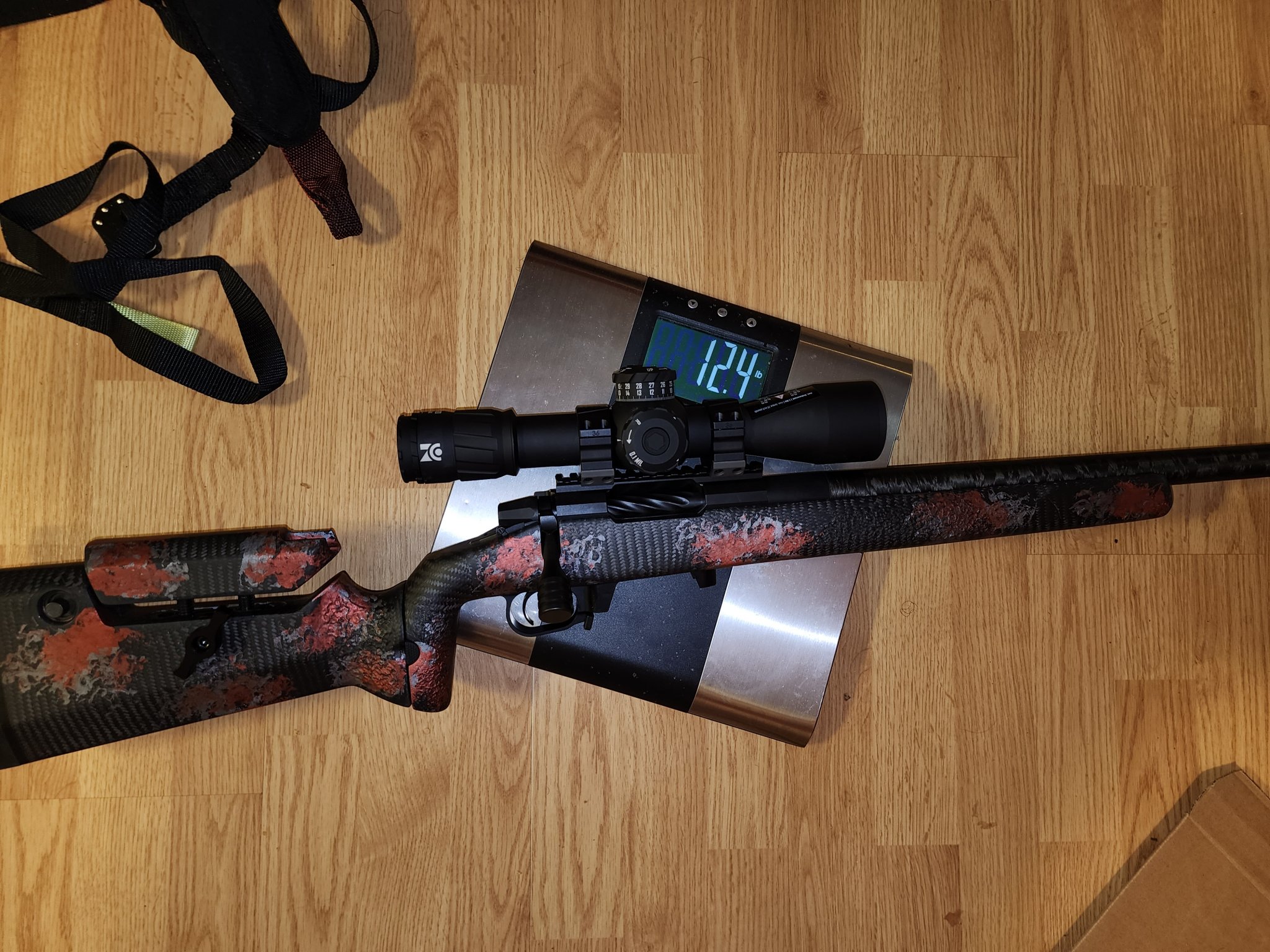

I was looking at the 16” Christensen Ridgeline Scout in .223 for a thermal host. They are also offered in .300, .308, 6.5 and 6mm arc. Pricey but only 6lbs.

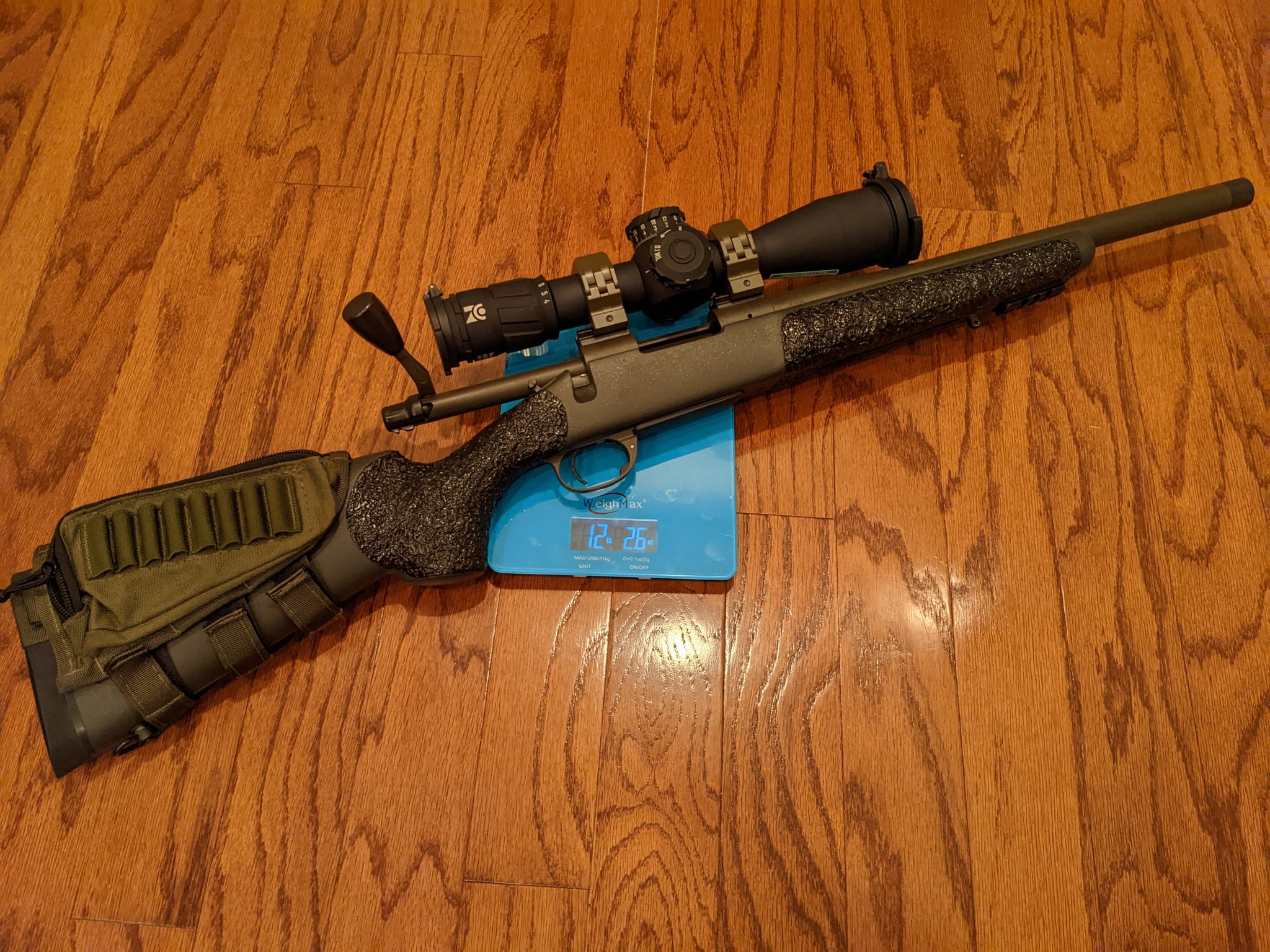

My 16" CTR. Rifle was slowly upgraded over time based on need. Never intended to be lightweight... I think it's about 14lbs loaded.

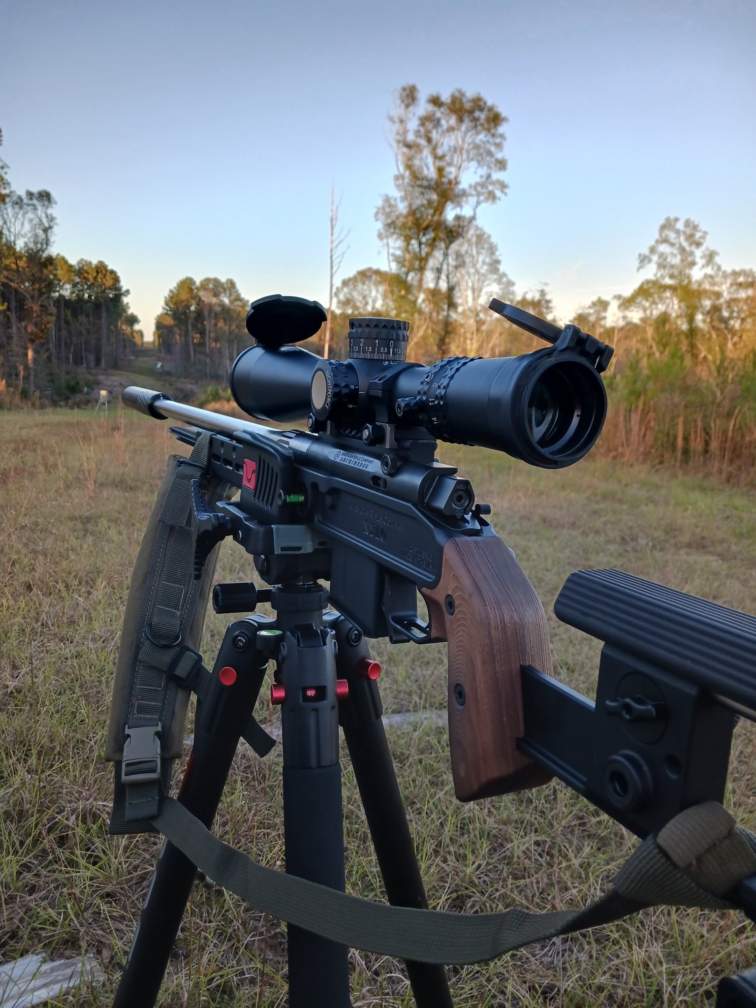

@reubenski we have similar taste. This is the little brother that is good for coyote/hogs. Again, never intended to be lightweight but is at only around 9lbs loaded even with the stellite can (Razor) hanging off the front - mostly thanks to the thermal.

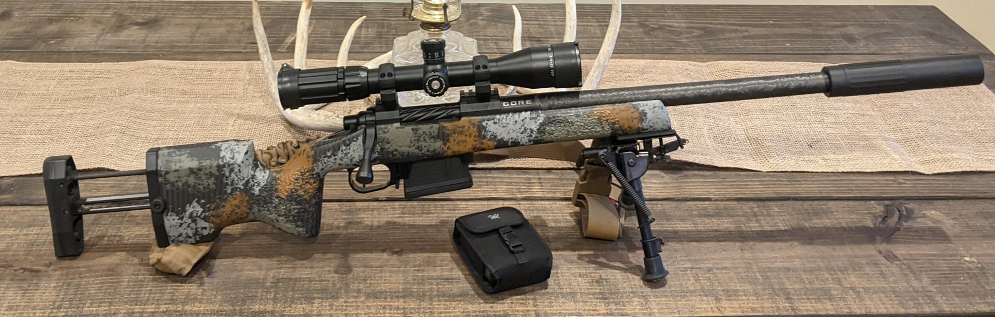

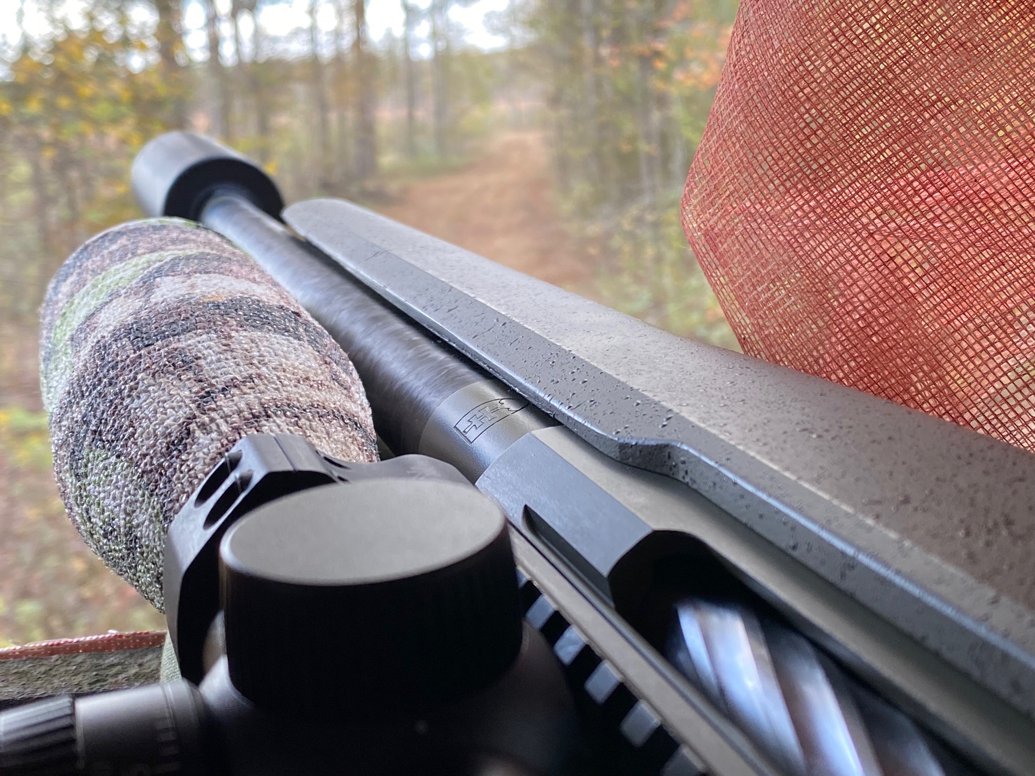

I recently got a barrel spun up and a KRG Bravo to configure my Mausingfield into a light(er) hunting rifle. Definitely not a lightweight hunting gun, but a lot lighter than it is in a JAE with a 24-28" HV/MTU contour barrel.
I decided to go with an 18" 6.5 Creedmoor, as I wanted to use the boxes of 143 ELD-X I have collecting dust. However, what I've found with the shorter barrel is that it's pretty slow with the heavier projectiles. The 143 ELD-X's are traveling 2500 fps as they leave the muzzle, which is pretty slow IMO. I think with a short barrel 6.5 cm, you are better off with lighter projectiles, which may be hard to do if limited to factory ammo. I'm now reloading 123 Scenars and ELD-M's.
If I was to build a dedicated whitetail rifle today that was limited to factory ammo, I would strongly consider the 6 Creedmoor. I would think the overbore nature of the 6 Creedmoor would help make the cartridge more suitable velocity wise from shorter barrels.

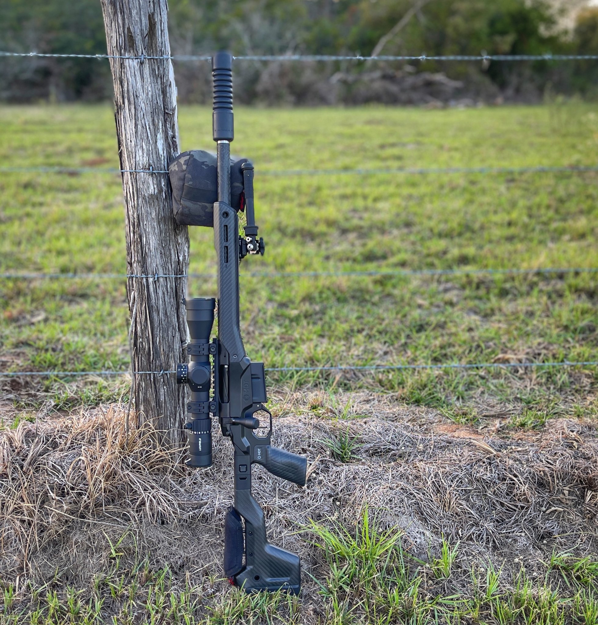

Bit north of you up in PA but for the same use case I built an 18” CF 6.5 PRC on an Archimedes action in an HNT26 chassis, weighs exactly 10 pounds with a Nomad Ti and an NX8 2.5-20 though I should be able to shave 8 oz when I get my Gen 3 1-10x.

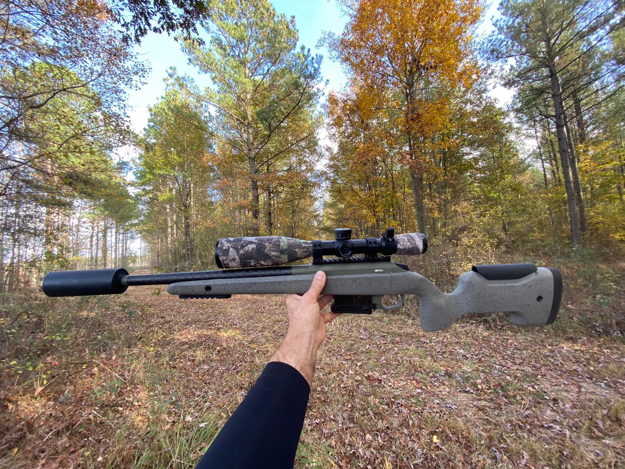

For your range you're hunting, you won't loose anything with the short barrel in any of the calibers you listed (neither will the deer). I've been running a 16" DPMS G2 in 308 since it came out. That gun has taken 30-40 deer plus with bullets from 150 up to 180's and from ranges measured in feet out to 400 yards. It's a fantastic little set-up and easy to maneuver in a blind.
