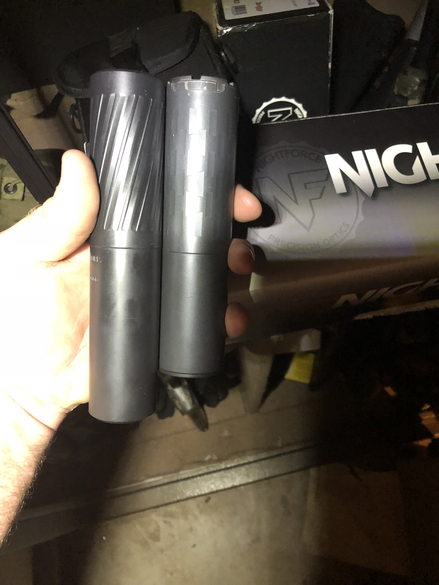

Here’s a ultra 7 vs omega w/flat ti endcap. Have’ t measured the omega but it’s not too long and very compatible in dB reduction to the 7.
It's a round 6.25-6.5" I run the Omega in that config most of the time. Though i'd still go TBAC reduction is better, cans are more durable in my experience. I've had the baffle stack come undone out of my Omega within the first couple of weeks of having it after running it on a 6.5 SAUM. The sleeve of both my omega and Hybrid constantly have to be reloctited or tightened. It's just annoying as hell.
The sleeve coming loose is a pain in the dick, solved the problem with a bit of Rocksett each time which I use on the direct threads as well, problem went away. Have read stories about the stack issues but makes me wonder if that wasn’t an issue with early omegas. There’s guys running cans locally that stay on either 28 Noslers, 300 Normas, or 300 wins with no issues.
My Omega's sleeve has loosened up but only a little. Haven't had a complete failure yet and it has gone through a 3 day carbine class that I shot completely suppressed. My serial number is 1379x. Not sure how early or established this is considered.
