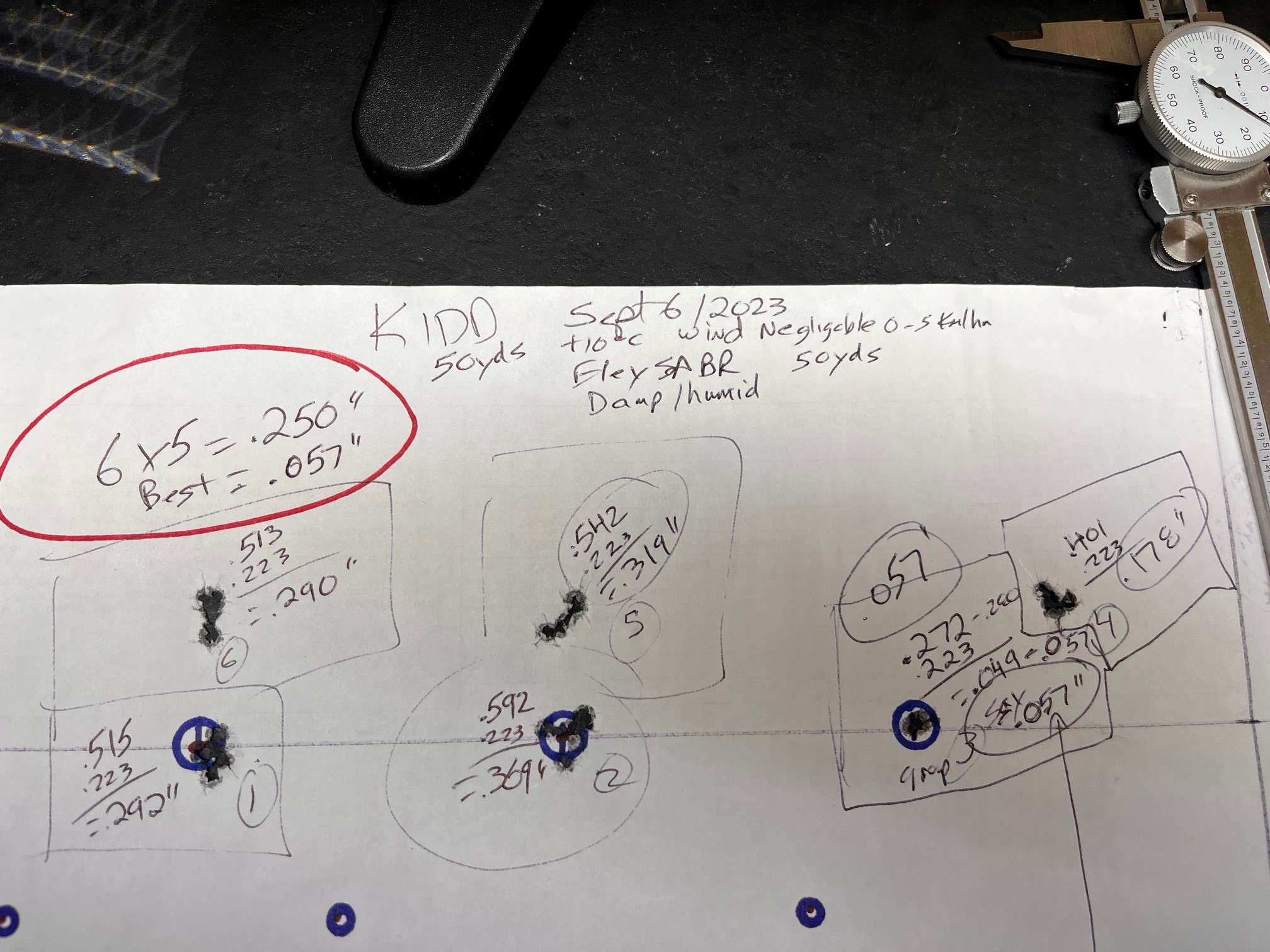

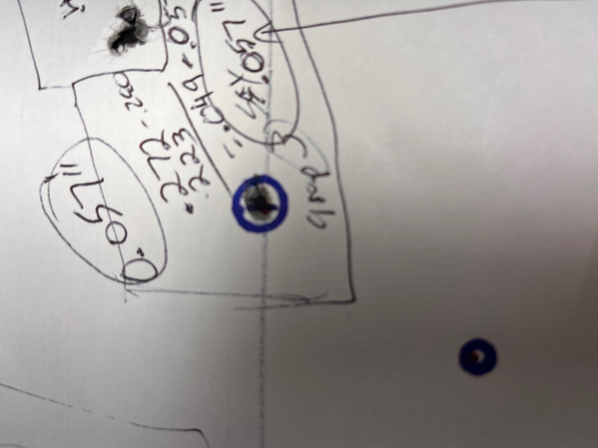

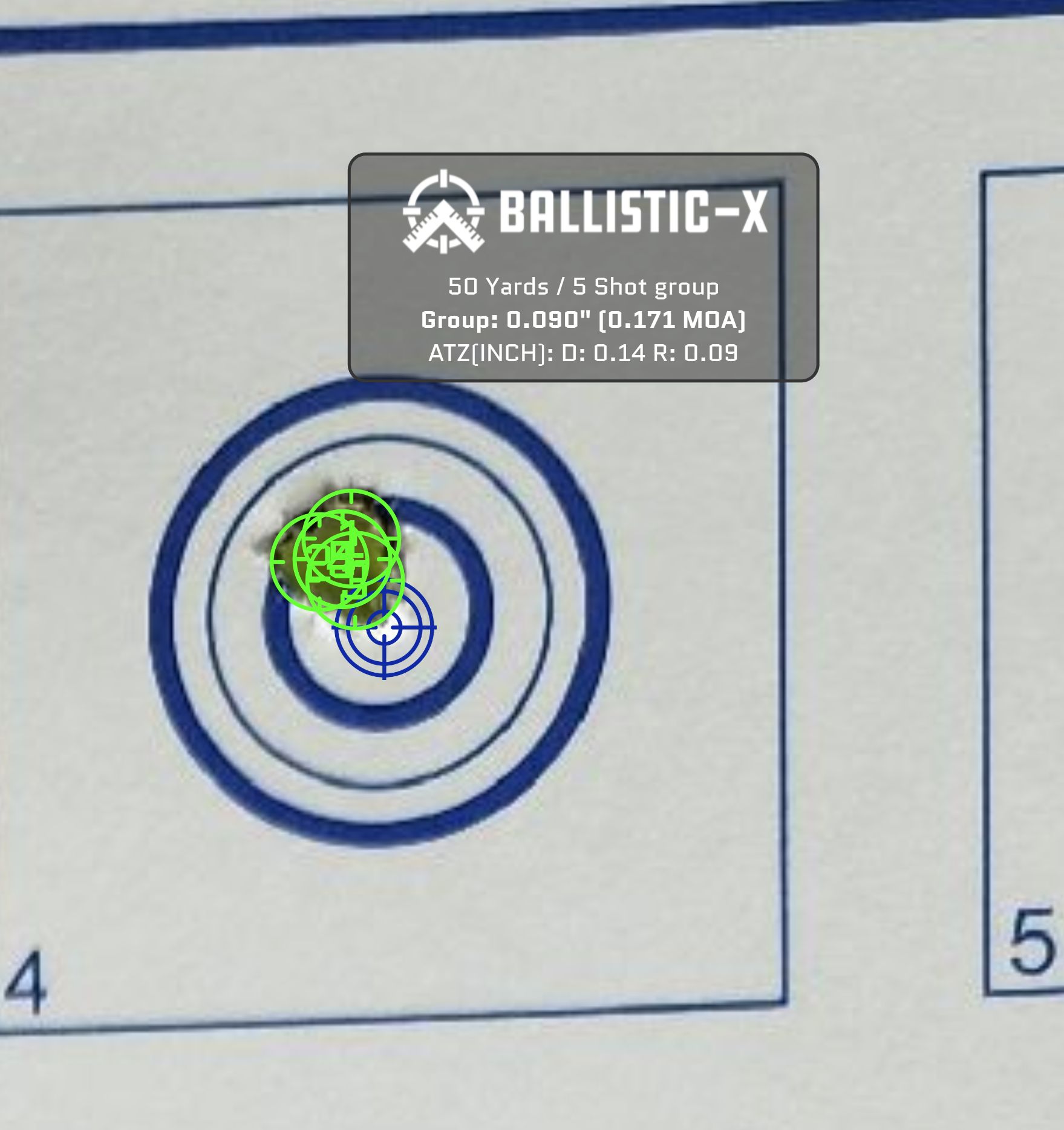

...HOWEVER, first thing this am I did get a 0.0X with my Kidd 10/22 with Eley BR SA. Eley BR SA doesn't leave a nice black ring like Eley Match does, so the group took a bit more effort to properly measure and I had the large magnifier out. So for fairness, I used the higher reading of 0.057".
Maybe a bit of a fluke with a Kidd in near perfect winds, but the overall average of the 6 groups was .250".
Who's next to shoot and show theirs?

Yeah, it was definately harder to measure the 0.0X" group then a larger group was / is. I think aprt of the reason I had additional trouble measuring is because my group landed right in the middle of my point of aim box.
In my case, I used a vernier (mitutoyo) with a magnifying glass - which should be good for what we are doing. I think some might even use a ruler, which is definately too crude for accrurate group measurements.

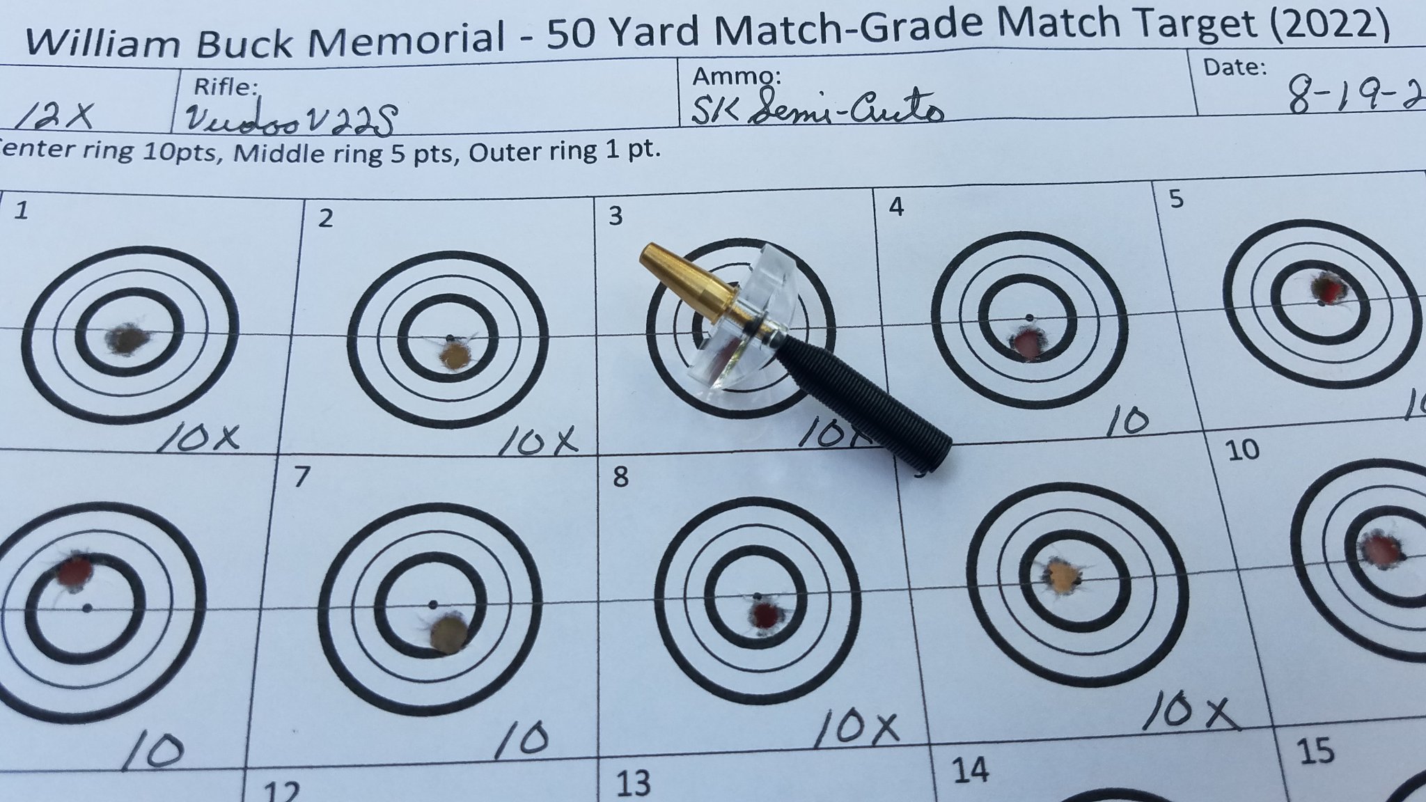

This is the plug I use, works very well. It was given to me by someone who is a fan of Anschutz 22LR. rifles.

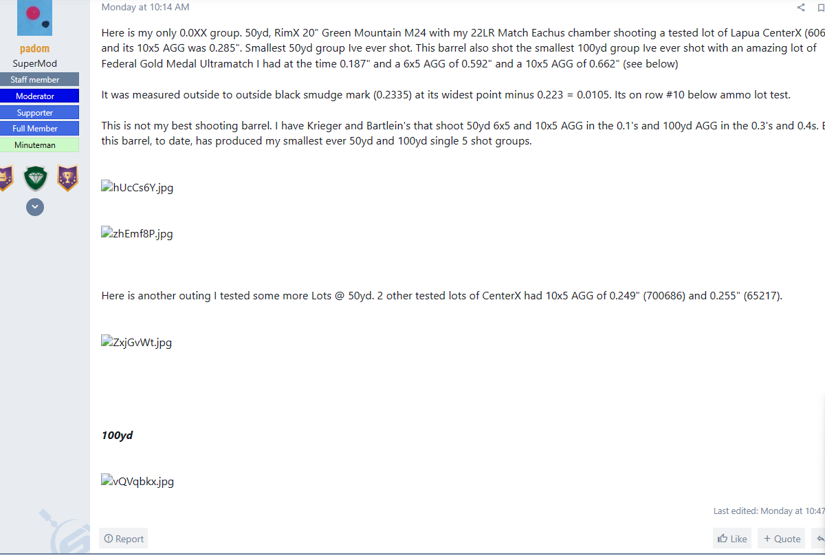

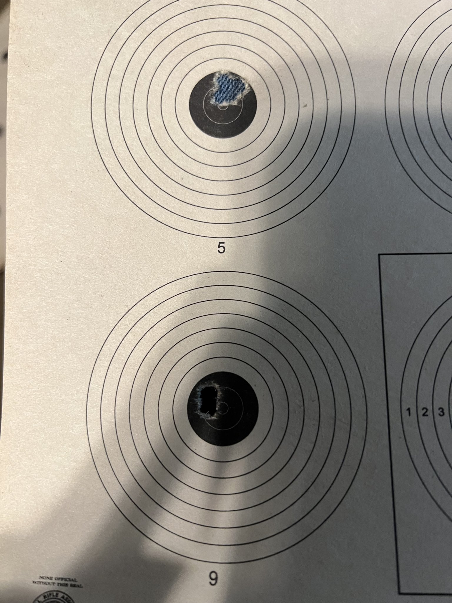

Here is my only 0.0XX group. 50yd, RimX 20" Green Mountain M24 with my 22LR Match Eachus chamber shooting a tested lot of Lapua CenterX (606324) and its 10x5 AGG was 0.285". Smallest 50yd group Ive ever shot. This barrel also shot the smallest 100yd group Ive ever shot with an amazing lot of Federal Gold Medal Ultramatch I had at the time 0.187" and a 6x5 AGG of 0.592" and a 10x5 AGG of 0.662" (see below)
It was measured outside to outside black smudge mark (0.2335) at its widest point minus 0.223 = 0.0105. Its on row #10 below ammo lot test.
This is not my best shooting barrel. I have Krieger and Bartlein's that shoot 50yd 6x5 and 10x5 AGG in the 0.1's and 100yd AGG in the 0.3's and 0.4s. But, this barrel, to date, has produced my smallest ever 50yd and 100yd single 5 shot groups.

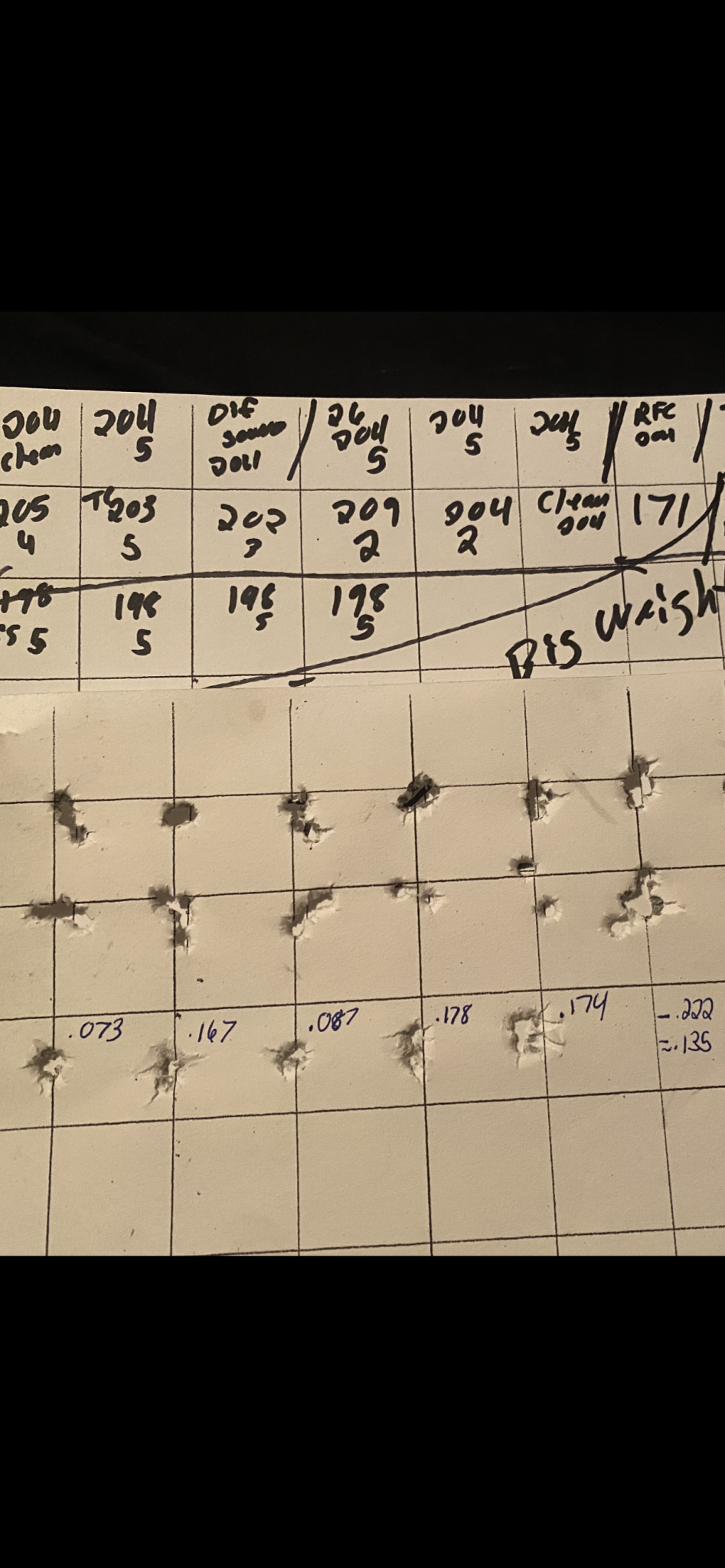

Here is another outing I tested some more Lots @ 50yd. 2 other tested lots of CenterX had 10x5 AGG of 0.249" (700686) and 0.255" (65217).

Maybe it's just my computer, but it won't show the pics?

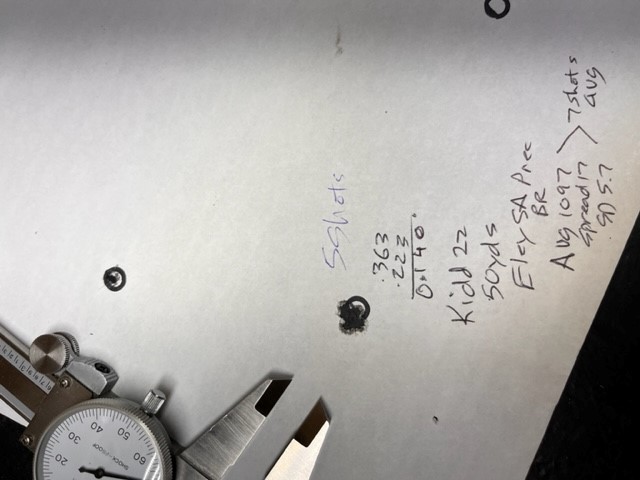

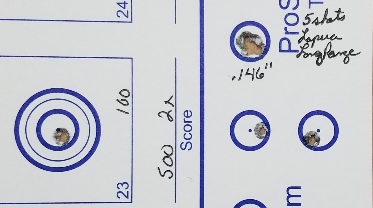

I cleaned my Kidd 10/22 this weekend and got it ready for an upcoming match and was more or less sighting it in for benchrest shooting and shot this .140" - 5 shot group at 50 yards while prone off a homemade rear bag. Still only have shot one 0.0X so far...that was with the Kidd as well. Gotta produce the same with the Vudoo, but so far no luck- howeve, lots of .1's.
Thanks!!! I was on fire that day, seems every group was in the .1's.
What really drives me nuts is the one very low left shot was a missed wind call. I knew where it was going and just didn't make it happen. :cry:

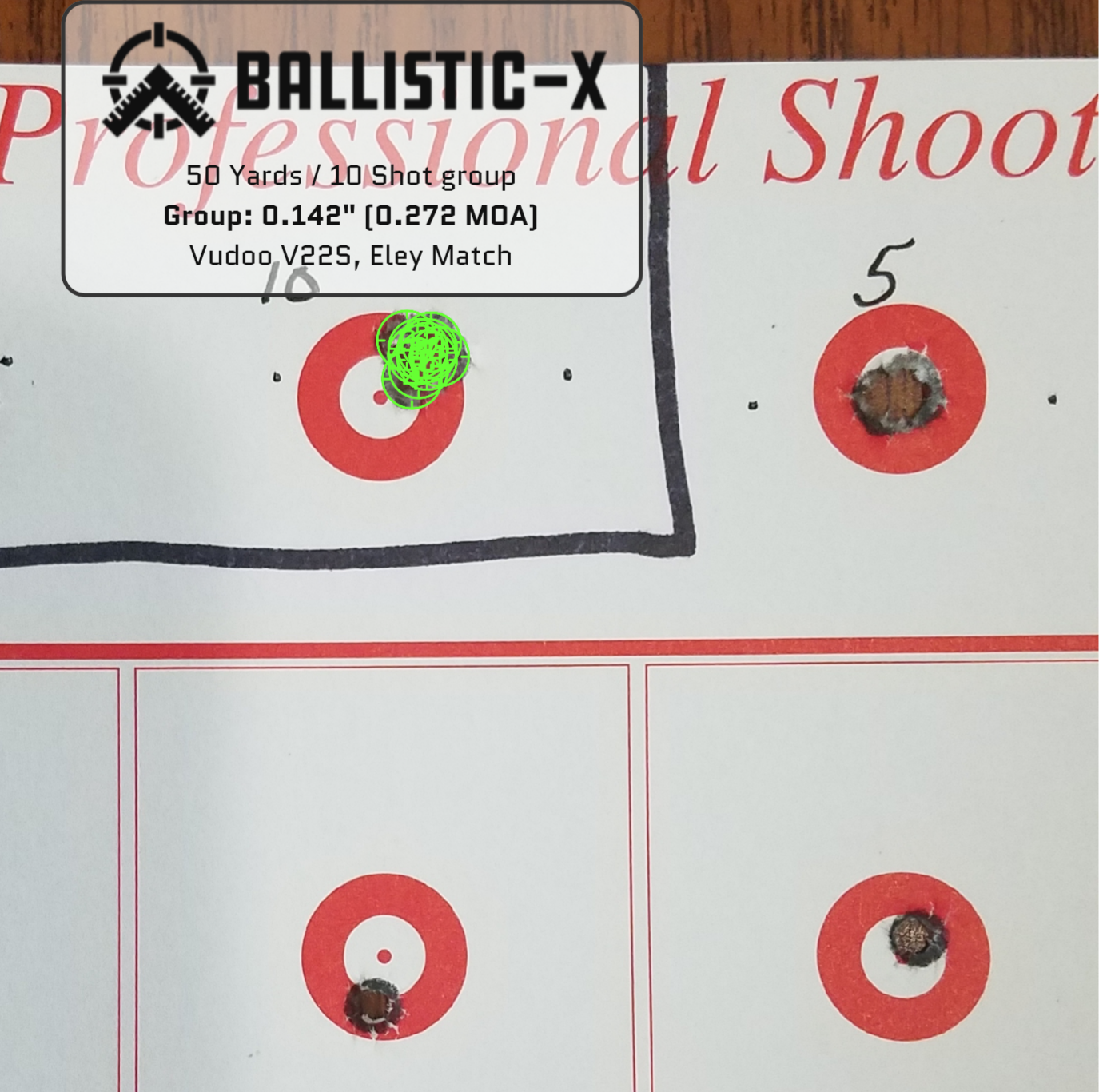

Since we have a show me your 0.0XX - 5 shot group. I wanna start a thread...show me your 10 shot 0.1XX groups - you can be the first as I haven't done it yet. A .2's yes, but not .1's for a ten shot.
Sounds good....count me in!!
